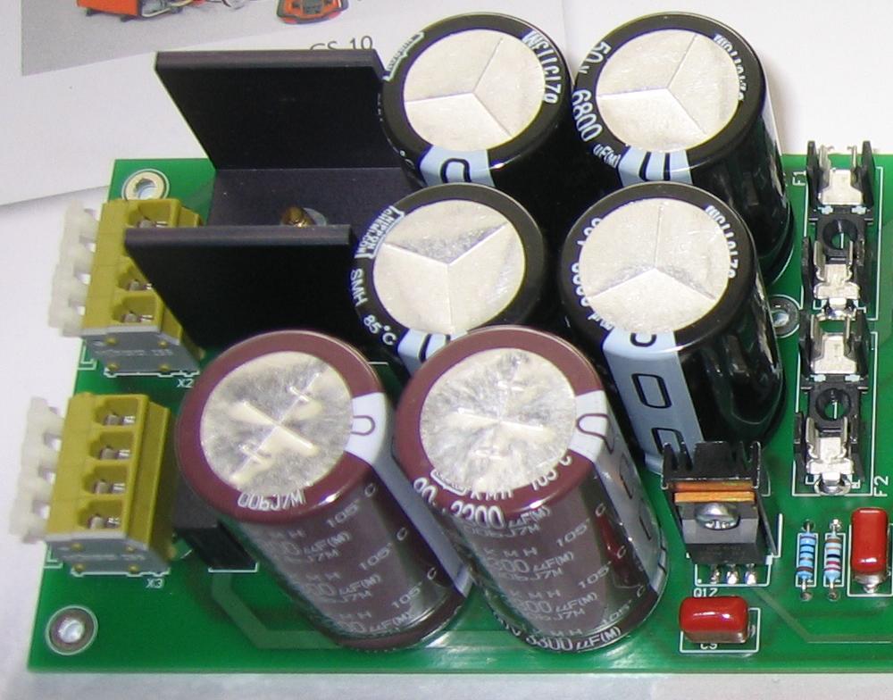

Hi David,
I always like to put about 1000uF per rail on the amp board close to the output transistors. If one does this, the wiring length to the big PSU reservoir caps does not matter much. These should of course be bypassed with iuF or so. These caps pretty much take care of the HF issues, making the arrangement far less dependent on the wiring to the PSU for distortion, etc.
An interesting half-crazy idea is to go far non-conventional when one does this, not using big wires to the PSU, but rather small-tightly coupled ones, including ground. The little bit of resistance may actually help matters and even give a little additional filtering from the PS at HF. Consider shielded microphone cable, wiring the rails on the inside wires and using the shield as the ground return to the PSU reservoir caps. When doing this, I return the speaker output to the amp board at the center of the on-board caps rather than a star ground at the PSU when I do this.
I realize that Self does not recommend twisting together the two rail leads and the ground, instead preferring to twist together only the two rail wires.
I always prototype with relatively long wires to the PSU.
Bob
Local or on-board cap/regulator is always the best approach.
The main filter/energy storage caps can be mounted with the terminals facing downward so they are close to the chassis and the PS and return wiring run against the chassis. Ground the caps' metal case also, if it has one, to the chassis via the hold-down mounting hardware. if mounted in the typical way with terminals facing upward, run the PS wires to it against the chassis and close up against the sides of the grounded cap case.
-Thx-RNMarsh
-Thx-RNMarsh
This isn't crazy at all. The limit is Cherry's A New Distortion Mechanism in Class B Amplifiers where he puts series inductance in the PSU leads with large local electrolytics.An interesting half-crazy idea is to go far non-conventional when one does this, not using big wires to the PSU, but rather small-tightly coupled ones, including ground. The little bit of resistance may actually help matters and even give a little additional filtering from the PS at HF.
I don't think its necessary to go to his lengths (the inductors) but this was the paper that refined my thinking on the subject.
He does this on his ETI NDFL amp that is on jan.didden's website. Loadsa useful practical details therein.
In da old days, it was difficult to find good caps small enough to put near the OPS & VAS. 220u was the biggest I could squeeze in. I remember marvelling at some really supa dupa full power THD20k measurements on a 50W prototype .. until the local caps blew up. 😱
