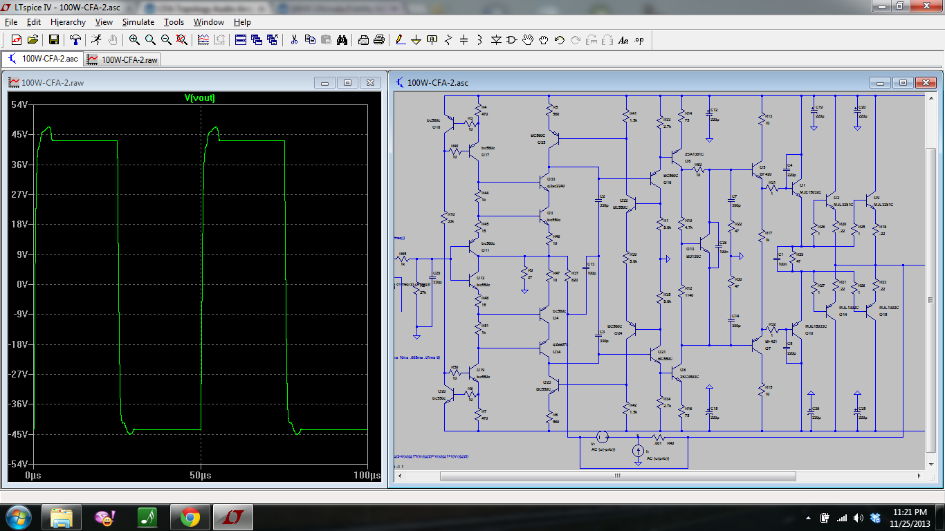

I've also simulated your BJT version schematic with square wave signal input, but the ringing looks a little different/better.

Hi Dadod, your amp designs certainly demonstrated admirable distortion performances.
I started learning to use LTspice as recent as a short few months ago. Please allow a beginner's question. I found the Tian probe you have in your schematics has a backwards current source from all other people's schematic I've seen here. Perhaps the polarity wont matter in a Tian probe?
Did you have the input LPF in when you plot the square wave response? The LPF seems to have a great effect on the overshoot and ringings, as we have found with your 200W-CFA design. Perhaps a LPF can improve the overshoot and ringing here too. From my limited study into a few CFA designs it seems that despite a fast SR and a broad bandwidth, these circuit require a heavy bandwidth limit at the input in order to have a clean square wave response.

Hi Nattawa, second question is answered in my previous post.
Regarding Tian probe I noticed that voltage source direction has influence, I am not yet completely familiar with the Tian probe.
This amps were just an exercise to get distortion as low as possible, but I am not confident in it, my simpler version(200W) should be very stable and good sounding, I hope. And all the trick is in Cherry compensation.

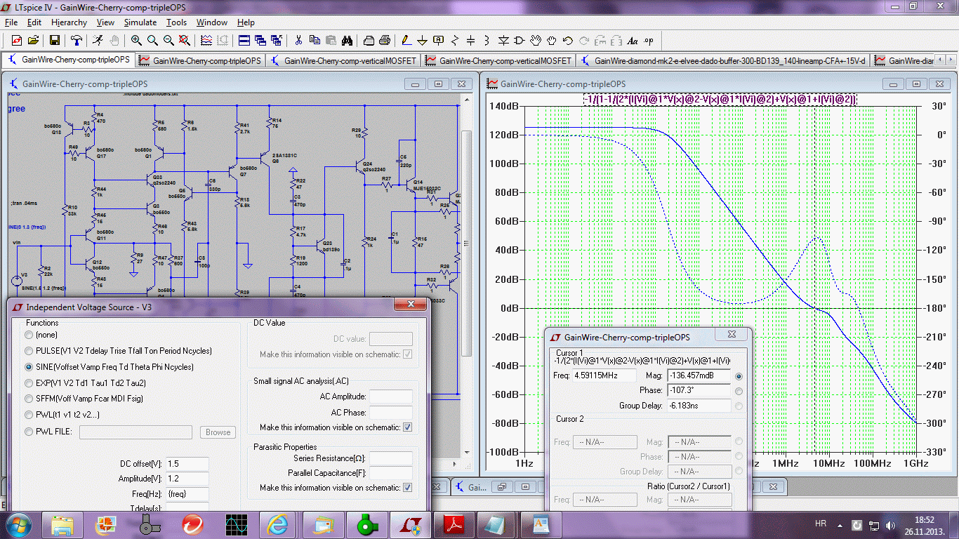

Here are the square wave plots and Loop Gain plots for both amps, MOSFET and triple BJT.
I hope it's clear from the plots what was the ULGF.
Damir
6MHz, to high for a practical implementation, this is one of those things that works in the simulator only. OTOH, using two pairs of output devices for 50W into 8ohm explains why the output stage has low distortions (only 1.8A peak for each device).
Bias the output towards the rails and determine again the gain and phase margins. You will find out why the large signal step response is not right, the phase margin will be significantly lower and the step response will overshoot.
I keep saying this, with limited success so far. CFA or VFA, there is no limit in what the loop gain can lower the distortions, as long as the ULGF is arbitrary high. For a fixed ULGF, the only possible way to increase the loop gain (for any audio amplifiers, and in general for any minimum phase system) is to increase the compensation network order. That is, inserting N poles and N-1 zeroes to bring the phase back to the Bode stability criteria.

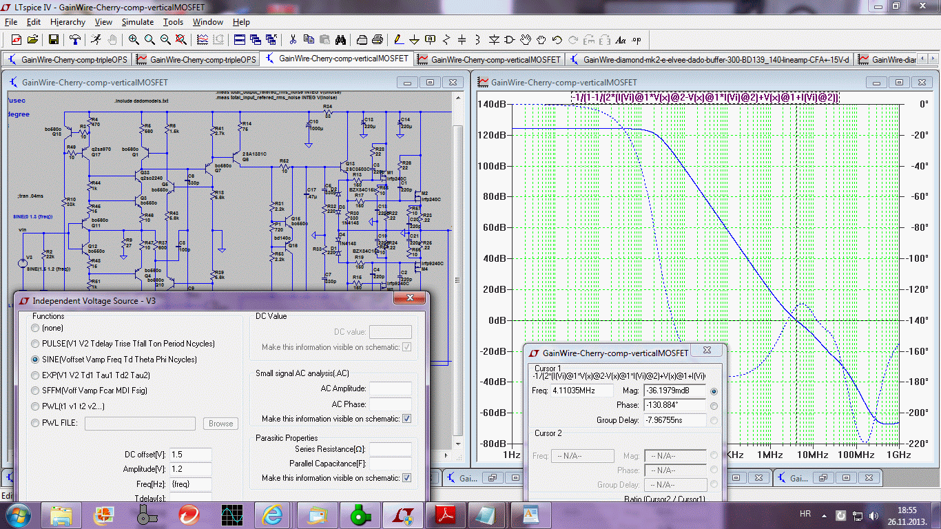

You should look at those schematics more carefully, they are capable for over 100 W into 8 ohm with the THD20k a bit over 1 ppm.
How you bias output toward the rails for .ac sim, with DC offset on input as I did in attached simulation??
If that is correct way to sim it, then I don't see a hint of instability, look attached plot. Uper output transistors are biased to 2.2 A. Maybe it is not a smoked mirror, don't be so conservative, you are young guy(student?).
BR Damir
