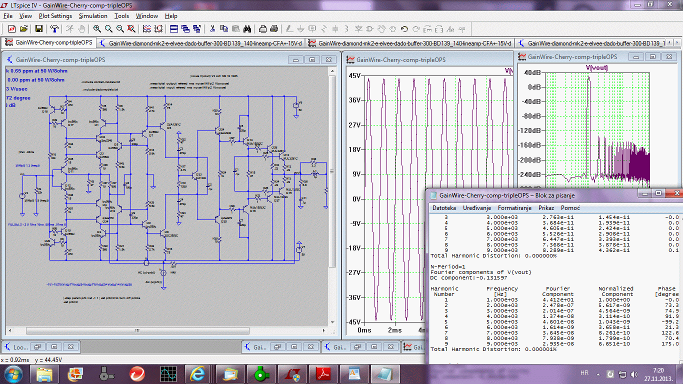

Here you feed the amp at +/-50V and push the output at not more than +/-27Vpeak. No wonder there's virtually no THD20 (and PIM). If you bias the output at +/-27V by applying a DC component at the input, the ULGF of 6MHz won't move much, so not much PIM.
Now push the output at say +/-45V (just before clipping) and the THD20 (and PIM) will show it's ugly head.
You may want to try modulating a very low frequency sine (e.g. 1Hz) with a 20KHz small sine, then watch the 20KHz harmonics as they move around. Requires a very long simulation time, though.
That s not representative of real life conditions , 5V below
the rails is quite excessive , 10V seems more adequate as
in Dadod s sims , 50V rails is not enough for whom wants
45V peaks outputs.
45V peaks outputs.
Whatever it takes, just before clipping, I haven't see his distortion results at 40V (or more) peak output. But as much as 23V under the 50V rails (as in Dadod's simulation) is completely irrelevant for an apple to apple distortion performance comparison.

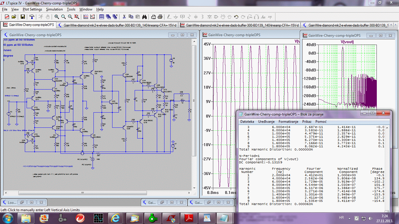

First it was 28V (50W/8).
Here are simulations of THD1k and THD20k with 44V peak output and 120W in 8 ohm, is that good enough?
