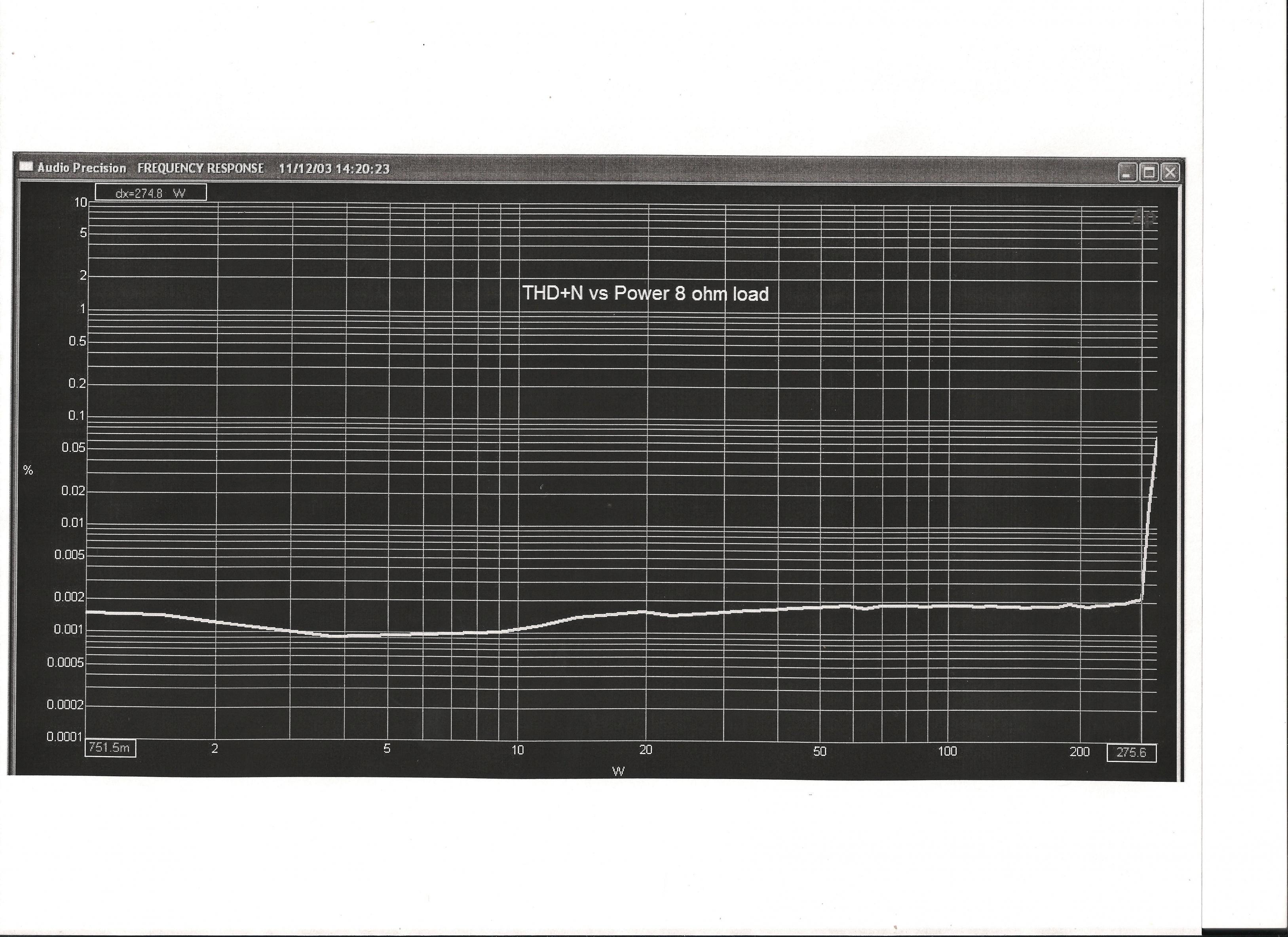

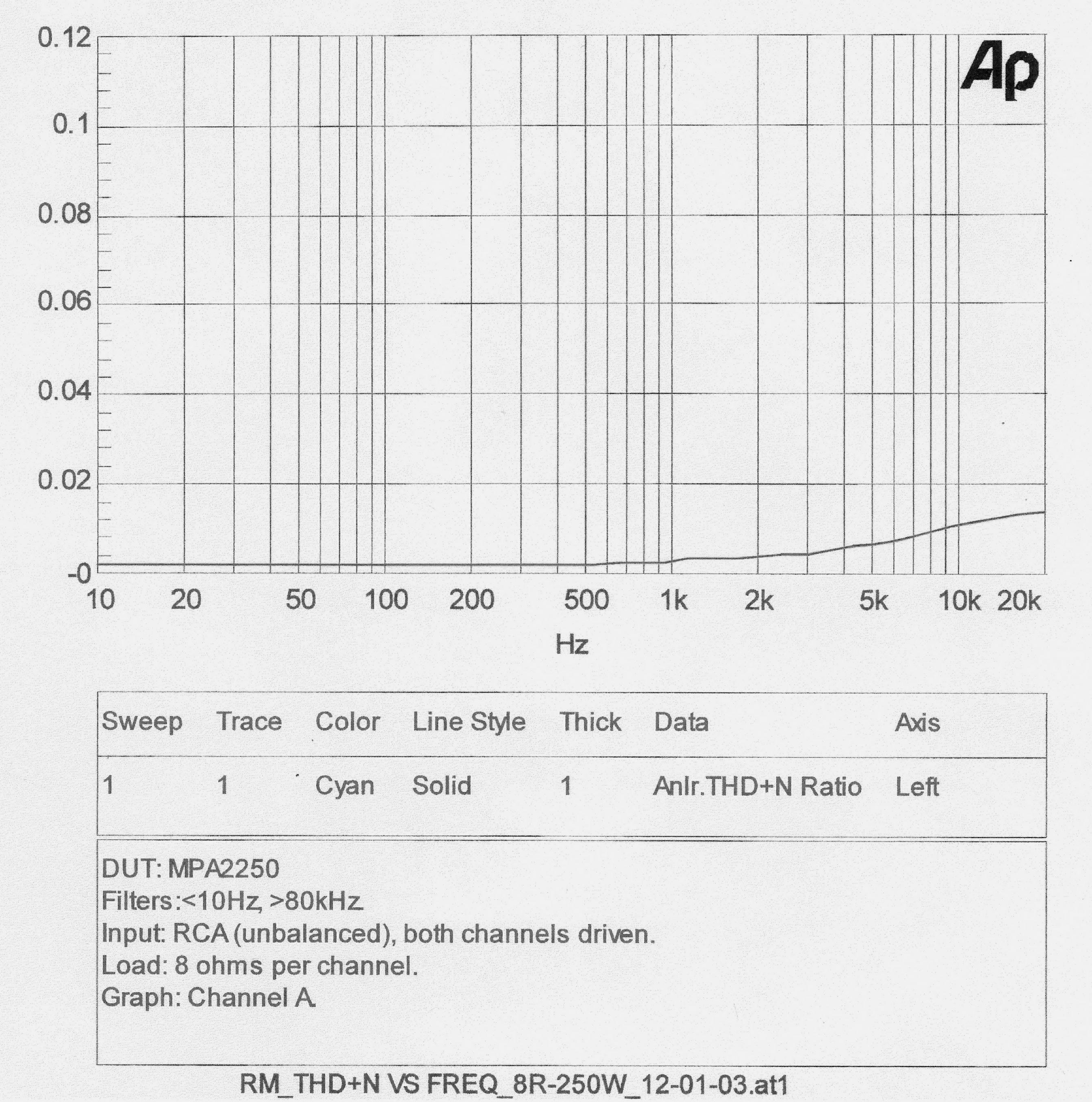

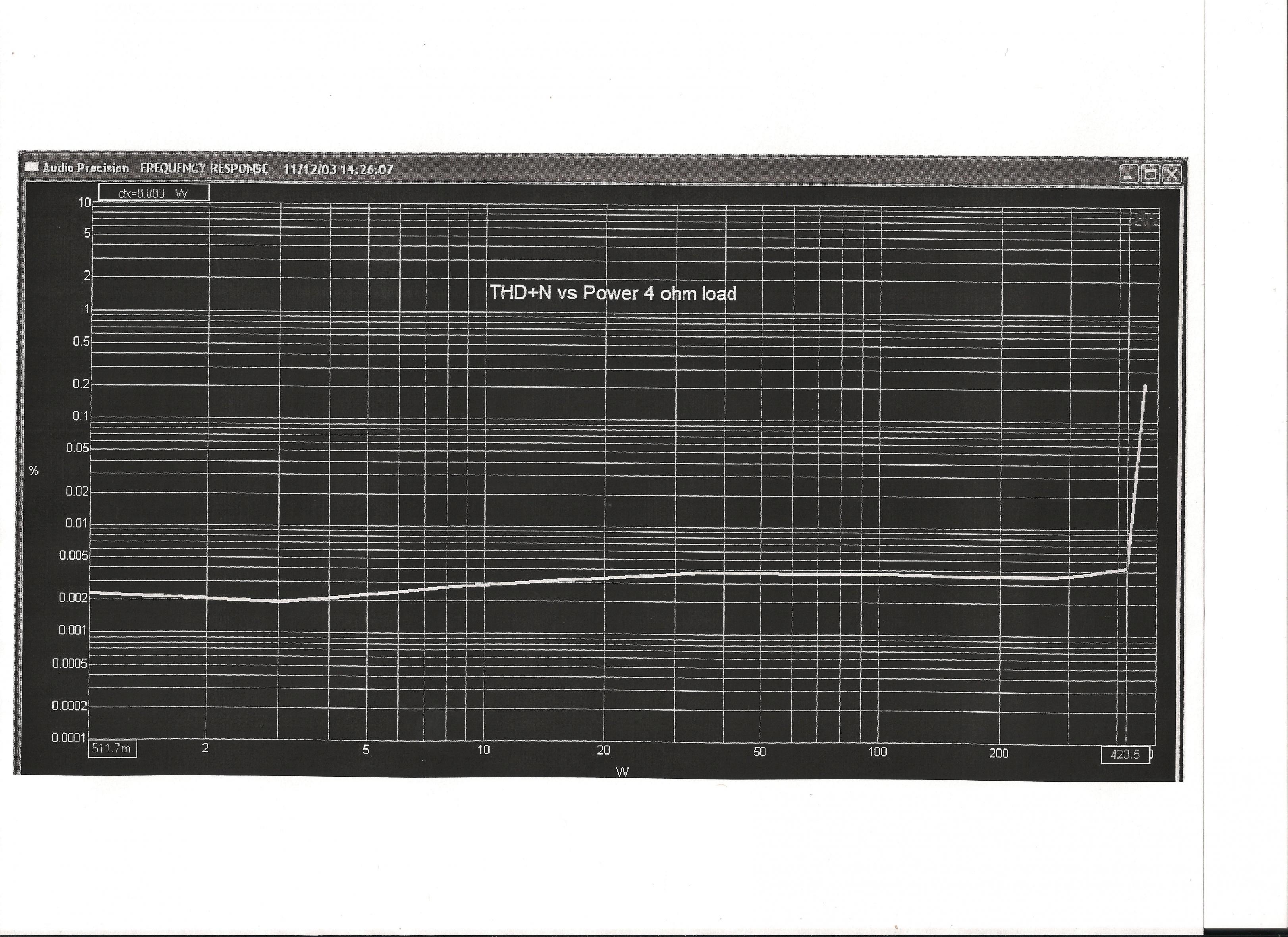

First let me put up again some real world data -- again, measured and not SIM. These are CFA power amps that I designed and had built several years ago - just as our economy went over the cliff to never return.
The THD was done at that time with an A-P SYS One which really could not accurately read what the amps could do-- just measuring itself plus a little added noise. But here it is from a decade plus back in time.

Hi Richard,
What's the fundamental frequency?
Bob

Greetings, Bob -- I only have this proto-type measurement here.... production was better... note it is a worse case -- only 1dB below clipping at 250W. Unmeasureable (at that time) at lower levels of power output. Which is basically why the test was done at such high power output near clipping... to get some numbers. Two channels both driven simultaneously... only channel shown.
I expect we could do a lot better today.

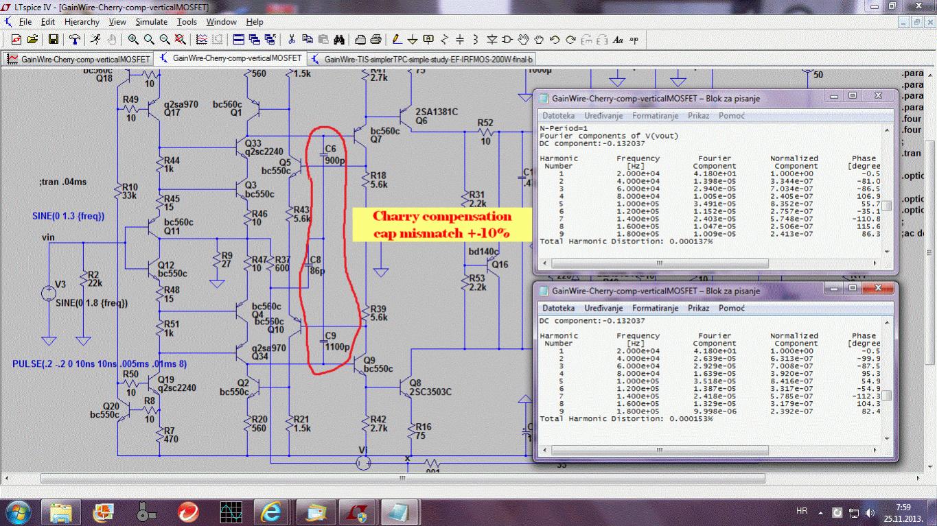

This is good exsample. Cherry compensation, C6 -10% and C9 +10%, THD20k at 100W/8 increased from 0.000137% with perfectly matched caps to 0.000153%. Insignificant!

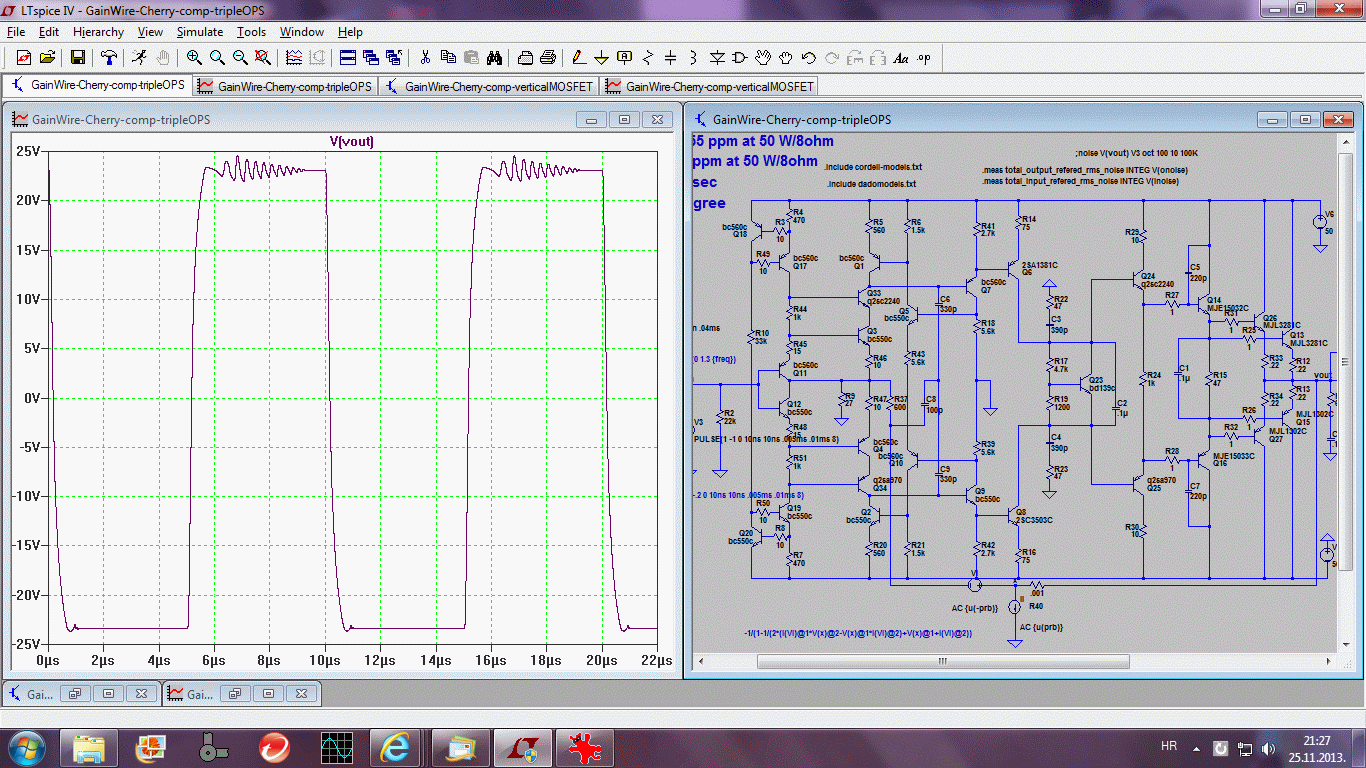

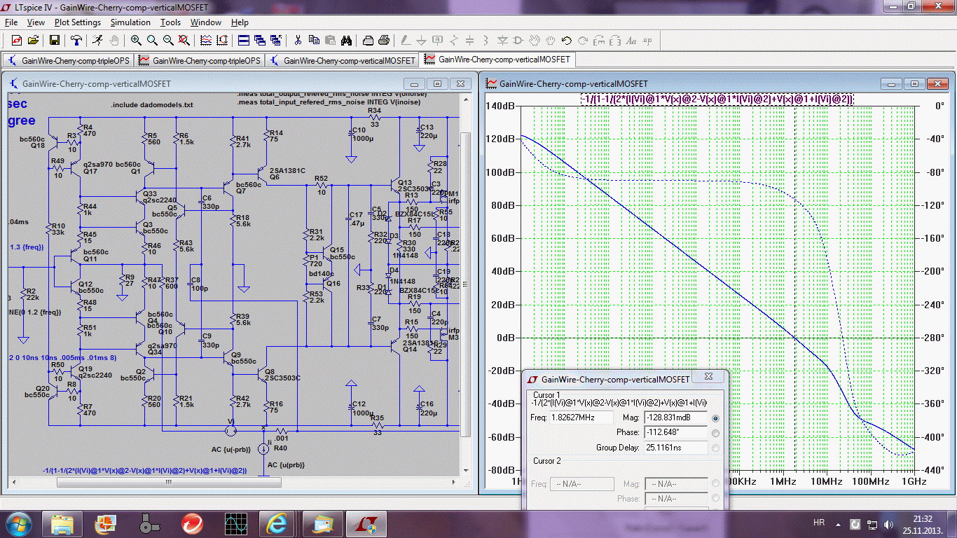

Hi dadod, have you practically built that amplifier? I'm thinking of designing a PCB for it and then to try to build it, would it obtain those perfect results in practice? Is it a stable enough amplifier or it needs some extra compensation?
Thank you!
Thank you!
This is just simulation. I think it needs some more polishing, it shows strange oscilation on positive side of square wave simulation, I just didn't have time to investigate more. From the Bode plot it looks very stable, but that square test warred me.

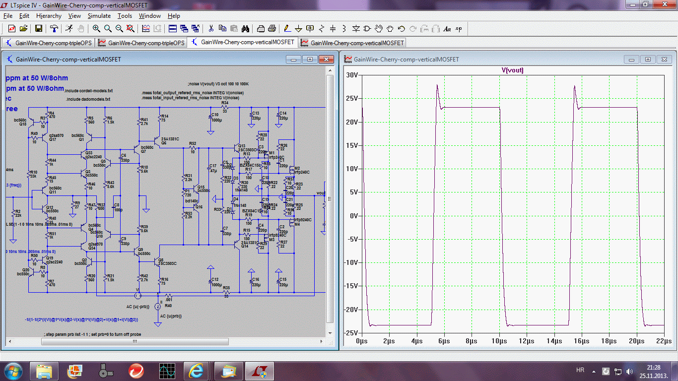

And this is with vertical MOSFET OPS. THD1k at 50W/8 ohm is 0.000000%.
It uses Cherry compensation with shunt compensation and 120 dB of NFB at 1 kHz.
Damir

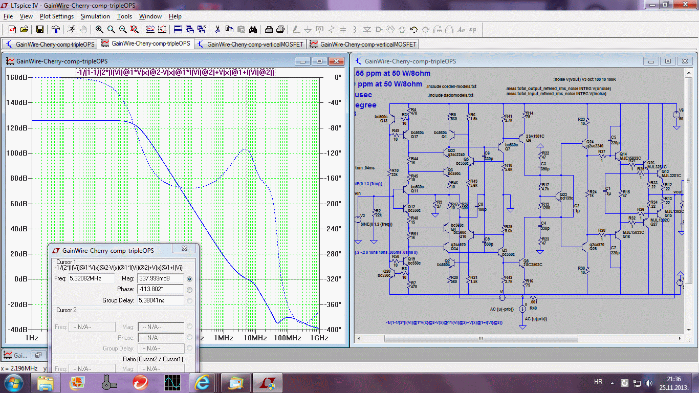

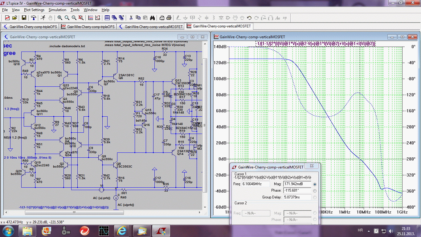

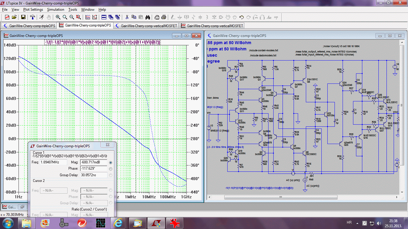

What was the ULGF in both cases?
Here are the square wave plots and Loop Gain plots for both amps, MOSFET and triple BJT.
I hope it's clear from the plots what was the ULGF.
Damir

I would sure like to know how that amplifier is supposed to have the almost no existent distortion numbers and could have anything like those square wave plots. Something doesn't compute here.
Oh, it does compute, I use computer you know.😀
