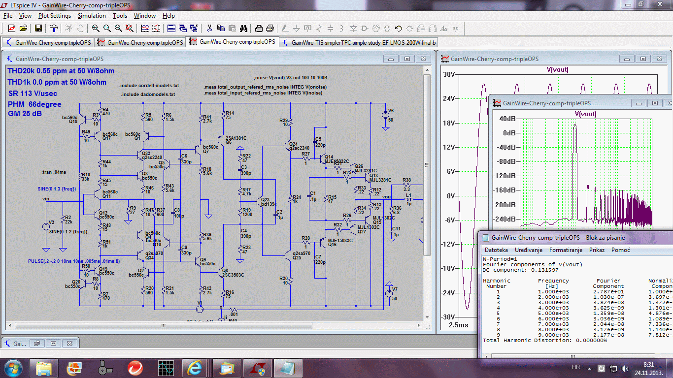

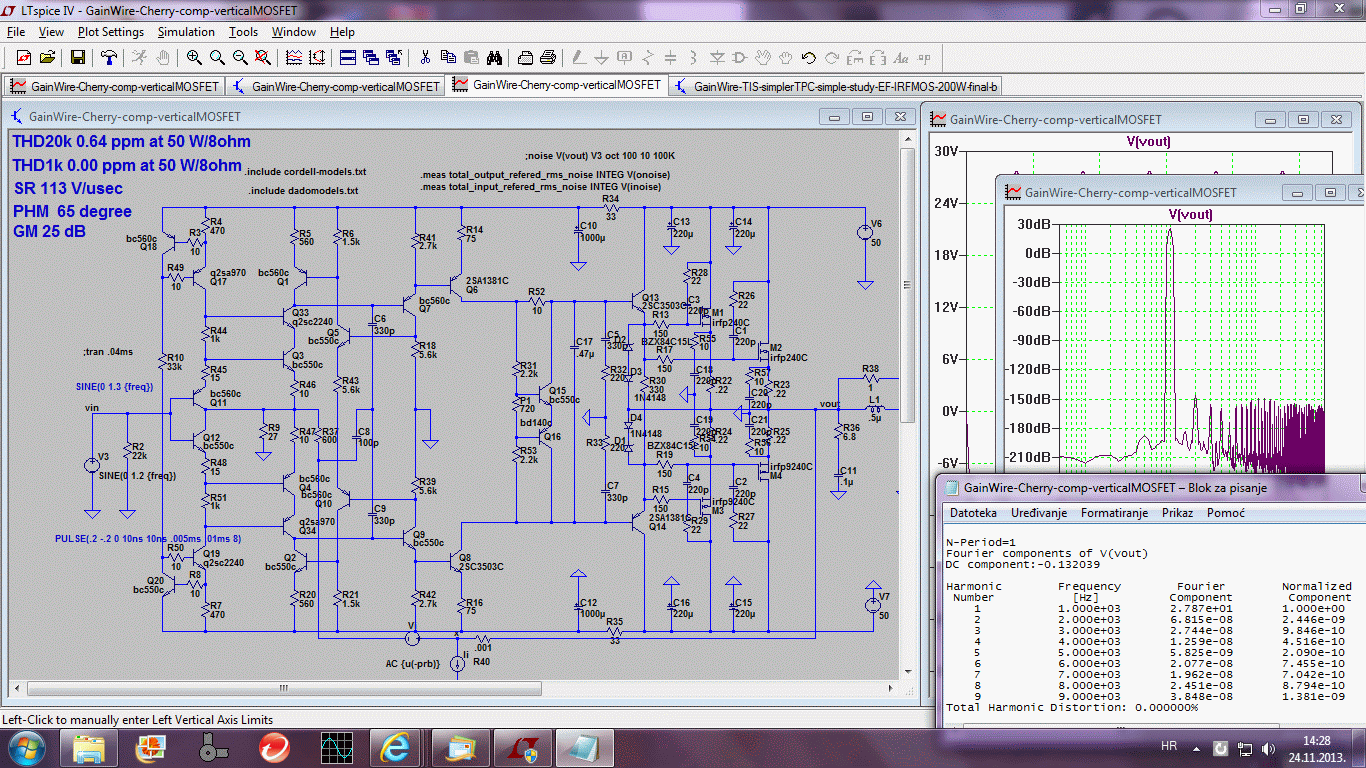

There you go, you`ve got your MAGIC number. What now?And this is with vertical MOSFET OPS. THD1k at 50W/8 ohm is 0.000000%.
It uses Cherry compensation with shunt compensation and 120 dB of NFB at 1 kHz.
Damir
I don't know, you've got any suggestion?
