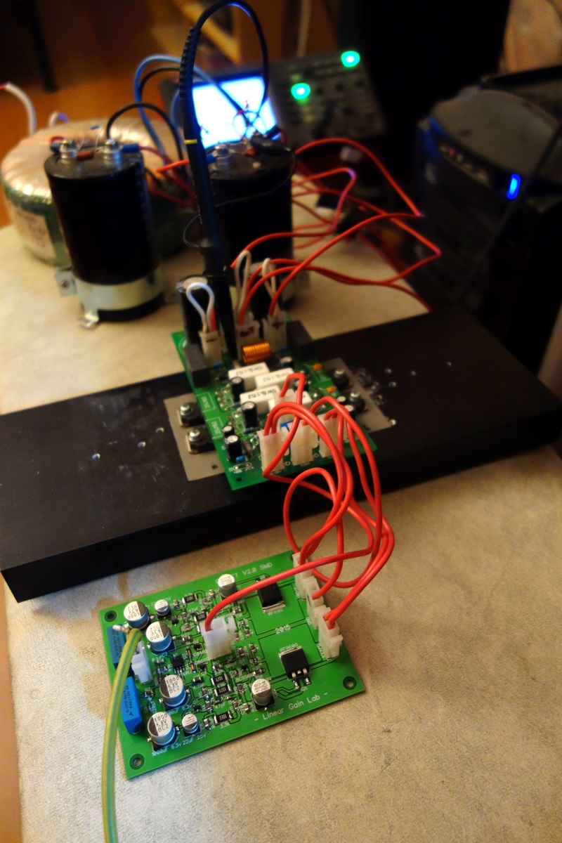

Done, tested!
OK. Soldered the FETs, pluged in, measured, listened - perfect!
Both channels are exactly the same. Surprise - no output "plop" at power on. Practically zero offset (some millivolts) right from the start. VAS FETs are very lightly warm.

Just noticed an interesting thing - didn't really notice it yesterday.
VAS runs at the higher quiescent current, than the one in TH version.
This one runs at 28mA now. Both channels. Well, fine with me, I don't even want to decrease it, OPS bias pot has got enough range to adapt to that and with such current it drives the OPS MOSFETS perfectly - their high input capacitance does not really matter any more.
But why? All the values are exactly the same in TH and SMT versions respectively. Must be some differences in Vbe / Vgs between the TH and SMT versions of the transistors.
Well, Nelson Pass runs those fets at 40mA. No problem. But I did not expect an increase for more than twice as much, comparing to the initial TH version...
Plays beautifully anyway 😉

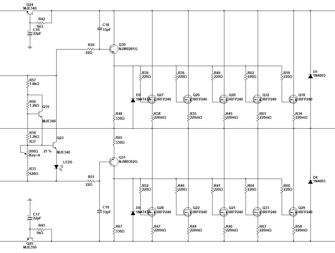

Nice work Valery!
Thank you, Valery. I will start laying out the PCB. I believe one can play with the value of R65 and even parallel a Diode and Cap for optimal performance. Is only Q19 to be mounted on one of the Output MOSFETs and is LED5 a Red one? Thanks again.
Yes, the LED is the red one. Q19 is mounted on the local heatsink with the drivers (Q30, Q31), Q23 is mounted on the main heatsink with all the MOSFETs. It's not necessary to mount it right on one of the MOSFETs - just touch the heatsink. I recommend to use the original Slewmaster layout as a basis for your PCB development - output section's arrangement is good there. Just modify the fragments that have changed (this is what I would do).
You can play with the value of R65 and even parallel a Diode and Cap for optimal performance, however it simulates pretty well even as is.
