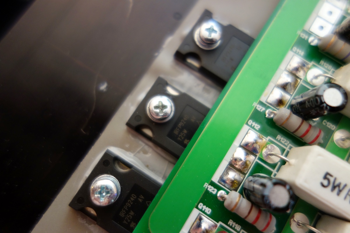

OK, the first one is done except the VAS MOSFETs - still waiting for Mouser to deliver. All the rest went pretty cool (the board is not cleaned from the flux yet). Got a jelly flux with very thin applicator - very useful, as it pretty much holds the part in place before it melts (the flux, not the part 😀). Also had to use a magnifying glass - especially when soldered 0603-package parts 🙂
So - waiting for the FETs, soldering the second channel board![]()
Looking good so far! I see you are soldering the hard way. An oven is much easier.
Well, I will probably come to the oven technology some day - will ask you some questions then 😉
The surface tension of the molten solder does all the alignment of the parts for you. You just need to get the lead touching the appropriate pad and the solder does the rest. I hated SMT until I figured that out.

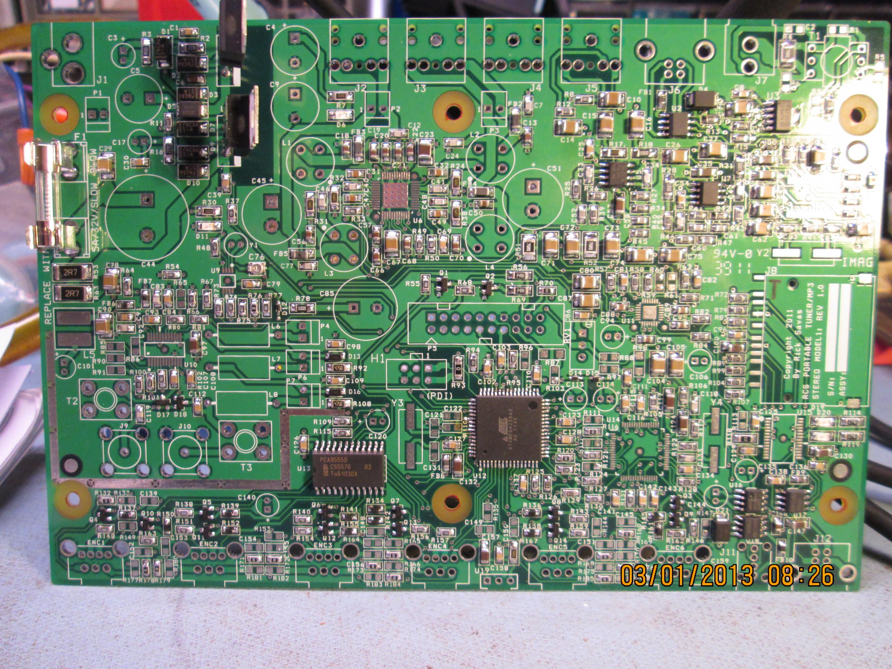

For you enjoyment, a pic of my last big project, (portable radio/media player) still working on software for it, now looking at FT800 graphics/touch screen display. Big leap from a 4x40 character LCD.

Wow! Impressive 🙂
I also like to design something on the edge of hardware and software. When it comes to implementation - SMT definitely helps
FT800 is a cool chip - I've seen some Arduino-compatible display boards, based on it.

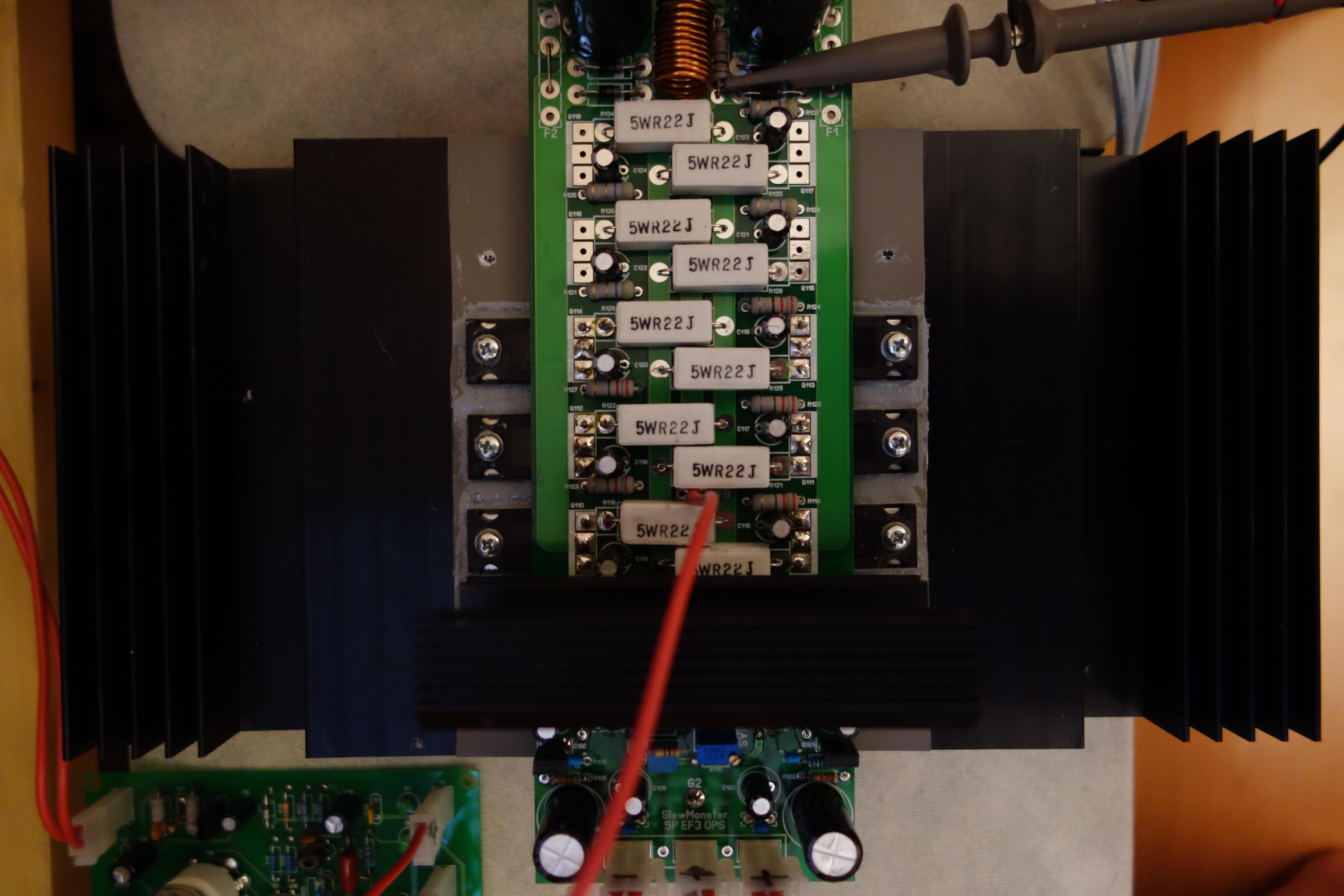

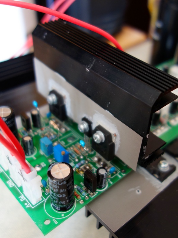

Here is my IRFP-based OPS. It is based on original Slewmaster PCBs. Sorry, I was too lazy for re-drawing it completely, so just replace BJTs with IRFP240/9240. Pinouts are fully compatible (BCE = GDS). I use two 1K resistors in parallel between the drivers' emitters, but you can use one 500R one (1W).
Thanks to Jason Kuetemann for assistance in adjustment of the spreader tempco for matching the one for IRFPs (adding the red LED was his idea).
You can use all 5 pairs if you like (I used 3 of them as it was enough for the purpose at that time). C10 (1uF) stays in place.
Valery

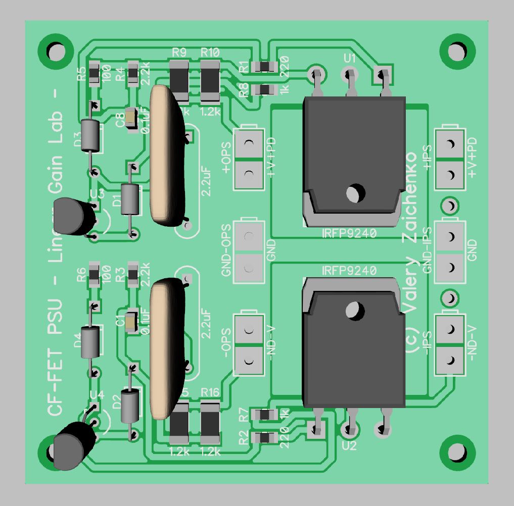

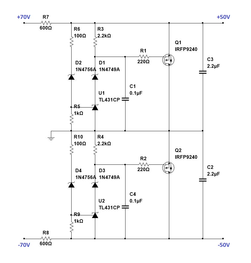

Shuntie
For high-quality builds I have designed a high-precision shunt regulator for the front-end. Not tested live yet, however simulation shows ripple reduction for more than 100db. Sort of "virtual battery".
The idea is to power the OPS with +/-70V, then the rails are slightly filtered with the cap multipliers on OPS boards and go to the shunt regulator. Front-ends are powered with heavily filtered +/-50V from Shuntie.
Valery

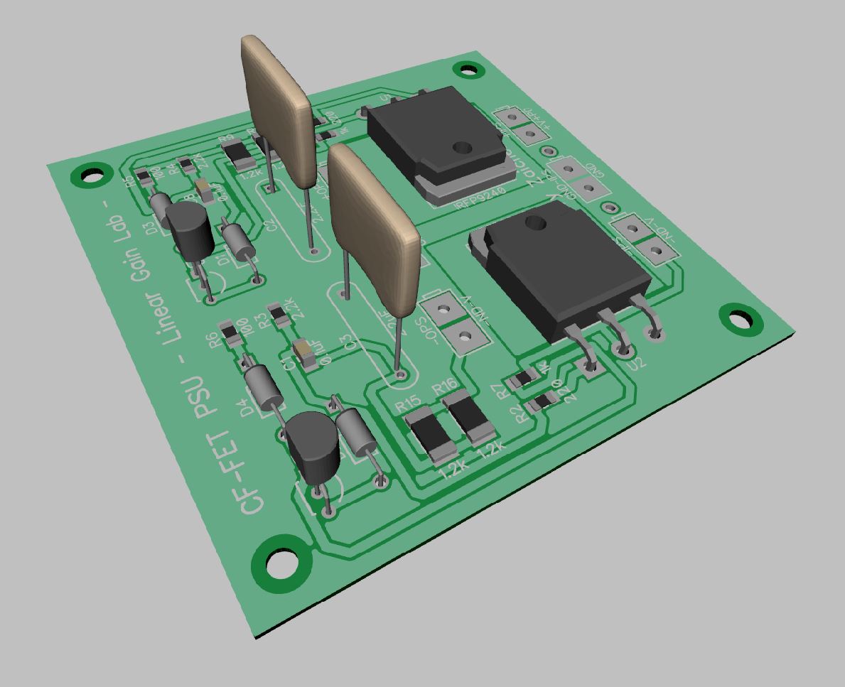

Combination of TH and SMD...
Nice. Would be interested in GB boards when and if ...
I have ordered a couple of boards - let me test it before I send you the gerbers.
