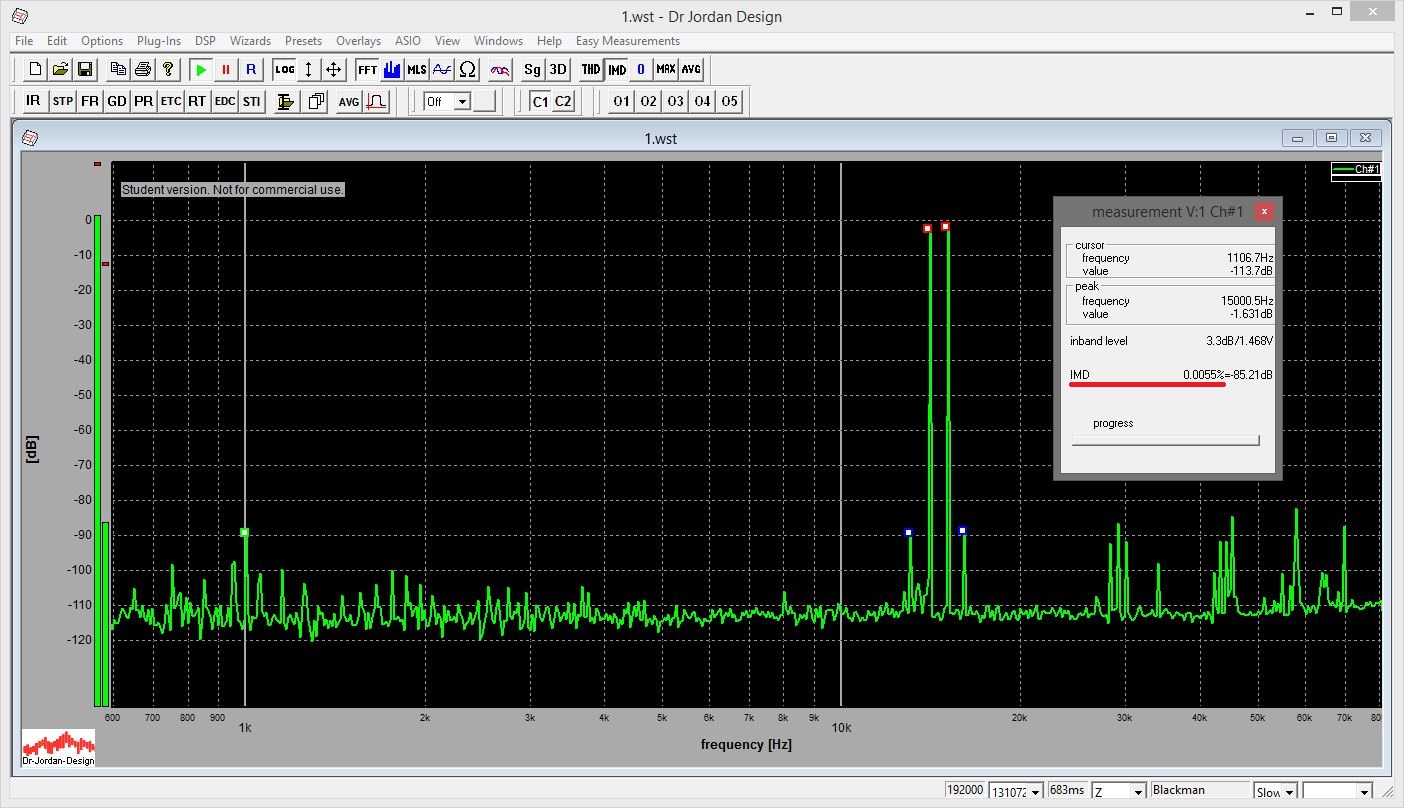

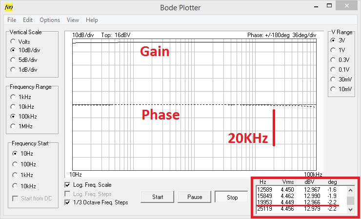

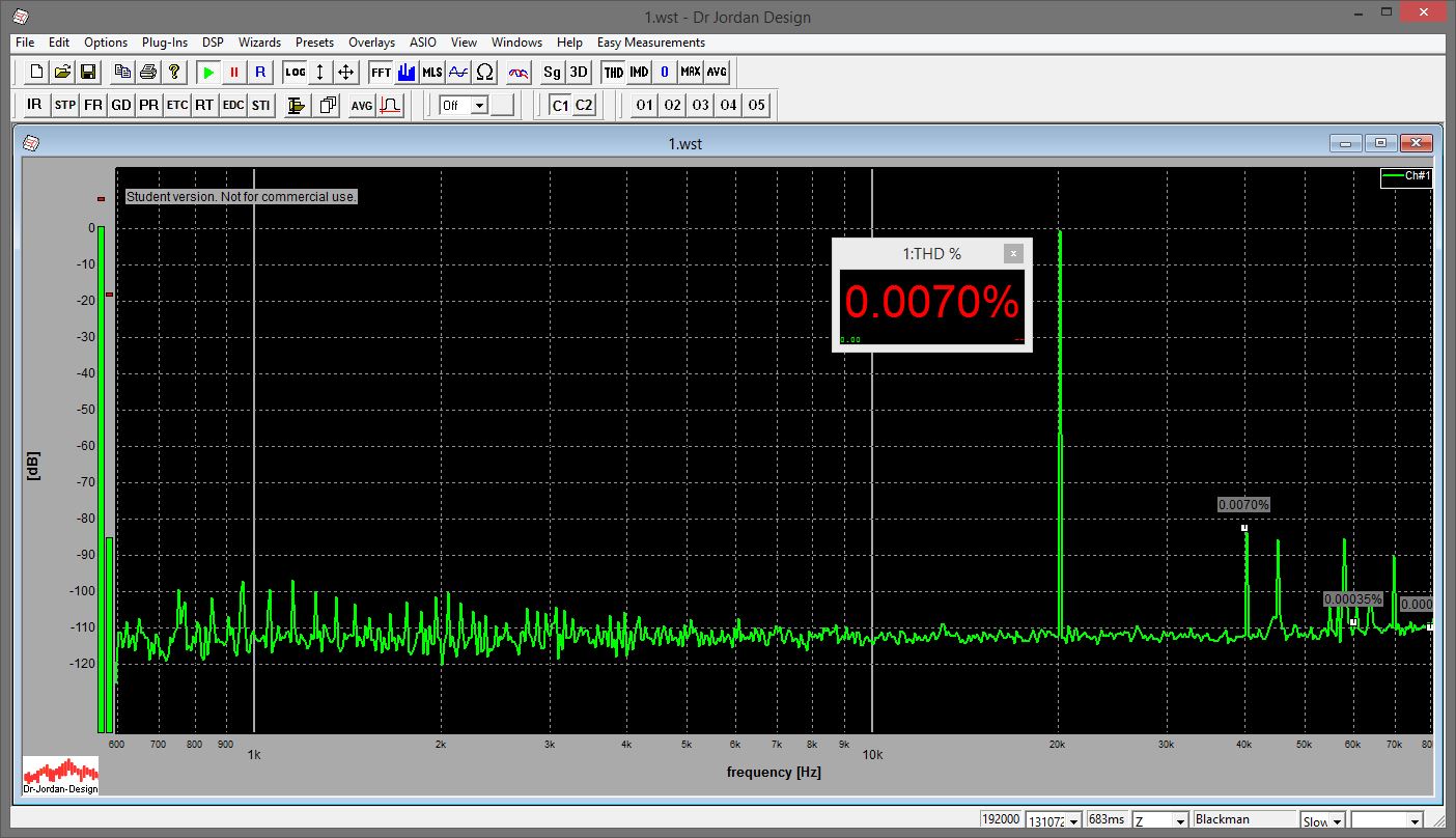

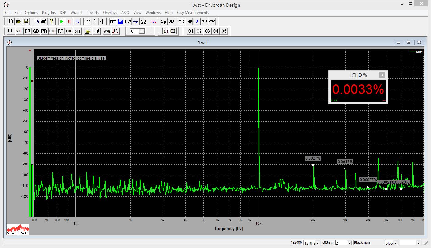

Hello All,

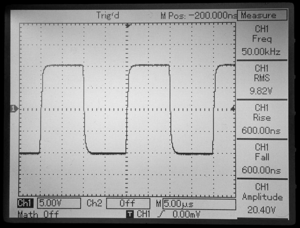

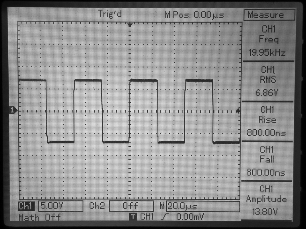

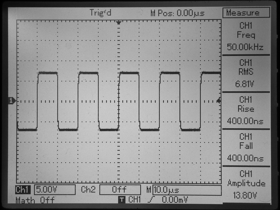

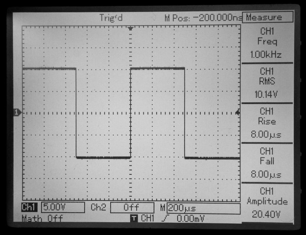

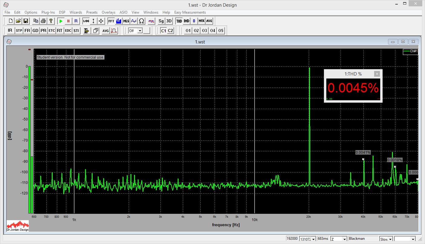

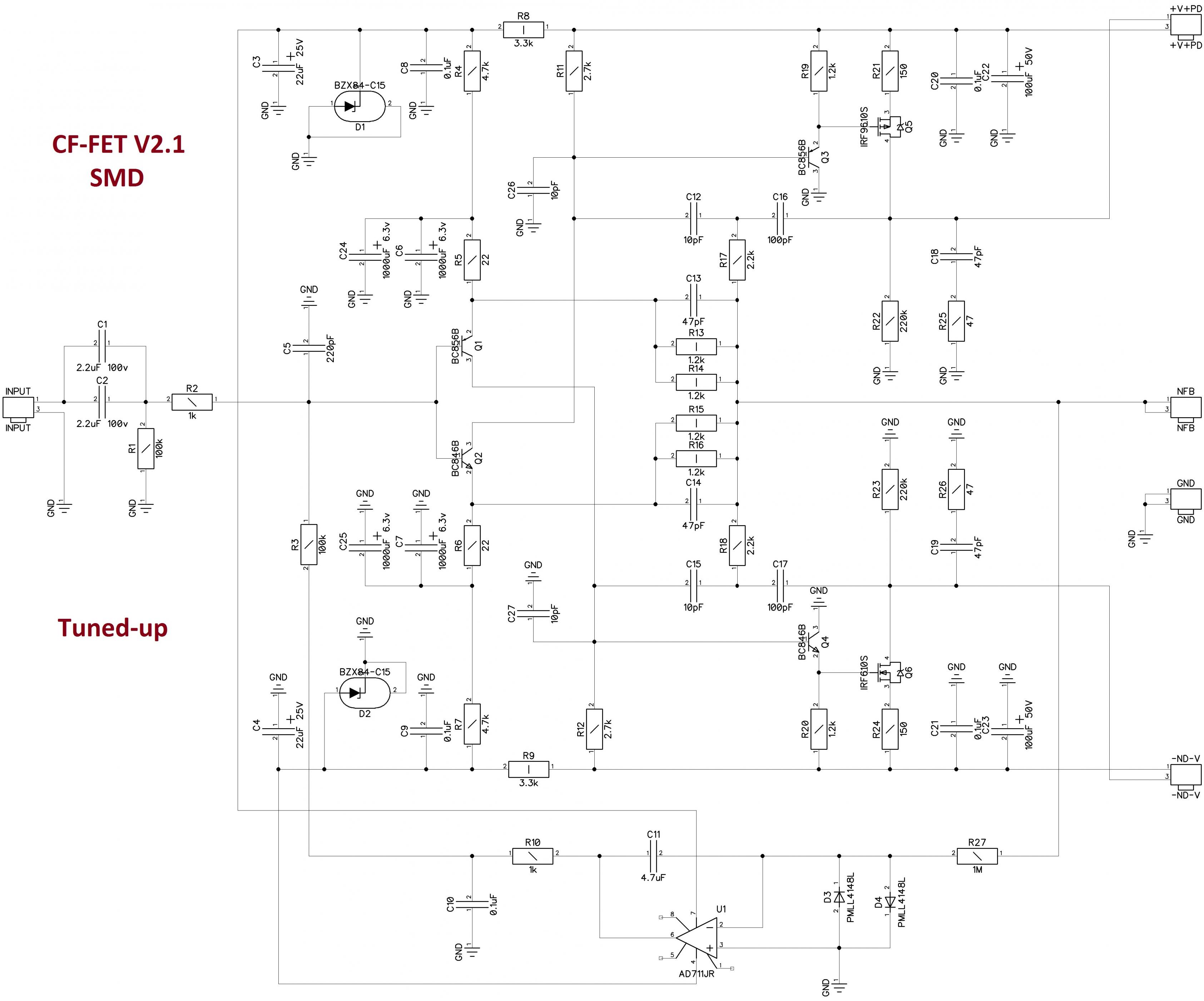

Added two 10pF caps to compensation scheme (C26, C27). R21, R24 = 150R (10.5mA VAS current).

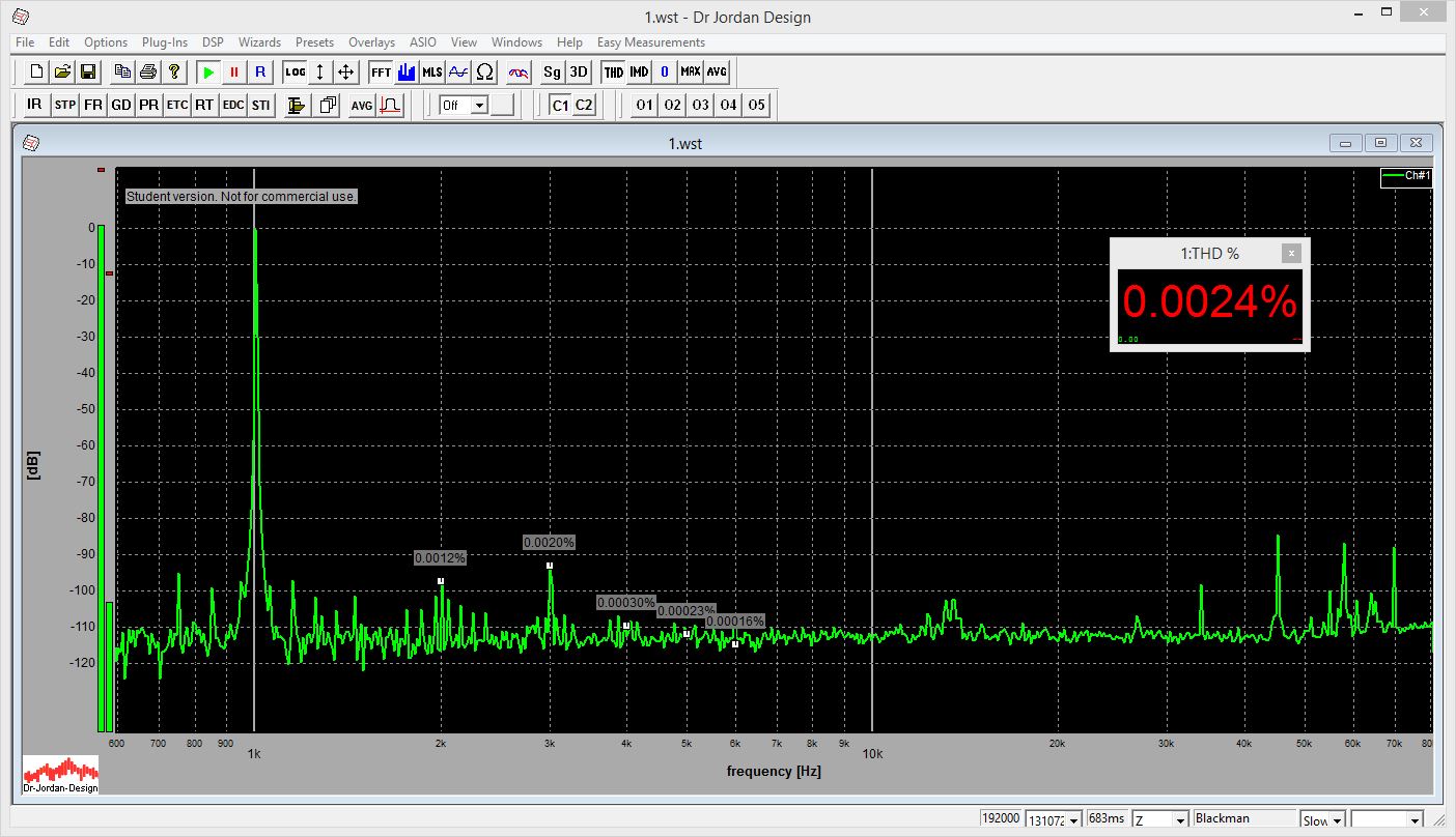

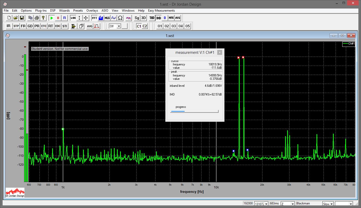

Key measurements are presented below (again, in combination with directly-driven two pairs of Renesas' 2SK1058/2SJ162 Lateral FETs). All FFT spectrums are measured at 4V RMS @ 8R, square waves are 20V amplitude at the same 8R. Practically no harmonics above the 3-rd one. Note excellent phase response within the audio bandwidth. All measurements are done with the input RF filter in place - otherwise the corners would be even sharper.
I have tried measuring the same things with 6 Ohm real speaker (Monitor Audio RS-8) - practically no difference. THD is increased by less than 0.001% due to the higher load - that's it. Square waves are exactly the same.
I am more than satisfied with the results. Next move - building an SMD version. Most of the components are already in hand except the VAS FETs, coming from Mouser. Looking forward to building it

Hello All,

Impressive performance from a 10-transistors amplifier (6 in IPS + 4 in OPS).

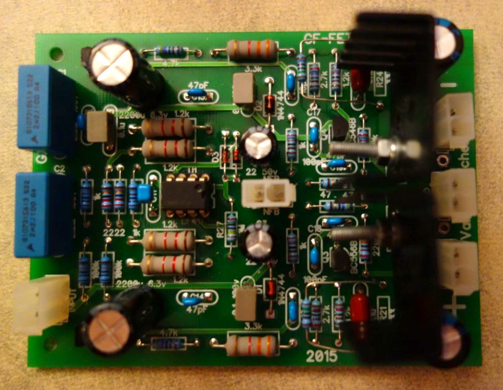

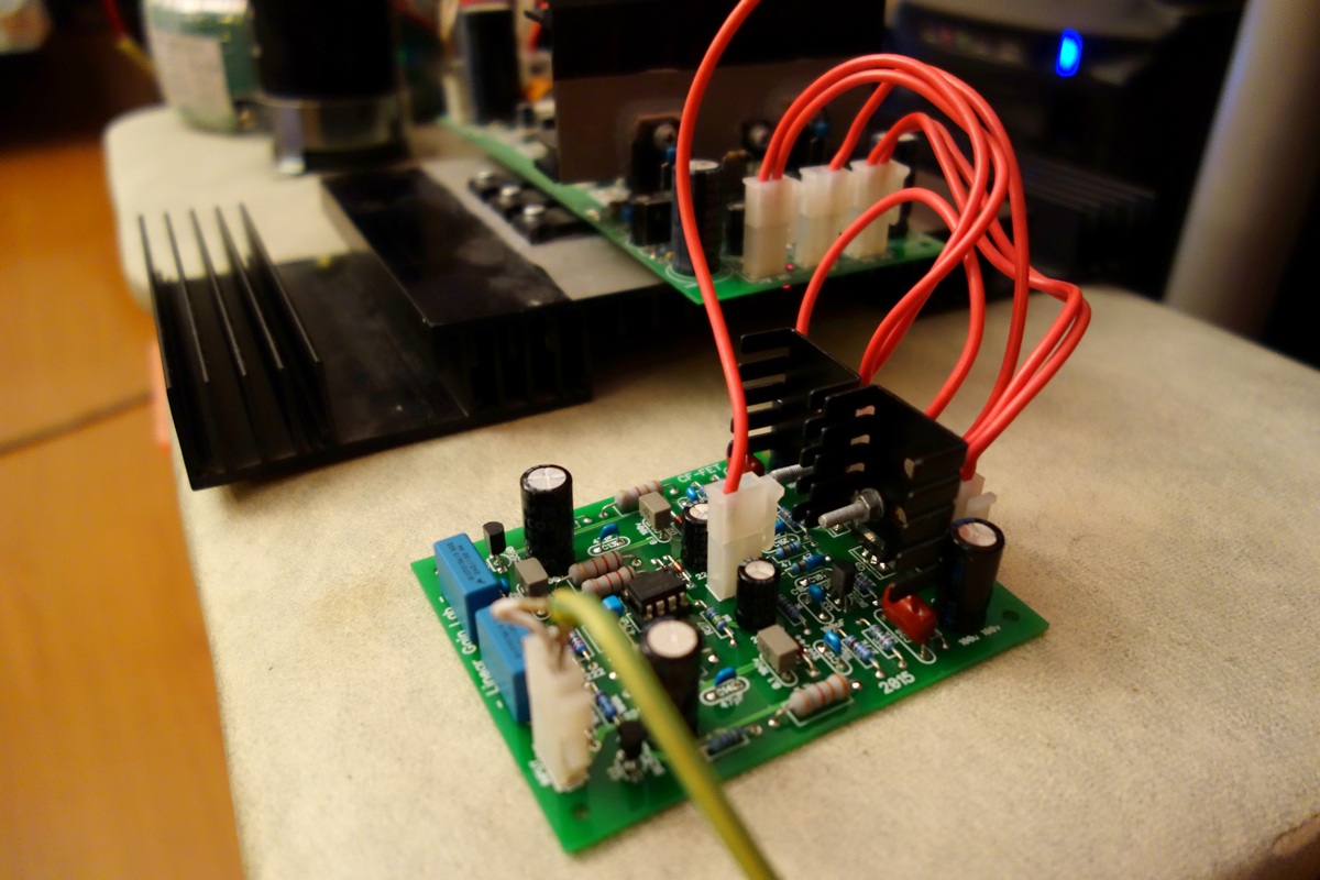

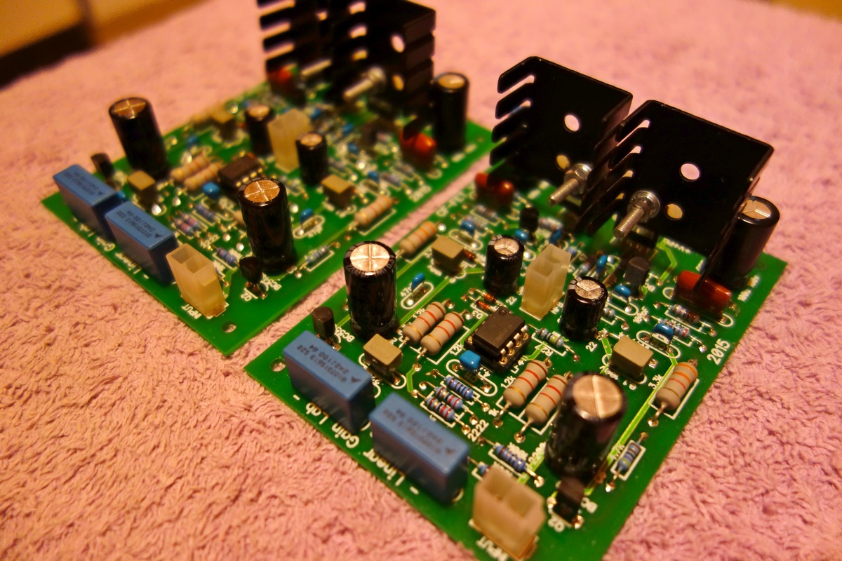

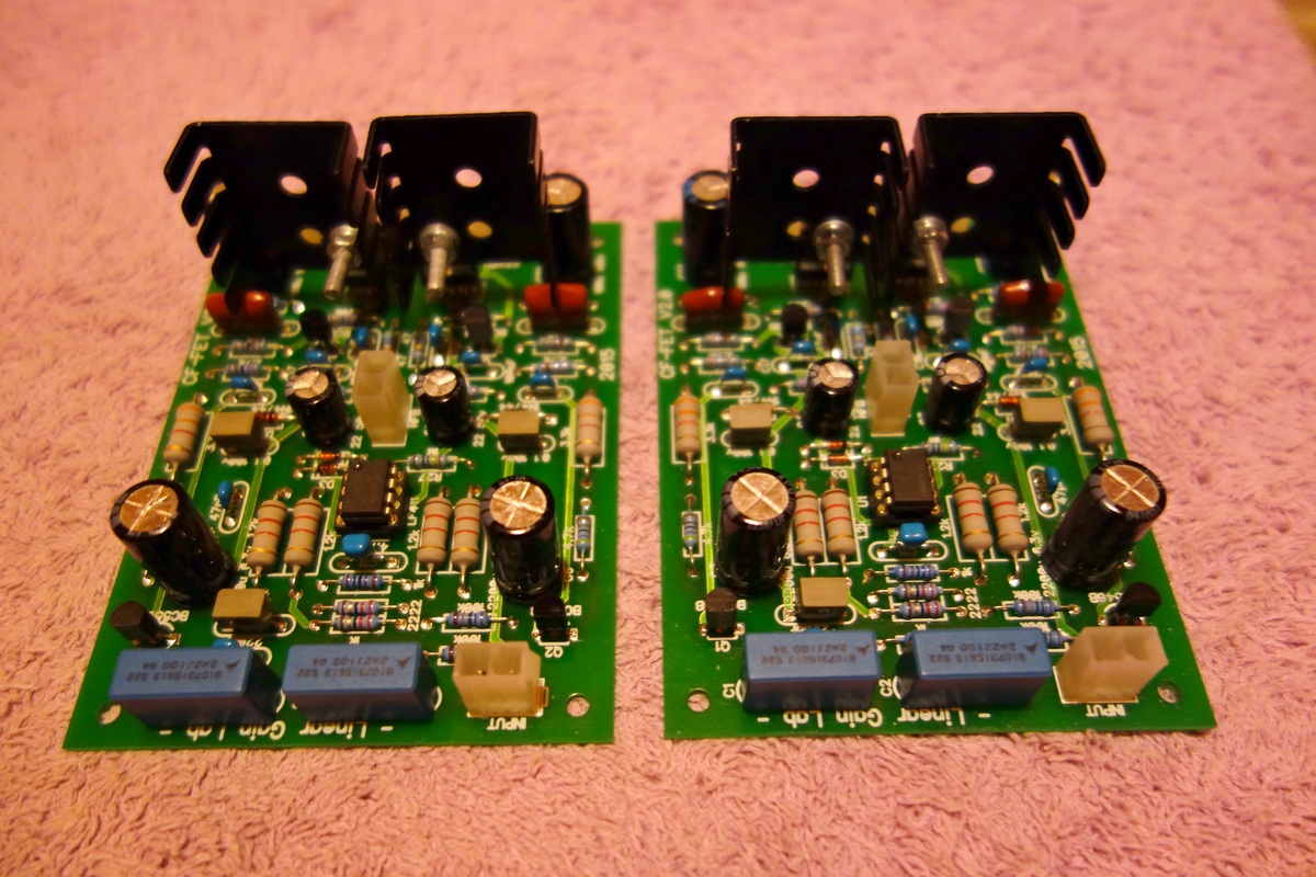

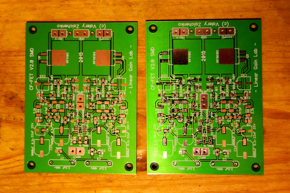

Measured the second channel. Exactly the same. Same PCB, same components - soldered, switched on - that's it.
At least the TH version is sort of "productized" 🙂

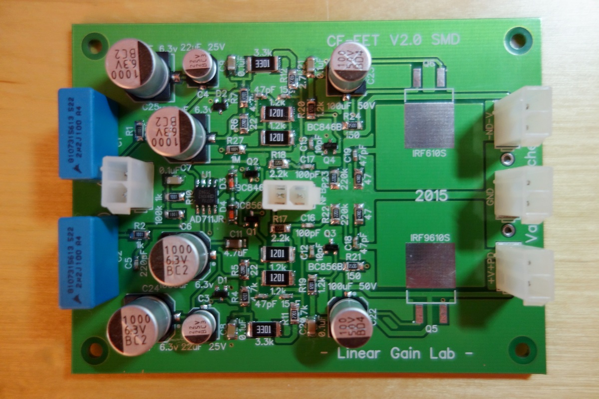

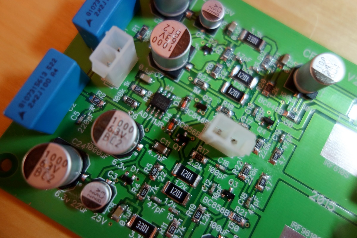

Got the most of SMD parts. They look scary 😛 Most of them are very small 🙄 Ordering the PCBs...

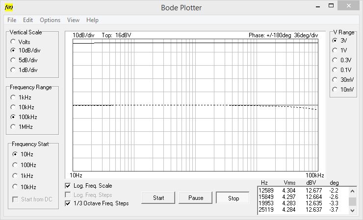

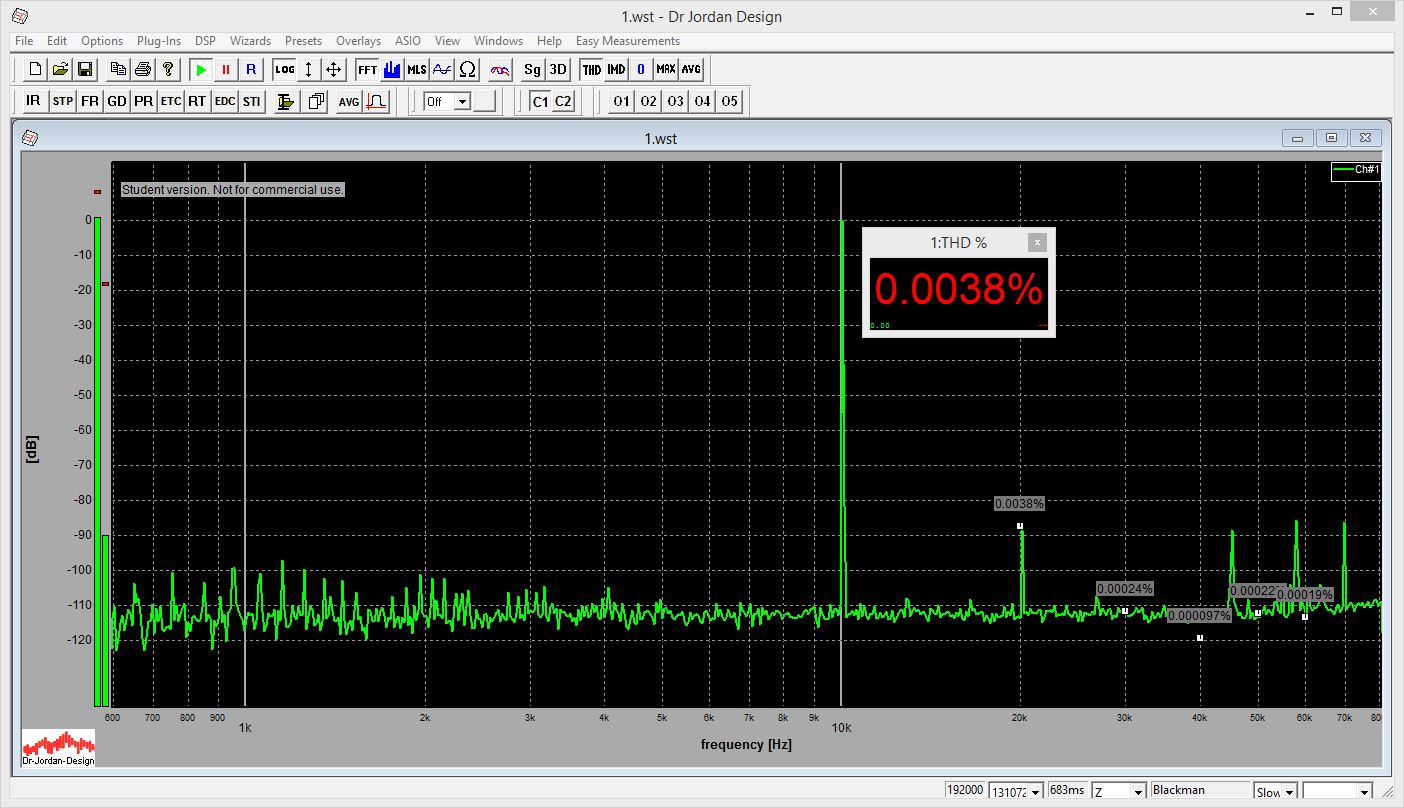

Tested with HEex-FET OPS

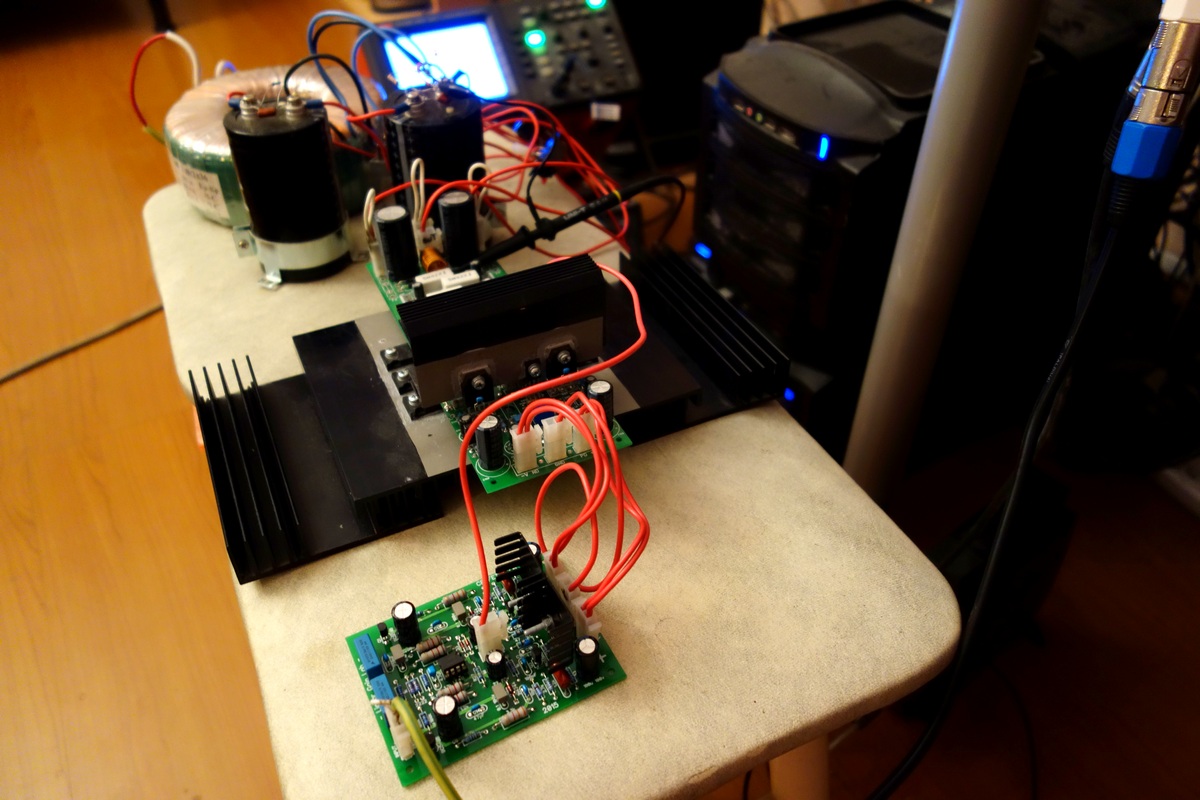

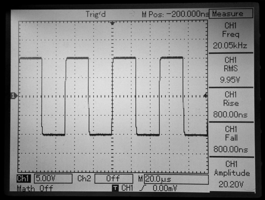

While waiting for SMD PCBs and VAS MOSFETs, tested the TH version with Slewmaster-based IRFP240/9240 Hex-FET (3 pairs) OPS.
Interesting results...
Slightly more accurate square waves.
Slightly higher phase shift @ 20KHz (3.3 degrees against 2.2 degrees).
Looking at the spectrums, 3-rd harmonic and above are simply not there.
However, 2-nd harmonic is lower @ 1KHz, but slightly higher @ 10-20KHz.
Also, with 3-5 pairs, this one is capable of delivering enormous currents. 4 ohm and even 2 ohm (with 5 pairs) loads - no problem.
Overall - cool performance. At normal listening volumes it's not really possible to distinguish between Lat-FET and Hex-FET OPS boards here.
Valery

Hi Val did you finish The smd version, if so Can you tell a little of The SMD IRF's are they matching Well ..?
Hi Michael,
Not yet - PCBs are expected to come in a couple of days and I will start soldering them.
However, IRFs are coming from Mouser, and it will take at least 2-3 weeks for them to arrive.
So, the most interesting parts are the "longest" ones 🙂
I will report on the progress.
Valery

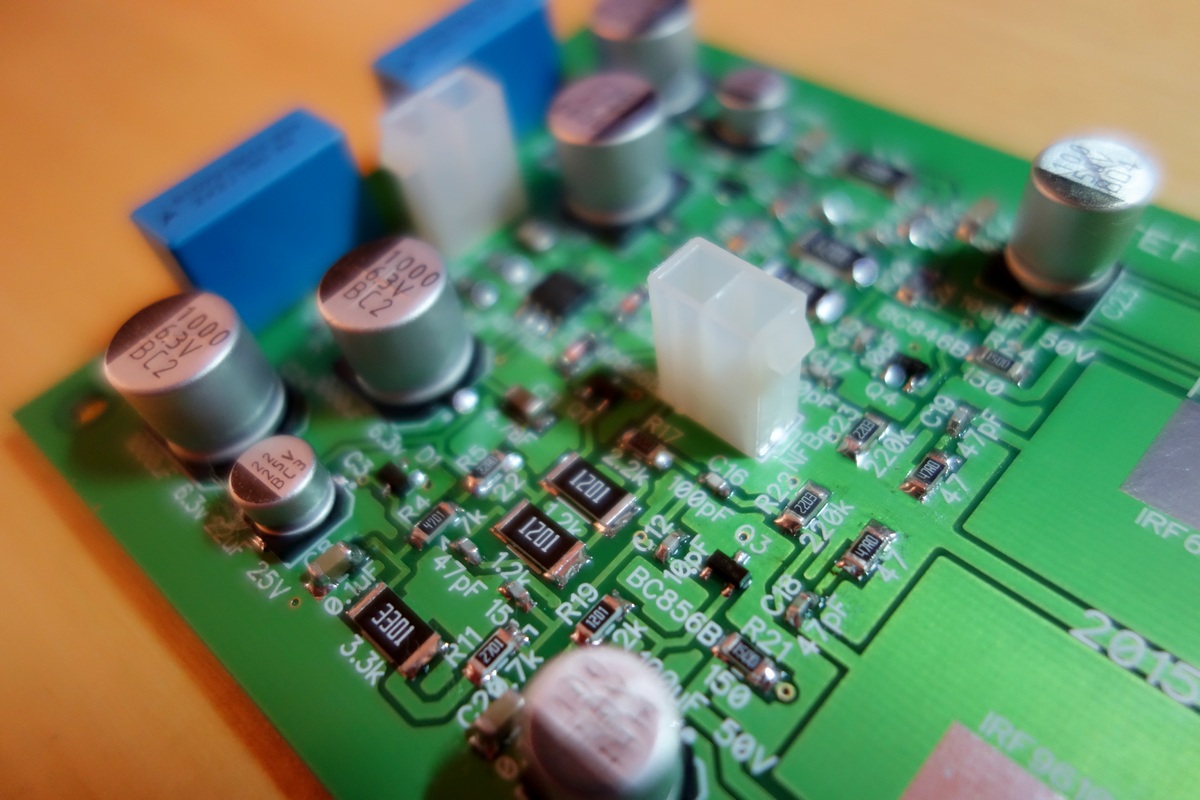

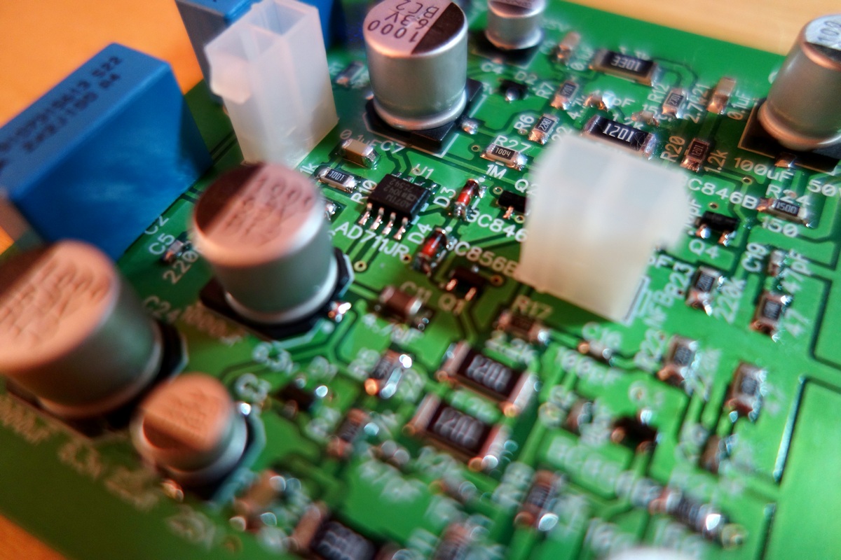

Not as difficult as expected 🙂
OK, the first one is done except the VAS MOSFETs - still waiting for Mouser to deliver. All the rest went pretty cool (the board is not cleaned from the flux yet). Got a jelly flux with very thin applicator - very useful, as it pretty much holds the part in place before it melts (the flux, not the part 😀). Also had to use a magnifying glass - especially when soldered 0603-package parts 🙂
So - waiting for the FETs, soldering the second channel board
