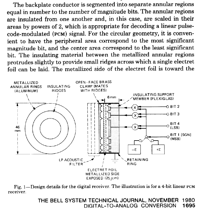

If a truly "digital loudspeaker" were possible
OK - if you want red book 16 bit as your base standard, that involves radiating areas between MSB and LSB in the ratio ~66,000:1 (2^16). A pretty tough ask.
Three or four bits, possibly. 16 bits not a snowball's chance. And by the time you get to 24 bit - area ratio of 16 million:1?

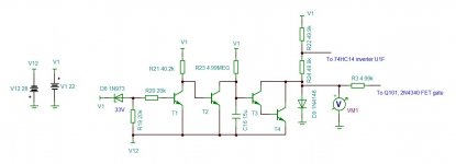

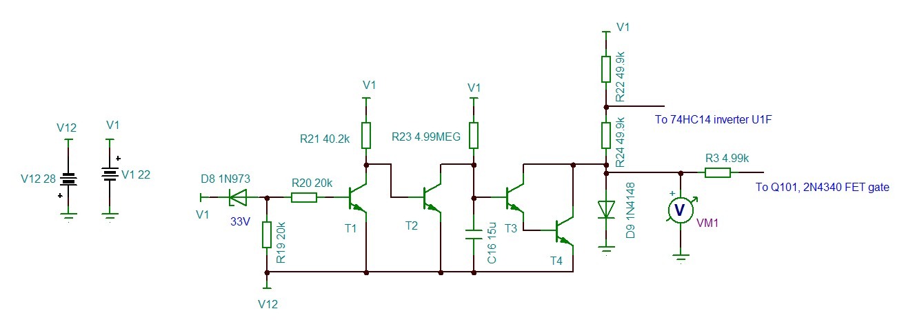

As part of understanding some of the subtleties of Burwen's design, I set to get to grips with the turn on delay to let the thing wake up before connecting the signal feeding the output drivers. The schematic is attached along with the two key signals.
V12 is the unregulated incoming -28V line, and V1 is the regulated +22V line.
T1 and T2 and associated circuit are to ensure that C16 is initially discharged. After which C16 charges up via R23. That only needs to charge by 1.2V (the two Vbe drops of the Darlington pair T3/T4). The switching time is C x (2Vbe)/I . Now I is set by 4.99M resistor R23. That has V12+V1 = 50V across it, and so passed 10uA. So the predicted switching time is 1.8 seconds. Simulation gives 1.7 seconds, so good agreement.
That is at odds with Burwen's description which says a 5 second delay. Obviously by increasing R23 or C16 you can set whatever delay you want. 47u instead of 15u gives close to 5 second delay.

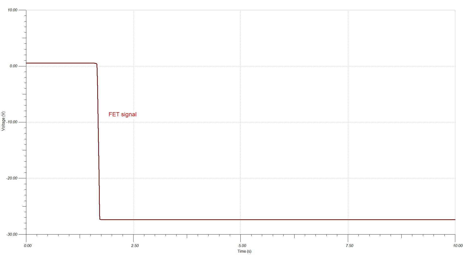

One output feeds the FET clamp. That goes from ~0.6V (set by D9, and switching the FET hard on) to close to -28V to turn it hard off. Since the 2N4340 FET has a Vgs(max) of -50V that negative drive voltage is fine.

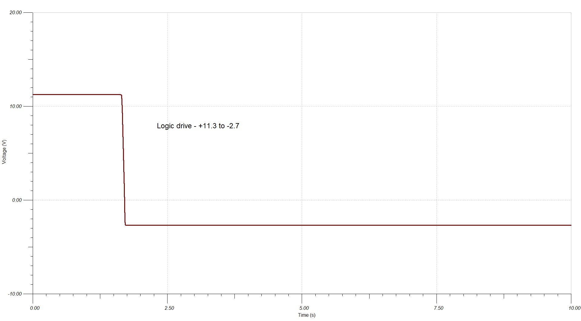

There is also a line that goes to a logic inverter (that feeds a CMOS analog switch). I chased my tail for a while, because, as you can see from the signal, it goes from +11.3V to -2.7V - surely way outside TTL logic levels. However, again Burwen subtlety, the 49.9k resistors R22 and R24 limit the current into the protection diode clamps in the logic inverter. These are specified at +/-20mA max for HC TTL. R22 and R24 limit that current to +400uA and -88uA, so well within the specified limit, and the inverter operates perfectly.
The logic used is CMOS not TTL.
