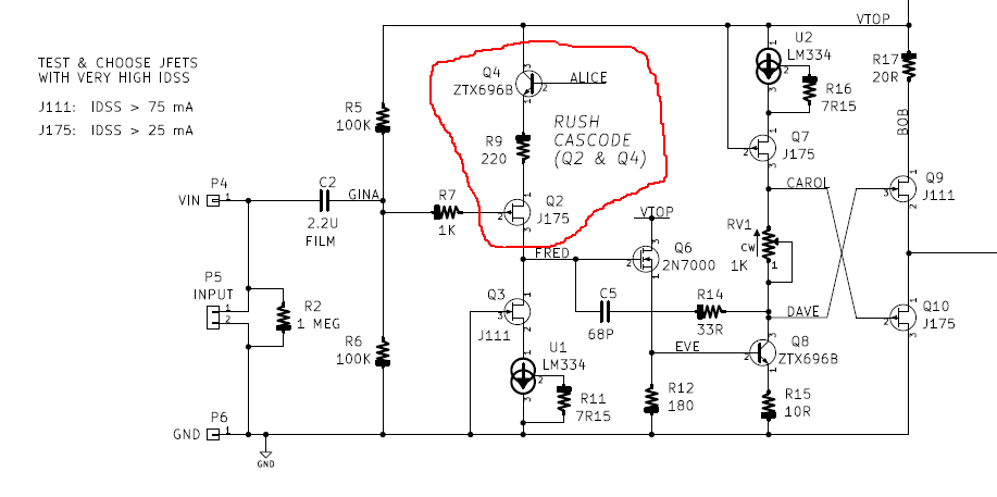

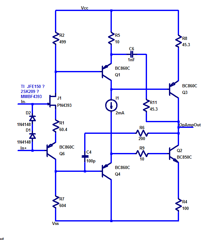

The J511 and equivalents have an impedance of around 120k with 25V across them.

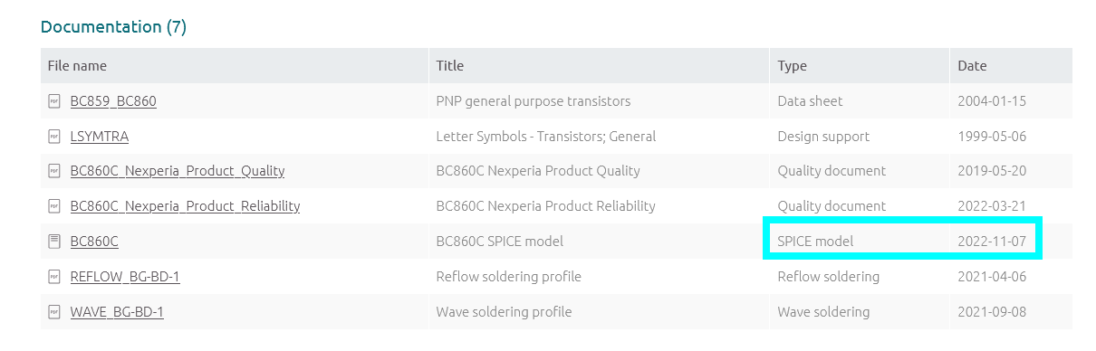

When I measured the Early voltage of a BC860C (like Q1 in the OTA), I got 41 volts. The tables in 3rd edition of The Art Of Electronics say 30 volts (which is worse) for the BC860.
rout = (Vearly + Vce) / Ice
at 2mA, the collector impedance is 21.5K or 16K depending on which Early voltage you use. The 10 ohm emitter degeneration resistor R5 is less than Q1's internal emitter impedance (1/gm = about 13 ohms) so the degeneration increases Q1's output impedance by less than a factor of two. It is far less than 120K. So there is little benefit to increasing the impedance of the 2mA current source above 120K; it will have very little impact upon the Q1 stage gain.
And all of that assumes Q3's input impedance is infinity, which is not correct.
_
The output impedance is roughly hoe/2, typically around 50k. So it looks like a current source with 50k in parallel.
Not infinity for sure. But pretty high by comparison to the external impedances connected.
hoe is terrible for the BC860C, about a factor of four below "typical" small signal devices. Run it at Ic=2mA using the SPICE model on the manufacturer's website (link) and you'll see that Nexperia agrees with Horowitz and Hill's measurements, and also with my own: BC860C has got awfully low output impedance.
_
_
Agreed entirely. I wouldn't use them for the output devices. Not sure what the hoe for the specified devices that the OTA-1 used. There were at least two and possibly three different devices used, presumably because they were obsoleted. The last ones were the 2N5321 and 2N5323, which are still available. I've searched the old databooks I have and googled - but I can't find what the hoe is.
OK - I found some characteristic curves in the 1975 RCA databook for the 2N5321 and 2N5323 http://ftpmirror.your.org/pub/misc/bitsavers/pdf/rca/_dataBooks/1975_RCA_Power_Transistors.pdf . That suggest that the Early voltage is about 1000V for these; the curves are so flat it is of course subject to some error. But since hoe ~ VA/Ic that comes out at about 1Mohm/mA. So for 5mA that would be hoe ~ 200k, so the NPN and PNP together would be about 100k.
Of course, in the end you take an OTA and load it with a resistor, so it ends up essentially being a voltage amplifier.
Of course who can say if current production devices have the same characteristics. I might buy a few and run them on the curve tracer and see.
Anyway, they look to be quite a lot better than the BC860C and complement with VA ~30V.

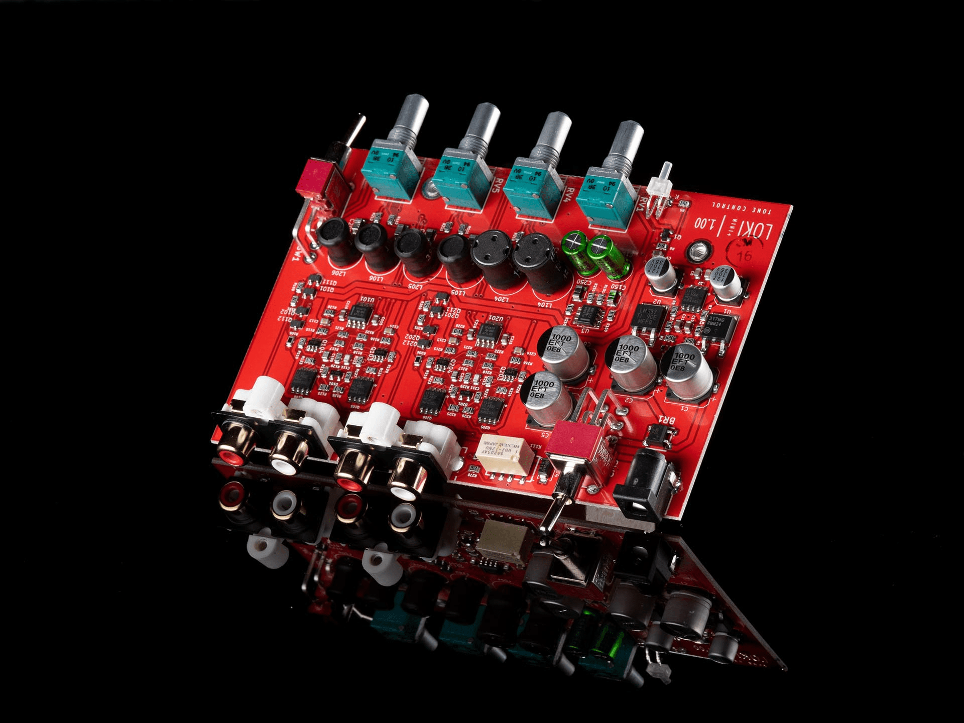

I was intrigued by the shiit loki mini circuit description, and when i have seen one b-stock on sale, could not resist.Yes, I'm aware of the Schiit unit. It has 7 opamps. Image from Schiit's own website. I think the lowest frequency band is a gyrator,
And it is a bargain, it has to be said.
It does sound great. Off course 4bands are no substitute for 31bands of ultracurve i normally use.
Since most of my speakers are flat through midrange and highs, not much eq is needed there, mainly gentle tilt.
However, below 200Hz, room is requireing steeper eq than shiit offers.
So, i will still need behringer for 20 to 200Hz, and should be ok with 3 or 4 bands on top.

Also I have spend too much time converting the OTA circuit to a workable (at least in TLSpice) opamp. Really like the tailless input with the fet and the bjt.
Gives quite low and predominantly 2. order distortion ...... think I'll do a pcb for it, even though I highly doubt it will sound different or better than modern opamps like OPA1642 ... but is a fun project 😉

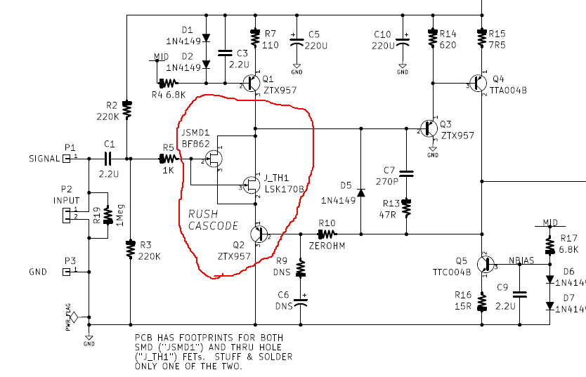

It's a Rush Cascode using a JFET and a BJT. Tubecad.com calls the configuration a "Bastode" and/or a "Retrogade Cascode".
I used Rush cascodes in a couple of Ship Of Theseus "Front End" boards: Kitty Hawk and Hornet. Full schematics, PCB Gerber files, and circuit descriptions are on the Forums, just use Search.

Cool 🙂 ...... thought it was called tailless pair, after reading these:
https://www.4qdtec.com/pwramp.html
https://www.4qdtec.com/preamp.html
But much more hits on Rush Cascode
.... just realize it was used in NAD3020 phono input .... thought I had seen it before 😉
