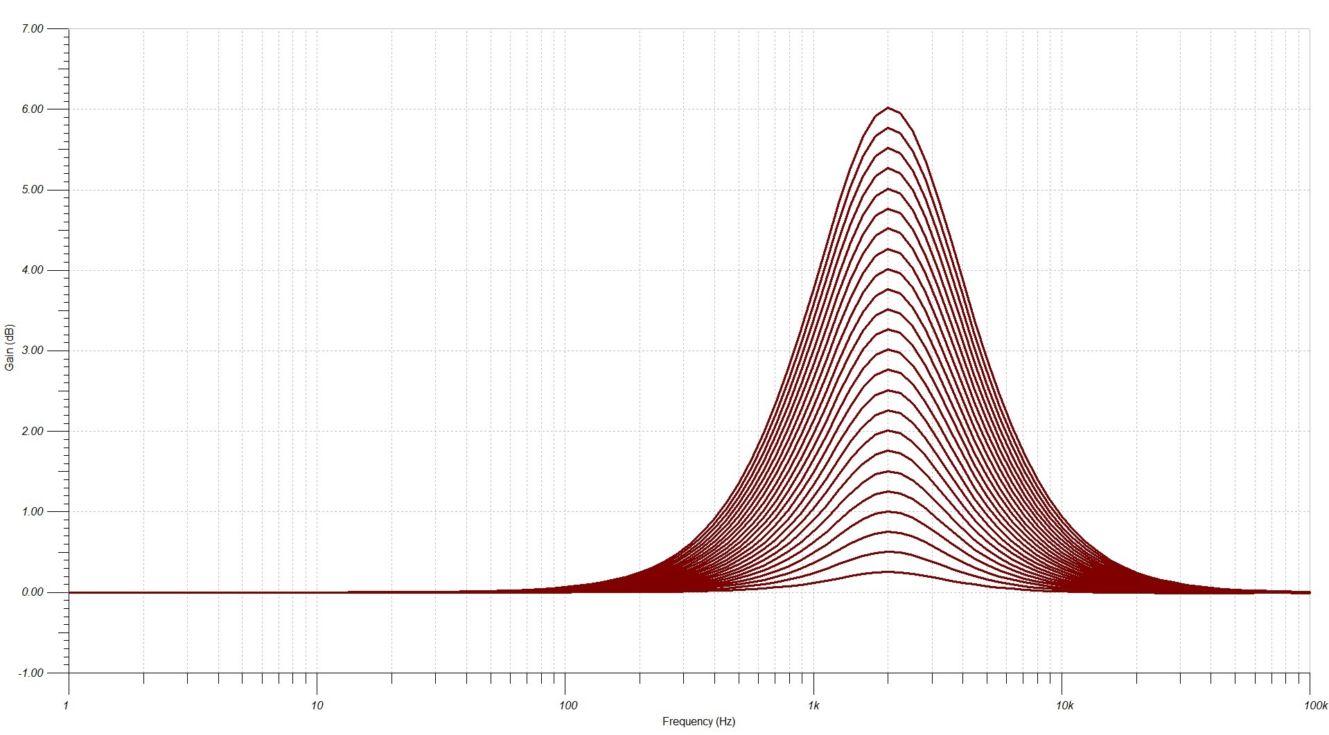

Well that is interesting. I've put all the switched data that Charles kindly supplied into my model. The critical design attribute is that the center frequencies (120Hz, 500Hz, 2kHz and 5kHz) have a grounded center tap. That makes those bands constant Q. The outer bands (15Hz and 25kHz) do not have a center tap and are variable Q.
If you remove the grounded tap on the middle four filters, the step size goes totally whacky. So the design resistor values were worked out with a center tap.
Just to show what I'm talking about is the response of the 2kHz filter, attached. Again just boost (cut is identical response, just subtractive).

Very interesting. So at the frequency extremes, does the Q decrease (implying greater bandwidth) as the boost/cut levels increase? If so, I'd opine that this is a "good" idea sonically. Now, does this / can this also apply to the National Handbook circuit (all paralleled filters)?
OK - the only National/Cello Pre control with a 10k pot is the 20kHz one. So I grafted in one of the Audio Palette 10k switched resistors to the Palette Pre model.
With the center tap grounded, the frequency sweeps as you adjust the control. Which is useless. So that is an idea that does not work with that circuit.
Leaving off the tap ground the control does what is expected, but the steps are wrong - so a switched resistor would have to be designed for the impedances in the Cello Preamp, and with the correct step size.
For the Audio Palette the 15Hz/25kHz the initial few steps have very low Q (about 0.3). The Q increases as you advance the control to about 2 at maximum boost/cut. So the bandwidth stays roughly constant
Everything in-between operates with constant Q (or very close to).
