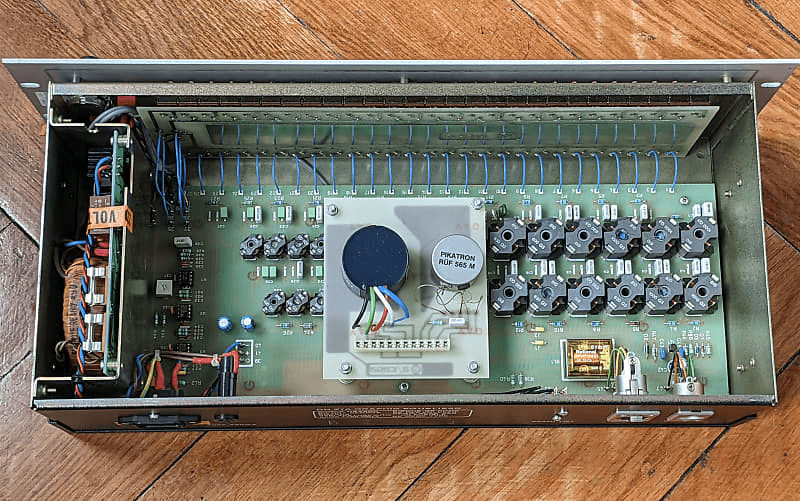

Is it the Klark Technik that you are talking about is the DN27A? Or are you thinking about another unit?
Due to work commitments at AMR/iFI this never saw the light.
A commercial realisation with OPA, Gyrators for LF and Inductors for MF was planned for the iFI Zen series, Together with a Tube preamp based on the original iTube and other products.
Sadly my departure meant these items are now unlikely to see the light of day, unless I can find a production partner.
And yes, Klark Technik DN27 is an example of the inductors.

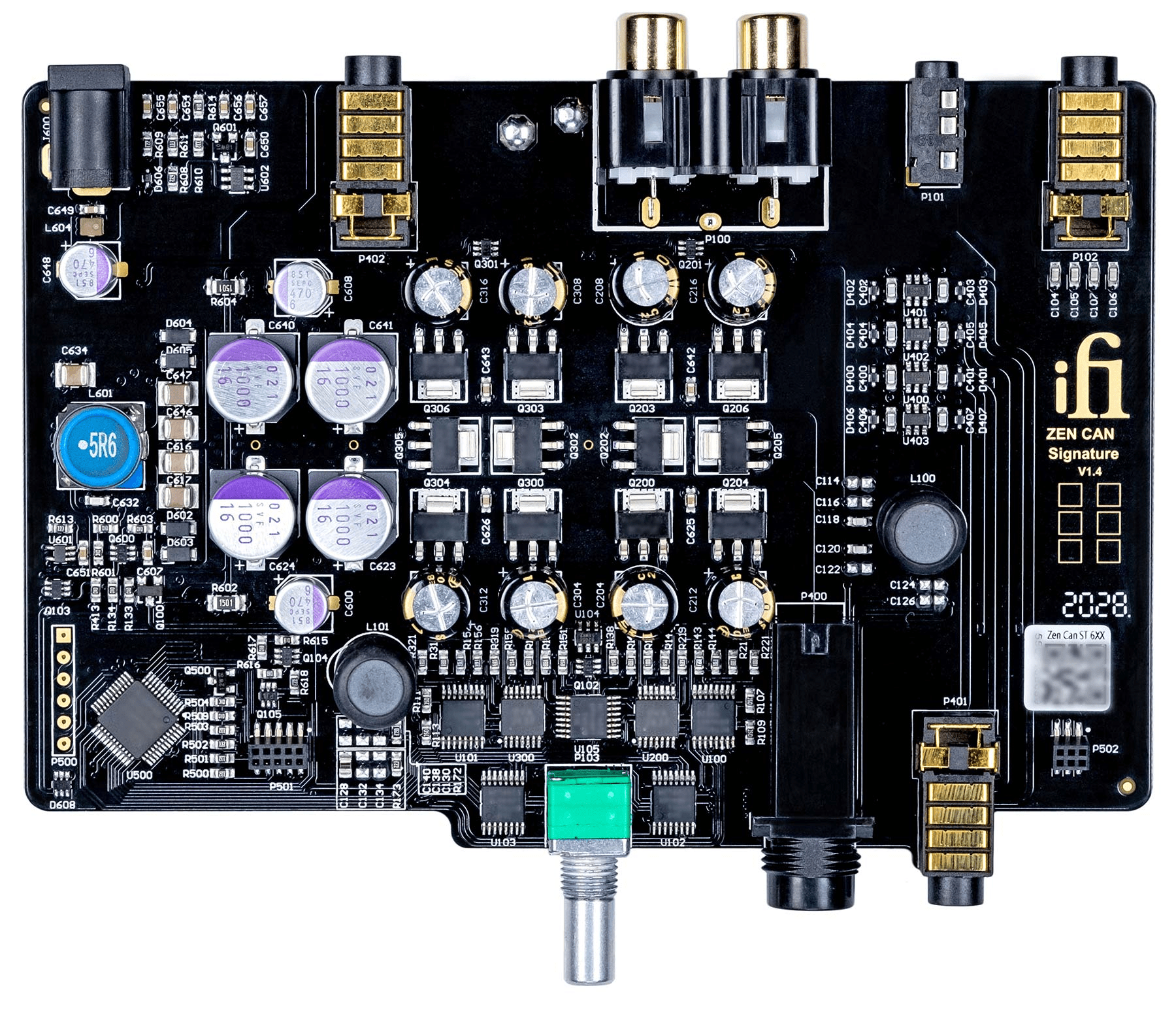

The cores used (we call then schalenkern in German) are shielded. Other Inductors may or may not be, but a few mm distance limit any coupling to unimportant. I used them in the headphone specific EQ in the iFi ZenCAN:
See L100/L101...

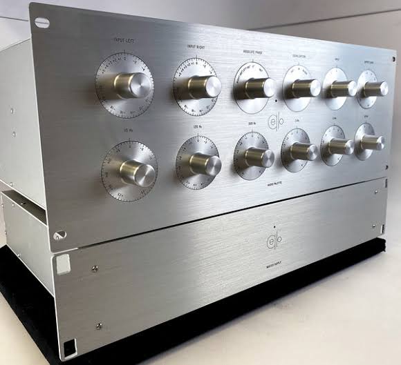

One of the keys to precision setting of the original Audio Palette was custom 59 position switches (60 positions of 6 degrees, minus one for a rotation stop).
The main one I have found with 6 degree indexing is a Seiden unit. But these are stupidly expensive. The 74002 is a 58 position two deck 74001 is a single deck. The quote I got from Seiden was around $250 each. Even if you just did the equalizer that would be $1500 for six dual deck switches. Add to that a further double for the output level and two single for input level, and you are looking at $2k plus for the rotary switches.
There is a 47 position Elma (A47-SERB2-THT is the two deck). That is also 6 degree indexing minus three for rotation stop. But that is a similar price to the Seiden. At least these come with an integral circuit board, so addition of the correct resistors is straightforward.
And a 30 position TKD unit 2R30 and 1R30, but again the same sort of price.
It is only when you get down to 24 position switches that prices become sane.
It is these considerations, I'm fairly confident, that led to using linear pots in the Palette Preamp instead.

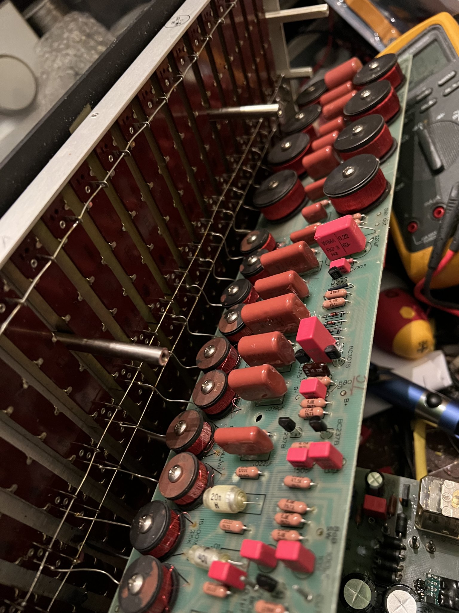

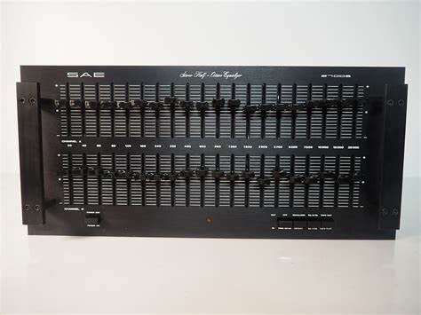

The SAE 2700b
1/2 octave - 20 bands per channel
8 transistors per channel, class A, 24 volt rails, could drive a 600 ohm load.
20 inductors per channel- only built for 2 years 76/77 when the gyrator parametrics took over the market - and were cheaper to build. Unit was tall - 5U with long travel 10k Alps pots. Other than the Cello probably the most expensive EQ to build. Top 5 bandpass filters used polystyrene caps, the next 10 were polyester, and the bottom 5 bands were tantalum.
Replaced all the transistors, carbon film resistors, ceramic and tantalum caps with Dale resistors, Wima FKP, and highest voltage 3% Panasonic polypropylene, Belleson +/- 24 volt regulators, Quaismodo snubbed soft recovery diodes, bigger filter caps
