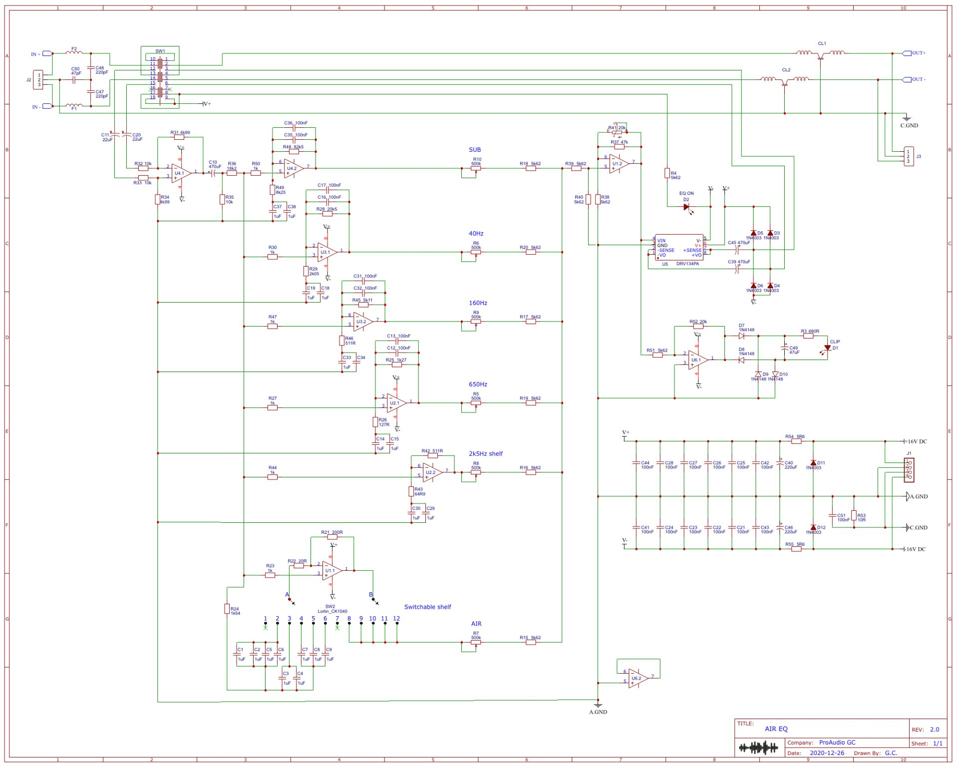

Using my spice model for the Audio Palette, I've figured out the resistor chain for the 15Hz filter, which uses a 10k resistor chain. This is attached. It is based on E96 resistor values, and the boost curves are attached. The nominal step value is 1dB, which it meets to about +/-0.03dB, apart from a couple at +0.06dB and one at +0.15dB
The actual resistor values used by Cello might be slightly different, but this design is very close in overall response.

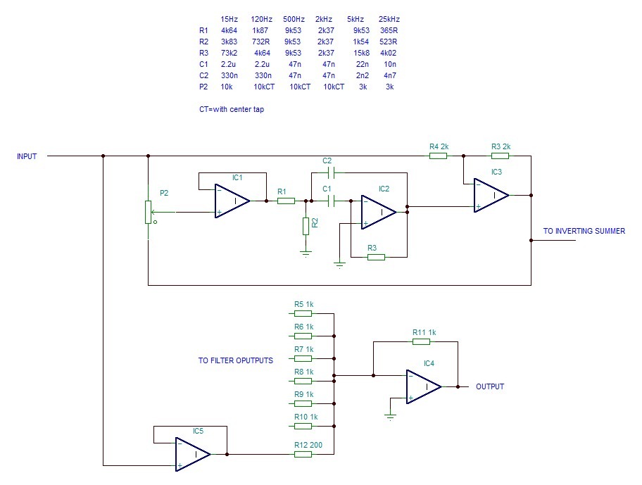

The attached is the basic filter configuration I'm using in the analysis. P2 is the stepped control. The wiper is buffered by IC1 and then fed into the bandpass filter IC2. This is where I deviate from both Burwen's arrangement and the Audio Palette based on it. In both of these, the filter outputs are summed into the non-inverting pin of IC3. With an inverting summer everything can be designed straightforwardly. The difficulty with a non-inverting summer is calculating the resistor values; this is what the analysis looks like https://masteringelectronicsdesign....f-the-summing-amplifier-with-n-input-signals/, and is candidly pretty messy.
So what I have done instead is to close the filter loop with an additional opamp, with the output of the bandpass filter feeding the non-inverting input of IC3 directly. In addition each bandpass filter has two resistors on the input. This gives the correct response (see the 15Hz and 25kHz responses above). The output of each filter block is summed into the inverting input of IC4 with identical resistors. IC5 is necessary to give an overall unity gain with all filters set to flat. The IC5 summing resistor needed is Rsum/(n-1) where Rsum is the 1k filter summing resistor. There are 6 of those, so it needs a 200 ohm resistor to set the flat gain to 1 (ie 0dB).
This is not a particularly elegant arrangement - it needs three opamps per filter block. The elegance of the Palette Preamplifier, based on the National apps book, is that only one opamp is needed per filter cell.
Anyway, the overall scheme is shown in the attached schematic, along with component values. The capacitance values are the same as in the Audio Palette, other than the 25kz filter, in which I have adjusted things to further reduce noise.

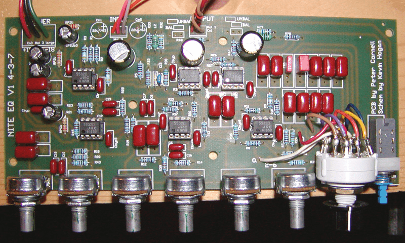

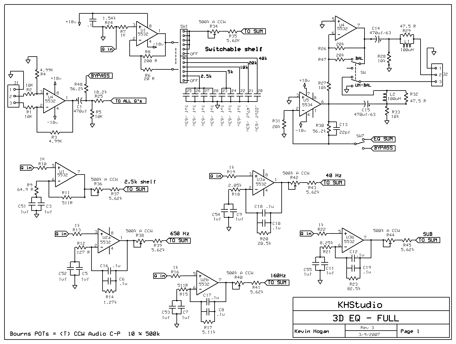

This kinda reminds me of the NitePro 3D. Much easier and not as precise as the Palette. But also parallel summing.
I did think of it as interesting enough to re-engineer into a palette style EQ...

Interesting approach, Thor. The filter blocks are not second order.
With second order filters (like the Audio Palette and Palette Pre) you can control the gain and Q. The gain dictates the maximum boost/cut, and the Q determines the width. So the Q of the 25Hz and 25kHz are about 2, and the block gains determine the +/-29 and +/-24 dB respectively. Other topologies that can give second order responses are state variable and biquad arrangements - although these are also op-amp hungry.
As I said, the filter elements in the NitePro 3D are all first order. So the bandpass filters are made up of a first order low pass and a first order high pass. So you cannot adjust the Q.
That is not to detract from the rather elegant simplicity of the NitePro 3D, and the positive reviews regarding sound quality. The only criticisms I've read (Googling following your post) is that there are two independent channels, not a ganged stereo arrangement, and no center detente.
The really elegant second order filter in which Q and gain are designable is the Palette Preamp, where a single opamp per filter is all you need.

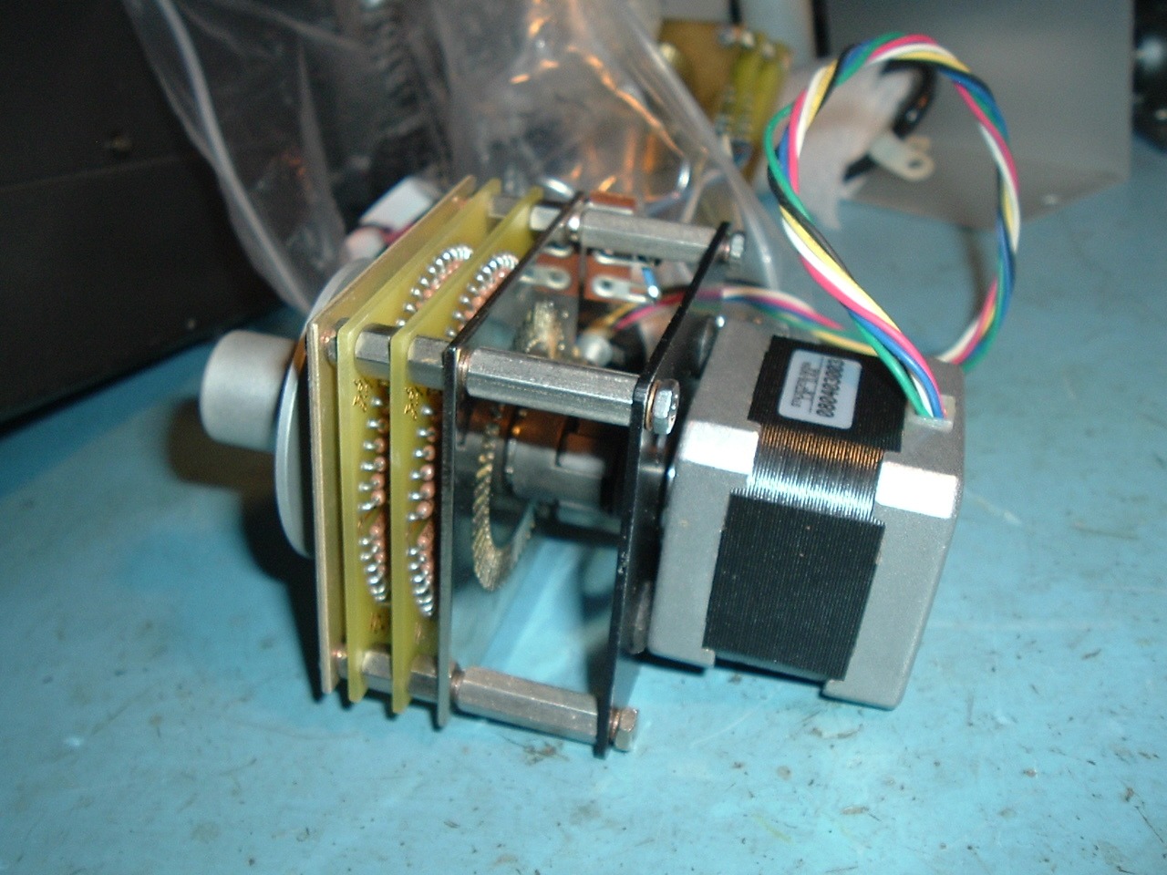

Palette switch info
The resistor values around the periphery of the xxHz pdf's relate to the position where they were to be mounted on the switch's PC bord - between switch poles.
Not all 59 poles were used for certain switches. Some were 49 poles. Had 2 different "stop plates" made up for the particular switch. Most switches were single deck. A few were 2 deck,
Picture is of a 2 deck attenuator I made up with stepper motor control - with the help of John Chapman.
