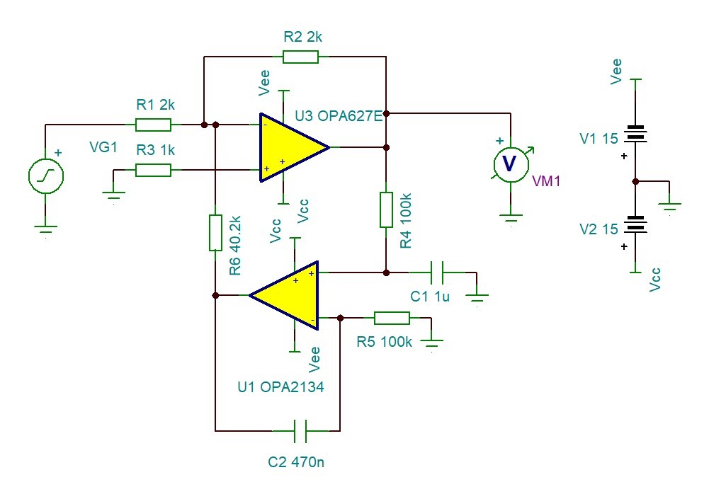

I was thinking about DC offsets in the Palette Preamp. First, looking at Burwen's original IC-based design for the Audio Palette, he used 6 DC servos per channel to remove offsets around switches to make their action click-free.
Also Curl made use of servos in both the Vendetta phono stage and in the famed and infamous Blowtorch.
And Bob Cordell used them in his VinylTrak phono stage (a mix of discrete and IC stages)
The benefit is that it keeps DC blocking capacitors, often electrolytic, out of the audio chain
Now these have to be designed with care to be (a) stable (ie don't oscillate) and (b) acoustically transparent (free of phase shift and peaking) and (c) have the right capture range (IOW don't hit the rails before they have nulled the offset. But there are plenty of road tested designs out there.
Time to do a bit of simulation...
Craig

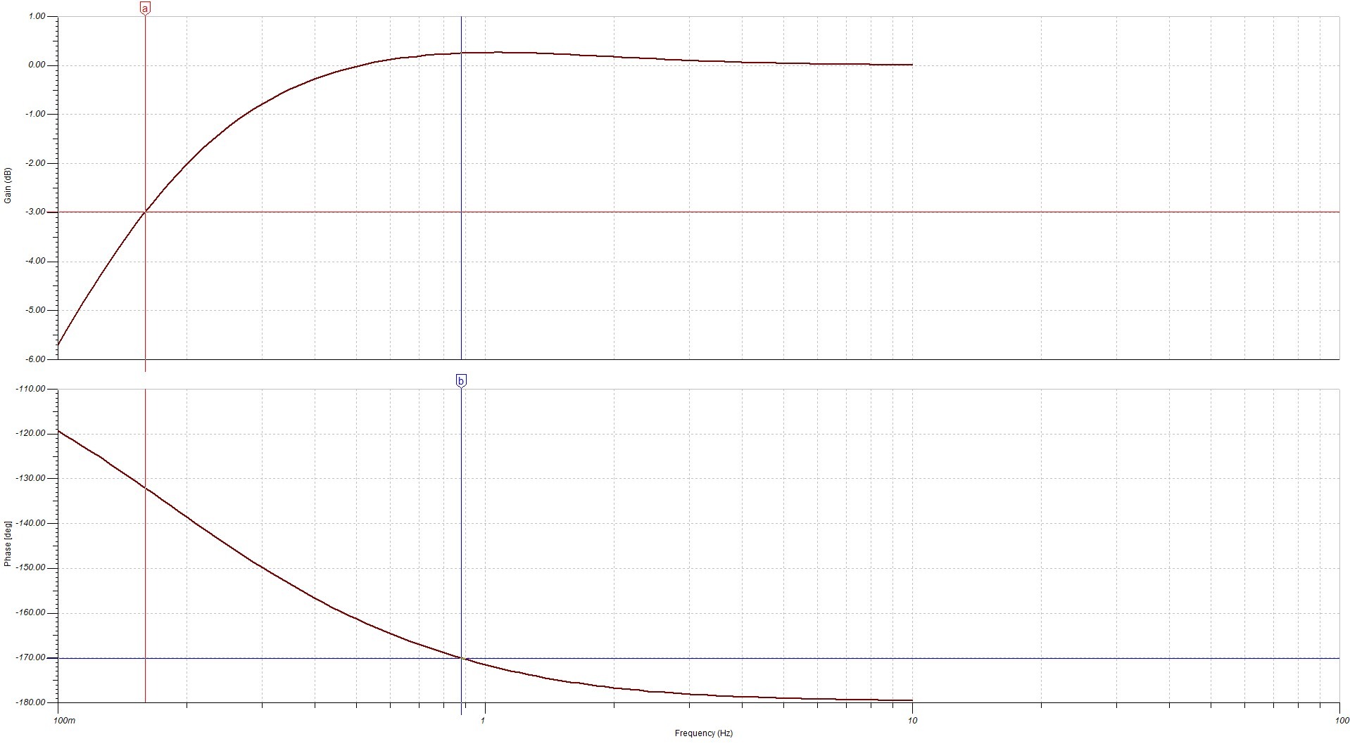

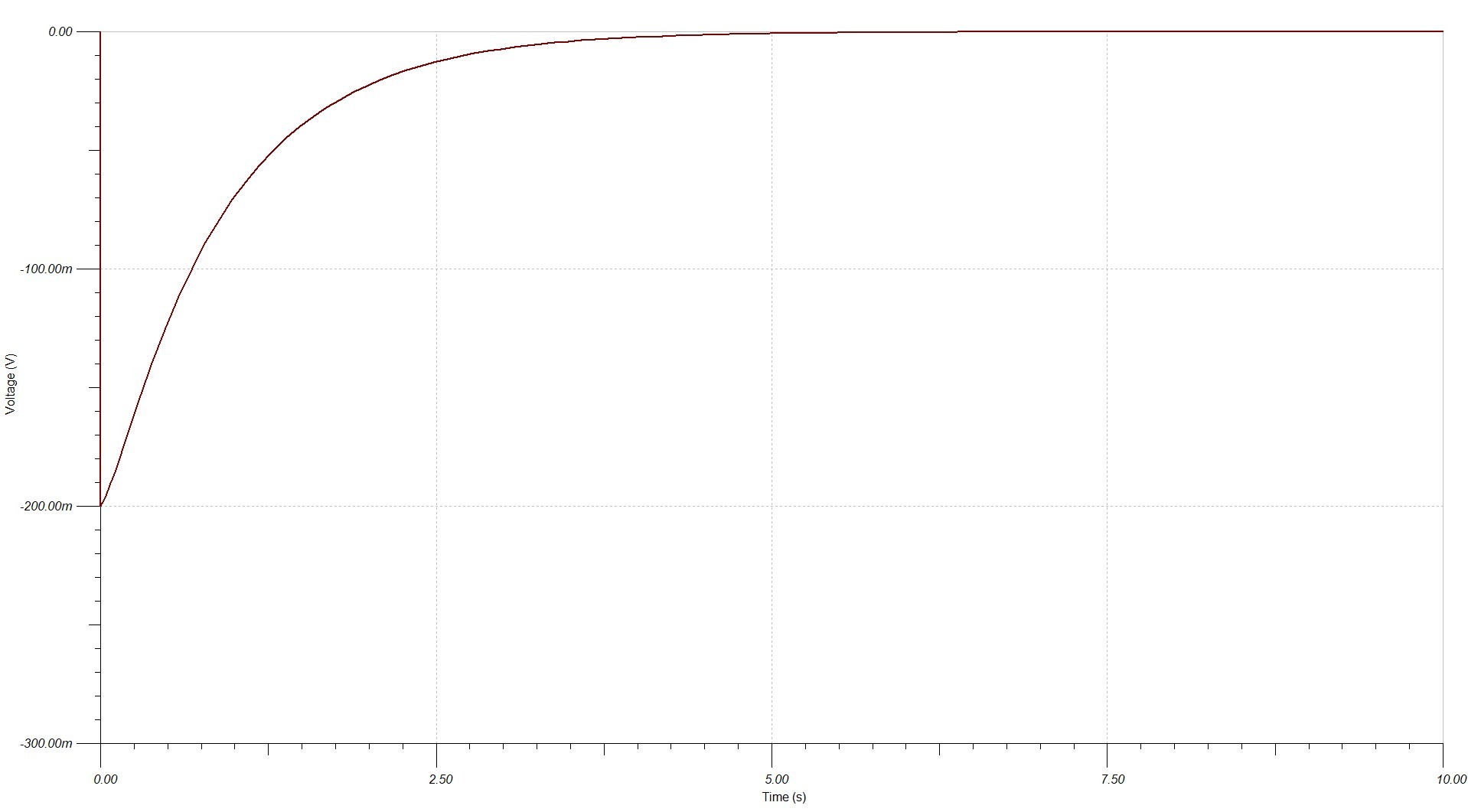

Simulation result for one of the Burwen servos.
The -3dB point is 0.18Hz, and 10 degrees phase shift is at 0.9Hz. Both safely outside the audible range. The servo amp has to be low distortion, because it is still partially in circuit well into the audio band. The transient response is good with no overshoot or ringing. It is configured around a -1 gain amp.
The servo IC output voltage is 20x the DC input voltage offset. So it can cope with ~0.75V of offset before the servo amp hits the rails. For more modest offsets of a few tens of mV, the output is within a few microvolts (<<10uV) of zero,

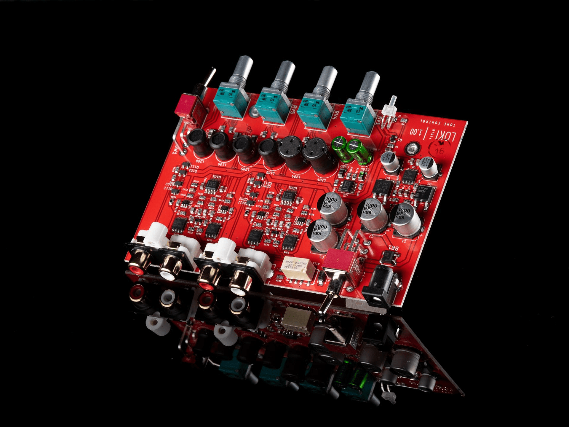

Wonder why they say this when it looks like there are op-amps in the picture? Maybe the Mini+ is the one without op-amps.
"Loki Mini+ uses a single, discrete, current-feedback gain stage, coupled to passive LC filters for 3 bands, plus a gyrator for the bass."
Those inductors look like they use ferrite, which I don't like the sound of.
I'd say they were definitely op amps. Surface mount transistors look entirely different - either three pad for single transistors, or for duals five (for eg commoned emitters) or six for two independent transistors. Peering at the picture there are in fact four six-pad dual and a number of single transistors, and a bunch of opamps.

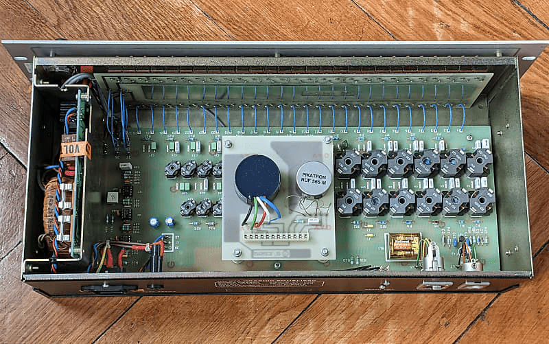

In professional Audio Equalisers are widely used.
The classic LC based designs like from Klark Technik etc. command large premiums in the 2nd hand market, while major name manufacturer older pure op-amp based EQ's are worth "junk".
Personally, I feel the subjective sound quality of a single NE5534 plus a bunch of inductors to be much better than common op-Amp based designs.
I feel that using LC for higher bands and gyrators for lower bands, using good discrete circuitry for the actual signal path would be SUBJECTIVELY best.
