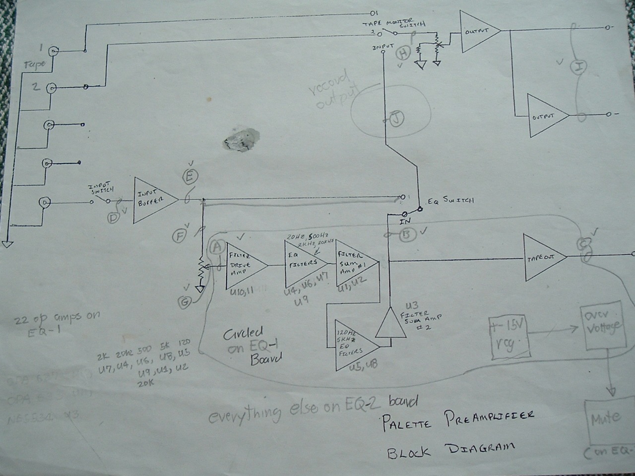

Can´t get my head around how the summing amp works, any detail on this Charles?
(The Rane/ Rod Elliot constant Q equalizer circuit makes more sense to me, but I would love to know all the details.)
Is seems that the different filter sections had different values of R3 ( output series resistor) AND they seem to have different gain in their respective band according to the values fo R2/R1, so that should almost do it.
...But the previously attached block diagram does not reveal any shunting resistor before the + input of the OTA2 in the summing amp an also no feedback resistor to a - output or something that would be expected in a nromal summing amp.
So are the different R3 values and actual gain in the filters the only thing responsible for the weighting of the diffenret gain range of the bands within themselves or what?

I've been looking at this too. A feedback resistor of 10 ohms makes no sense. The way this type of circuit works is that summing is done into the positive input of the opamp, and the negative input has to have a gain of precisely one - so the output resistor to the overall input has to equal the feedback resistor. So in this case, 2k. So the feedback resistor ought to be 2k, not 10 ohms.
Next look at the output resistors of the input amp - two ten ohm resistors in parallel. So I think that the 10 ohm resistor in the feedback ought to be in parallel to R17, and the 205 ohm resistor ought to be on the inverting input of the opamp to ground. That is needed to set the overall gain with controls centered at one. It is usually equal to the parallel resistance of the R3's in the filter circuit. That is actually 170 ohms, but the value on the schematic is 205 ohms - probably found by tweaking.
The other point is that OTA-1 (Operational Transconductance Amplifier) has a very high output resistance (taken from the collectors in OTA-1), and is therefore a current driver, So the output resistors cannot go to an opamp input - particularly OTA-2, which has JFET inputs and an exceptionally high input resistance. So there has to be another resistor to ground somewhere to ensure that the current has somewhere to go. So there is a possibility that the 205 ohm resistor is supposed to be on the positive input to provide a ground return. Or the 10 ohm resistor might go there with the 205 ohms on the negative input to ground to set the 0dB point.
This is just speculation of course - but the EQ circuit as drawn makes no sense.

There also has to be a bit of hidden detail. There are blocks that are specified as OTA-2 + VF. OTA-2 also has a high output impedance. So there has to be a resistor to ground between OTA-2 and the diamond buffer VF that sets the overall gain of that block.

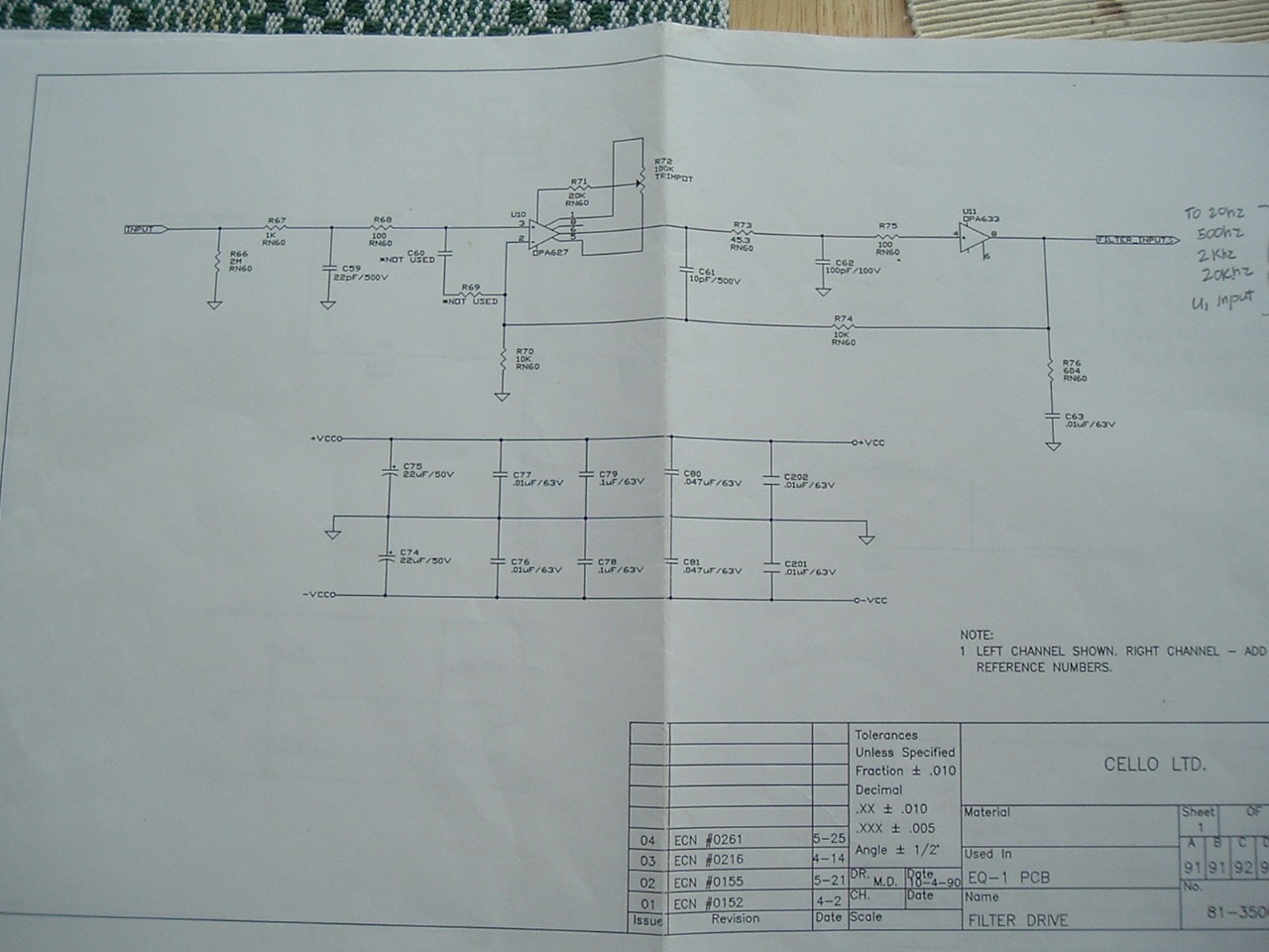

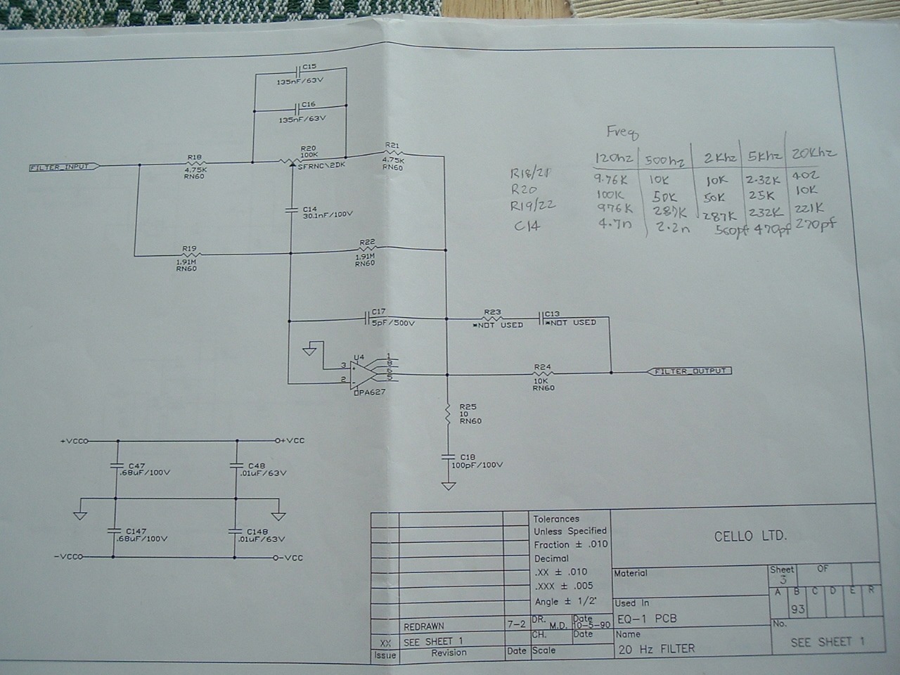

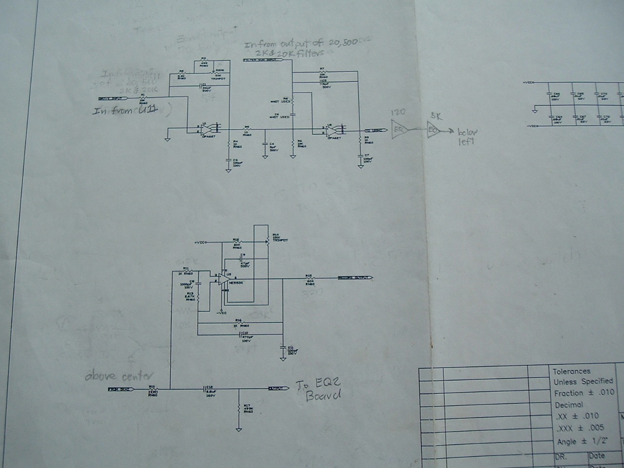

Here are the applicable schematics for the EQ portion of the Palette PREAMPLIFIER. Hope you can read them OK.

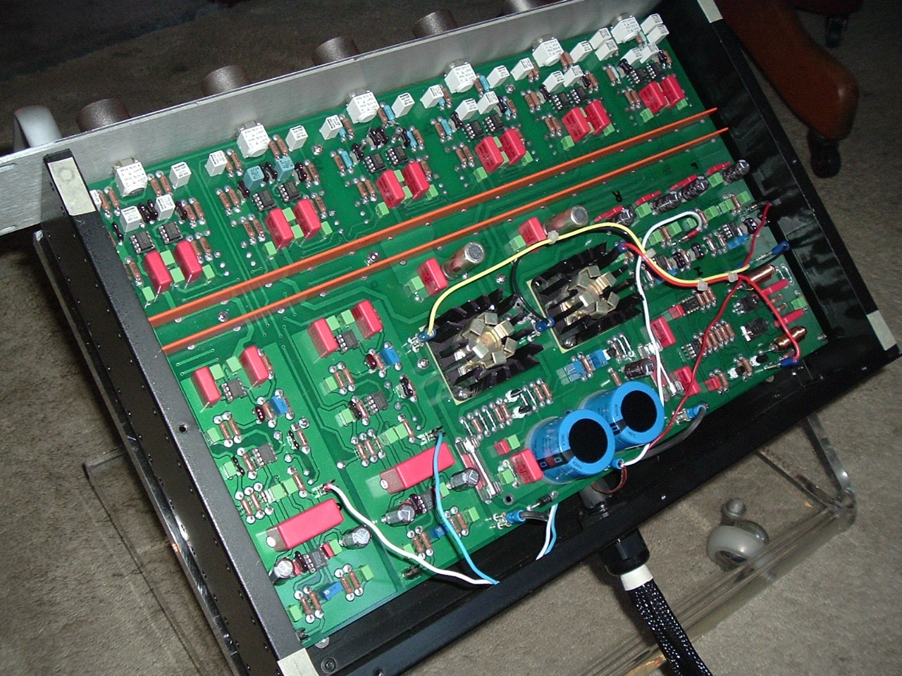

And a pic of the EQ PC board. Filters are along the top half. Input and output bottom left. Post-regulator bottom middle and overvoltage protection lower right.
Rest of the pre is on a second board
Didn't realize till now that you had some questions about my earlier schematic postings. Will try to figure this out.

Superb Charles - thanks! Just one question - shouldn't C15/C16 scale with frequency too?

OK - simulation suggests, for C15 (+C16)
20Hz 270n (given)
120Hz 47n
500Hz 22n
2kHz 5.6n
5kHz 5.6n
20kHz 2.7n

Thanks - overlooked that/those cap values
Your values fine except 5Khz = 4.7n

Yeah - I later realized that I had not changed the pot value for the 5kHz filter! With the correct value of 25k it does indeed come out at 4.7n.
The summing method is interesting, with 20Hz, 500Hz, 2kHz and 20kHz summed via the 10k output resistors, as per the National apps note. But 120Hz and 5kHz are then in series.
To make that work for the series combination, it looks like the 10k output resistors need to be shorted out. Otherwise there is a 10k resistors between the two sections - and that screws with the response a treat. Replacing the output resistors makes the 120Hz and 5kHz filters do what they ought to do.

So the question I've have since I compared the palette pre to the National application note is why have the 120 and 5K filters in series?? In series there has to be more "net" noise (which I never found to be a problem) BUT there is the "cascading" added output voltage offset which has been a problem in a few cases. Also negates the effect of the 500 ohm trimpot across U1 the filter sum amp.
Should note that I had a few NOS "loaded" Palette pre equalizer PC boards and swapped the 627's for some LME's. Still no noticeable noise. Have a pile of 627's.
When I centered contour knobs on each dual pot shafts for "0 - out", could easily get a flat 20-20khz input frequency sweep with an output repeatable to better than a half db which (fortunately) corresponds to no (to my ears) audible difference when throwing the EQ "in/out" switch! Measuring instrument is the Amber 4400.
