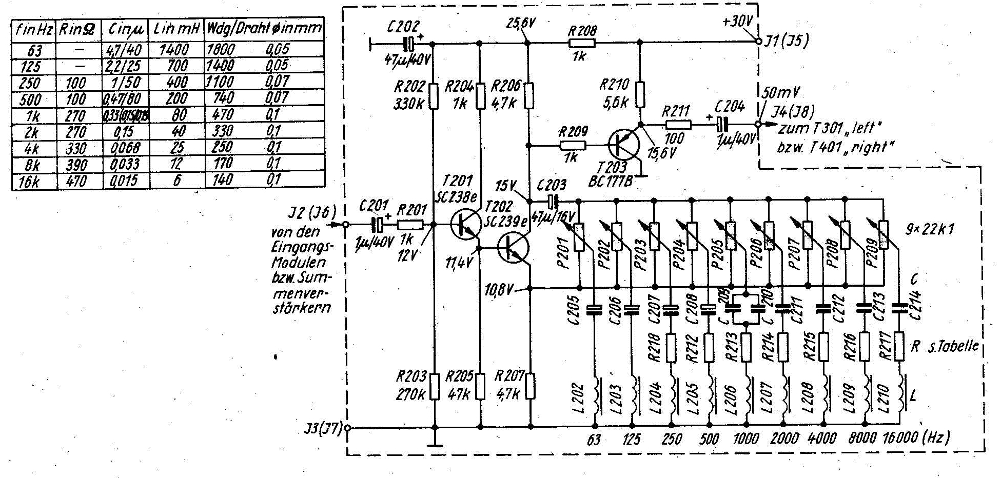

Split-load/Cathodyne/Concertina for EQ
It includes this schematic:
273858d1332735474-tone-control-minimal-eq-jpg
I called it "East German EQ" because that is what it is. It was designed in East Germany in the late 70's and remains somewhat legendary for it's sound quality. It avoids the use of looped feedback, which similar western Pro-Audio design already used in massive amounts routinely. I can attest to the sonics of this type of EQ, I used it extensively.
This EQ shows the principles for what "ZenEQ" (Solid State) and the "HotEQ" (Tubed).
Fascinating circuit! The only similar designs I can think of is in the early Soundcraftsmen 10-band graphic equalizers like the two schematics below. I don't know which one came first, the Soundcraftsmen EQ or the East German EQ. Both from the 70's, I believe.
The only tube version that uses split-load circuit in an EQ I can find is from a Fender guitar amp.

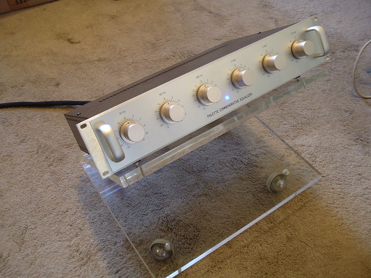

Guys,
Would like to comment on the boost/cut levels proposed in various posts.
I've built up a few of the Palette Preamp Equalizer section from the original schematics. Used them a lot and came to some conclusions about the amounts of boost/cut actually needed.
Please remember that the Cello was designed to be a PROGRAM equalizer. Not a ROOM equalizer. As such, the amount of boost/cut NEEDED in the mid frequencies, combined with the ear's sensitivity at those frequencies, appears to be much less than at the frequency extremes.
Still using the same basic 6 frequencies as the original Palette, but now use boost / cut values of +-12dB at 20hx and 20K; +- 8dB at 120hz and 5K; and (only)+-4 dB at 400/800 hz (switchable) and +- 4db @1K/2Khz (again switchable.
Did put the Equalizer section in a nice small box (see Pictures of 2 versions) on the end of a 10M umbilical that plugs into my DIY Cello Encore Line Stage. Can dial-in the EQ; adjust the gain of each channel by 3dB or so and defeat the equalization FROM the LISTENING POSITION.
Use it a lot to "tame" bright CD's and "boost" deficient bass on older LP's. Amazingly, in many cases only ONE to TWO dB is all that is needed in the midrange.
