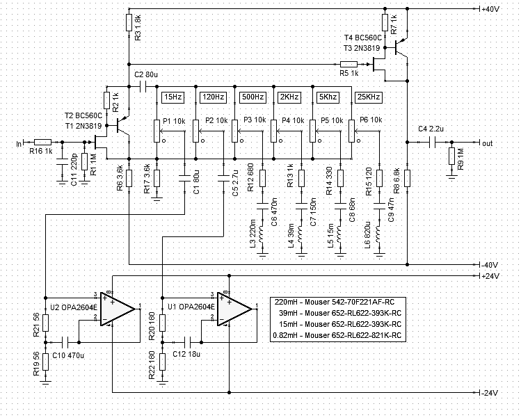

So far it is this, but I don't know why the ~45hz control was lost or where to buy 80v capable BC560C's.I see lots of ideas floating around, but is there a concensus yet? If so, what is it and what's the post number where it's loated?
This was the Op-amp solution on the two lowest bands, if I read this correct?So far it is this, but I don't know why the ~45hz control was lost or where to buy 80v capable BC560C's.
post #18?I see lots of ideas floating around, but is there a concensus yet? If so, what is it and what's the post number where it's loated?
The trouble with the circuit in #88 is one of the bottom band is centered below most speakers' reproduction range, and at the top end--unless you are below the age of eight--the control is largely worthless. The original GDR circuit was much more useful, with a 63Hz to 16,000Hz range.
