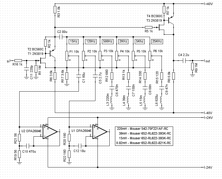

Because I do not know, I wanted to ask if the BC560C okay with the 40v rails shown. There is a Fairchild BC556C, Fairchild KSA992 and Toshiba 2SA970-BL, which are all slightly different but have higher voltage spec if you happen to need it. Indeed, the decision is yours and I very much appreciate what you have done so far.

Attached the version with gyrators for the two LF bands where mouser does not stock suitable inductors.
Mouser Stock Numbers for the other four bands are included as an example and as help for those too lazy to even do a quick search there, however they are not necessarily the best choices, just what I could find and which looked okay. The circuit is adjusted to account for the inductor DCR for the items listed.
As these inductors do not have closed core they have a tendency to pick up stray fields. Custom made units on a pot core may be better and one could certainly make the whole set.
The Curves and other performance remains essentially unchanged, as before I have included the Tina-Ti simulation file... The use of Op-Amp's for the Gyrators is necessary (if undesirable), in the simulator at least, as using the same compound Fet/BJT leads to an overall level boost and wrong Q.
The OPA2604 shown here is really just a stand-in, use whatever works for you. The Op-Amp's need more current capability than anything else... Video Op-Amp's are probably a good choice, but can be problematic to stabilise. Adjust rail voltages as needed for the Op-Amp's of choice.

Checked a few more things.
Using a CCS (ideal) for the output follower tail increases THD mildly by increasing H2, but reduces higher order content, this is more pronounced with loads far greater than 10K.
The Resistor between base and Emitter of the BJT in our Inverted Fetlington shows also some sensitive re. HD. Increasing the value 3.3K shows a minimum of higher order HD at the cost of 6dB more H2.
I would be reluctant to trust a simulator implicitly on small details like that, so the circuit would have to be build and measured to confirm the sim and I suspect optimum values will be quite a bit different.

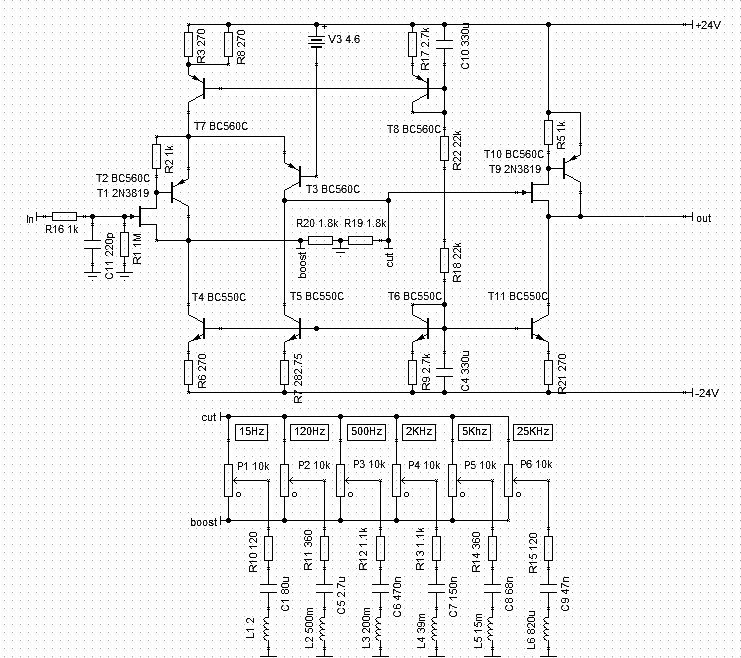

BTW could it be that C10 should be swapped with R21, and C12 with R20 ?

No, of course not. What RE shows as usual is not 100% correct (that comes from copying others). The circuit using what is basically a Sallen Key Filter does not behave correctly like a "virtual inductor". It "kind of works", but is not a correct alternate to using an inductor.

May I propose the following changes to your schematics in post #18, just for discussion :
T1+T2 -> 2SK369BL
R6 -> 2SK369BL matched Idss to above
R7 -> 1.8k
T3+T4 -> 2SJ74 BL with 1.8k degeneration.
R8 -> 2SK170BL with matched Idss ot 2SJ74.
C4 removed.
Negative rail to -20V.
The 2SK170 can also be conveniently turned into a servo.
Result : All JFET, no couplung caps, improved PSRR to +ve rail.
Please feel free to comment / criticise.
Patrick

Yes, I would in principle agree with these, however it will produce less linearity and more parasitic capacitance than what I show, while using parts that for many potential builders are hard to find.
BTW, R6 should be 1.8K in series with the 2SK369V (or better, halves of the LSK389), so both sections have the same voltage across them.
However my take allows pretty much any generic medium Gm RF Fet (BF244/245, 2N38XX and so on) to be combined with a decent Small Signal PNP Transistor, no selection needed and to get good results.
If we arrange the PCB right we can just fit the "good" Fets you and I have, leave the PNP off and short the resistor and enjoy our five to tenfold THD increase and sound truly of "one fet clapping". I'm sure it will actually sound better.
The CCS could theoretically be beneficial if we have too much noise on the negative line (positive PSRR remains near zero), but I think we can afford decent supply regulation.
This still needs a buffer (output absolutely must be buffered somehow/somewhere) and does not strike me as all that horrorshow.
A servo is just a different place for the coupling cap, if it does it's job properly it will not allow lesser quality capacitors. DC coupling = no capacitor sound is almost always an illusion, not actuality, often the reverse is true.

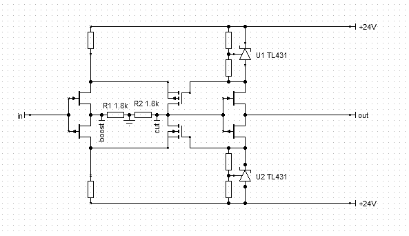

Here what I have been considering (Principle only, precise circuit would look different...) to get rid of the evil coupling capacitors:
This will need a servo of course.
Anyway, surprise, surprise, in almost any relevant metric we have performance comparable to the much simpler original. PSRR is much better, but we where going to a decent set of supplies, right?
If we really want guru cred we would make it rail symmetrical with K170/J74 and impossibly tight selection requirements. At least we would reduce HD this way...
So, all long considered.
I'm not rejecting it, but I do not feel that the results will necessarily be better than the basic one above, but complexity, trouble shooting requirements and all sorts of stuff goes way up, as does cost.
All of this in my view makes it worse as a DIY project, though it has a better chance to be listed somewhere as "fiendishly clever circuitry that should sound great but which somehow did not get to work, more luck to you".
T1+T2 -> 2SK369V
R6 -> 2SK369V matched Idss to above
R7 -> 1.8k
R8 -> 2SK170 with matched Idss ot 2SJ74.
C4 removed.

Something like post #37 was also what I had in mind when going for complementary all FET,
though I do tend to consider the output buffer not an absolute necessity.
Patrick
Patrick
Patrik,
The output buffer can be omitted under two conditions:
1) The load on the output is infinite (in other words the inputs of the circuits following are reliably buffered)
2) The load on the output is clearly defined, unchanging and designed into the circuit as part of the output load.
Under all other circumstances a buffer is required.
Ciao T
Something like post #37 was also what I had in mind when going for complementary all FET, though I do tend to consider the output buffer not an absolute necessity.
Ciao T
