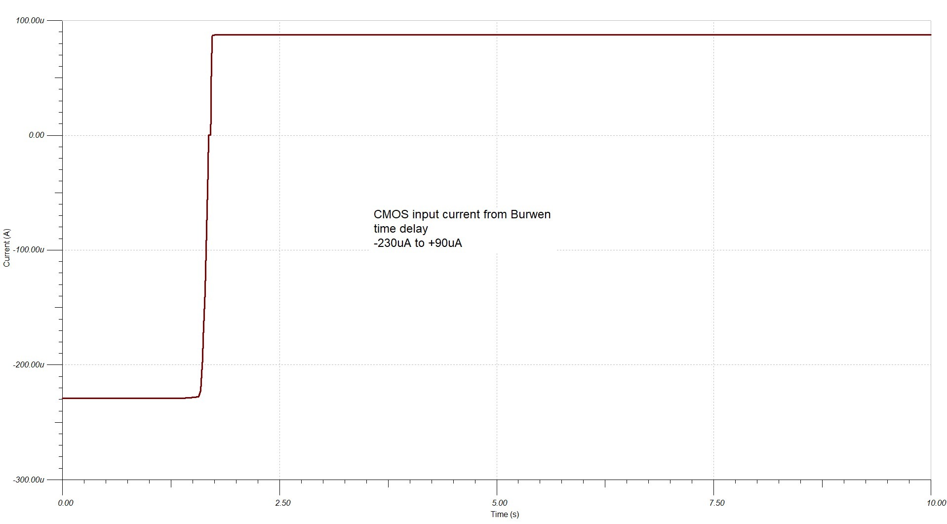

Yes it is indeed CMOS not TTL. But the +/-20mA input current limit still applies, so the 49k9 resistors still limit input current to a hundred uA or so.
Indeed. Note, if the circuit were to use actual TTL (open emitter input) it would probably not work as is.

Two 74HC14. One per channel. They run from a vanilla 7805 from the +28V regulated line coming in. So not much current draw at all.

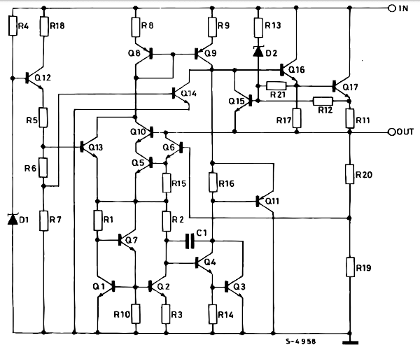

I'm not sure if the 7805 has a minimum current to regulate, like the 317/337 do. There are a few searchable references that suggest 5mA is needed from a 7805 to ensure regulation, but that figure is not in the datasheets. A simple resistor of 1k or so would ensure that.
Yup, static CMOS is basically "zero power".
I think it has a little internal current and may be able to sink a few 100uA via Q6 and R19/20.

I was a little wrong - there are in Burwen four LEDs too that draw power from +5V too. One to indicate power on (~8mA) and three to indicate EQ bypass, Blend on/off, and phase invert. So between ~8mA and ~32mA into the LEDs. The 7805 could therefore dissipate (28 - 5)x32mA. Add to that a stated quiescent current of 6mA to get a power dissipation of about 1W. It should not need heatsinking with junction-ambient for TO220 version at ~24C/W,
That is more than enough to sink the clamp diode current of our little inverter.

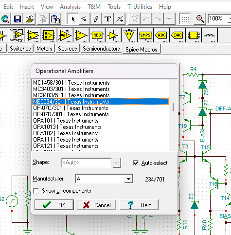

That is interesting. Out of curiosity I've been trying to model the power supply regulators in Burwen's design. The +22V refused to regulate in TINA-TI, Microcap and LT-Spice. It either stuck at ~8V or oscillated, depending on the simulation package. It worked in Tina-TI using the generic opamp, and finally worked properly using an OPA2134 FET input opamp.
The -22V line is still refusing to play ball.
The upshot is that the simulation of these regulators is entirely dependent on the opamp and linear regulator macro models. You can basically get any result you like. Stir it and make a wish.
Since they are simple, I might just build them and do some tests. I've all the bits kicking around.

Good suggestions Thor. The 317/337 models I put into TinaTI were the TI ones. They are pretty detailed and cover start up, transient behavior and drop out.
But the opamps are what was in the simulator. LT spice did indeed fail to converge and needed some tweaking to get the thing to work.

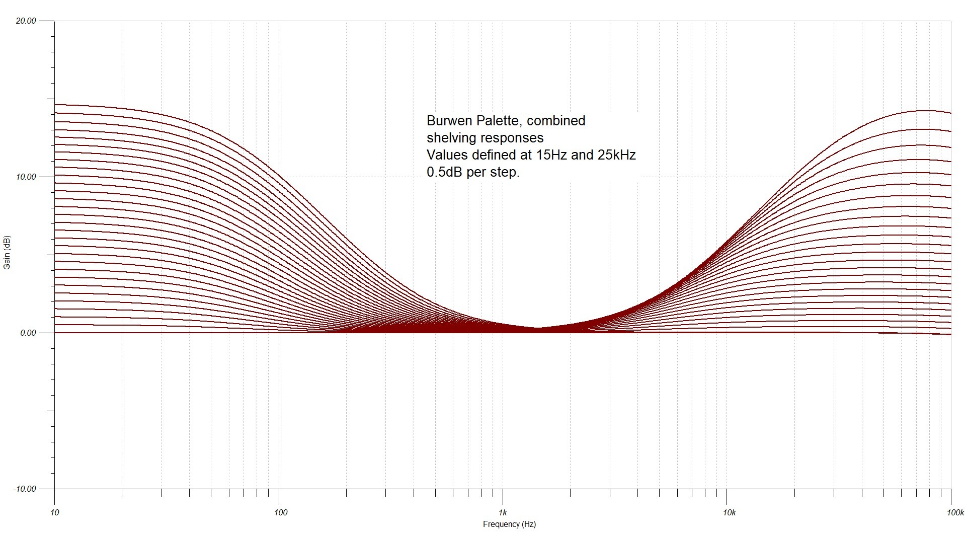

In Burwen's Audio Palette prototype, he adopts a quite different philosophy. There are four conventional boost and cut filters at 15Hz, 500Hz, 2kHz and 25kHz, with the same boost and cut levels as the final Cello unit.
But after this Burwen has a shelving filter section. This was quite deliberate; in fact his now defunct Bobcat software tone system had a combination of the two types of filter. In fact one of them is similar in operation to the Quad "Tilt" control of the 34 preamp. http://www.burwenbobcat.com/BBTB_Instructions.html
Anyway, in the philosophy of interesting reverse engineering, I've worked out the resistor chains to meet the Palette prototype shelving filters. Burwen states those in half dB steps at 15Hz and 25kHz.
First the response curves

Craig,
Why would "one" want to shelve below 15hz and above 25Khz - regions that few can hear, and the vast majority of speakers can't reproduce? Not to mention what "information/music" is there there?

But after this Burwen has a shelving filter section. ... Burwen states those in half dB steps at 15Hz and 25kHz.
I would probably use "bell" curves at 125Hz/500Hz/2kHz/8kHz and LF/HF shelves at the extremes with the common ranges, maybe +/-4dB in the middle, +/- 8dB intermediate and +/-16dB for the shelving sections.
Using the 47 Pole Elma Switches this gives 0.7dB steps for shelves, 0.35dB and 0.18dB per step in the middle.
