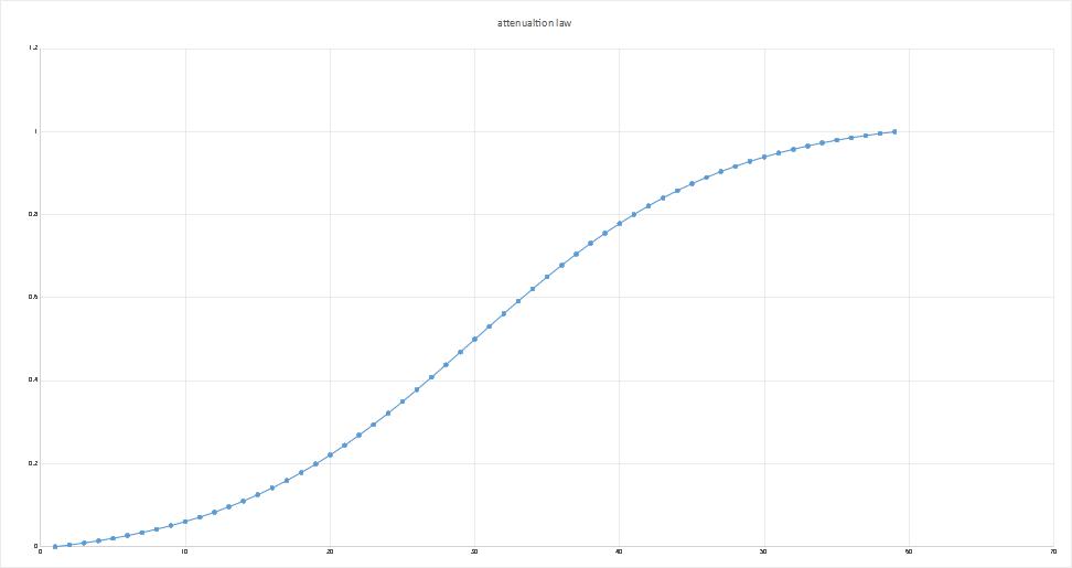

Well, IF YOU ASK ME, having 1.5 dB, 0.7dB and 0.35dB steps and +/- 16dB/8dB/4dB and using 23-Positions is just fine. But I would probably not replace them with pots.
Thor
If only it were that easy. The controls are far from linear, so you cannot just divide the range up. In general they are S shaped, some of them quite markedly so. The attached is the characteristic of the 15Hz filter. You could get away with a linear control with small error in the middle +/-12dB range. The 500 and 2kHz controls are quite linear though, and can probably be divided up per your suggestion. 15Hz and 25kHz ones are the worst. 120Hz and 5kHz are also quite non-linear.
Craig

Given the shelving section of Burwen's Audio Palette prototype, why does he describe them as 120Hz and 5kHz?
Having looked at the curves for the shelving responses, those frequencies are at 6dB below the upper and lower asymptote at maximum boost and cut.
I guess he had to describe them in some way, and that was as good as any.

I clearly misunderstood your mail - the way you worded it looked like you intended to have switchable attenuation. I now realise what you actually meant!
The switches are actually 23 way - there has to be a rotation stop. So center position is zero, then 11 steps each way. So 1.5db/step would give +/-16.5dB etc.
Craig
