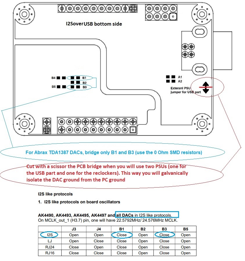

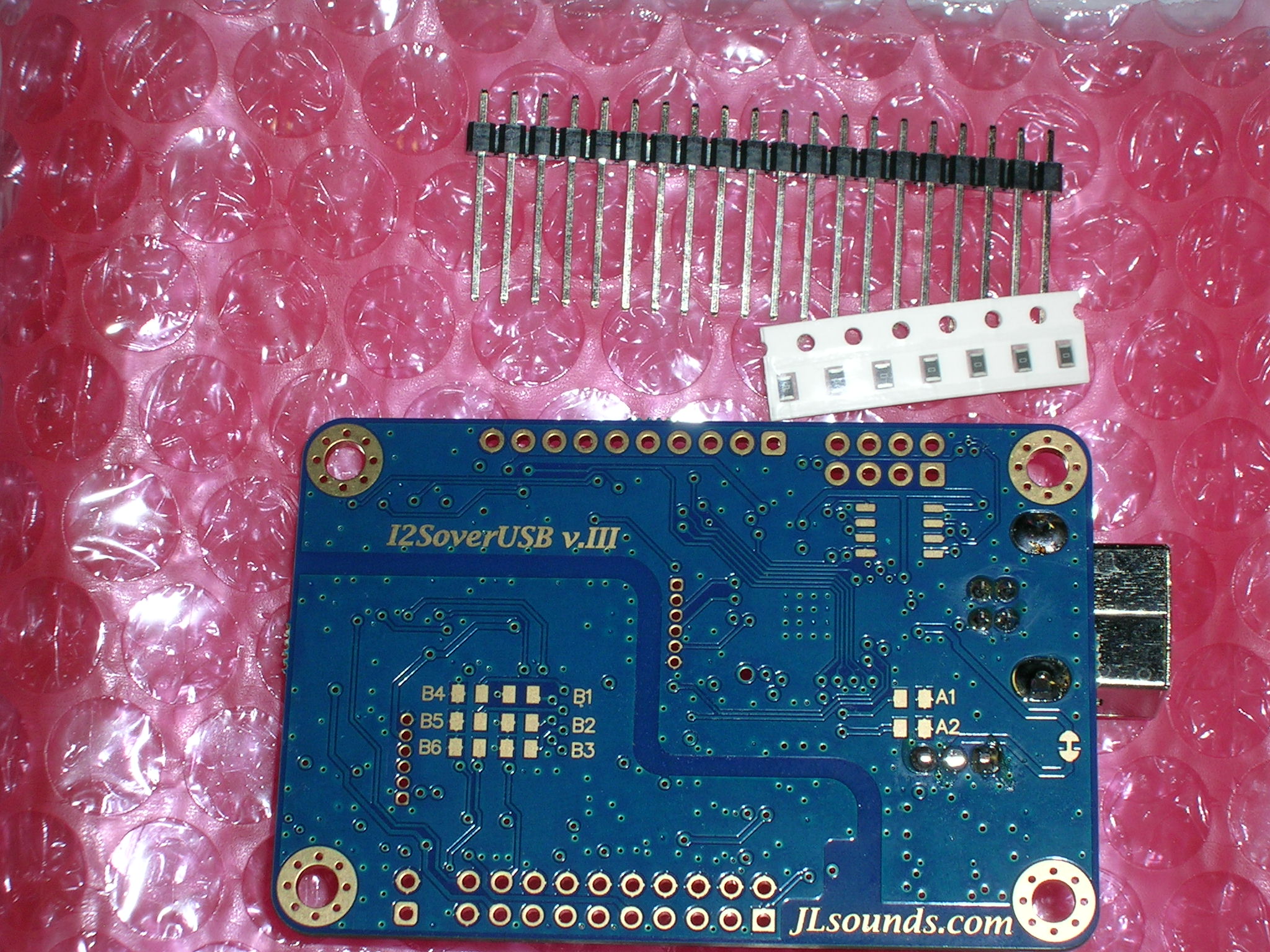

I didn't manage to have USB working. The other SPDIF/Toslink module works fine. From here
http://jlsounds.com/uploads/I2SoverUSB v.III.pdf
gpapag told me to solder only B3.
Windows recognizes device and loads driver

I owe you an apologygpapag told me to solder only B3.
It should be "bridge B1 and B3"
George
There is something other wrong, because it cannot open device, while the device is recognized and driver is installed. Maybe somehow I have broken it, i have gone with separate PSUs for USB and stage, so that USB ground is isolated.
@gpapag, i soldered the B1, same issue. BTW I have installed the new PSU boards almost everything SMD, they seem marvelous and stable as hell..

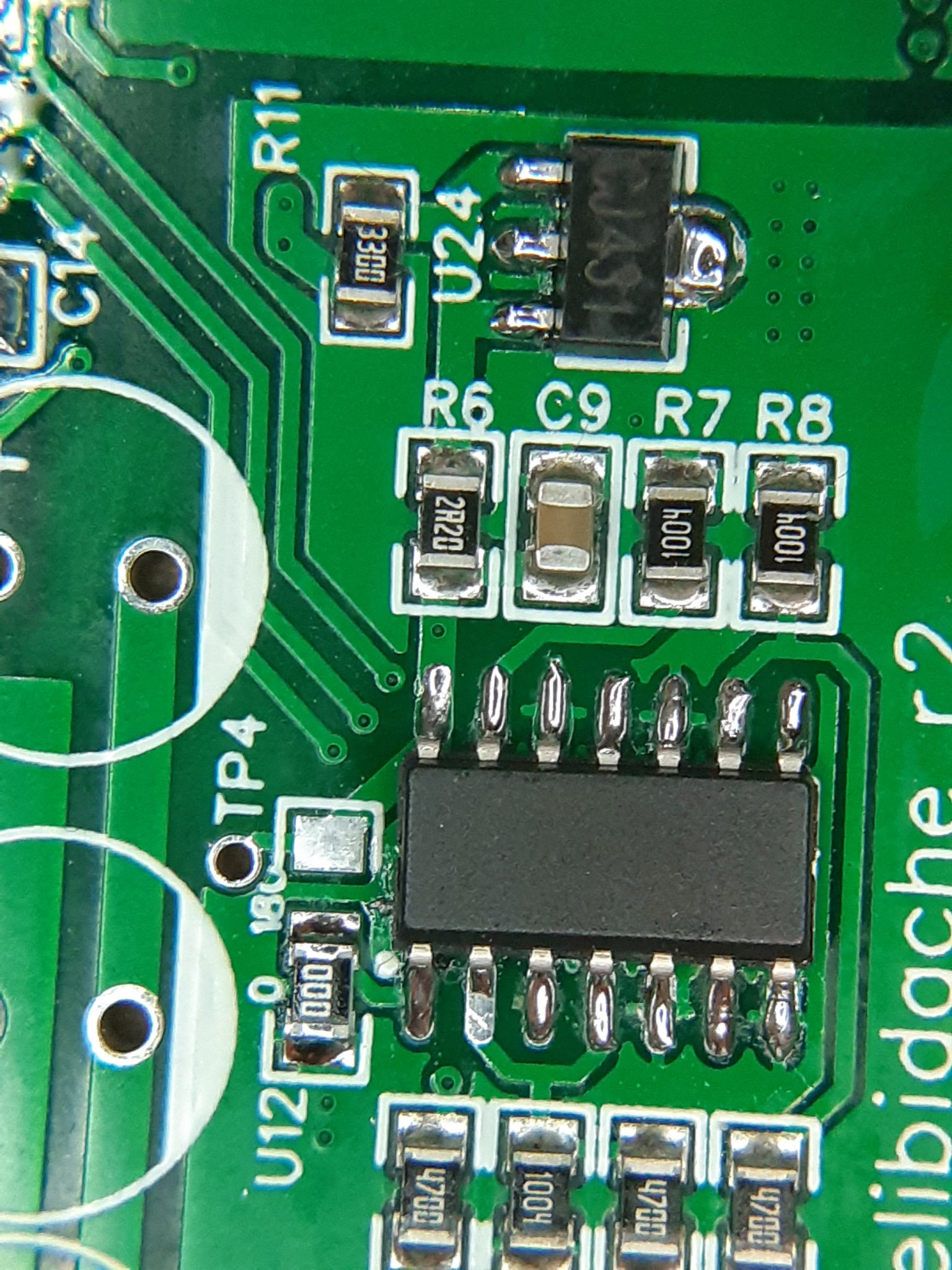

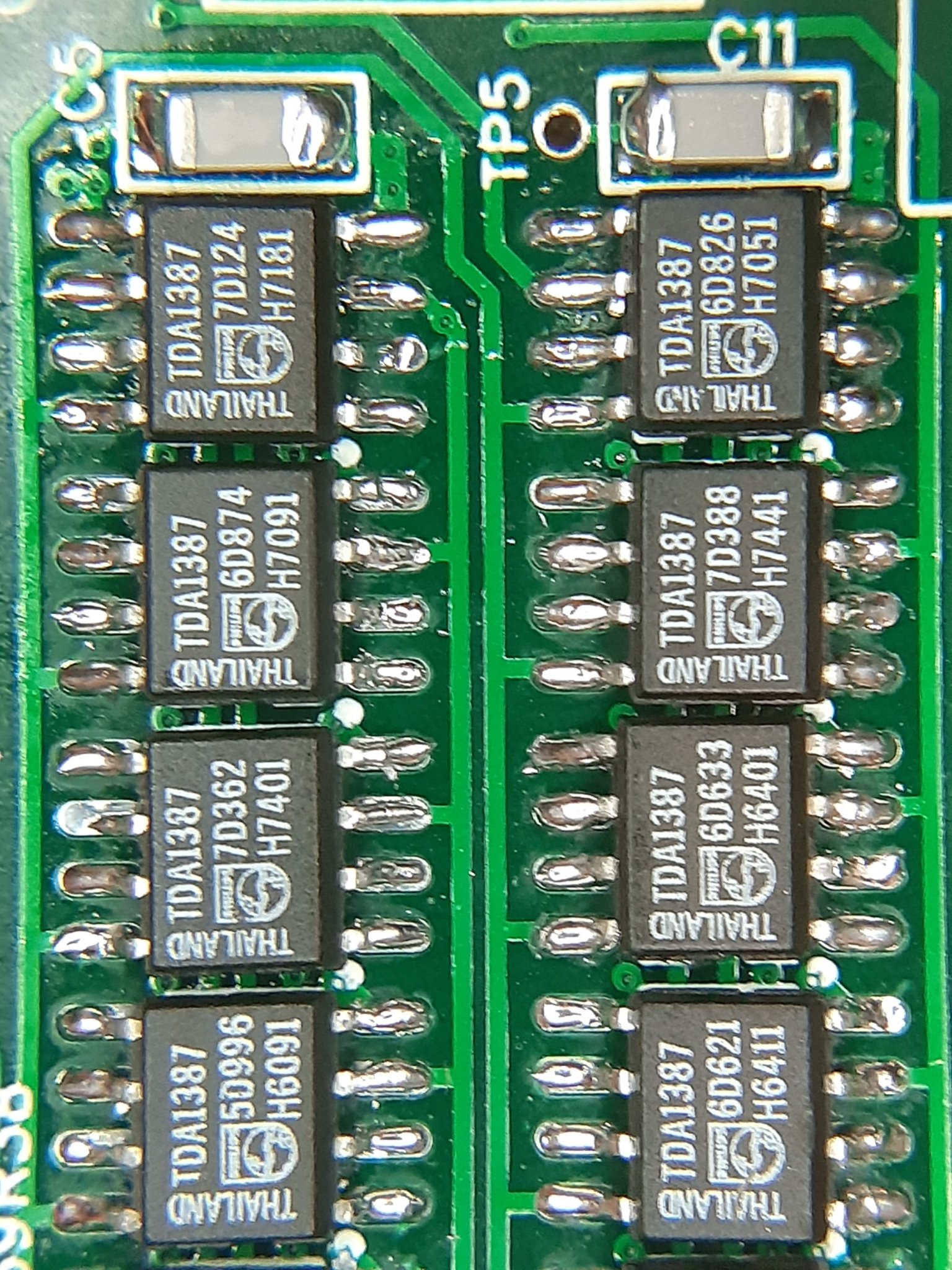

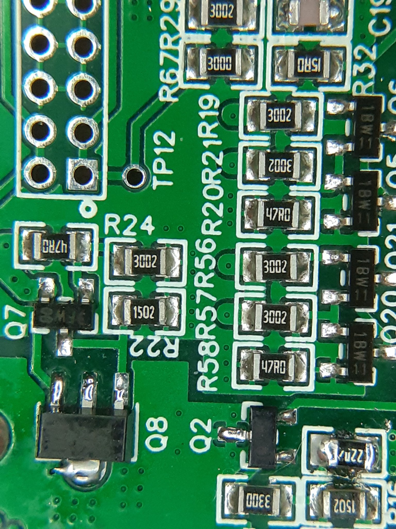

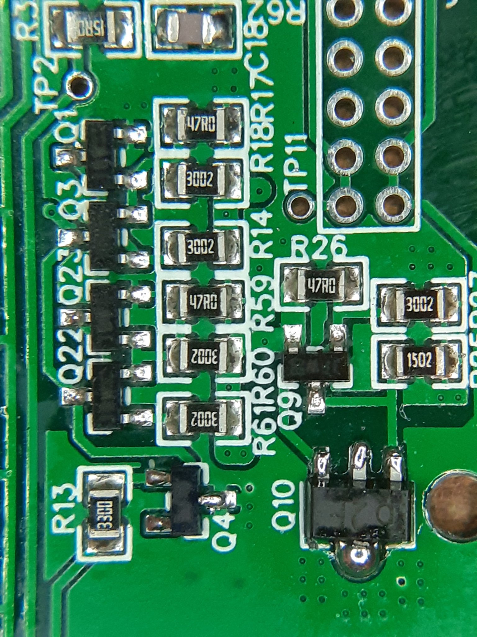

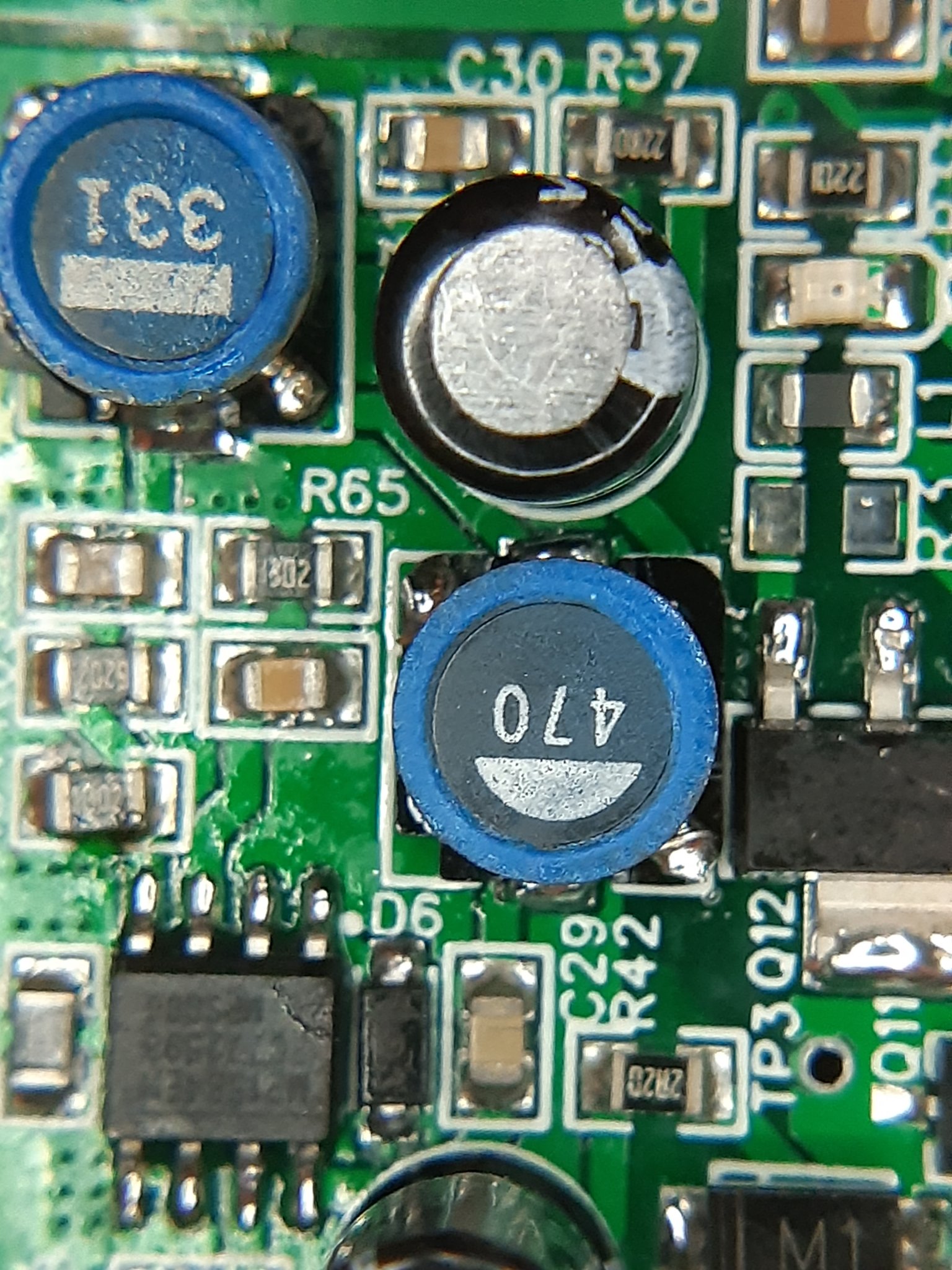

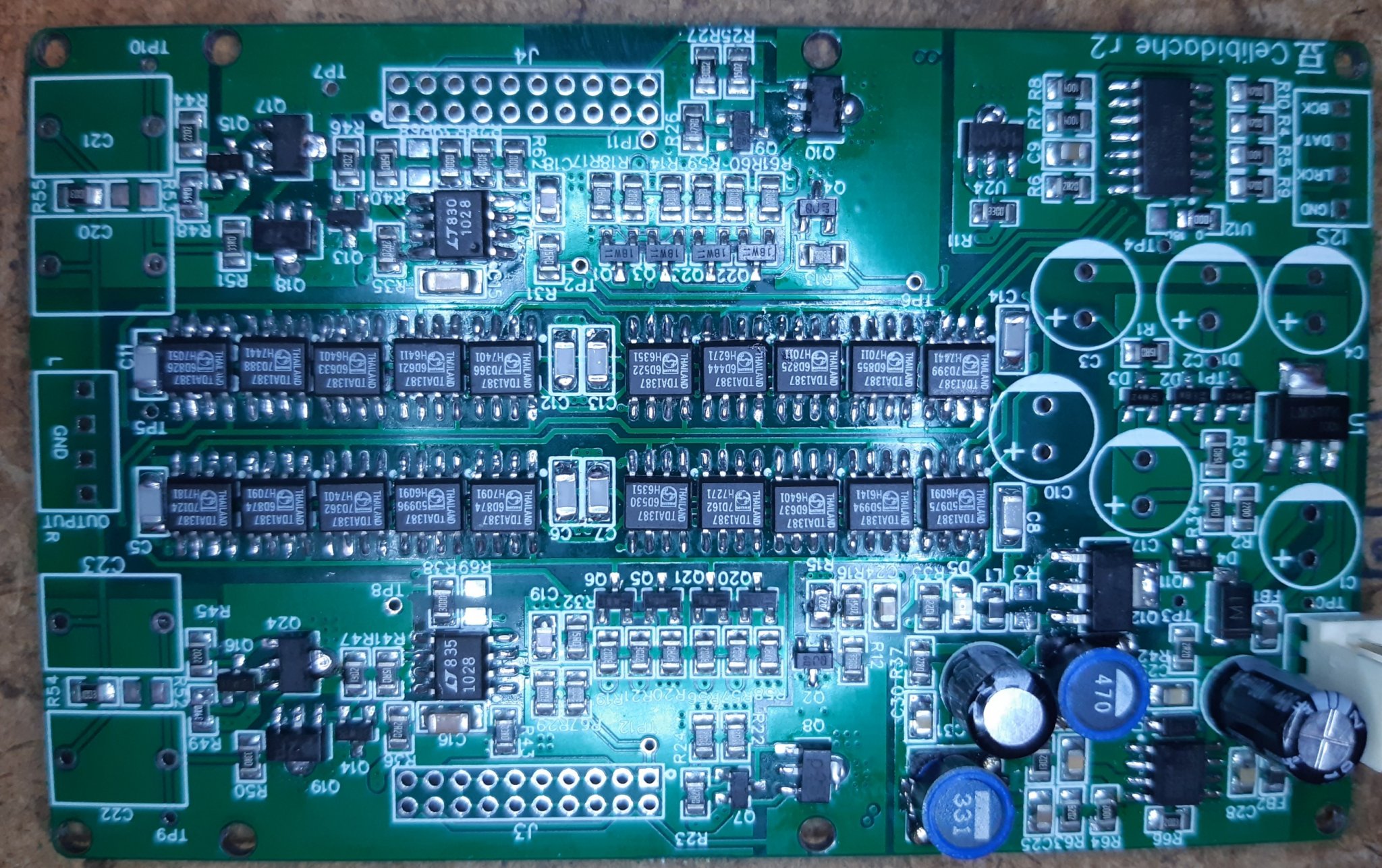

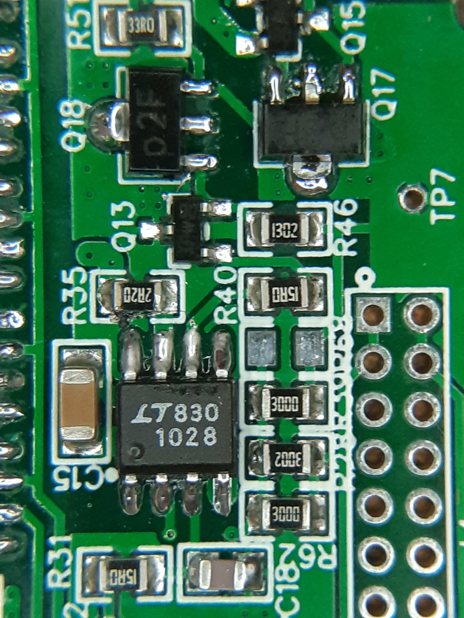

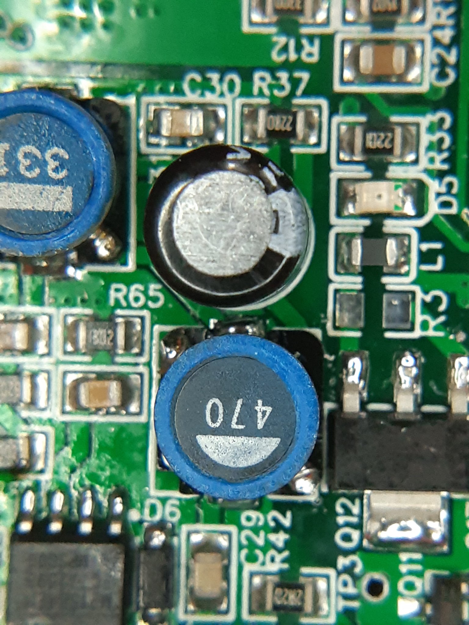

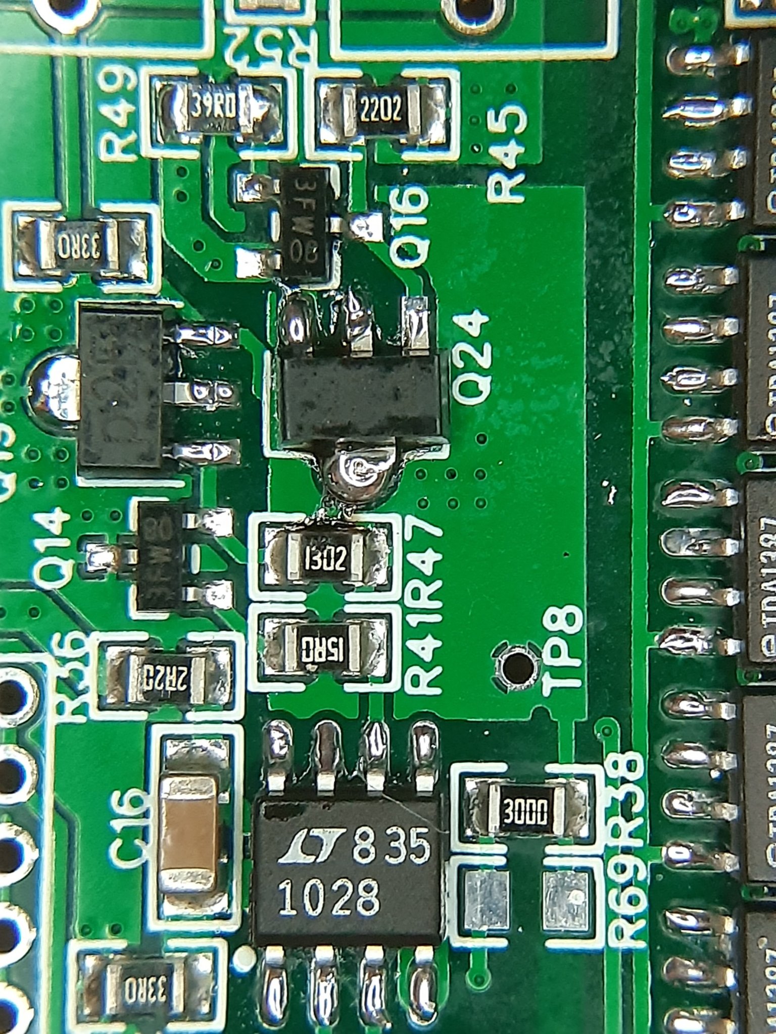

Hello,
I've a big problem!!
The Step 1 was ok and all TP was perfect, also TP6 with a new resistor.
In the Step 2 there was 24V140mA, in the first moment go to about 170mA.
The test points are:
TP1=20,2V
TP2=11,7V
TP3=21,5V
TP4=2,5V
TP5=5,5V
TP6=2,2V
TP7=14,7V
TP8=11,8V
Do you have any suggestion?
I'had some problems (I'm stupid!!) soldering the LT1028 of the left side but I don't know.
Here are some pictures of the board.
Guglielmo

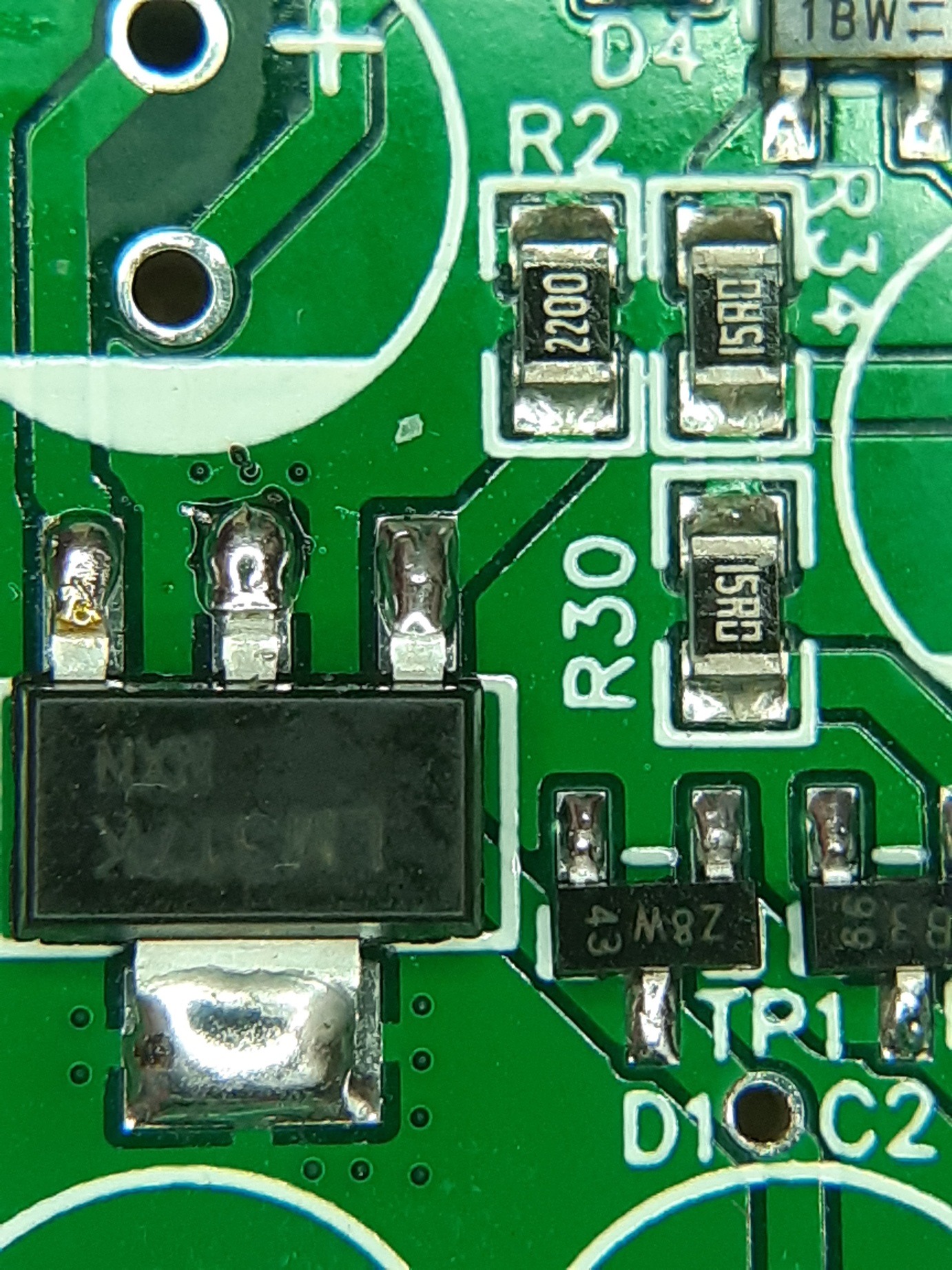

Hi Guglielmo - those TP voltages you're posting have changed since step1 - the first few are too high, also there's too much current flowing. I normally get around 120mA. This suggests there is a problem around LM317 - for all the first three TPs to be too high it suggests the LM317 isn't working correctly.
Please check the voltage across R2, it should be 1.25V
1.31V is out of spec, seems to indicate the LM317 is damaged. Normally we provide a spare in the kit, I suggest replace it.
Hello,
i replaced the LM317 but the only difference is that on R2 I have 1.254V and TP3 = 21.53V. Otherwise all TPs are unchanged, the thing that surprises me is that during Step 1 all TPs had tension as in the guide, including the TP5. Now it seems strange to me that all tensions are greater. I think the increase of the current to 140mA is only a consequence.
Any other idea?
Guglielmo
Any other idea?
Guglielmo
I'm really scratching my head here - there's too much current down the zener diode chain resulting in too-high TP voltages. TP2 is 1.6V too high, TP3 is too high but not 1.6V too high. So perhaps R1 has some current flowing through it, please measure the voltage across R1 (15ohm). And also measure across R35 and R36 to see what current's going into the LT1028s.
Now we have some progress - it seems the excess current is coming from U25. R35 voltage drop gives the game away.
What was the nature of your soldering issue with U25? I predict if you remove U25 your test point voltages will be normal again.
