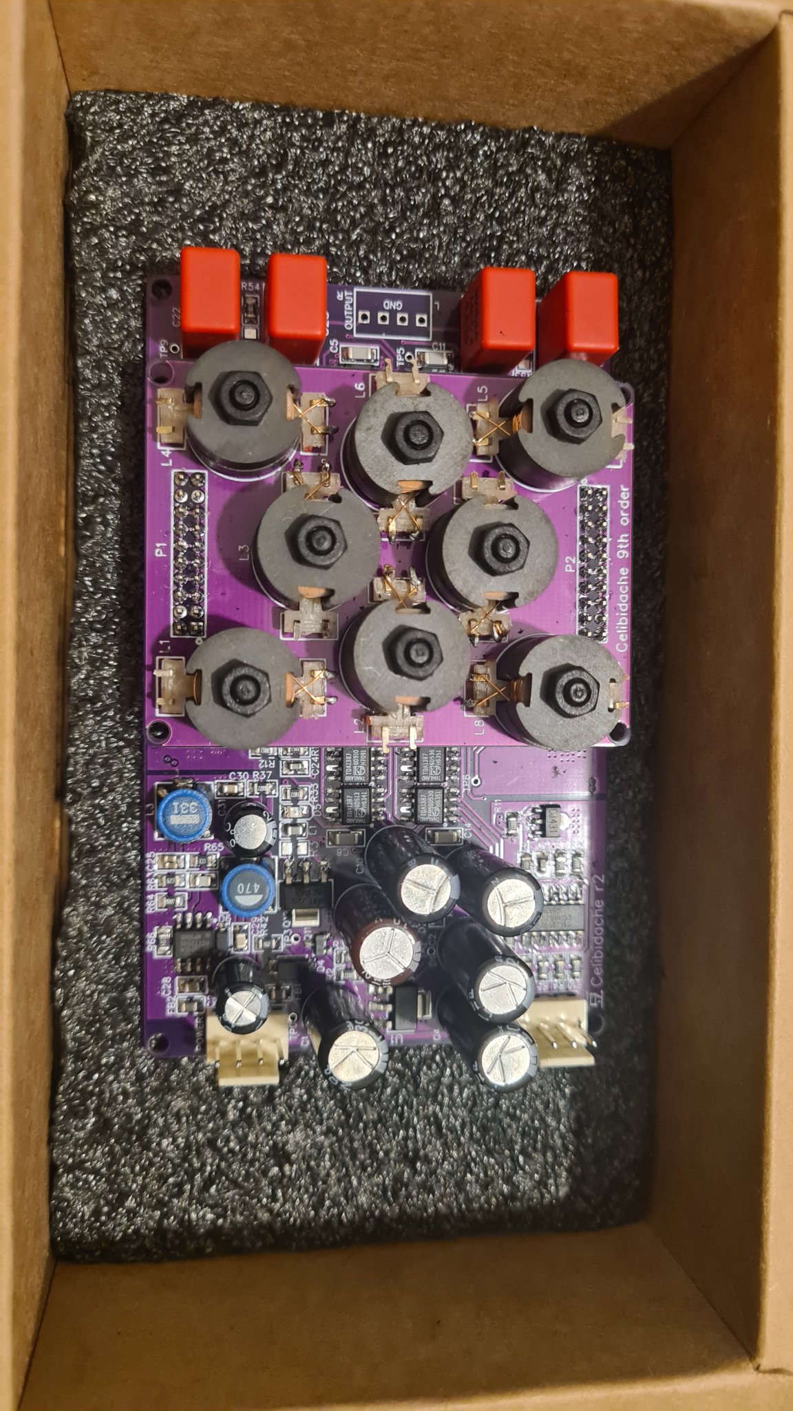

I'd suggest Celibidache yes as its incorporating the largest proportion of what I've learned over the years of developing DACs. I'm for sure curious how it compares against the Holo May which seems something of a reference in the world of R2R/multibit.
The 'output transformer PCB' is actually a bunch of inductors forming an LC filter to eliminate NOS images. That part is already fully built and tested so you just need to plug it into the finished baseboard.

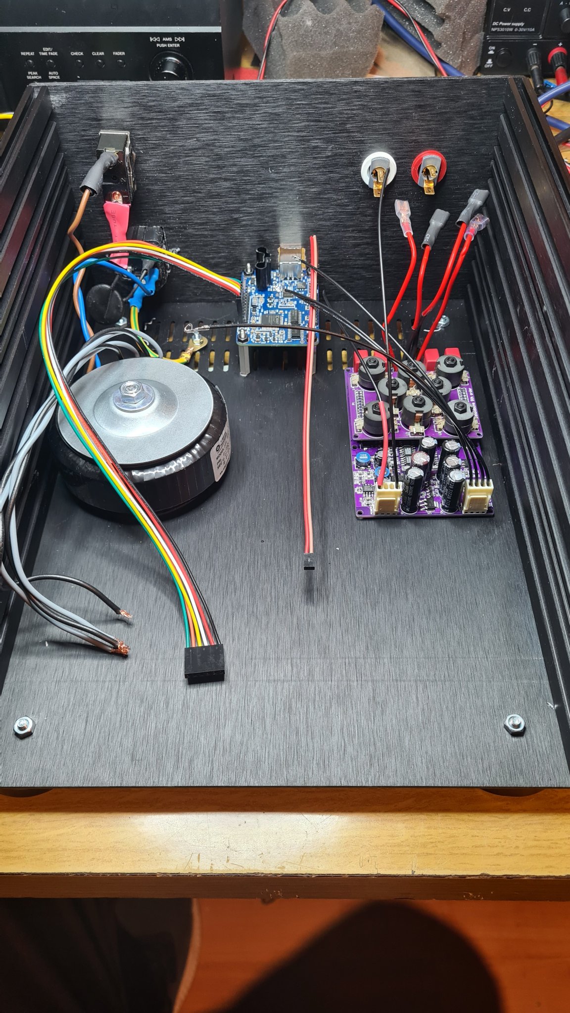

I have some progress... It seems I will finish within the month. I decided to go with separate PSU for USB part so I have ground isolation. So I ordered now the transformer, I hope I will have it end next week.
I received the box, USB part and started drilling

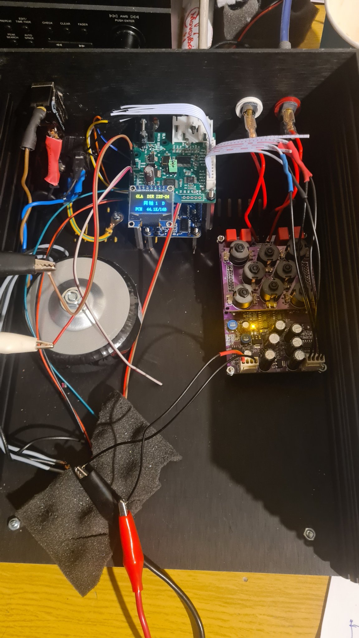

Today it played music, with external supplies, on the lab. Cross fingers, if suppliers send me stuff, next week it will be completed, I designed new power supplies with SMD parts and ordered from JLPCB. Later I am thinking to add other DACs on the same box and switch between them. I am thinking to control it with an arduino or raspbi zero with relays, it will be done in the (far) future.
I have silver soldered OCC neotech output cables directly on PCB.
OK it is difficult to say because lab system is not that special but I might say that I heard very interesting sound. At start I was a little disappointed (I have to learn some time to wait for the burn-in, it has happened so many times that i really have to get used to it. I had the same experience with my new set of speakers I designed. Woofer needed more than 60 hours to fully open... ) Back to our DAC, it seems there is detail and a lot of atmosphere.To be able to judge it must be get its place on the main system... some time end next week.
BTW complete silence when no music. Excellent.

Here is a photo
Great! You might want to consider some kind of mains filtering (a CMC, common-mode choke) as you're using a toroidal which has a fairly high capacitance between primary and secondary windings. Which makes it a relatively open window to mains-borne noise.
CMC goes on primary?
I soldered today PSU PCB boards and put a temp transformer. I put it on system for some minutes (to remove it because i had hum, need to connect 0V to earth ground). These minutes it sounded really different from my other DACS, interesting. This weekend I will have it really tested, I will get the correct transformer tomorrow, shop told me it is ready.

CMC normally goes on primary yes, due to that being lower current. I've used them on the secondary where I've wanted wire with thinner insulation (twisted pair magnet wire) and the current isn't an issue.
