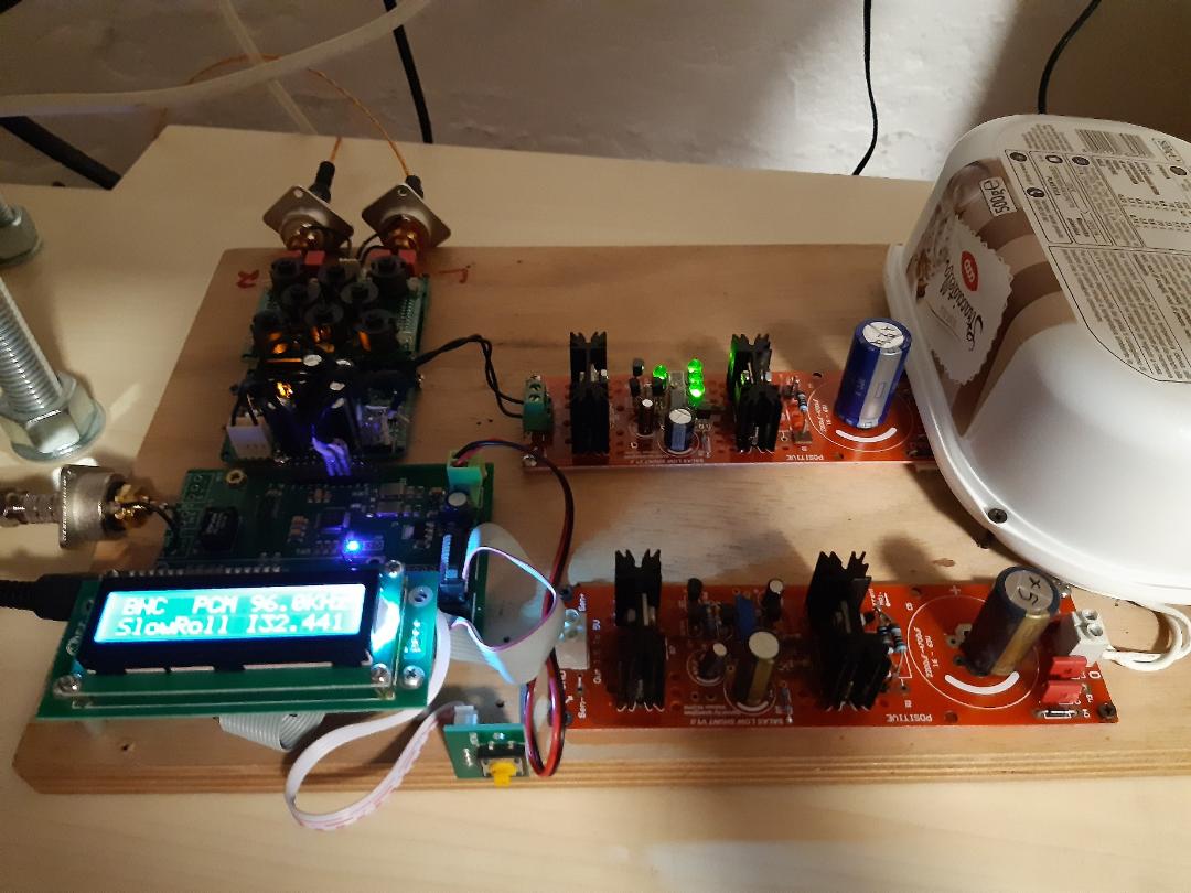

Hello,
U25 removed:
Tp1=19,25V
Tp2=10,1V
Tp3=20,5V
Tp4=2,5V
Tp5=5,3V
Tp6=2,17
Tp7=*****20,5V
Tp8=10,1V
Tp5 is 5,3V instead of 5.0V on the soldering guide. The otherTp voltage seems to be correct
Psu=24V 83mA
What do you think about?

At last, TP2 is correct 🙂
I wonder if there is some damage to the DAC power supply circuit which is why TP5 is too high. Please check the voltage on base of Q11 and Q12. Also voltage across D2 (3.9V zener). The rest of the measurements, including the current draw are encouraging. TP7 won't be correct because of the missing opamp.
That is looking as if Q11 (BC846B) got broken as VbQ12 should be about 5.6V. Do you have anything to replace it?
Can't see any problems there, you now've got the DAC supply within spec. You'd be able to get music to play from one channel I reckon. Beyond that you'll need a replacement LT1028 to bring the remaining channel to life.

Hello,
I replaced the LT1028. Now everything seems ok, all the TP of Step 2 are correct and the PSU is 24V 105mA.
Seems correct, can I proceed to Step 3?
Thanks for your great help.
Guglielmo

Hello Richard,
Celibidache is singing in my system, a big step up from the Decadac 1. It sounds different than I expected, it doesn't stand out but there is a lot of music and a lot of rhythm. I like it very much. As an input card I had one with an AK4137 that allows me to bring the sampling frequency to a fixed value of 44.1KHZ (settable) also allows you to set 4 different types of digital filter. Now I have to try and listen.
At this point the usual question: are there any parts in this dac that could be upgraded to a better quality to squeeze some more juice?
Thanks for your work and your patience.

That is excellent news Guglielmo, thanks for sharing. I will have a think about upgrades and get back to you.
