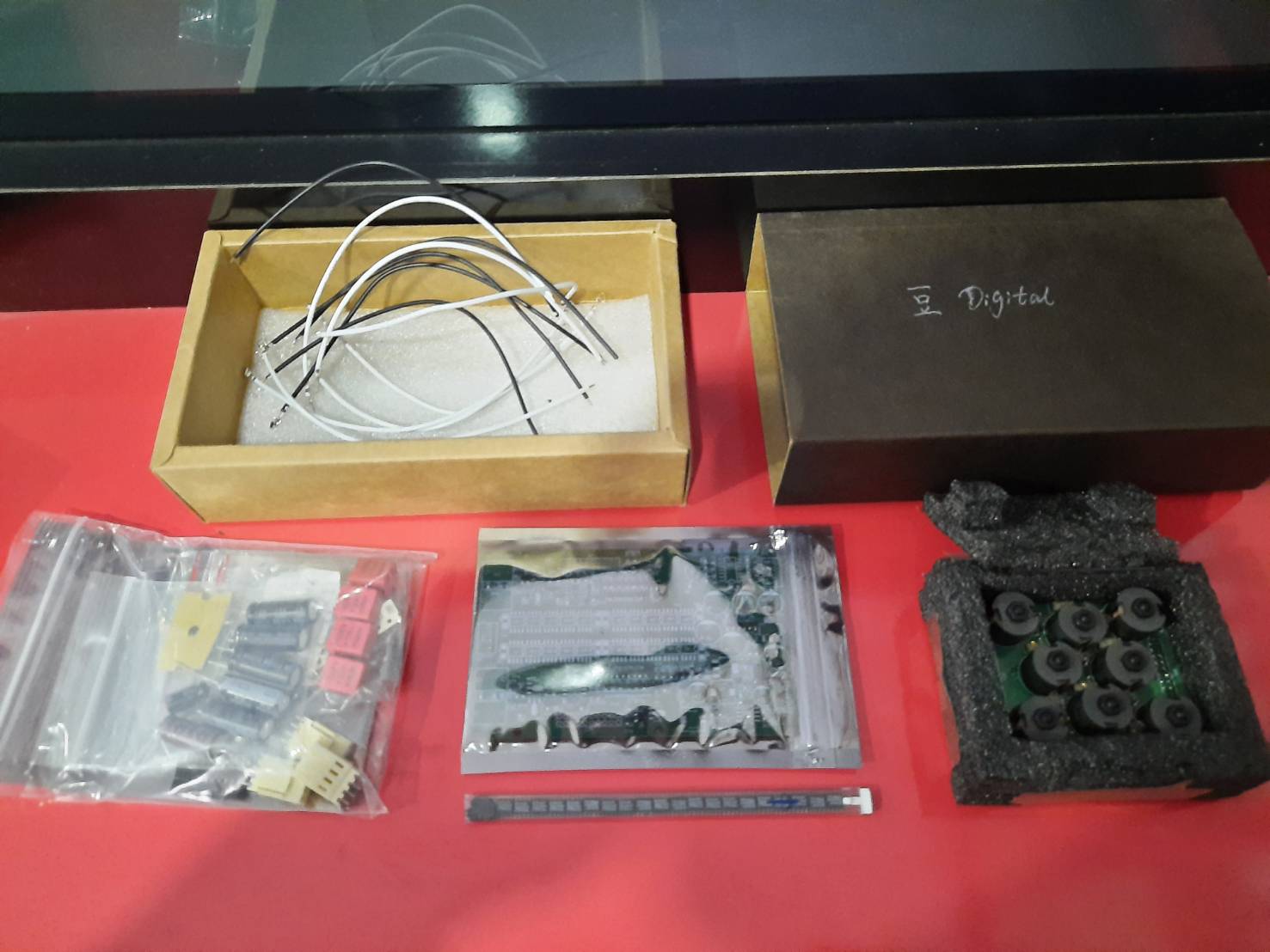

Received my Celibidache package 2 weeks ago. Thank you @abraxalito and wifey, the packaging is really neat!
Hoping to finish putting up my Celi soon!
