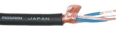

I'm not familiar with Mogami W2534, is it a twisted pair internally with 3 conductors in total?

Thanks for the prompt response! The cable is 4 conductors internally plus the shield.

With 4 conductors inside the Mogami I'd try using two for each of L and R or leave two unconnected. Wiring conductors to 0V will likely only increase capacitance to GND which is undesirable. If you short RCAs to chassis then you'll have an internal 0V loop once the DAC 0V is also tied to chassis. You could though try using a small cap (say around 1nF) between RCA shield and chassis to encourage RF to bypass the DAC.

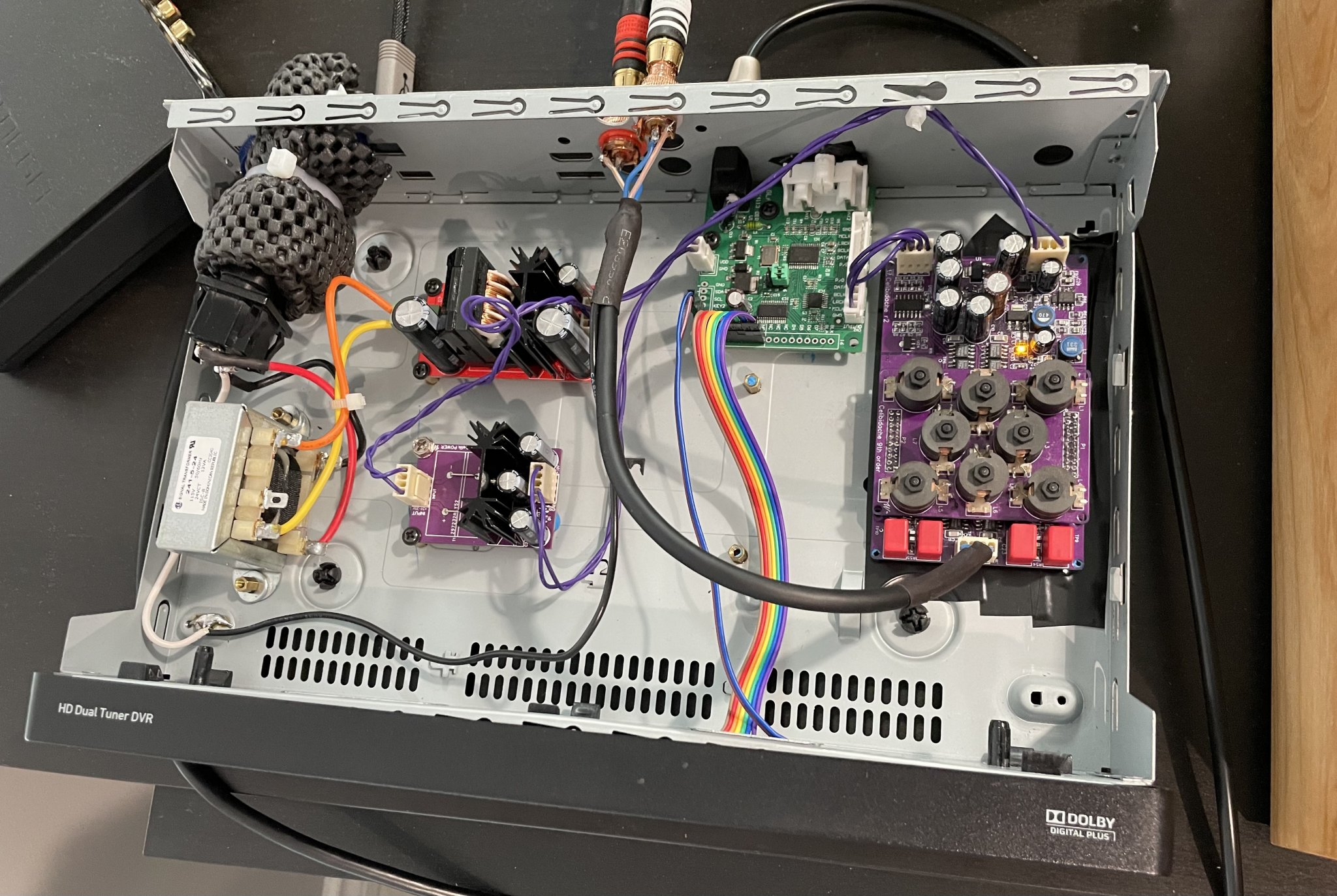

Here’s a pictures of the new layout, shortened i2s cable and upgraded RCA cabling where shield is going to the chassis, earth ground. L/R are using two conductors each.
The shortened i2s cable definitely improved micro dynamics. I think there’s an improvement of using coax over spdif now which wasn’t there before as well.
I think the shielded RCA cable improved fatigue, but I’m getting mixed results from the wife insisting it’s more fatiguing than before, but I’m out of ideas.
Would it be worth moving the components further away from the trafo? What about using shorter cable for the power cables?
Is there anything else I can do to optimize this dac?

The cable between the lower voltage (purple PCB) regulator and the I2S input board could definitely be shorter if that PCB were moved - is there enough space on the other side of the red PCB regulator? If there's the chance of a connection to chassis closer to the DAC 0V power input, I'd try that too rather than the longish wire you currently have.
You say 'shield is going to chassis' for the RCAs - have you tried without that connection? There will be a large loop with it.

The shield sheathes the wires and is not connected to L- or R-. Would there still be a loop present? 0V is not connected to chassis ground.

OK now I'm really confused. What's the role of the black wire terminating near the trafo mounting bolt? - at the trafo end it seems to go to chassis but the Mogami cable obscures where it ends up in the picture.

Shorter wires are normally better but seeing as I don't know yet the reason for the fatigue I'm making suggestions that might influence it. Making loops of cables smaller its good practice EMC-wise.

The Mogami cables has 4 conductors and an additional shield as pictured below.

Are you saying (it seems to me rather obliquely) that the black wire I mentioned in my last post is a connection between chassis and the Mogami shield? It would then follow that the shield is having the reverse effect it is designed for - instead of being a 'sink' for interference, its actually capacitively coupling interference into those 4 inner conductors because there's nothing tying the DAC 0V to the chassis. So the 0V is free to float around unless something in your amp/preamp ties them together.
My suggestion has been to link 0V to chassis with a wire at the 0V power input to the DAC board. Then connect the shield of the Mogami to a centre pin (or both centre pins if you like) of the analog output from the DAC. Connect the shield at the other end to the outer pins of the RCAs.
Its possible this will result in hum due to the grounding arrangements in your amp/pre but I feel we must try one step at a time.
