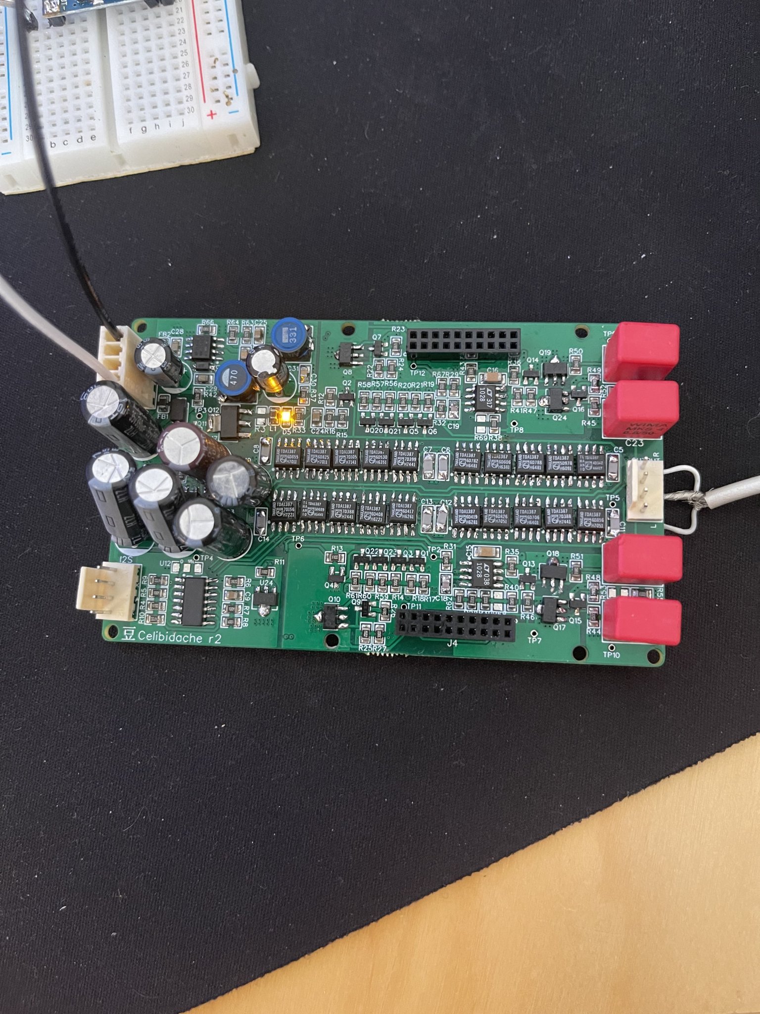

@abraxalito Hi Richard! The box arrived and it was beautifully packaged. I soldered it all up, eventhough diyaudio.com was down and I didn't have the full rez solder guide. So I was sorta winging it. Anyways I took measurements of the test points and they all are in spec except TP 6. It is supposed to measure 2v but mine is 1.8 - not sure that is within range or not. Second issue is upon first start I got crackling that slowly went away but no music. Neither left nor right. Where should I be looking for issues?
Hans - do you have a way to check the current consumption of the DAC, it should be about 130mA with 24V supplied? Also do you have an oscilloscope that you can use to check the I2S signal is arriving OK? If not I can suggest a crude way to check that with a DMM. Those would be the first steps to debugging. TP6 at 1.8V is fine I think.

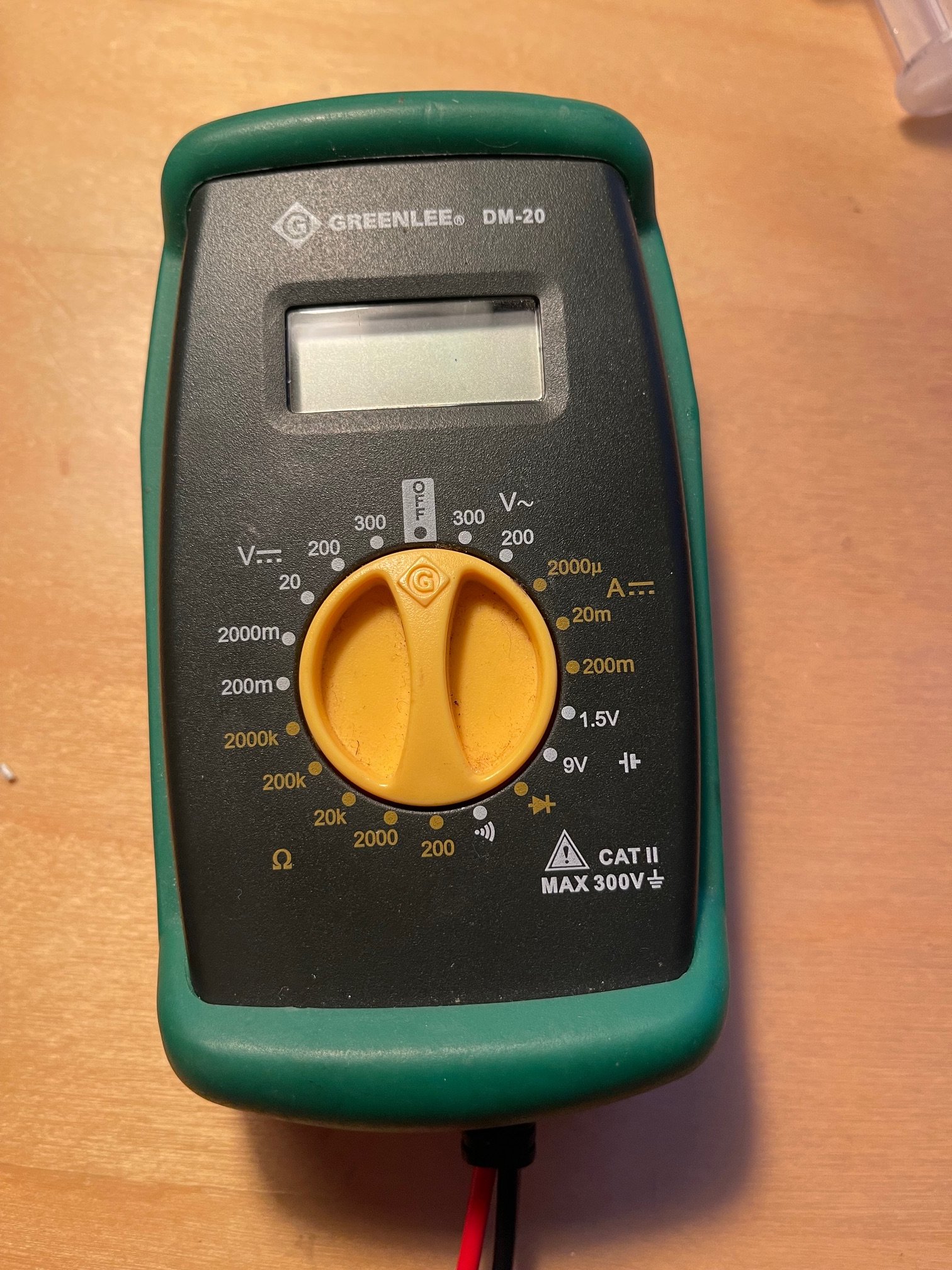

Does your DMM have a current range so you can check the consumption on the 24V rail? Now there is some music coming out the I2S must be functioning to some degree.
This is what I have. I don't think the current meter works, or I don't know how to use it. I don't get a reading and the DAC wont power on when I try to use it by having the current flow from the psu + through the DMM to the DAC.
At the 3 o'clock position it says '200mA' so it has the capability. You may need to re-plug the leads into a different socket, many meters have a different socket for amp ranges rather than volts.
@abraxalito Hey Richard, I was able to test the current draw and it is 121.1 mA. Supplied voltage is 24.

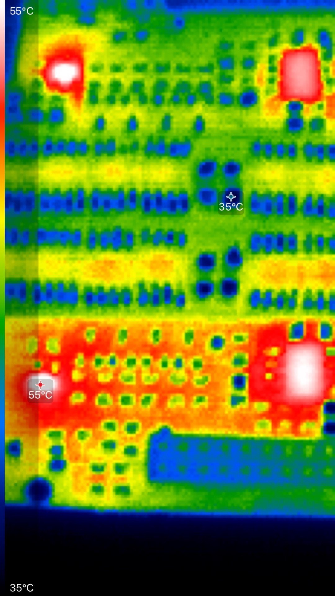

So I have double checked all solder points and there are no bridges. I have checked all TP and they are all nominal except TP6 @ 1.8v, which you said was ok. There is 6mW on the left and right output with or without the filter plugged in. The outputs are dead silent when no music is playing and is full volume crackle fest when music is playing. Here are some IR pics showing that only q4 and q2 as well as the opamps are putting out any heat at between 50-60c. In the picture opamps are on the right and q2 & q4 on the left. All other chips look fine.

Supply current seems fine. '6mW' do you mean 6mV DC offset? My suspicion - based on the fact that at first you got nothing but after resoldering you got distorted sound - is that there's something amiss around the I2S input circuitry. Which 'bunch of contacts' did you resolder initially, when the DAC was silent? When fault finding the most likely fault is just a 'single point failure' which can account for the evidence. Given that it seems you get distortion out of both channels its unlikely to be the analog circuitry, which is separated into L and R channels. So we'd need two faults in the analog circuits to account for what you hear, but the I2S is where the L and R signals are combined, using the same connections.
The I2S circuitry is bottom left on the PCB, near to the I2S connector. It includes six (lower and left) of the resistors around the IC, the 74HC86 IC and U12 the phase setting 0R.

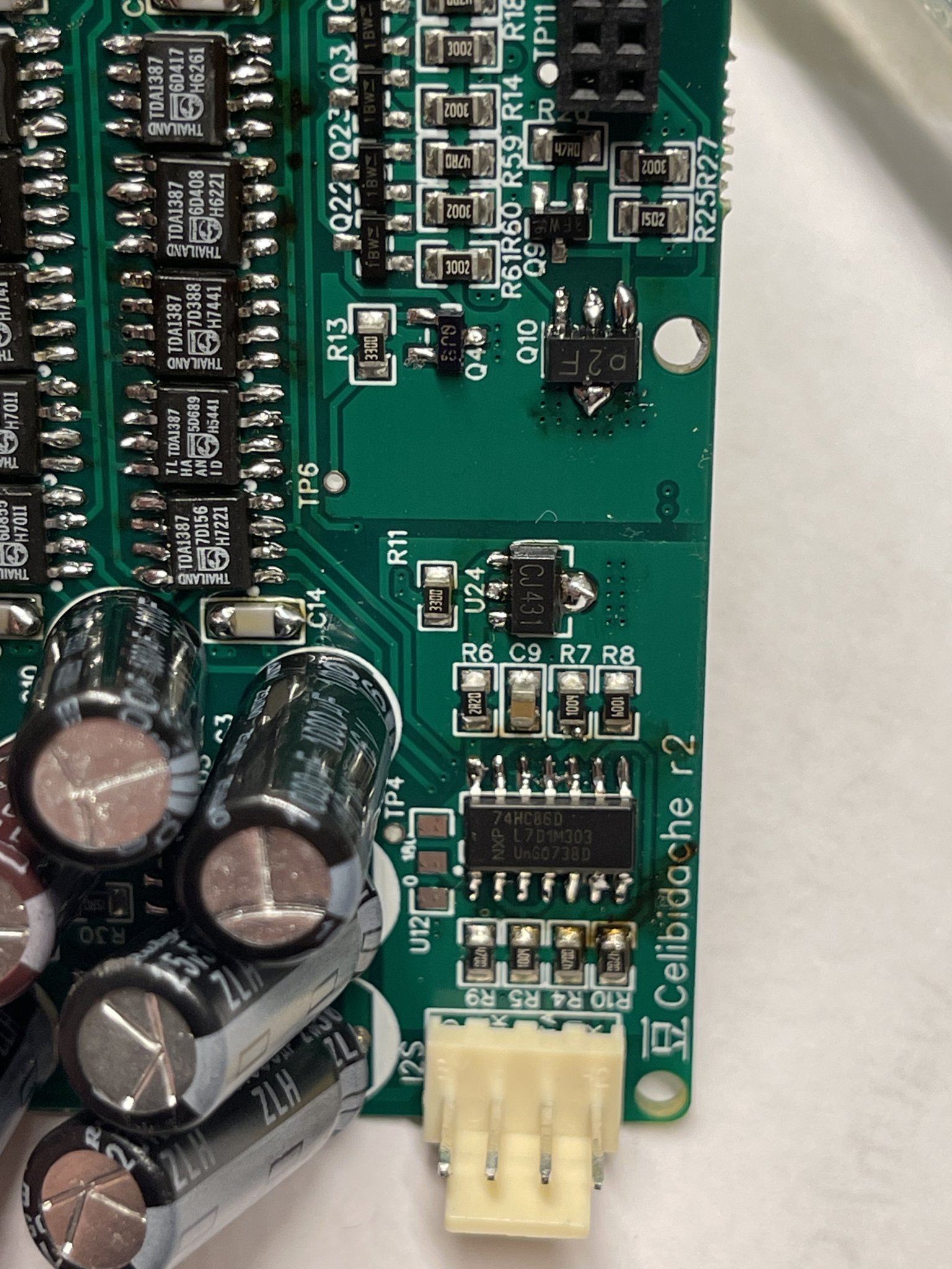

In these 2 pictures you can see the solder bridge on one of the chips. That has been cleaned up. On the other picture you can see that chip looks like a mess. On the bottom right and top left were suspected solder bridges but in the middle top is some solder paste residue. I have since cleaned up the soldering and took a tooth brush and isopropyl alcohol to the whole board to get rid of any residual solder paste and all that flux. Once I did all that, I did get music but also full volume distortion. Do you think that i2s chip is damaged somehow? Ignore how crazy the caps look. I didn’t seat the fully since once I get it running I will be playing around with those. There is also a full board pick in case something jumps out at you.
There are some suspect solder joins in the first picture, i.e. C6, C7, C12 & C13, and it looks like there is a solder bridge between pins 10 & 11 of the IC in the second picture.
Good idea Hans to share pics, from your 2nd one I have found something that may well be a major contributor to your issue. U12 (the three pad resistor footprint adjacent to the 74HC86) needs a 0R 0805 fitted, the default is between the left pair of pads. We show this by making the left two pads pinky purple in the stuffing guide. Without this resistor the I2S Data line is undefined and so it could easily be the cause of your full-volume distortion.
So after fitting the 0R on U12, it plays perfectly. Thank you. Now I need to listen to it for a while and let it burn in. It does sound quite a bit different from the phidac quad.
