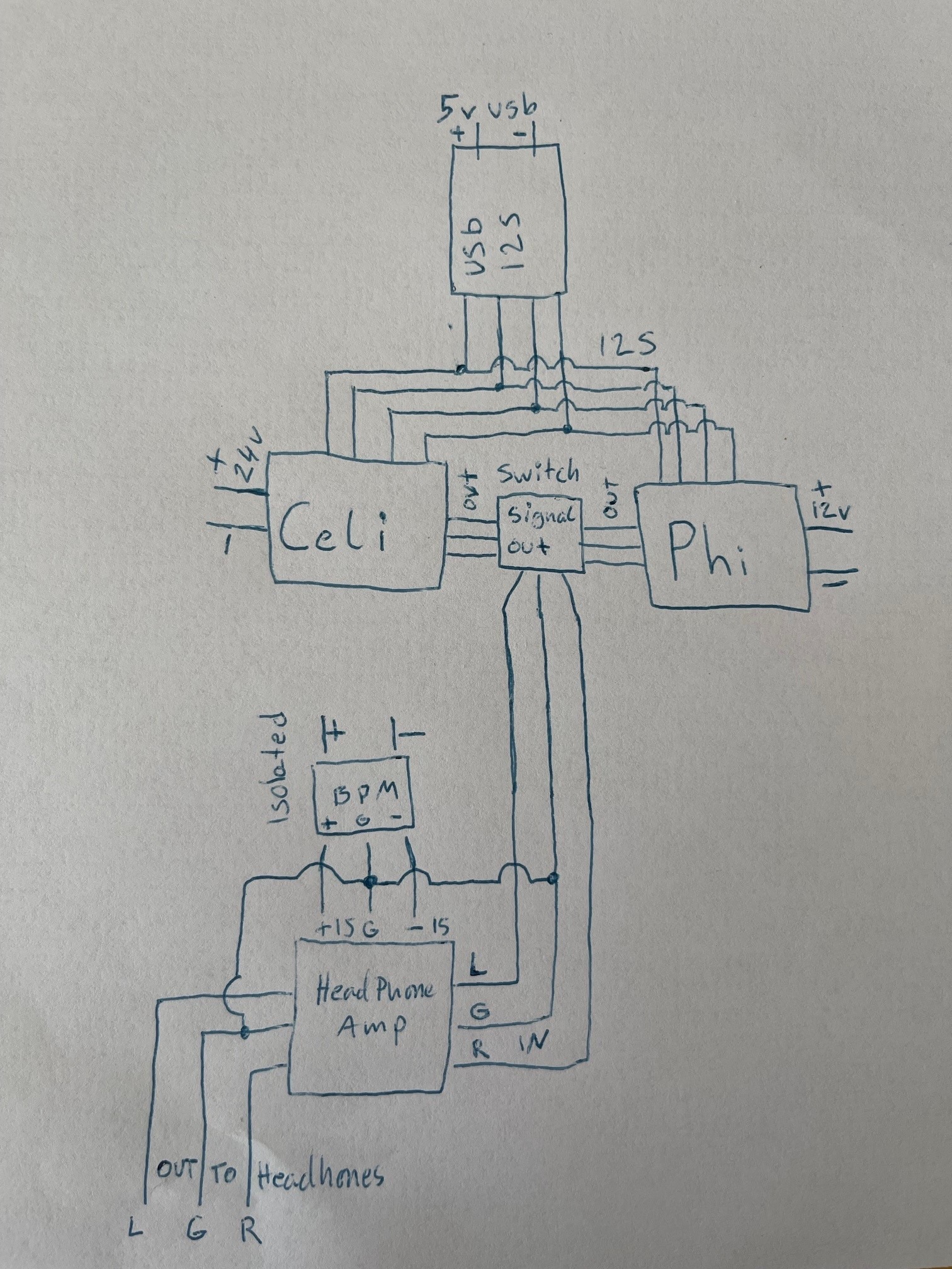

I have a strange problem that I can't seem to fix. I am trying to put my system together so I can switch back and forth between the Phidac and the Celibidache. However, I am getting a ground loop issue (at least I assume it is that). Here are the main components and how they are connected.
Setup 1. SMPS 28v. I had it hooked up with all three wires: main, neutral and ground. I used this to power the whole system. It went like this:
28v -> TPS7a4 regulator to 24v to Celibidache.
28v -> TSP7a4 19v -> LT3045 12v to Phidac.
28v -> BPM15-150-Q12-C to +15v 0v -15v for headphone amp.
There is a switch that turns on either the Phidac or the Celibidache.
There is a switch that selects the output from either the Phi or the Celi to go to the amp.
This works as it should.
Setup 2. I have a recycled amplifier case I wanted to put the SMPS into but it only has main and neutral. No Ground Wire. All components are hooked up the same but now there is noise in the system. The fact that the I2S are all connected did not make a difference since I tested it with disconnecting one Dac and the other. No difference.
The BPM15-150-Q12-C gets warmer and sometimes when I touch it, the noise goes away. If I power the BPM15-150-Q12-C from a separate power supply, the noise goes away.
Is this a problem because the BPM15-150-Q12-C is Isolated? I tested the center tap from the BPM15-150-Q12-C to it's ground on the input side and measured continuity.
Having multiple PSUs is not ideal, so if there is a suggestion to fix either this circuit or, alternatively, is it safe to run another power cable (that includes a ground wire) to the box and connect the ground to the chassis and then the SMPS to the same point on the chassis?

Hi Hans,
I've been thinking this over for some time and am I right in thinking that the only thing that changed (electrically) between your two scenarios is that there was a mains earth connection in (1) but not in (2)? If so then I would try introducing the mains earth to Setup 2.

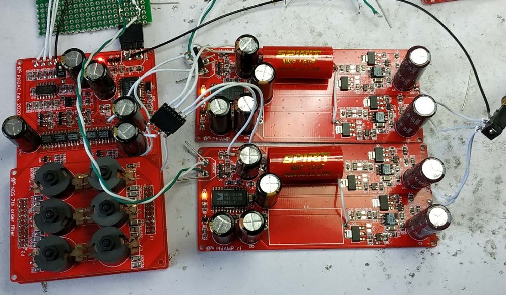

@abraxalito Since the thread for the Phiamp is closed and I am running it from the Celibidache, I will post my question here 🙂
Based on the picture you attached, I do have some questions, (only because it is not working for me). The version I have is the r2 (in the picture is r1) and the left and right channel have more resistors/capacitors but unlike in this picture they are not equally populated. The right channel has more resistors and the left has some blank spots.
I tried replicating this setup; A) both boards powered with 12v from the same source.
B) Ground and left signal to one board and ground and right signal to the other board input.
C) Based on the jumper from the input cap to the second channel and two wires going from the board output to the headphone adapter, both channels are running in parallel and get hooked up to the headphone plug together. (If I am interpreting this picture correctly)
D)The headphone jack is not grounded to the boards but goes to the DAC ground.
Very first test I tried one board, and it produces sound in one channel only, as it should (since these are supposed to be two boards paralleled) but it was grounded from the board to the headphone amp. However, when I hook up both boards according to this image, I do not get full stereo, just a very faint volume in one side only. So my question is: Since version r2 is different (more resistors/capacitors) and one channel is not populated like the other, what is the correct way to run them in parallel? Do I still jumper from the input cap to the other channel? Do I only attach one output instead of bridging the left and right outputs per channel?
So it seems one board works and the other does not. The diode lights up on one and not on the other. I have taken some voltage measurements while powered on of the 4 capacitors as arranged in the photo going clock wise. Input voltage is 11.5v
Cap 1 on the good board is 10.02v. On the bad board is 3.25v
Cap 2 (the one in the middle) 11.48v on the good board. 11.48 on the bad board.
Cap 3 on the good board is 10.01v and 4.07 on the bad board.
Cap 4 on the good board is 5.57v and on the bad board is 2.4v.
The LED feeds the reference voltage which is used to generate the supply rails for the amps. With the LED off the reference voltage is not going to be biassed. Cap4 (I'm taking it that this is the bottom left on in the pic) is across the reference. The power to the amps is multiplied up from the Vref by 1.8X. Caps 1 & 3 are across those rails. So the investigation of what's gone wrong should start by looking into why the LED isn't lighting up. The LED is fed by current source Q1,2 (next to power inlet) and a check of the voltage across the current source resistor (R1 I believe) should reveal whether the CCS is working.
Just a heads up that grounding the power board did indeed solve my issue. Would you happen to know what kind of fuse I should install on this sucker at my inlet? I’d like to add one.

For a mains fuse you'd want no more than 1A, slow-blow. 0.5A if you can find it, 'T' is the marking for slow-blow fuses, meaning 'time delay'.
@abraxalito Thank you for pointing me towards wondering why the LED wasn't working. It was missing.. which explains a lot. Well, I had a spare and so it is all good with the Phi Amp.
