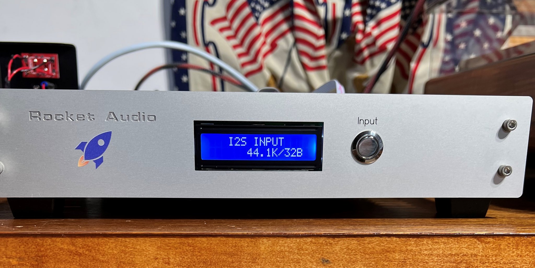

How do you switch betwenn inputs (eg from USB to SPDIF)?
I see 2 different input cards and presume output is from the second card in I2S format, but wonder how you switch inputs...

Seen that, hence the question... care to elaborate how it works?
I mean is the switch to switch between cards (say USB and what is not), so a choice of 2?
Then on the non USB card (SPDIFs) what signal gets priority?
Or did you find a way with a push button to go through the various inouts, but then how?
Sorry, newbee on all this

The SPDIF board has inputs for a switch. It is a momentary contact switch that will cycle through the inputs.

It will cycle through the inputs... is there a provision for an additional input on tio of USB and fiberglass and coax you fitted?

Claude - the input card I normally recommend has two coax S/PDIF inputs, a Toslink and an external I2S (which usually receives the USB input I2S). So you could handle Bluetooth if you used a BT-> Coax board. Something like this : https://www.aliexpress.com/item/1005001771461083.html
