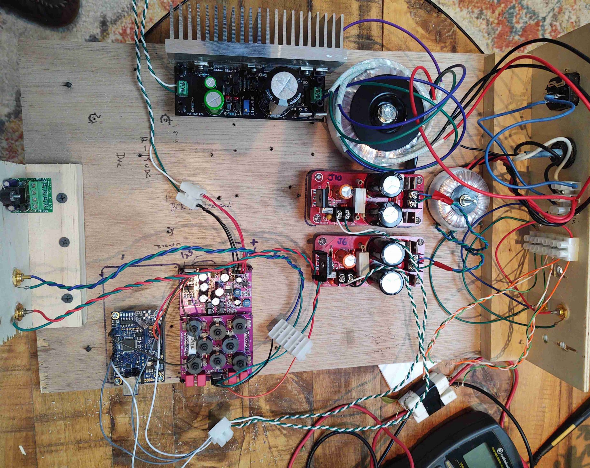

A new Celib DAC is born. Hooked it up temporarily on a prototyping board just to get things working. Using a UBIB psu for the Dac and a JLsounds I2S input. Yes the wiring is a mess but everything works. waiting on another trafo for the I2S since the single one is too small and a bit under voltage, but so far sounds very promising. I'm going to order a nice 2U case from the Diyaudio store to house it in. Once everything is cleaned up and sorted out I'll do a direct comparison with my Decca NOS dac, a AK4493, and a ESS9038K2M DAC.

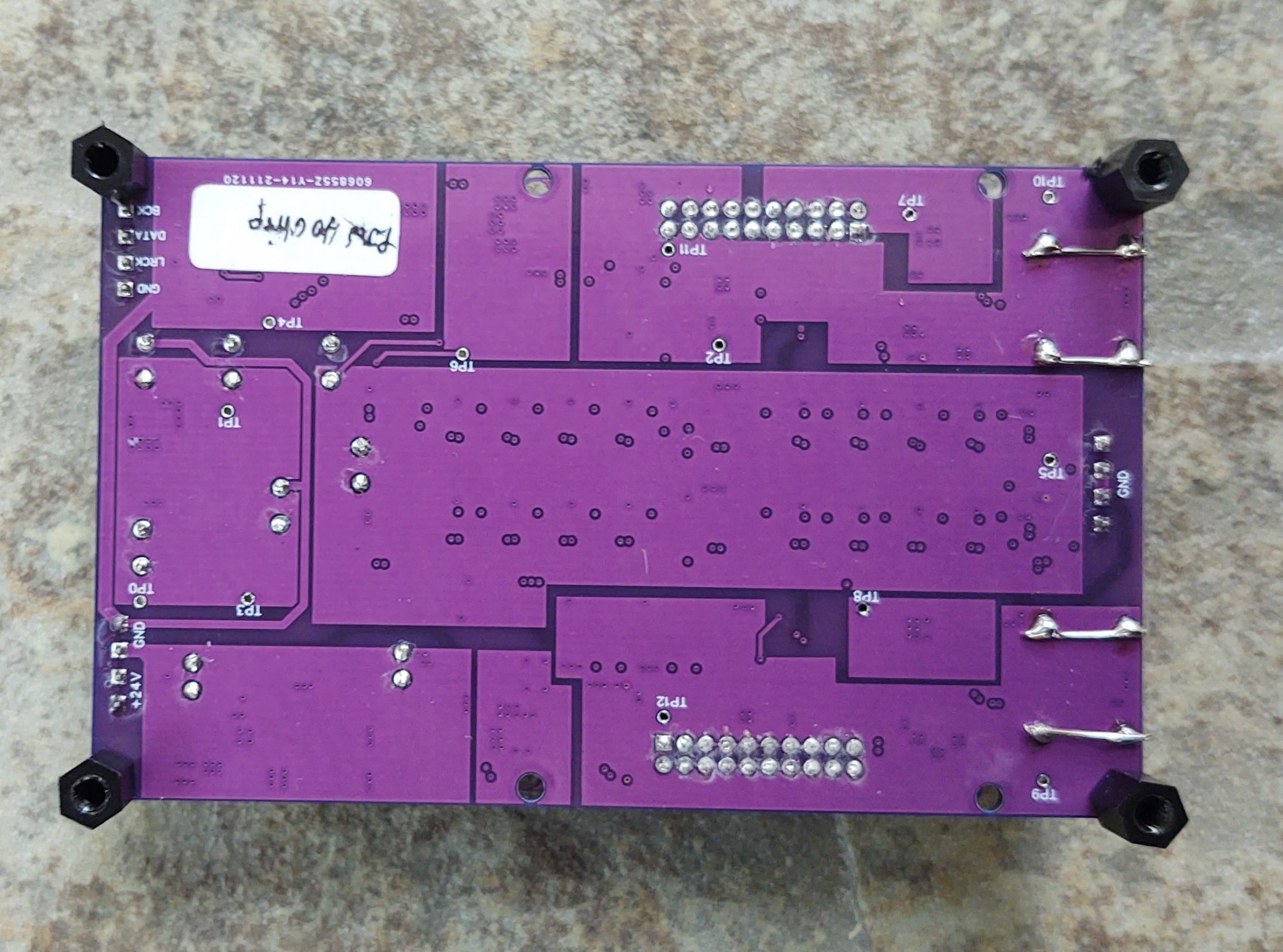

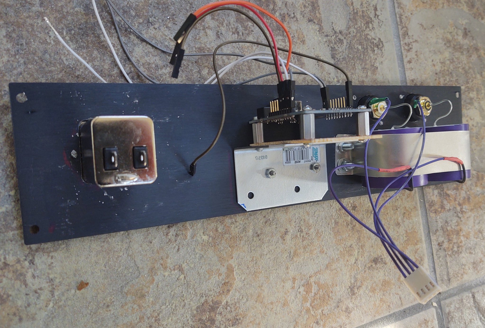

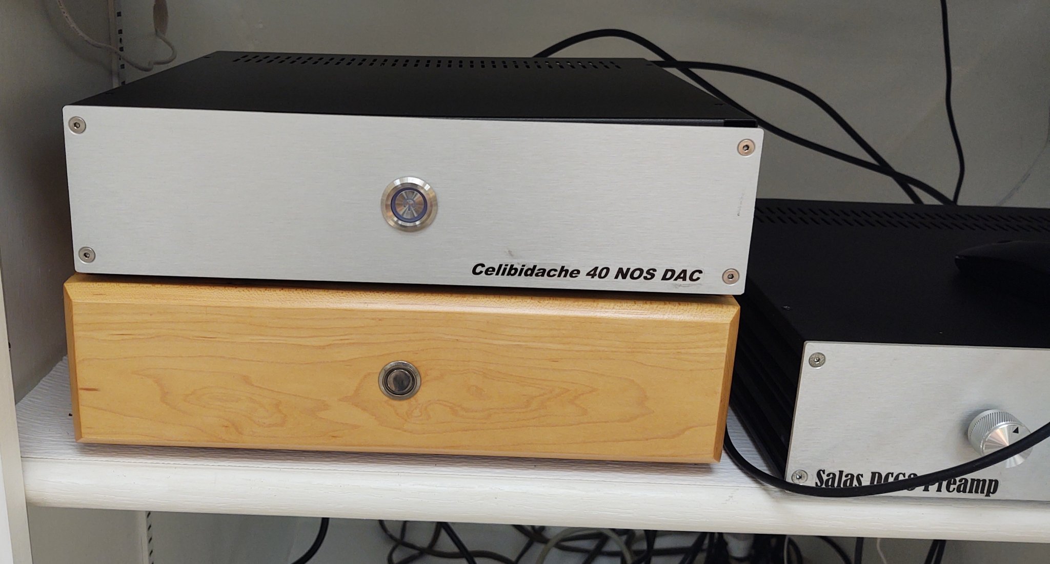

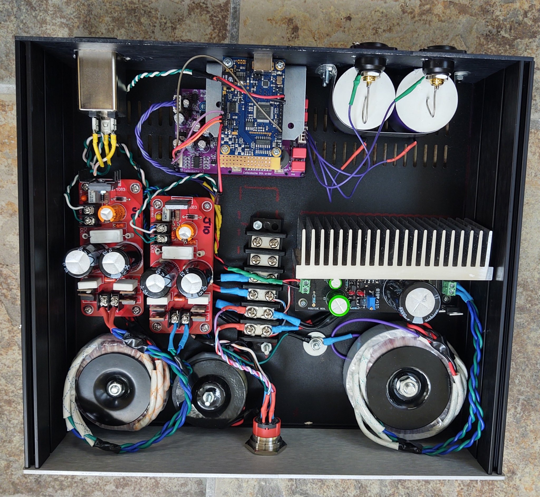

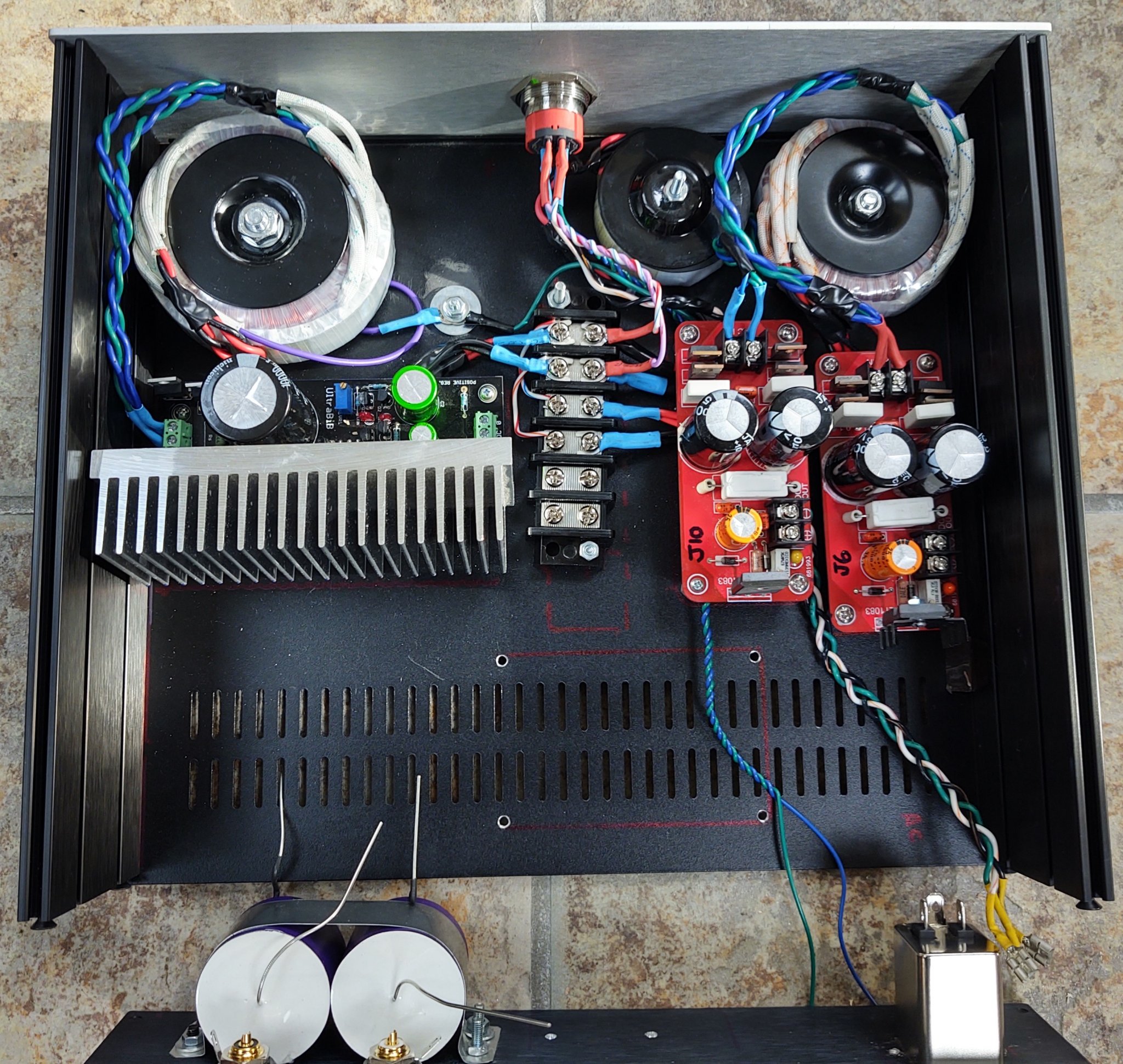

I finished assembling my version of Celib dac. This version has 40 dac chips that Richard was good enough to put together for me. Here are some build pics. I used what I had on hand by scavenging other projects, I'm using a JL Sounds USB to I2S for the input. Three separate PSUs, a Salas UBIB for the DAC and two separate supplies for the USB module. I bypassed the coupling caps and used some nice clarity caps for coupling mostly because it made me feel better, it does seem to make a small difference for the better though. I used a 2U galaxy enclosure from the DIYAudio store. It was a bit of a challenge to squeeze everything in, but it worked. I'm listening to it now, I also have a Decca dac that I really like, the Decca is more laid back with a mid hall presentation and very nice layering front to back and side to side in the sound stage. The Celib sounds more forward, front row, with excellent soundstage, and seems more detailed, great dynamics. Both have great base definition. I'm listening to Oscar Peterson live at the blue note, with the Celib the low level ambience of the live recording is more easy to make out, still there with the Decca, but more subdued, farther away. I compared both to a nice AK4490 with same PSUs and input, for me it had a flatter more two dimensional sound stage plus the leading and trailing edges of notes were not as good the NOS dacs both sounded more realistic. I liked the NOS dacs better. The bottom line to all of this is that the Celib dac sounds excellent.
