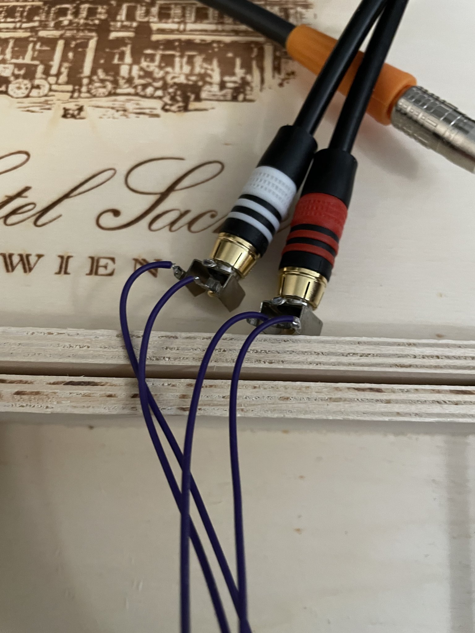

The RCAs we sent you have cube-shaped lugs, that's where we solder the ground wire. Needs a chunky soldering iron as there's quite some volume to heat. I don't know about tabs as they're mechanical things and beyond my limited electronic knowledge 😛

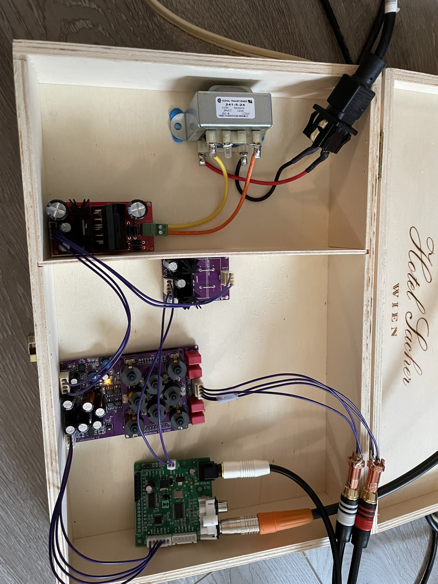

Assembled this up today, but not getting any sound from either channel :/
Am I doing something wrong? Only getting static when I plug in and unplug the dac to mains power.

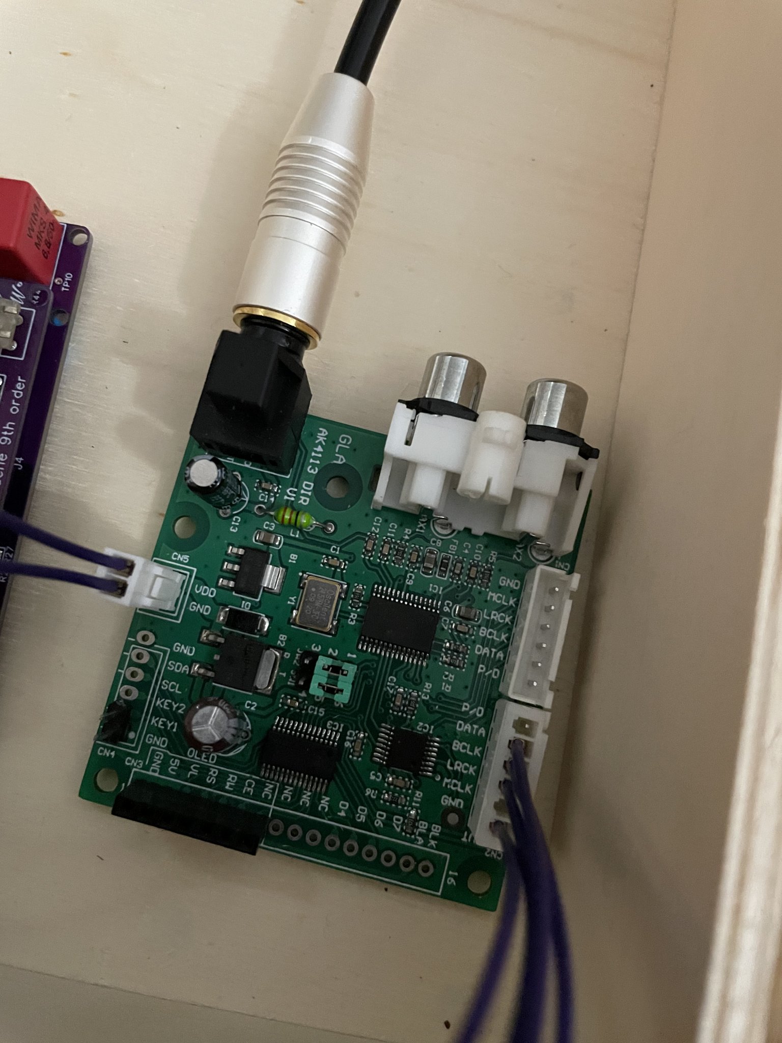

I think I narrowed down the problem to the spdif board. It’s being fed 9 volts, but I think the input selection is wonky.
From what I remember about the S/PDIF board, the default input is Toslink. If you want coax you need to toggle the switch input contacts.
Also the RCA sockets are so shiny that they need some scratching on the outside to make a reliable contact. Could be they have a very thin layer of lacquer on them to make them look so bright.

I tested the RCA jacks with my multimeter and they appear to be conducting correctly. I think the spdif board has an auto input selection mode. Do you know to turn it on?From what I remember about the S/PDIF board, the default input is Toslink. If you want coax you need to toggle the switch input contacts.
Looking at my copy of that board its looking like the default is 'auto'. Under the PCB on the silkscreen roughly in the middle it says 'OPT1 SHORT | AUTO' and indeed there's a solder short on OPT1. Worth checking if your OPT1 is indeed shorted.
Replaced the rca connectors with something a bit more simple and removed the short for opt1 just in case the auto sensing is causing issues.Looking at my copy of that board its looking like the default is 'auto'. Under the PCB on the silkscreen roughly in the middle it says 'OPT1 SHORT | AUTO' and indeed there's a solder short on OPT1. Worth checking if your OPT1 is indeed shorted.
Shorting the switch selection does seem to cause the odd click of static every once in a while. May I ask how the jumpers on the top of the board are arranged for you.
Jumpers on my top side are 1-2 and 5-6 shorted which looks the same as yours. That config is I2S, 24bit which is correct.
BTW - you can do a rudimentary check on the I2S lines with a voltmeter - if there's signal being decoded the LRCK and BCK lines will show the average voltage, around 1.6V. If no signal they'll show zero.

Your trafo is CT but you don't have the CT wired. ( although I see your dac has the LED illuminated). Is this an issue?
I checked what kind of voltage would be provided if I used the different taps on the transformer, but only the outer taps provided close to the correct voltage. Other voltages where 13-15 Volts.Your trafo is CT but you don't have the CT wired. ( although I see your dac has the LED illuminated). Is this an issue?
At load, the voltage off the trafo did drop to 28 volts at least.

I unplugged from the wall and unplugged the Celibdache and spdif board from the PSU. I wanted to check if the spdif board was actually receiving 9 volts, which it is. When the PSU was plugged back in to the Celibdache it didn’t power on the LED anymore.
Its possible then that the LED's gone out because the supply voltage went too far above the recommended supply (24V). Please check that the red PSU board is still putting out 24.3V - but not before retiring for the night!
What I'm guessing has happened is you hot-plugged the Celibidache into the PSU. Because there's a cap at the input to the Celibidache that's a momentary short-circuit and exposed the regulator on the red board to an over-voltage condition. When I warned about not short-circuiting the output I should have added 'and don't hot-plug it' - my omission.
After a good night sleep I revisited the project this morning and found that the ground wire, of the blue jumper cables, that went to the Celibidache, from the PSU, separated from the gold contact. It's now soldered in nicely and the Celibdache powers up well.
To answer your questions, the PSU is putting out 24.26 Volts and everything is powered correctly. Nothing was ever hot swapped. The transformer was always unplugged before touching anything, and I waited several minutes if I was going to touch any of the PSU components.
Still no sound though :/

Just an observation but your I2S hook-up connections look too long for optimal performance, the general rule of thumb to keep them under 10cm - remember that I2S is a protocol designed to interconnect ICs on a board, not as a cable interface.
Thank you! I will keep that in mind when I move this to a metal case.Just an observation but your I2S hook-up connections look too long for optimal performance, the general rule of thumb to keep them under 10cm - remember that I2S is a protocol designed to interconnect ICs on a board, not as a cable interface.
