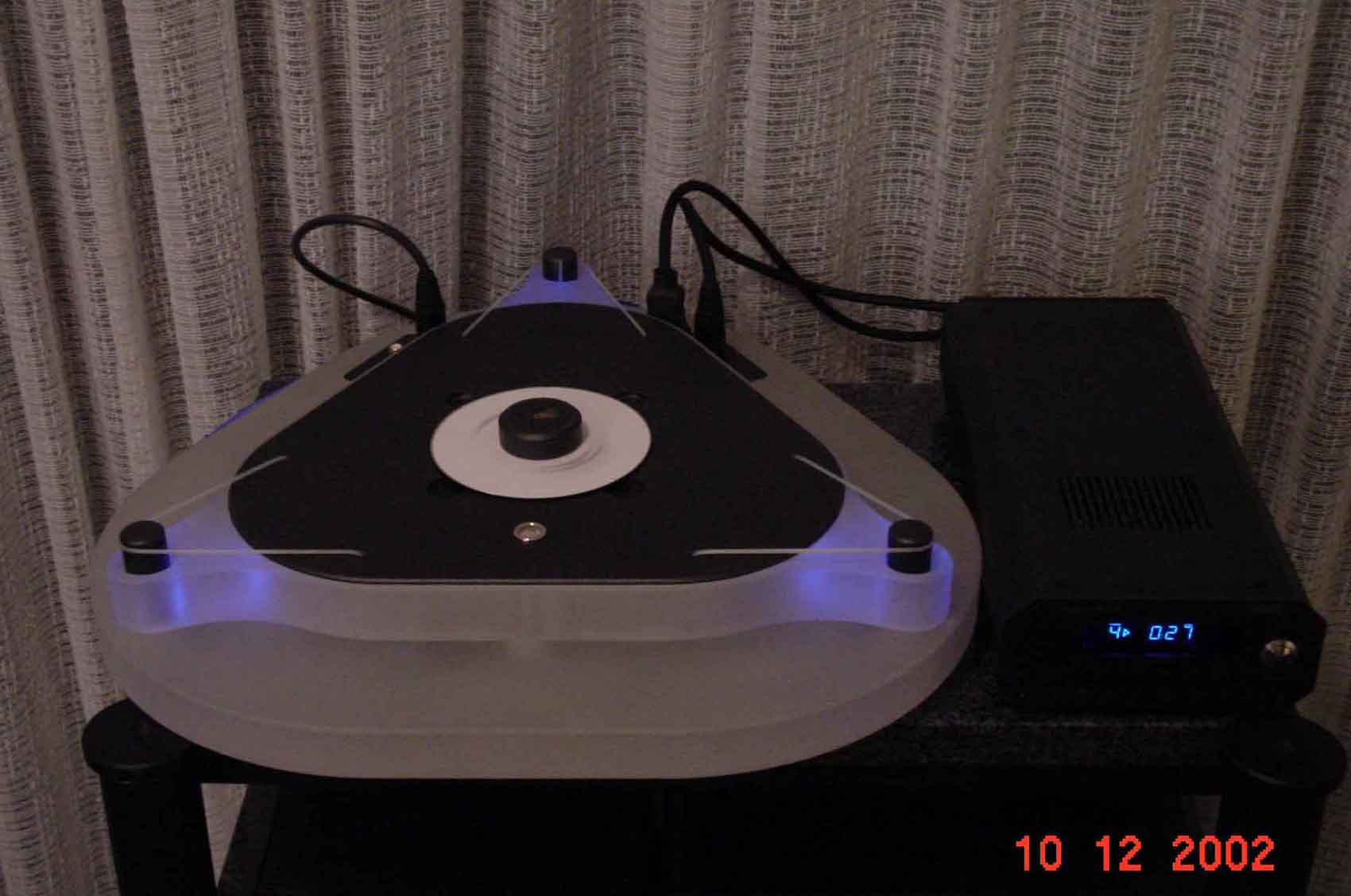

Re: CDPro2
Nice Machine work on the Acrylic casting Peci.
Regards
Anthony
peci said:Nylon strings are support for upper plate where meshanisam is fixed, acting as vibration dumper.
Regards
Anthony

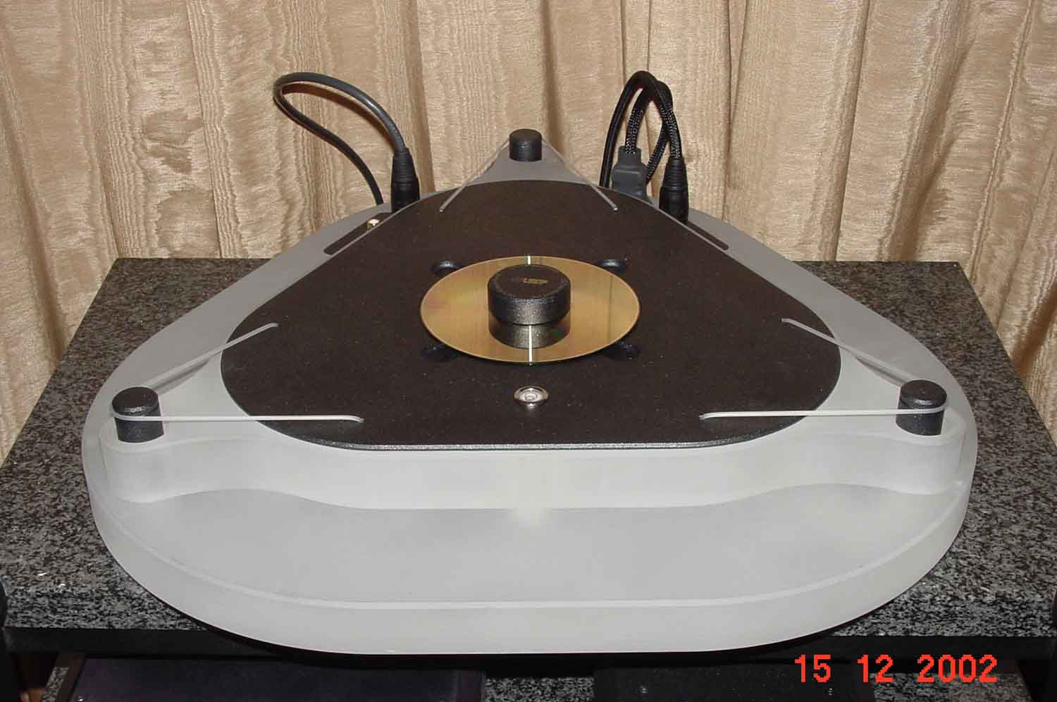

Hi Peci
Very nice piece of equipment you've built there.
Building my own transport is also on my "to do" list. All I have so far is the display!?
Cheers
Walter
Cheers
Walter

suspension!
Here is another way to make the CD-PRO2 module 'floating'.
The spring of CD-PRO2 just sit on the gold-plated column.
Re: suspension!
Is that one of those kits out of Hong Kong?
Regards
Anthony
YENFU said:Here is another way to make the CD-PRO2 module 'floating'.
Regards
Anthony
