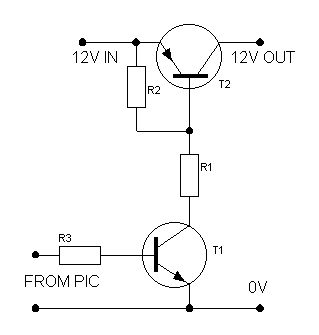

Hi BrianGT,
I'm in the process of designing the "supply sequencer" by using some transistors as switches.
The main issue is how to get negative voltage from the pic that could only provide 0 or +5V.
But for the DAC I'e got a negative voltage (-15V) that needs to be sequenced as well. Do you have an idea of ho to do this ?
Attached is a schematic to explain how using transistors as switches instead of relays.

This wouldn't be too difficult to implement in conjunction with configuring the power supply to power up based on the microcontroller. You probably wouldn't even need to have a power switch on the unit, just a standby switch, which powers down everything except for the microcontroller.
I would rather see relays used for the power supply, rather than transistors. This would make life easier. A few control lines, or a serial IO expander could be used to control the relays. This would be a cleaner implementation. Relays aren't that expensive that it will be much of a worry.
Brian
