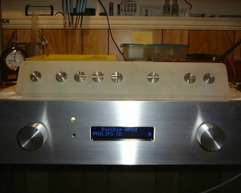

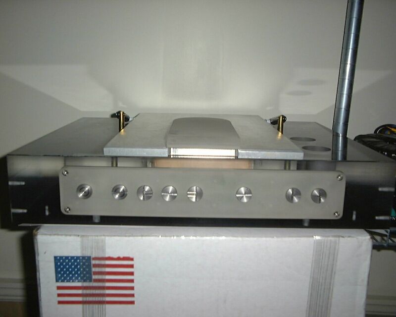

Hmm, I'd have to say option A or an optical encoder.
I say this, because it'd be very difficult to present those tactile switches to the user on the outside of the chassis with them being so close together. Maybe option a is too spread out, but it enables you to do the switching system that brian has employed through his front panel. I'm intending on doing a similar system but through wood.

My opinion is that B is the best option. The buttons portion of the pcb can be made so the it could possibly be cut off, and attached with wires (add holes for header pins). This would allow for the using a custom button board, or relocating the buttons on your chassis. It is quite easy to P2P wire the buttons on a perf board also. The schematic is posted above. I like the idea of only having one board to assemble and attach to a simple chassis.
I will draw up a new layout when I have time and post it.

My vote is for option b.
with the option of locating the buttons where you wish for custom cases as Brian stated. wood is also my preference for case
