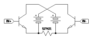

OK, what I have in mind is a hybrid amplifier in just two blocks.
What possibilities do we have for a very basic bridge output topology?
Balance is important, things like complementary structure not.
Anyone, please.

Circlotron ;-)Lumba Ogir said:OK, what I have in mind is a hybrid amplifier in just two blocks.

Peter,pietjers said:Would love to hear more comments on the output stage idea I posted in post #30?
Hhm, just a feeling from the stomach, so to say... I would perhaps rearrange the cascoding more horizontally than vertically. That is, each stage cascoded with the corresponding cascode transistors, not with the complete stage as a whole. Like cascoding predrivers with predrivers, drivers with drivers and outputs with outputs. This would shift the working conditions (and the timings issues) a bit (and would save two resitors). Hard to say if it would make things better or worse or maybe it's just insignificant...

Thank you for your great idea!
I think this is what you had in mind.
By fotopeter

I would put some resistors between the upper and lower cascode's for the pre-drivers and drivers you would be surprised at how quick this topology will oscillate without them.

Thanks Philip, (nice stages you have there). A bigger difference seems to be that you derive the cascode voltages from the output. Maybe one could get away with lower/no cascode emitter resistors with a input derive topology (as they defeat part of the cascode action depending on standing/max current ratio in the predriver/driver)....
