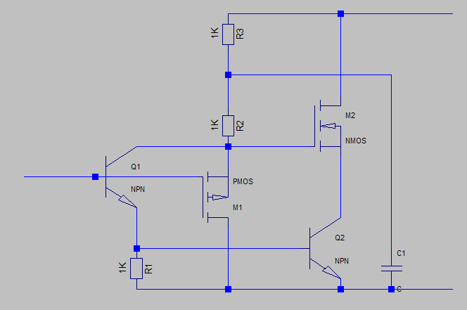

" I can suppose variant of cascode replacement of pair npn transistors. Using of MOS power transistors is preferred because its SOA is larger and output impedance much higher. First MOS transistor must be ordinary. Second - logic level. "
Replacing Mosfets ith BJT's is not my Cup of Tea. I am one of them that actually Dislike the sound of Mosfets, Moreover this has already Been done but with only one stage as opposed to Three stages we are talking about See http://www.amb.org/audio/beta22/
Replacing Mosfets ith BJT's is not my Cup of Tea. I am one of them that actually Dislike the sound of Mosfets, Moreover this has already Been done but with only one stage as opposed to Three stages we are talking about See http://www.amb.org/audio/beta22/ [/B]
I prefer bjt in output too. But I think, that primary bjt transistor witll determine sound. And upper mosfet has minor impact on sound, but can do good work.
