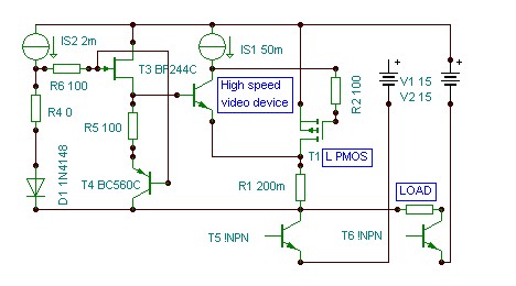

maybe it's just me, but I do not understand your schematic. It seems your inputs are the bases of T5/T6, and the bulk on the positive rail might be an output modulated current source. So you take T5 and T6+load as active load? Why the asymmetry with T6 and load in series?
As you see now what the results of my short look are (shockingly incorrect I guess), maybe you could post a short description of what you have in mind about this thing?

This is an update because in the past week I have built and tested the circuit beneath (only with 10V zeners instead of the 5V references).
What most worried me was circuit stability. Well, I must say that these worries have turned out to be true! This circuit is really very hard to get stable. I tried all of the usual ways to get it right (like described in post #59). It is stable under certain circumstances, but during power-up lots of nasty oscillations can be seen that disappear once it’s settled.
The rejection of AC signals across the output devices is quite good. With 2V AC at the output I measured the Vce (10 V DC) of the output devices to have only 3mV AC (-56.5 dB). It is also rather frequency independent, giving at 1 kHz about the same values as at 20 kHz.
For now it’s too much work to tame this beast, probably I will give it a try later when I have more time to investigate it.
