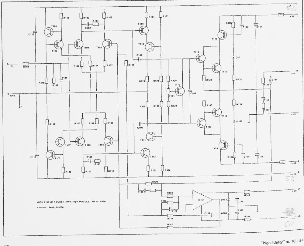

Here is the circuit that is in my head for a while. Perhaps it is more a “totem pole” than a cascode as JCX stated in one of the previous posts.
The Vbe multiplier and variable CCS are only drawn as a function, but that won’t be the toughest part.
Would this circuit work well? What do you think?

Not sure what to think about this.. so outer transistor pair will see the same signal as the inner except for a different level . wonder what happens when it's clipping from too high signal. The voltage on the collector of the inner pair will be lower than normal and it will change in the same way as the emitter(output), so inner Vce will be constant but the outer pair's Vce will change almost as much as a usual output.. hmm
Hmm anyway personally I would rather split the signal with 4 resistors from the output and feed it that way.

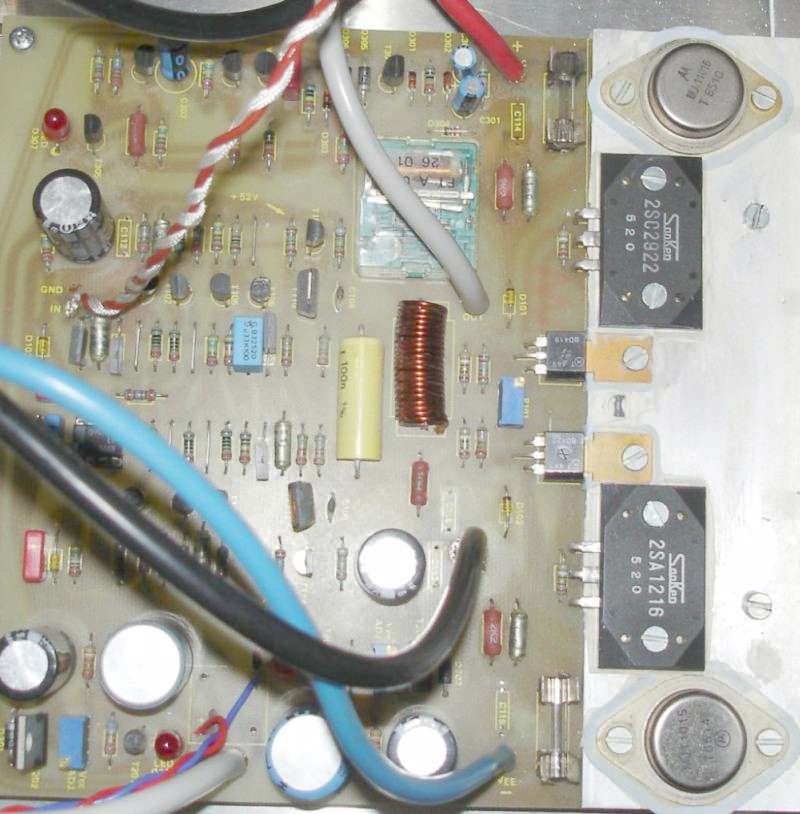

I did an amp quite similar in topology than the one shown earler ,high fidelity danish, but with fet output and input. I'm pleased with it (talking about powersuppy, I used vicor modules ;-)..
