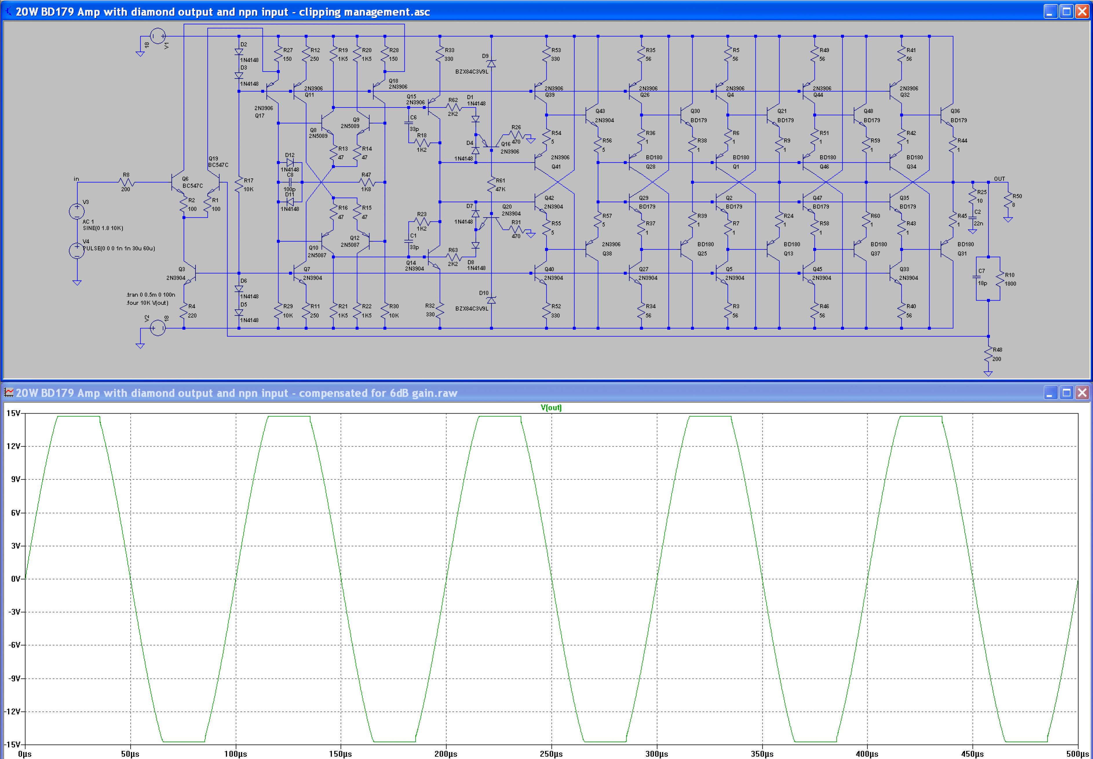

Bob Cordell's output stage is a conventional MOSFET complementary source follower, not shown here. However his approach to eliminating clipping artifacts (see post #97) is applied to the front end of the amplifier, and can be used with most power amp designs, including the one shown in post #98.
Cordell's concept works well; I exhibited my implementation recovering from clipping (btw no MOSFETs), because Cordell's paper contains no scope photos of clipping. I've simply offered simulation evidence that the idea achieves its objective: graceful clipping and clipping recovery.

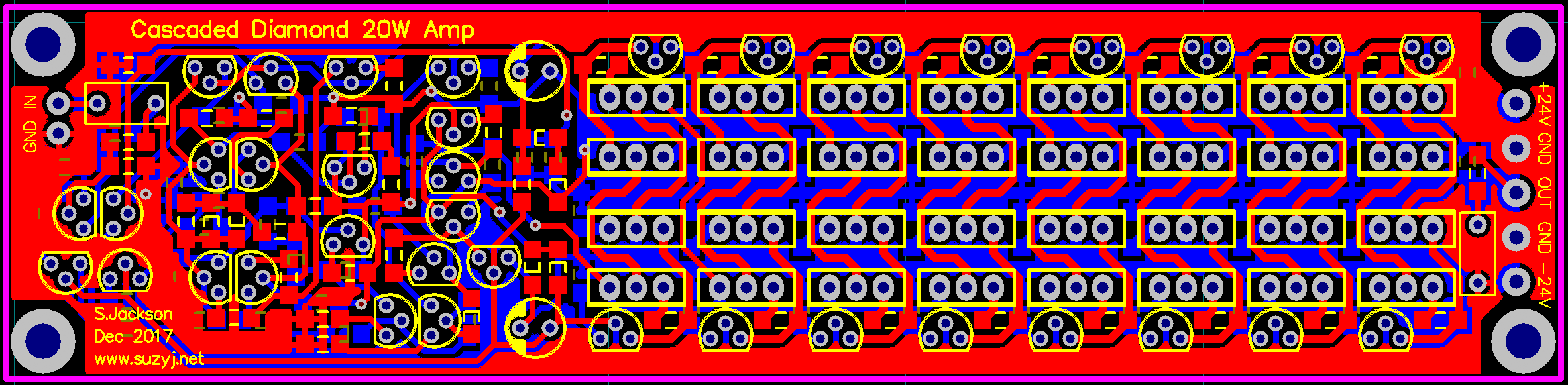

Mark, the Cordell clipping desticker circuit is awesome! Thankyou so much for pointing me to that - it improves the behaviour of my amp no end.
Totally not OT - very useful bit of info.
I put the clipping desticker circuit after the VAS stage, controlling the VAS transistor bases and collectors. I found the diode capacitance at the base of the VAS transistor messed with my compensation and killed the THD as a result, so I threw some series resistors in to prevent that. It doesn't prevent the clipping desticker from working as it should, but does stop it loading up the VAS bases unnecessarily.

I (and also Bob Cordell) use 1N4149 diodes for the clampsters. Datasheet guarantees half the capacitance of a 1N4148. And since you are OK with SMD devices, you could select the Toshiba 1SS472L3 diodes instead. These little jewels have 13X lower capacitance than 1N4148. Boy howdy.

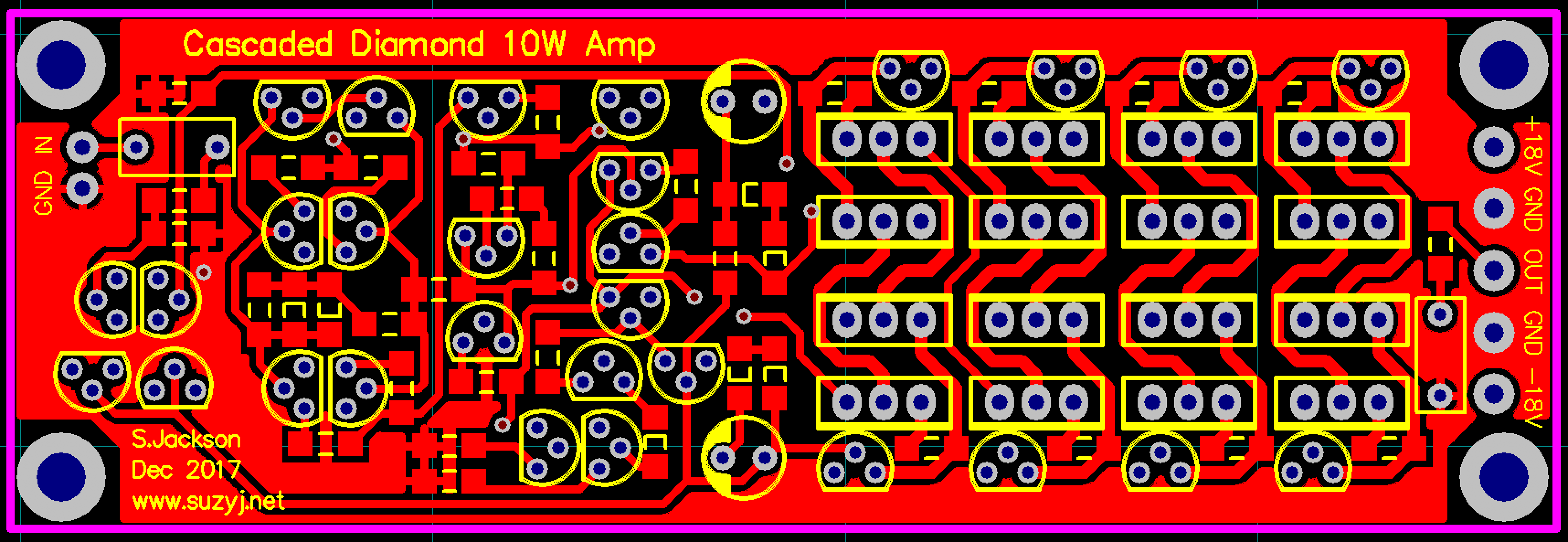

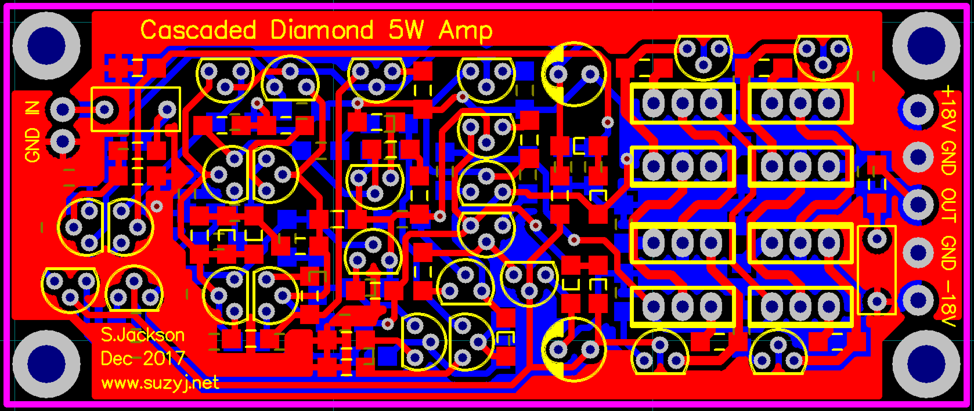

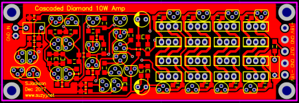

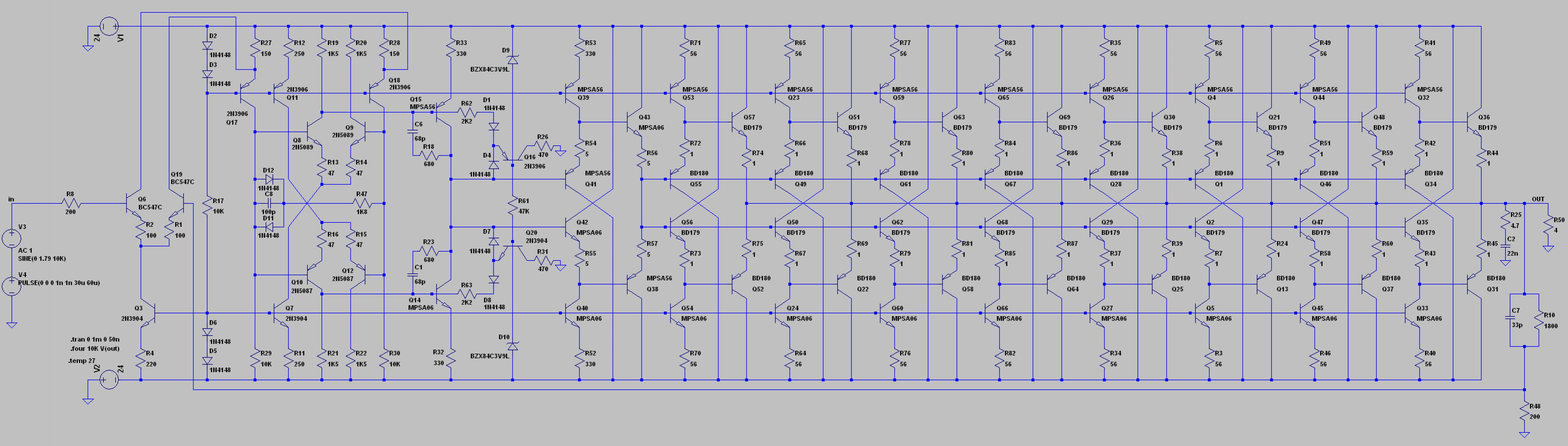

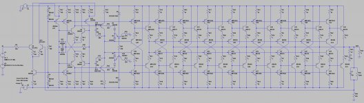

New layout with clipping management incorporated. I moved the output drivers to the side rather than the top - it makes it a lot easier to generate different versions by simply adding or removing blocks on the output. Size for 2, 4, and 8 sets of output diamonds is 1.25" wide by 3", 3.75" and 5.25" respectively, so despite the large number of transistors the boards are small.
The 8-set version (20W into 8 ohms, 40W into 4 ohms) has to run at +/-24 rather than +/-18, meaning the 2N3904/3906 are no longer suitable for VAS duty and other full-rail jobs. The MPSA06 & MPSA56 are an acceptable substitute here - they do 80V, 0.5A, 625mW, and aren't that much slower. As a bonus they have the same pinout as the 2N parts, unlike BC5XX transistors. THD for 40W into 4 ohms for the MPSA version is ~5ppm.
