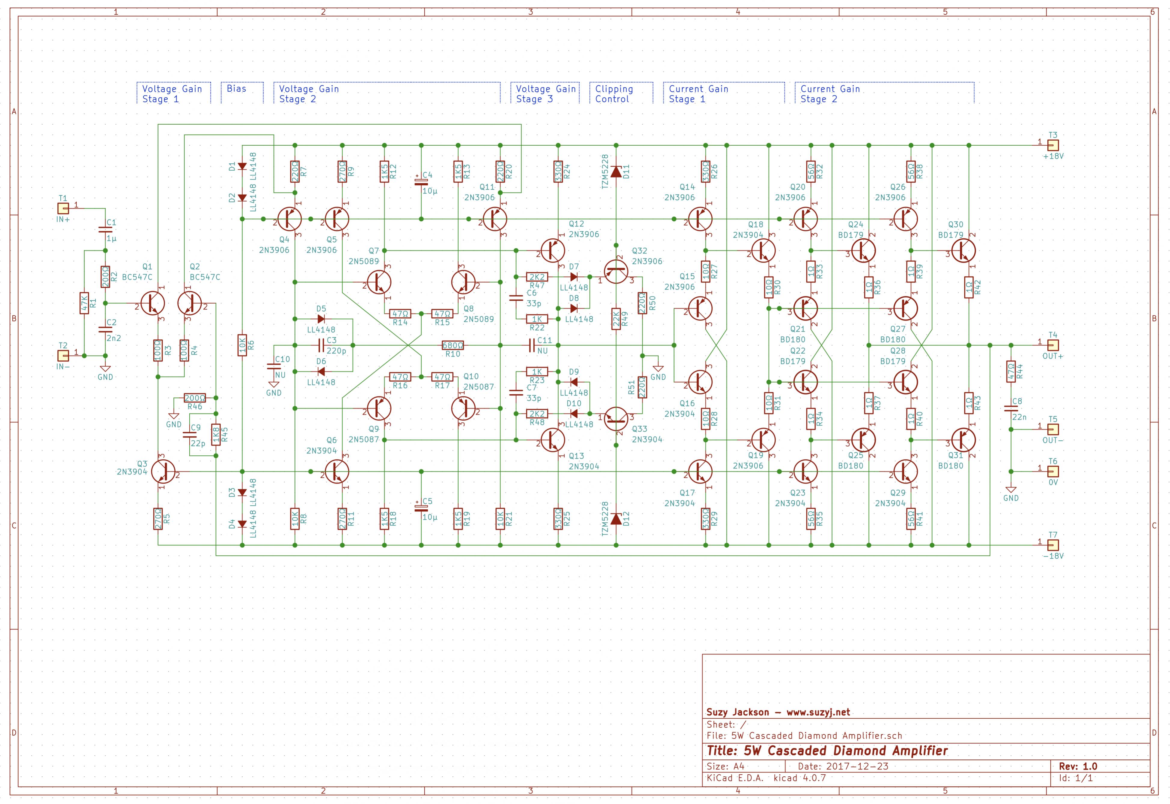

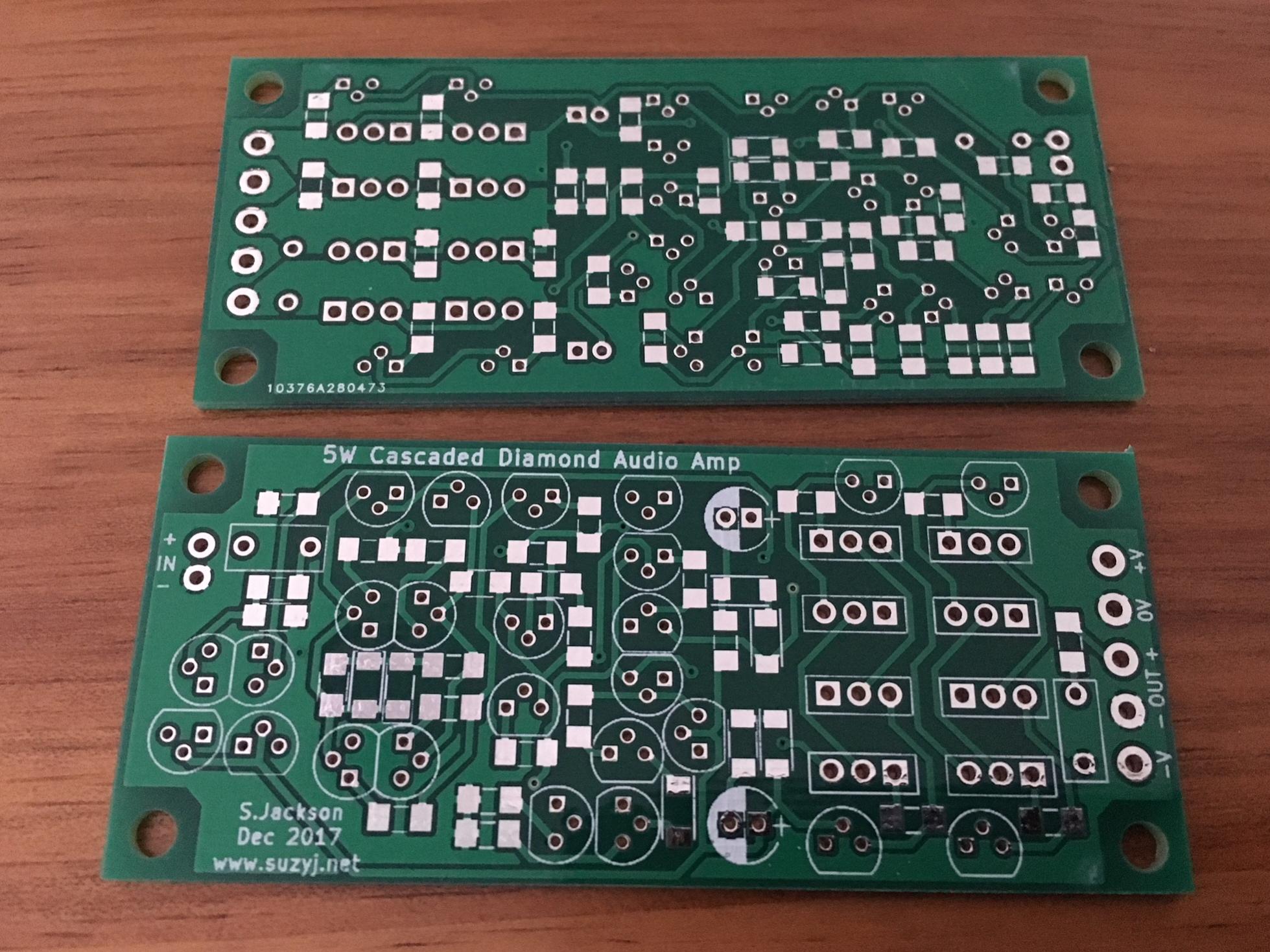

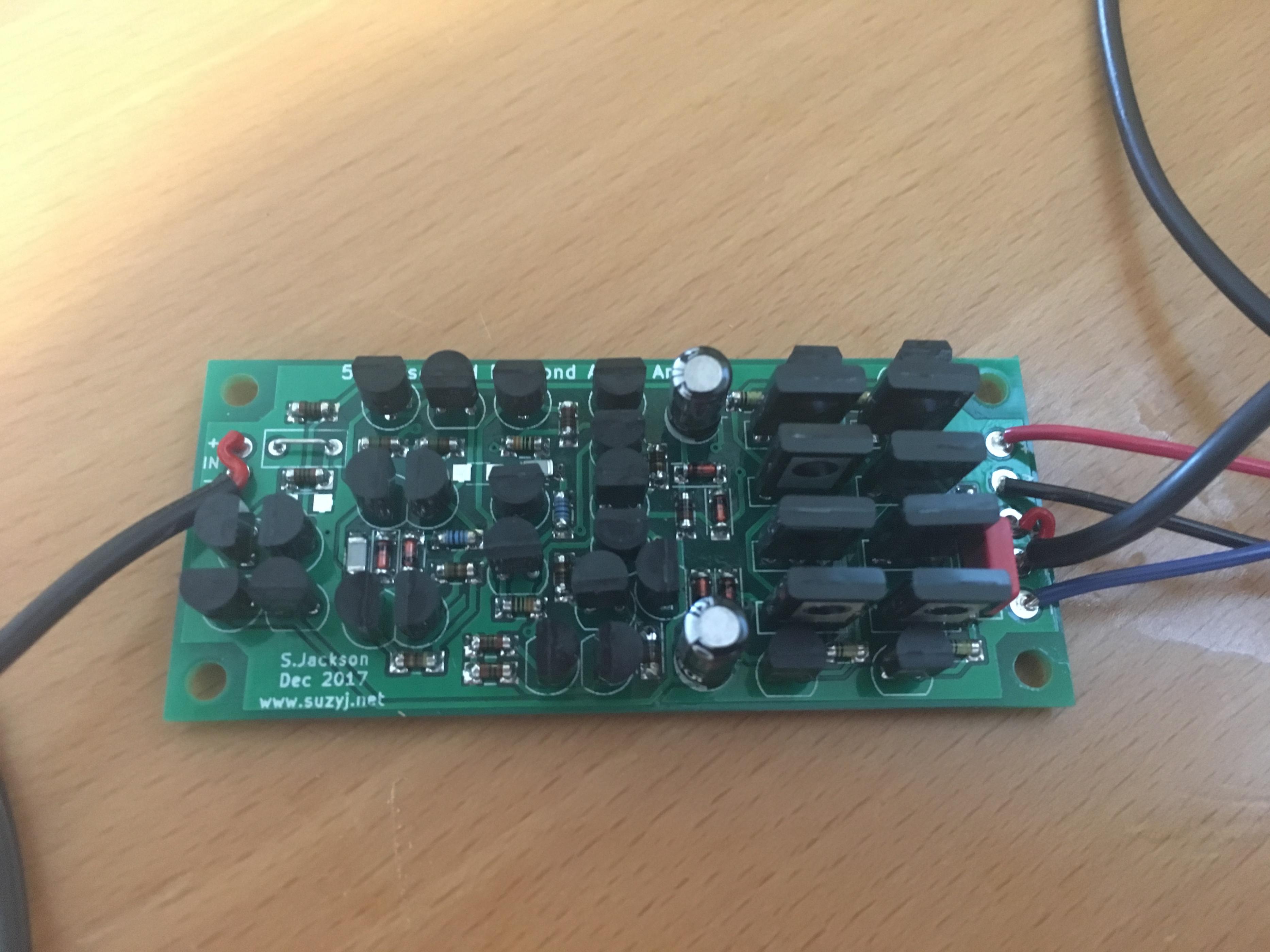

Promising so far. There's a stuff-up on the PCB where I forgot to link C7 to R3, but that's an easy fix as the pads are right next to one another.
Also I forgot to order 3V9 zeners, so I've substituted 6K2 resistors, making the clipping control not really right.
The board is stable so far with C3=330p, R10=1K, C6,7=22p, R22,23=1K, C8=22n.
No load quiescent current is 78mA with +/-18V supply. There's a rather nasty 62mV DC offset - I guess I'm really going to have to match Q1 & Q2. Input referred noise measures at 4.2nV/rtHz.
Thus far I'm just driving a 50 Ohm load, as I haven't yet put a heatsink on.
(Very) preliminary 1KHz THD figures are:
1.25V - 0.00004%
1.77V - 0.00006%
2.50V - 0.00010%
3.53V - 0.00007%
5.00V - 0.00014%
7.07V - 0.00013%
10.0V - 0.00016%
Early days yet, but no burned fingers so far!

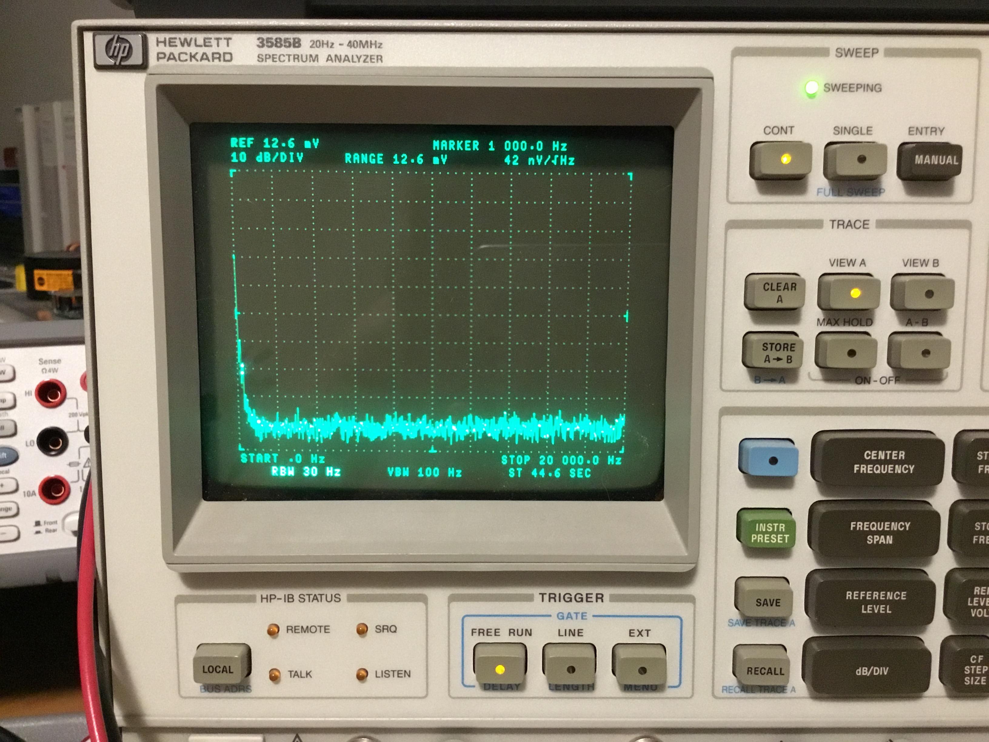

That's low, very low !Promising so far............. Input referred noise measures at 4.2nV/rtHz...........
Is it topology, or devices selection, or resistances selection?
I used BC547’s in the input diffamp due to their reasonably low noise figure. I picked the input resistance of 200 ohms to minimise noise.

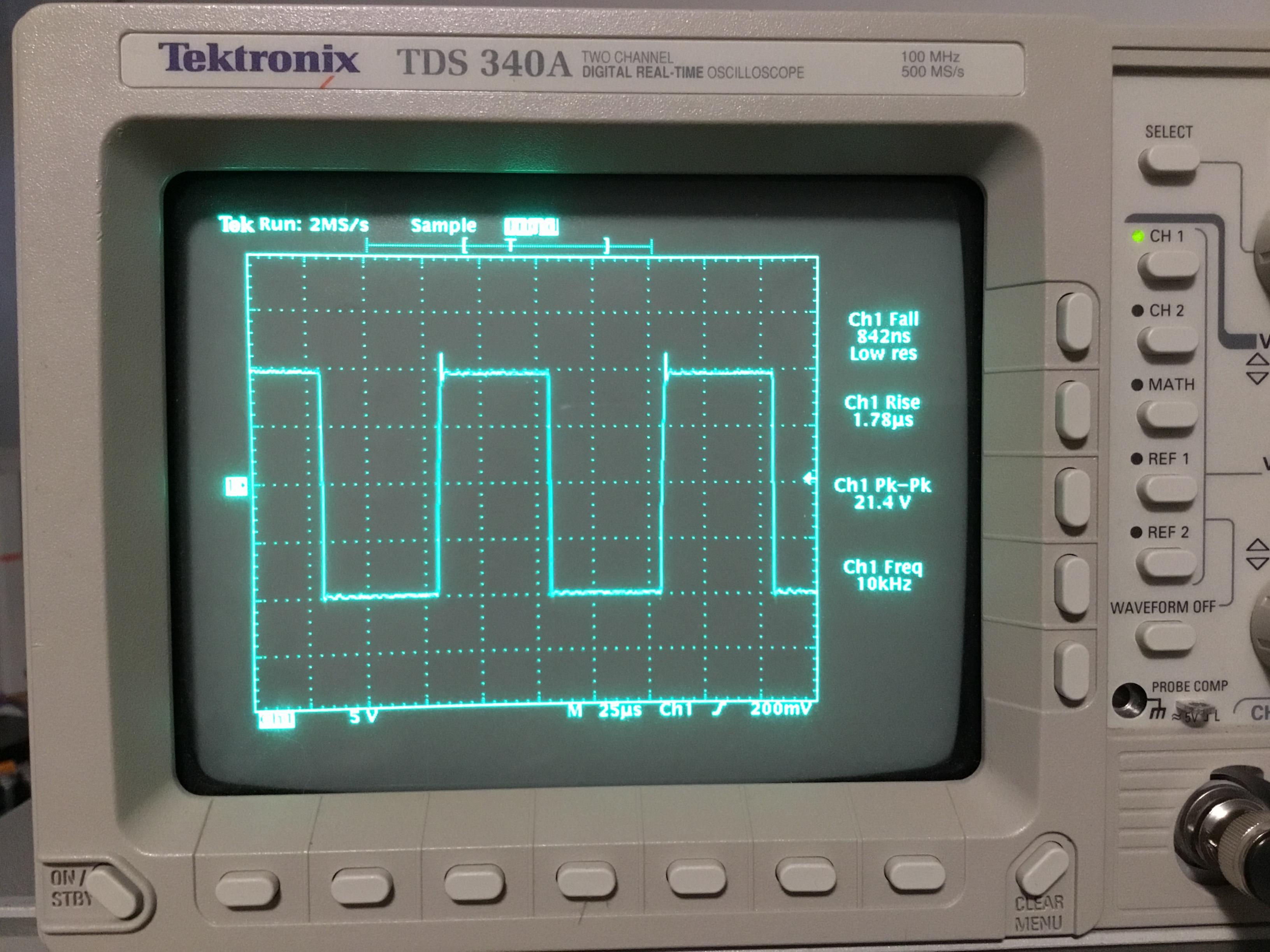

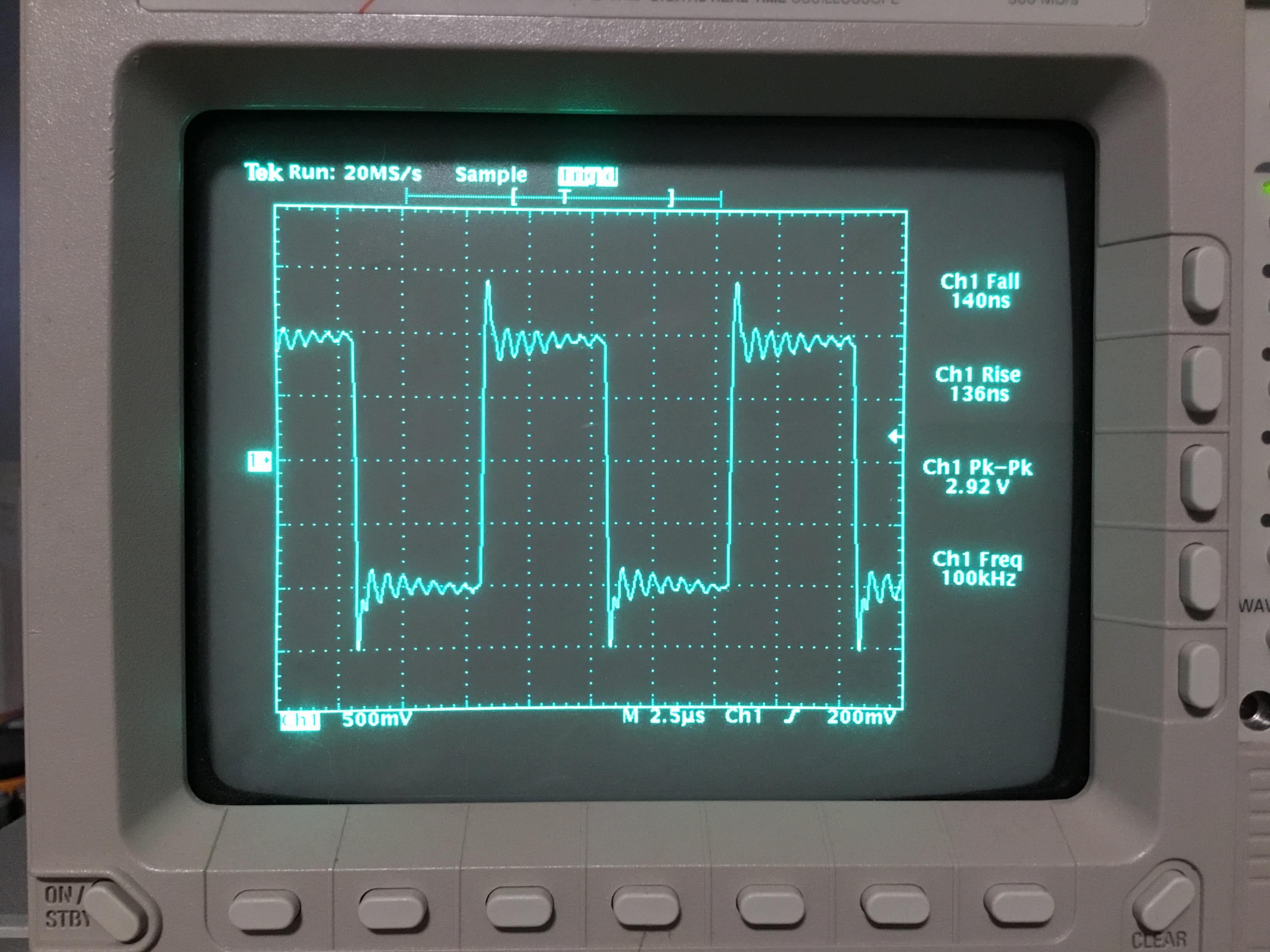

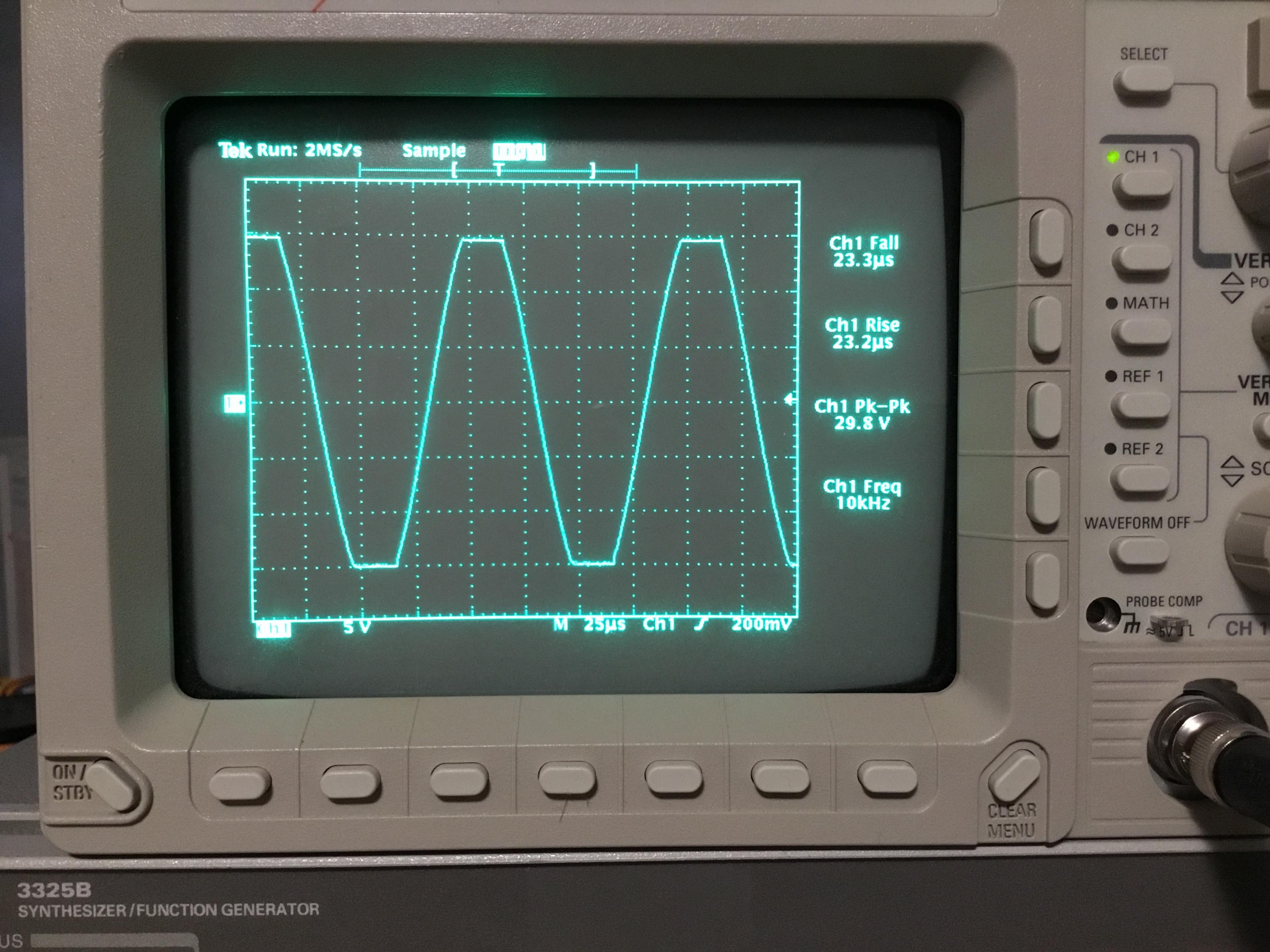

It’s been rather enjoyable playing with the compensation to improve stability. Running square waves in is useful, as I can straight away see slew rate and any ringing.

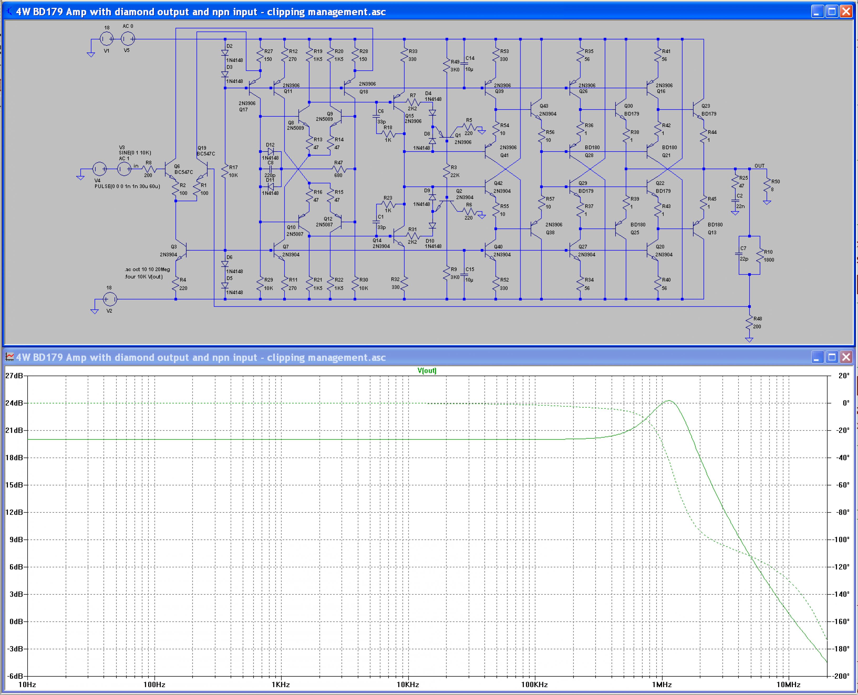

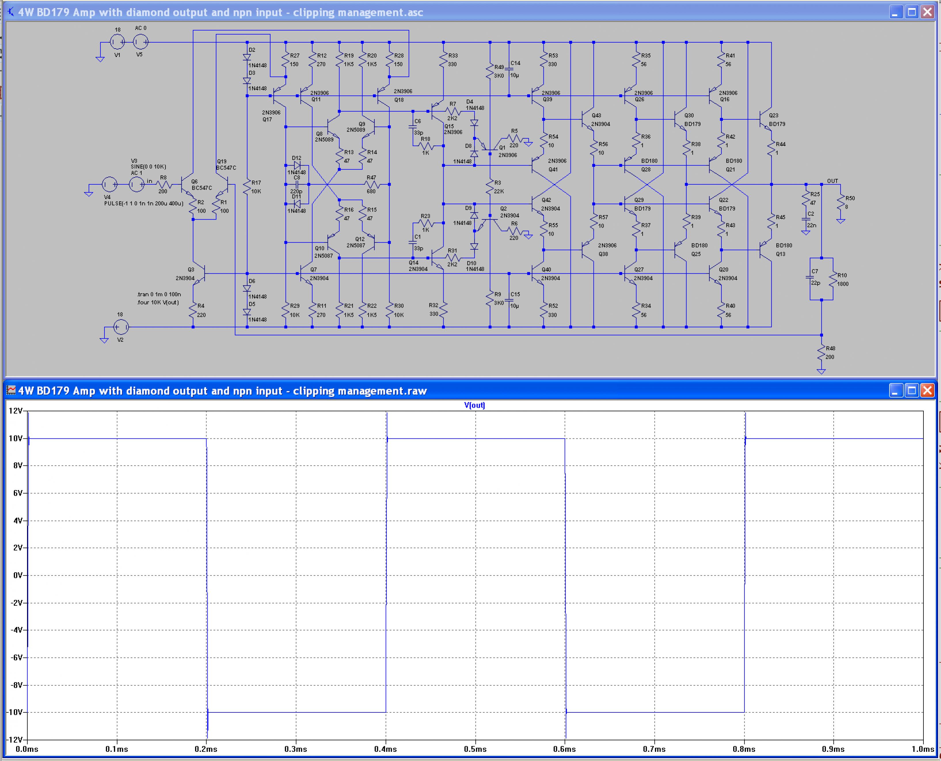

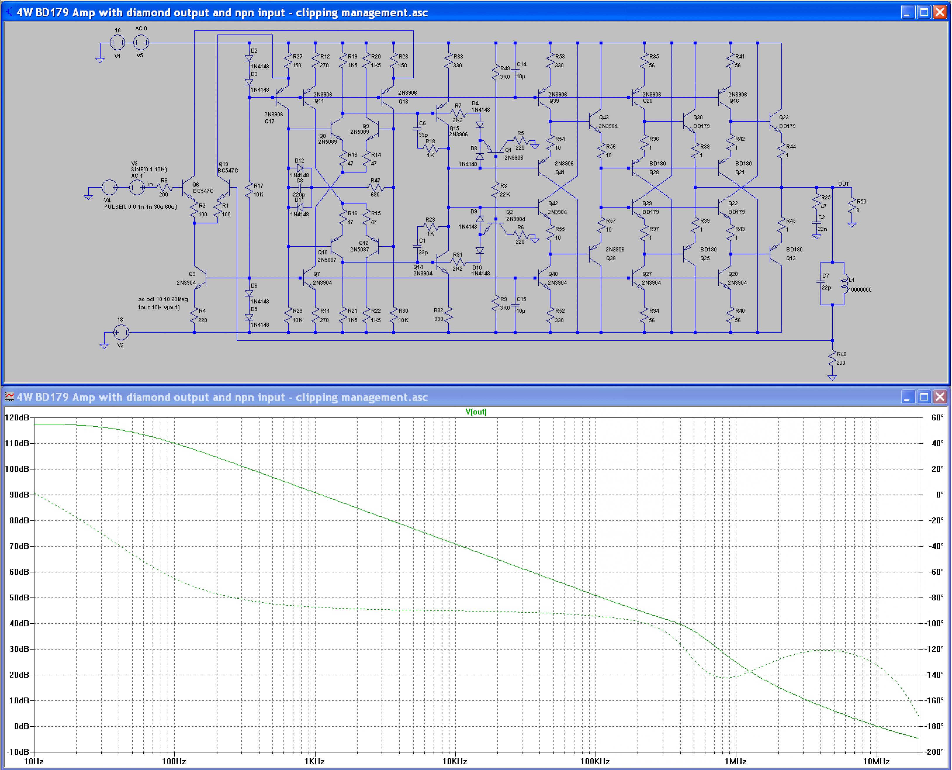

There's no such thing as a final .asc. The simulation that I have for the amp physically playing on my desk now is attached here.
I'm happy with the stability now - I can run the physical board (as opposed to the sim) happily at x6 gain (1K Rf) without issue - I tried x2 (200R Rf) but that was pushing the friendship, alas, and it was breaking into ringing a bit on the -ve half cycle. The sim is fine at x2.
Square wave response is good, with a little overshoot but nothing terrible. It's really nice on clipping.
Offset is still 60 odd mV, which I think is excessive - I'm confident that can be reduced with some first stage matching.

Why not adjust the offset simply by replacing R3, R4 with a pot. Once set, measure the pot and replace with fixed resistors.

These noise measurements befuddle me.
I just repeated the measurement, using at 8 ohm output load and shorting the input, with gain set at 20dB (x10).
Output referred my spec-an says 42nV/rtHz, so I make that 4.2nV/rtHz input referred. I double checked that the amp was actually connected. Indeed it is - shorting the input of the spec an gives 14nv/rtHz.

Do not change R3 & R4.
Instead measure the unbalance across R3 & R4 and across R7 & R20 and across R8 & R21 and work out which transistor pair is causing the worst of the output offset.
The unbalance across R14, 15, 16 & 17 should also be a clue to where unequal currents are flowing.

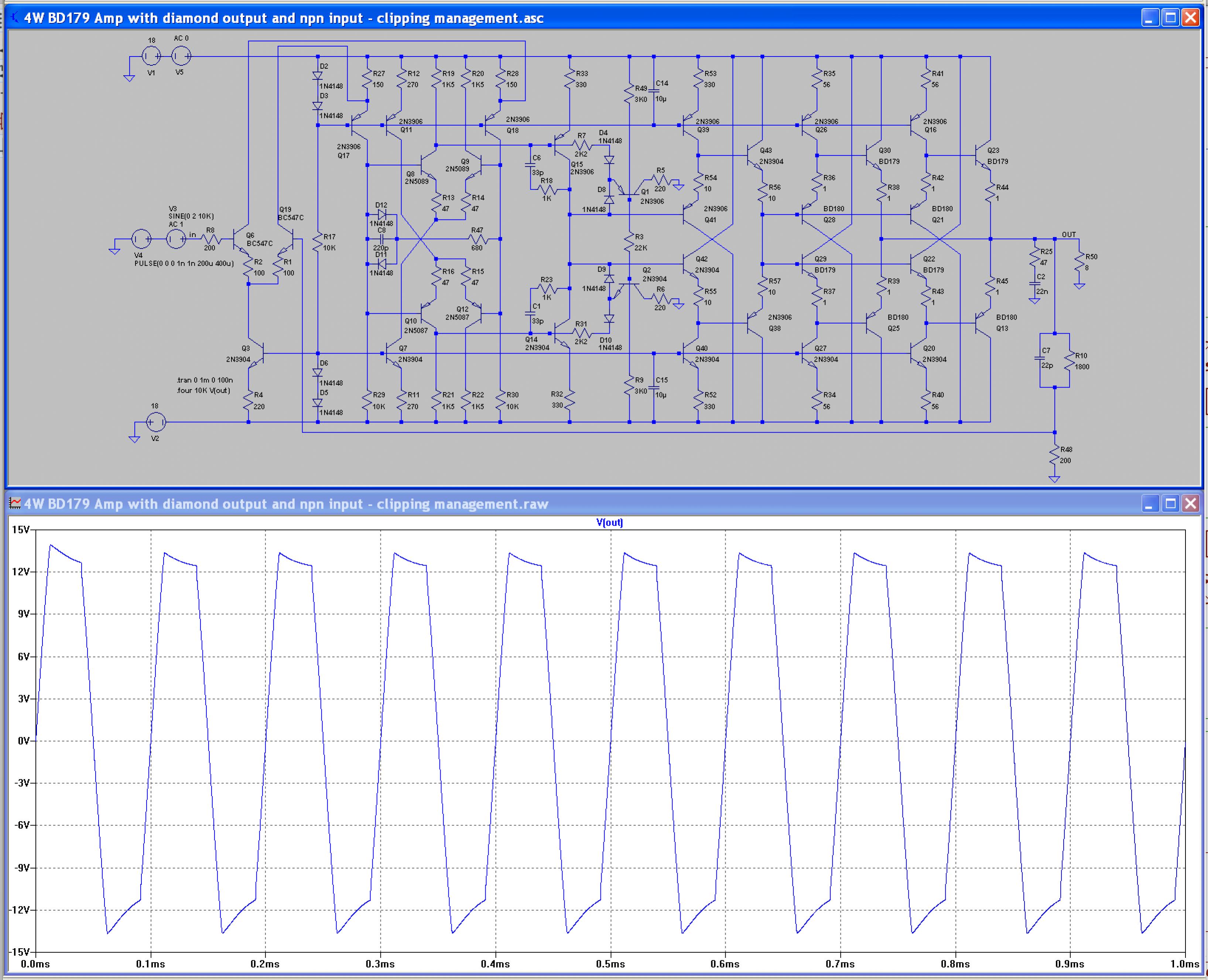

Here's the behaviour when clipping with a 47 Ohm load, also square waves at 10 & 100 KHz, 20Vp-p output (no input filtering) plus a 100KHz 1Vp-p output square wave to show small signal slew rate.

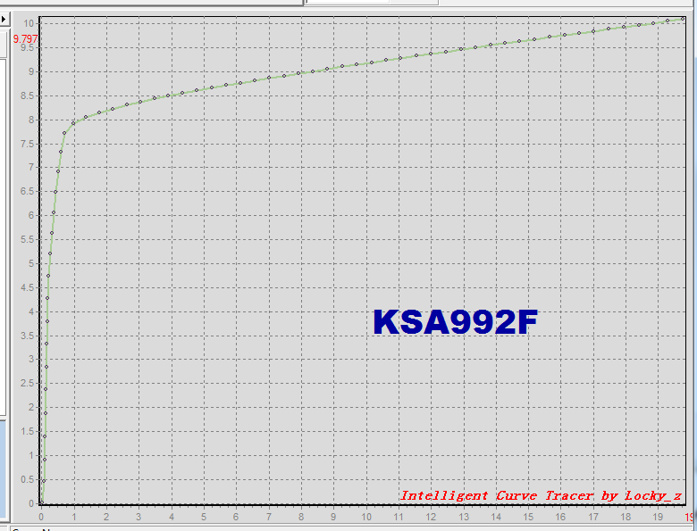

... I want a complement for the 2N5089, with it's 50MHz Ft and 450 Hfe @ 1mA...
You might consider one of the attached. According to octopart.com they are both in stock at several distributors including Mouser.com and Digikey.com .
In my quick and dirty tests, the '992 had a higher Early voltage (flatter Ice vs Vce)

The idea for heat sinking is to bolt the inner two rows of transistors (these are the high-current ones) to a piece of aluminium T extrusion. I can use 2mm thick flat strip either side, one countersunk and the other threaded, to secure countersunk M3 screws.
About cooling, I saw this heatsink I planned to use before, maybe it can hold 2 boards, has a T profile in. Maybe too big. Im not sure if it is widely available, because I couldn't find the maker.
Double T sink would suit a pair of vertically oriented amp PCBs.
That arrangement brings the like for like terminals only 57mm apart.
This suits minimising voltage losses and minimises added inductance between the channels and can result in lower hum interference in the completed stereo amplifier.
