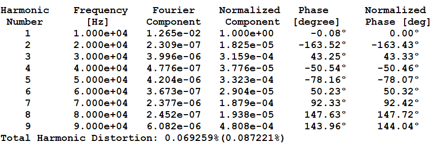

Your BZX79C2V4L model is broken. Try: .model BZX84C2V4L D(Is=2n Rs=.5 Cjo=200p nbv=3 bv=2.4 Ibv=1m Vpk=2.4 mfg=OnSemi type=Zener)
