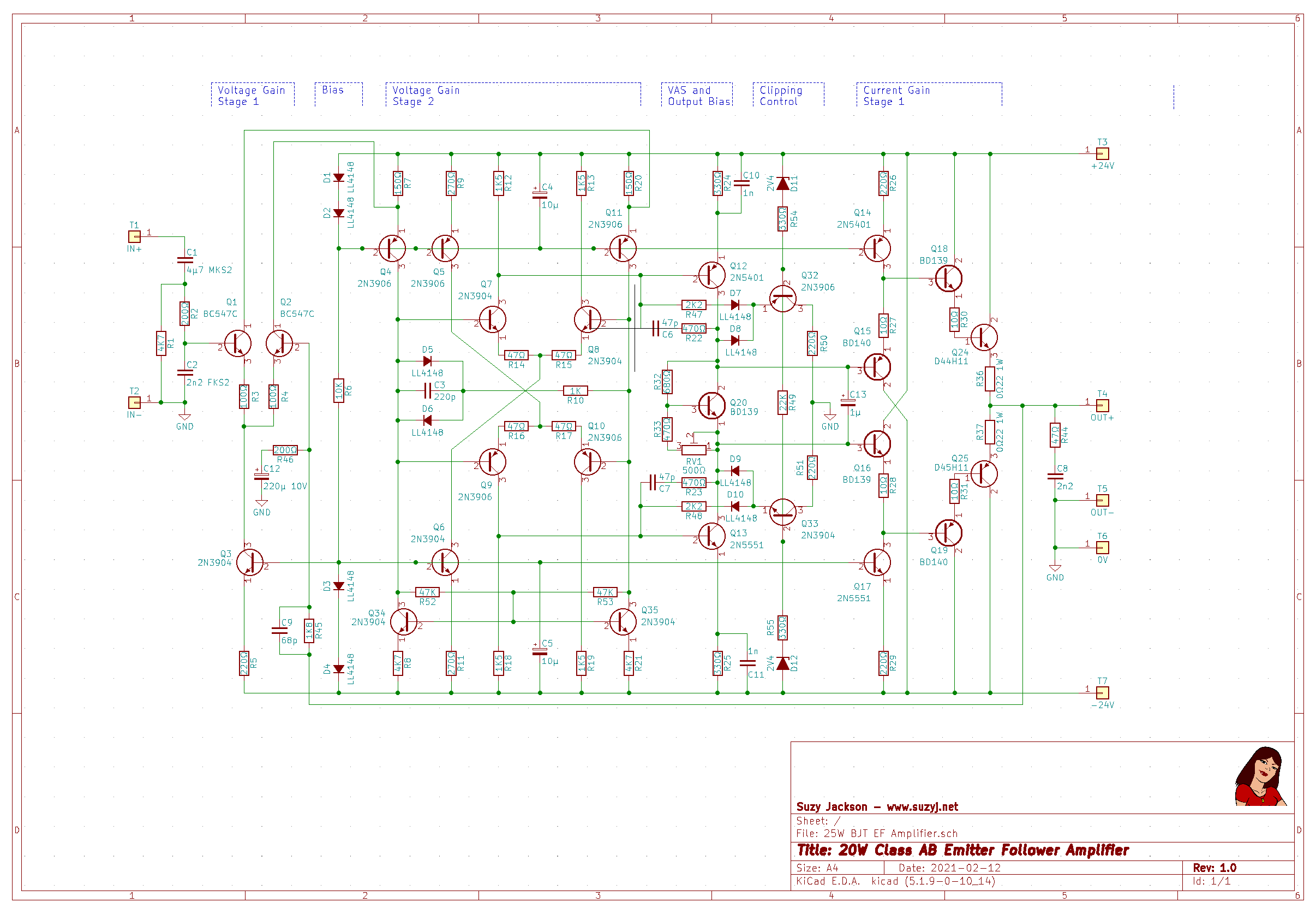

Hi Suzy J
Post-268: Q20 + R34 + R37 are clearly a bias-set circuit for the output diamond. The latter has no emitter resistors on the input pair and needs something to balance against the two Vbe drops per side of the output stage.
Every bias regulator I see has at least 100nF across it, and usually 10uF or so.
Yeah. It’s also got no power supply filtering caps. That’s because it’s a simulation, not a finalised design. For the purposes of the simulation it makes zero difference. By all means add a cap there in sim if that’s what blows your hair back.
BTW, you do know that making comments like this about someone’s simulation don’t make you look clever, but actually the opposite. Of course if you did the work to show that it actually had an effect (any effect) that’d be different.

And it will not work as shown - it is oscillating even in simulation.

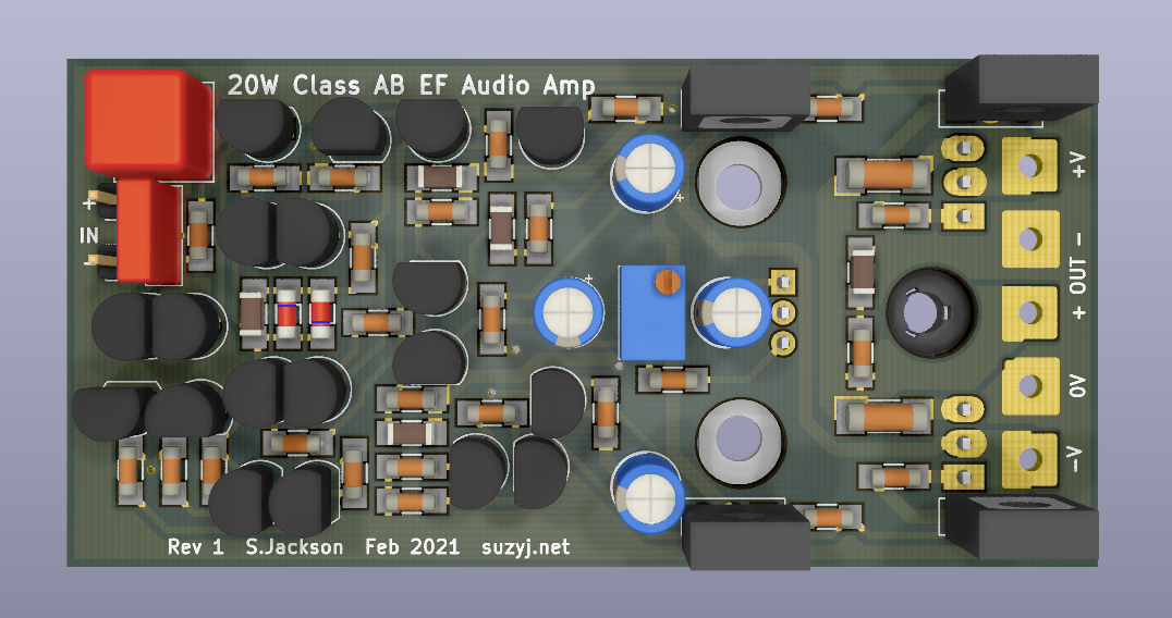

I'm on a bit of a design binge right now - I blame the new version of KiCad, which is such a pleasure to design with.
A few posts up after mucking around with the cascaded diamond topology I concluded that the best way to get a low-cost, medium-power amp that doesn't burn heaps of power was to go back to a more normal emitter followed output stage. So this is the polished version. I reckon it'll make 20W with a D44H11/D45H11 output driver stage, with basic BD139/140 drivers, and +/-24V supplies. The nice thing about only having two hot parts is that heatsinking is ever so easy, unlike the amps with many output drivers.
The reason this is interesting to me is that the MV supplies for my bigger 100W class G amp are +/-28V, so that's near enough to what this wants. I could use this for tweets and midrange, and put the woofer on the 100W amp. Or even use the 200W amp with two paralleled woofers, and the 100W amp for mid. Anyway, the tweeters don't need a lot of power, but they do need a lot of speed, and this topology has buckets of speed.

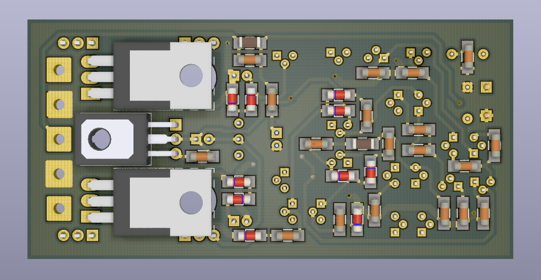

PCB is 38 x 77mm. It idles at around 1.5-1.7W, depending on output bias. The BOM is ~$25, so it's not an expensive amp, and there's nothing exotic and hard to get. Indeed 90% of the parts I've already god.

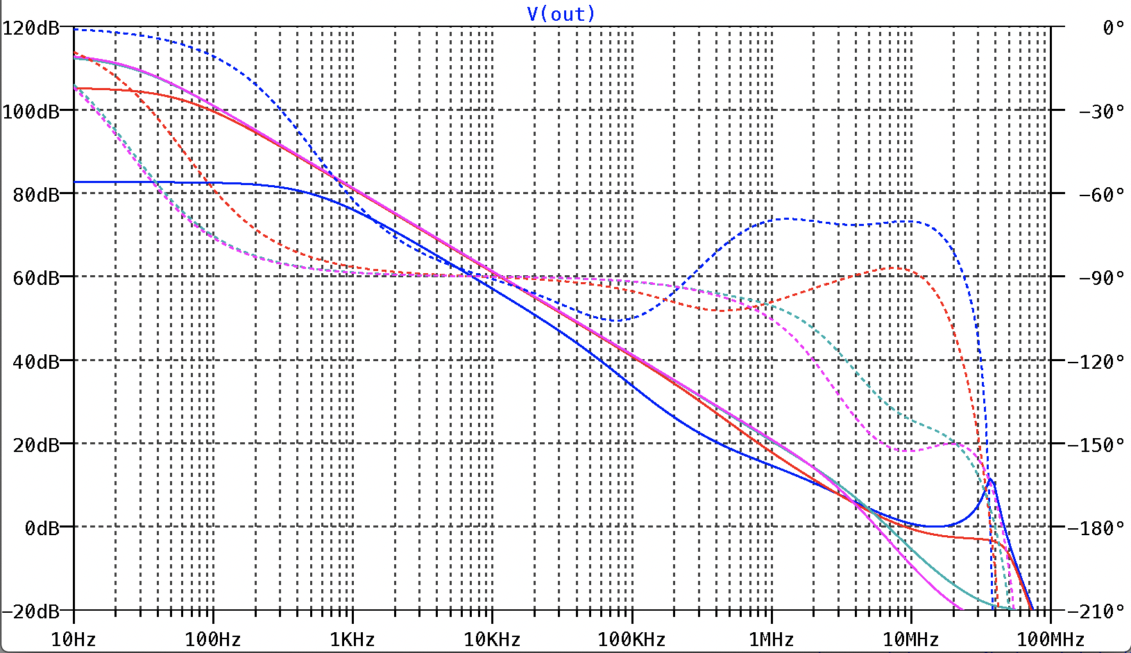

No particular reason, really, I just drew a pair of transistors. It really points to my inexperience with this style of output stage more than anything.
I'm guessing it's there for stabilising the gain of the driver stage with devoce and temperature variation? I'm guessing it's a good thing to have.
Here's an open loop ac plot of adding and varying this resistor in sim, showing it has some profound RF stability implications, though this is more likely due to starving the output transistors of current and hence changing the bias point rather than any magic of it's own.
In the plot blue is 100≈, red 1K, green 10K, and magenta 10Meg.

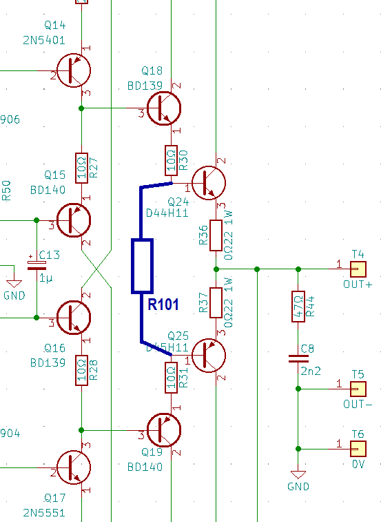

I might create an initial starting point, by estimating the maximum base current that can possibly flow in the output transistors, and then choosing R101's resistance value so its DC bias current will be two or three times greater.
If (8R * Irms * Irms) = 20 watts then Irms is 1.6 amps and Ipeak is 2.25 amps.
If Beta = 80 then Ibase = 28mA. So I might choose R101 to have 85mA of DC bias current. At least as a starting point for further calculations.
And I'd actually connect R101 from emitter to emitter, not from base-stopper to base-stopper. Whoopsie, drawing error.

That'll push standby consumption from 1.7W to 3.7W, which will then require heatsinking of the drivers.
I can see your rationale - it means the servo only has to correct for one pair of Vbe rather than two. However the same effect is gained with much less current, as long as you ensure that the drivers and main output pair come our of class-A at different points, so the servo system still has to deal with one pair of Vbe at a time.

The added resistor, which usually is rather connected directly between the emitters of driving transistors, is there to suck out the base charge of the following transistors, some times even a small capacitor is added in parallel to help speed up turn-off .
