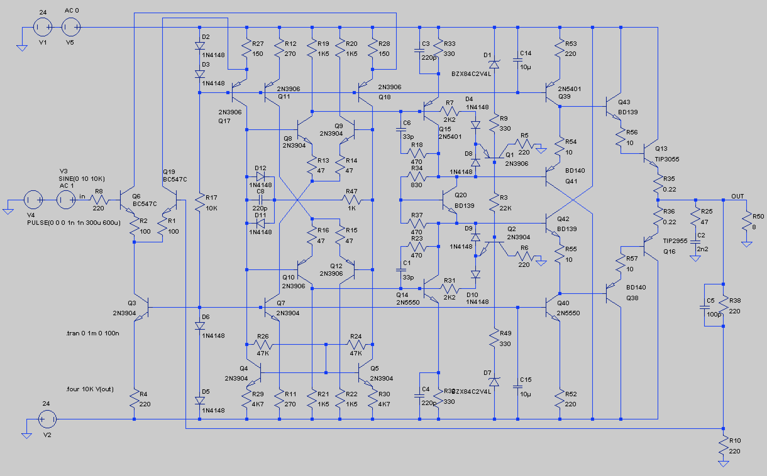

The +/-18V supply is dictated by the Vceo of the 2N3904/06 of 40V. By substituting MPSA06/56 (80V) or 2N5551/5401 (150V) or another fast, reasonably high gain TO-92 with EBC pinout for all the 2N3904/06, it's possible, in principle, to run the supply higher - say +/-24. Indeed exactly that was in my mind when I added the regulator for the input opamps.
A supply of +/-24V (~18VAC) would allow around +/-20V swing (25W into 8Ω), which should be enough for say 6" mid bass woofers. You'll need to heatsink rather better than I am with the 4" drivers at +/-18V.
No guarantees though - I tried substituting BD139/140 at one stage for the output and had no joy stabilising the amp, so it'd have to be designed and simulated carefully. Indeed I might give it a go - I'll have to buy MPSA06/56's though as I only have about 20 of each in my drawers.

Having played a fair bit with this topology, I reckon I've got a reasonable handle on it's strengths and weaknesses.
Strengths: Reasonably fast, good slew rate, Iq for each output stage implicitly set by diamond source/sink, so no issues with thermal runaway and good at sharing current. Reasonably good distortion performance.
Weaknesses: Maximum current is 2 x Iq x Hfe, so with typical output drivers (BD179/180) with reasonably low Hfe (~40 odd) it's wasting a lot of current for higher wattage flavours.
Also the many cheap output drivers thing, while doable, is rather tedious to build once you include a heatsink, as everything has to be screwed down with individual isolation pads etc, and the expense adds up quickly.
Essentially great for headphones and tweeters, and itty-bitty full range drivers, but not really extendable to bigger things.
So that's led me to look at simpler output stages - essentially returning to a bog-basic emitter follower. I've gotta include a Vbe multiplier, so I inserted it in the middle of the diamond.
The attached sim is a 25W into 8Ω version, using TIP2955 and TIP3055 output drivers set to 20mA Iq, driven by BD139 & BD140 in a diamond. Only the 2955 & 3055 need a heatsink, plus the Vbe multiplier of course. It's really easy to compensate, and makes under 2ppm at 10KHz, with gain set to 6dB. Total amplifier Iq is around 50mA, or 2.4W.

I would like to add my reflection, though I am not an audio designer. This amp has a large open loop gain, around 120 db if I'm not mistaken. We do not know the bandwidth to this gain but I think it is very narrow, at most 1 Khz. This behavior, although it ensures ultra-low distortion in the order of 1 ppm or slightly at higher frequency, such as the last-generation op amps, is not well considered from the point of view of sonic performance. I think it is better to get a distortion of a higher order (10 ppm or less, on the entire audio band seems more than adequate given the much higher distortion of each type of transducer, both speaker or headphone) with a lower open loop gain and a consequent wider open loop bandwidth,(at least 20kHz) that ensures better behavior on the high frequency phase linearity and on the quality of the distortion, at least so it is claim by the people who find the sound of amplifiers so designed very natural and with a very good soundstage.
semola
semola
Hi semola,
How did you come up with this summary? Did you build one, or have you measured one that is put together?
Actually, if you read the thread you would see that it is a very wide bandwidth circuit. The rest of your statement is just regurgitated audio myth without any basis in fact.
-Chris
-Chris
It is true that the location of the dominant pole is sometimes called "the open loop bandwidth".
If you take the number called "gain bandwidth product" and divide by the number called "gain" then you get the location of the dominant pole.
