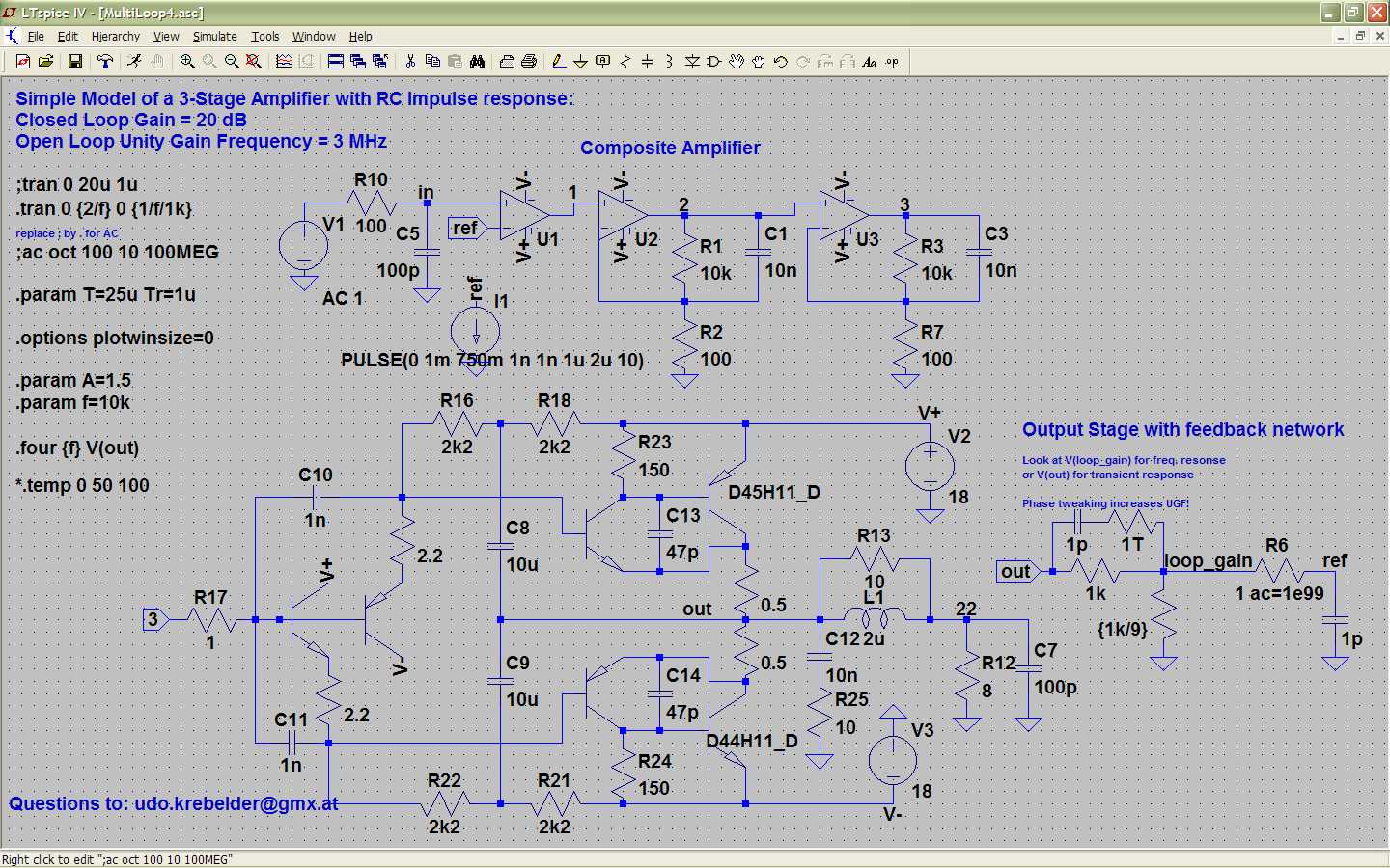

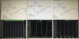

To help with the design of Suzie's 3-stage amp, i added a third
amplifier to the MulitLoop LTSpice example.
The example consist of up to 3 amplifiers in a loop.
The first one has Gain of 10e3 and a unity gain frequency of 30 MHz,
the second one has gain of 100 and a UGF of 100 kHz.
The third one is identical to the 2nd amp.
In addition i added a very simple output buffer stage to see if
the added loop gain helps in reducing distortion.
This buffer has serious problems with crossover
distortion but it is a quick test.
The LTSpice file and a picture with a simple stability test is
appended. The square wave test looks very good without
overshoots.
The simulation does three sweeps:
- only the first amplifier is in the loop
(the main one with 10e3 gain up to 30MHz, similar to a good Opamp)
- additionally amplifier 2 in the loop (Amp 2 has Gain 100 up to 100kHz)
- additionally amplifier 2 and 3 are in the loop (Amp 3 is like amp 2)
The log file (View->Log) records the THD values @ 1kHz:
It is nice to see that indeed more loop gain helps with THD:
- 86 dB with 1 amplifier in the loop
- 110 dB with 2 amplifiers in the loop
- 119 dB with 3 amplifiers in the loop
In principle this concept could be implemented with 3 opamp models,
or three discrete stages similar to Suzies amp.
Nevertheless a class-A amp could sound better at low volume as it
has zero crossover distortion 🙂

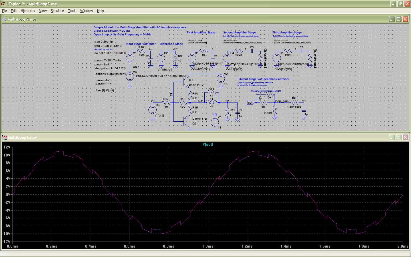

Ok, to make this Multi-Loop ampifier less abstact, i replaced
the ideal Spice parts with LM4562 opamps.
I promise this is the last post today regarding this thema!
If Suzie feels, that this does deviate too much from the original post,
the administrators could please shift this in a separate thread.
I improved the output buffer with a diamond like structure.
Voltge swing is about 15 Volt Peak with 18 Volt supply and 6 Ohm load.
And distortion really shines, especiall at lower frequency
(even Spice can not measure it anymore 😀)
At 10 kHz with a 15 Volt Peak Sine in 6 Ohm THD is about 130 dB
(at least Spice is saying so).
One little drawback of the composite amp concept is that it does not
help much at higher frequencies, and 10k is already high,
as the 2nd and 3rd stage has a unity gain frequency of 160kHz.
I think the output buffer is pretty and simple and with the addition of
two transistors it is short cirucit proof.
I do not have the time to build this, but if someone has interest in
building this, i would like to help out with the theoretical part.
An idea is to add an output buffer with voltage gain.
With higher supply voltages and overcurrent protection
this could become one of the best amplifiers in the wild.

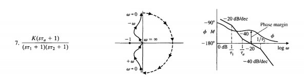

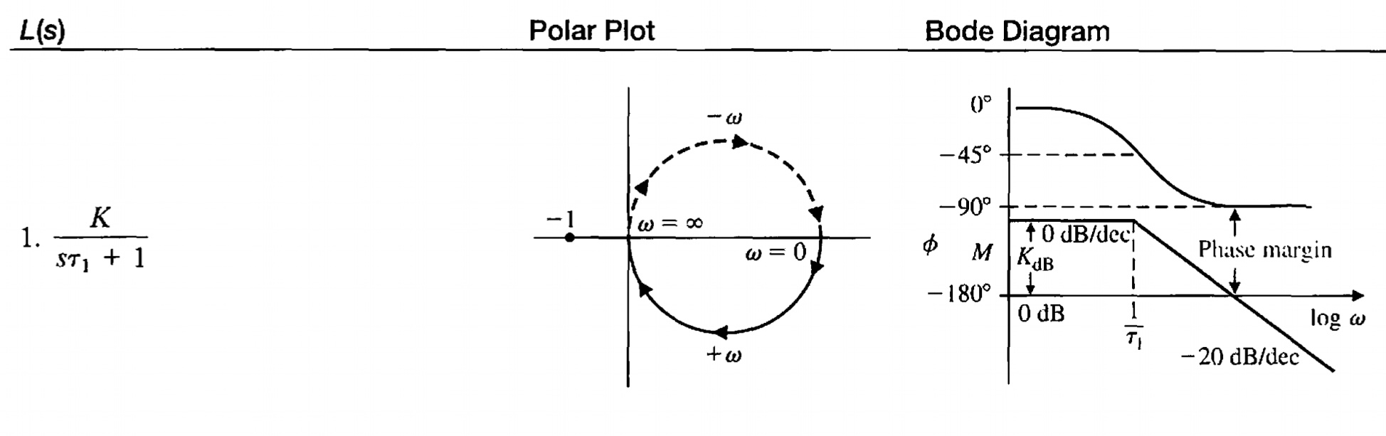

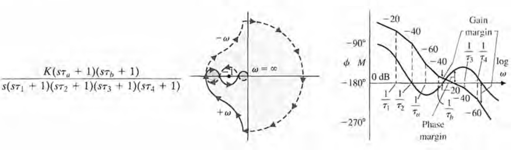

Hi, udok!
Let’s try.
There are some severe math, so excuse me if i’ll go excessively deep in that forest.
Example you’ve shown assumes very different approach, while an order of UGF differencies used.
Please, allow me to start from poles and zeros.
Theare are three common usable compensation schemes:
1. First order or dominant pole compensation
Unconditionally stable, but for such a feedback depth are very high bandwidth is needed. Say, for ~100 dB at 20 kHz with -20 dB/dec slope and -20 dB amplitude margin we’re run for 20 GHz output stage.
Unpractical at all.
2. Second order slope (-40 dB/dec) with some part going at first order (-20 dB/dec) around unity-gain frequency.
Conditionally stable, but easy for design and ready for any moderate feedback depth with good OPS.
3. Third order slope with first order part around UGF.
Conditionally stable, hard to design, but allows for unprecedently deep feedback with a real well-known OPS’es.
What was done.
1. Open parentheses and differentiate parts for complex and real fractions.
2. Express poles and zeros freq’es by relations.
3. Try to minimize complex fractions.
4. If there are a mathematically solveable limit present then we have a relation between them.
5. First poles are commonly present inside an opamp’s as dominant (could be taken from OLG plots), just substitute those values for estimate needed zero’s frequencies.
I already showed an example for third case and it clearly corresponds with
My impression was that Pavel is aware of a rigorous mathematical method. It should allow to shape a higher-order loop gain (shift poles and zeros of transfer function, perhaps with some constraints) in such a way that the closed-loop circuit will not overshoot in an exact sense, without the aid of an additional input filter.
Check, that input filter at centered .TRAN simulation doesn’t connected and we see intrinsic two-opamp composite response.
Sorry, if i went into the wilds.
PS. Your example with a 10x differences between UGF’s is known approach, but we went a little more complicated way.

Suzyj, to achieve the noted THD of .000046% as shown in the original post, you must be running this amp with boat loads of negative feedback. My guess would be well north of -50db. Just how much negative feedback is the amp running at?
Mickeystan
Mickeystan
Using a reasonably simplistic method of opening the loop (substituting a 10,000X resistance in favour of Rf), I get ~75dB overall gain at 10KHz. So about 55dB, give or take.
Hey
for those who think that <1ppm is only possible in simulation, please "get out more". The Audio Precision systems and similar can resolve down to about 2.5ppm and they re about to release or have released some new software to go lower than that. With spectrum analysis and fancy math one can mine out distortions in the <1ppm range.
There have always been real amplifiers that have THD so low that it cannot be measured accurately with the test equipment of the day.
Based on the "any distortion is bad distortion" approach, the goal should always be to get the lowest number possible. It is easy to do with small-signal circuits and only slightly harder for power amps. It helps if you know what the load will be and do not have to design it to be all-things-to-all-people, although even that is not impossible given the many very bright designers in the world - and on this forum. To me, Suzyj is in that class.
Even if it could be shown that the simulations are always an order of magnitude better than can be achieved with real parts - even two orders of magnitude - that would make it all the more compelling to shoot for the lowest number possible. Maybe you are willing to accept 50ppm like Bigun, but if one of these "sim <> real" ratios is true, then he would aim for 5ppm or 500ppb so that his physical amp would be 50ppm.
The circuits I've built are pretty simple and the sims run very fast yet I get good numbers. When you see the six-zero result the first time it is very exciting, but then you are spoiled forever... hehe... never quite satisfied... My test equipment at this point is obsolete, resolving 20ppm, so all I can verify is that I cannot measure what I build and then know it is <200ppm. Fortunately, I have occasional access to an AP equipped lab with friendly people.
