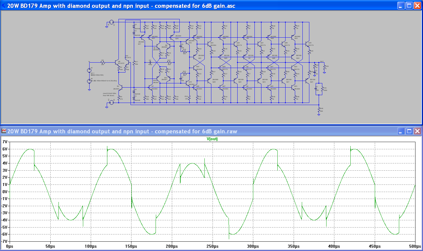

Cascading diamond buffers - a cheap low THD 10W amp with TIP41C
Of course with the removed silly 22nF input capacitor as you need
a fast risetime in Spice to excitate oscillation!
Don't forgett that in a real cirucit the thermal noise will excitate
your circuit from DC up to infrared and will trigger any instabilities...

I have no idea why I'm even humouring you, given you're being incredibly rude and aggressive, but here's a version of the compensation (exactly the same amplifier) that'll put up with your square waves with no input HF filter, not to mention being reasonably stable down to around 6dB gain. There's a penalty for that though - 10KHz THD has blown out past my 1ppm design goal.
  • 20W BD179 Amp with diamond output and npn input - compensated for 6dB gain.asc

Great, you have finally added reasonable compensation caps 🙂
Your amp is now stable with about 20 degree of phase margin, though
on the border.
Try to add 10 nF to the output - it will again burst into oscillation.
No wonder, this beast has 107 dB open loop gain @ 10kHz!
And the open loop response does not look as if someone has
spend time on it.
Thermal noise is amplified as any signal,
and the output noise couple back to the input through the feedback resistors.
If the amp is unstable it will add in a positive way,
and in a few mS later you have an oscillator.
Besides the stability problem, the amp has other serious shortcomings:
It wastes 1/3 of the supply power with 4 Ohm load as the
diamond-buffers have serious shortcommings in power amps:
They limit the base current of the output transistors.
=> Bad peak power capability => forget them in this config.
The DC level of the first cascode stage is still rather random. It needs
a common mode stability circuit.
A current mirror would be a very good idea, but this does not work
in your amp.
The nice idea is that you have put 3 amplifier stages in one amp.
The bad news is that you have not though about it.
Look up some text about opamp design. The better ones have
three stages and some clever compensation schemes.
And forget your 1ppm goal. At this low levels simulation will tell
you exactly nothing as layout and transistor effects not modelled in
LTSpice are more important.

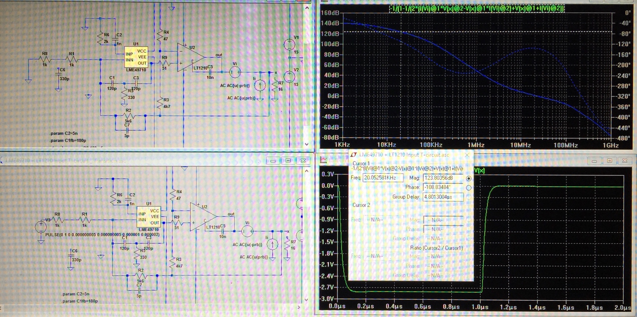

It’d be a neat trick if I could manage 100dB of OLG at 10KHz.
Why not to draw open-loop gain plot?
Do you need help with this?
And maybe you could agree with a hair under 10W at 8 Ohm with one LT1210.
That’s over your budget, but diamond output no so good as 2EF for such a load.
Also i’ll think about cheap as dirt NE5532 with 2EF output buffer.

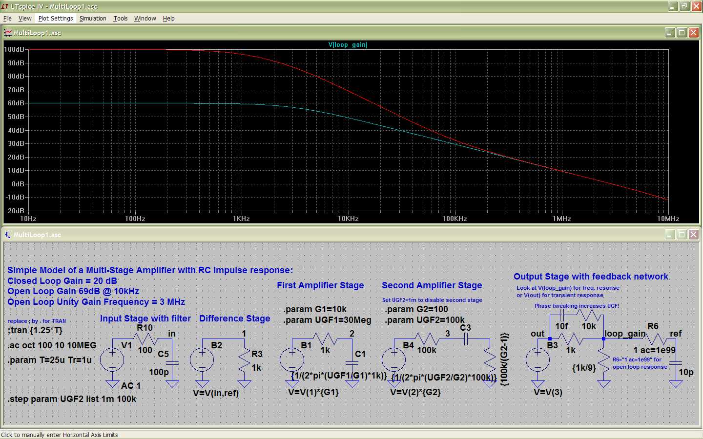

can you please give a pointer to such a derivation? No problem, if it is on the mathematical side.
Thanks in advance,
Matthias

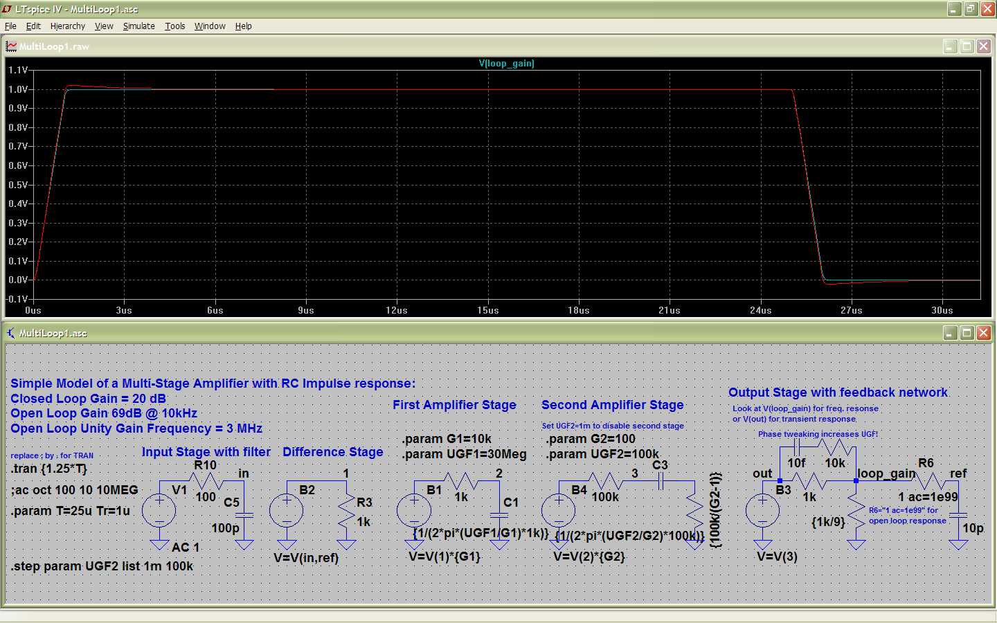

Assume you have two amplifier stages:
A simple and workable approch is that the second stage gain
goes down to unity at a frequency at least 10 times less than the
open loop unity gain frequency of the first stage.
E.g. first stage has open loop UGF of 3 MHz,
and second stage has UGF of 300Khz.
The overshoot will not be more than 4% in this case,
and only with fast impulses which do not occur in Audio.
If you design your amp this way, it will behave like a R-C filter with gain defined by your feedback resistors.
I added a LTSpice file to illustrate this concept.
I choose a UGF of 3 Mhz for the whole amp, maybe even 3 MHz is too much for a TIP41/TIP42?
If the second amplifier has a UGF of more than 1/10 of the UGF of the
whole amplifier, you could use a bessel or butterworth filter,
but this must be tailored to so that the frequency response of the
whole amp is a bessel filter.
I could not think of a better method than trial and error.
Maybe BesPav can help us?
