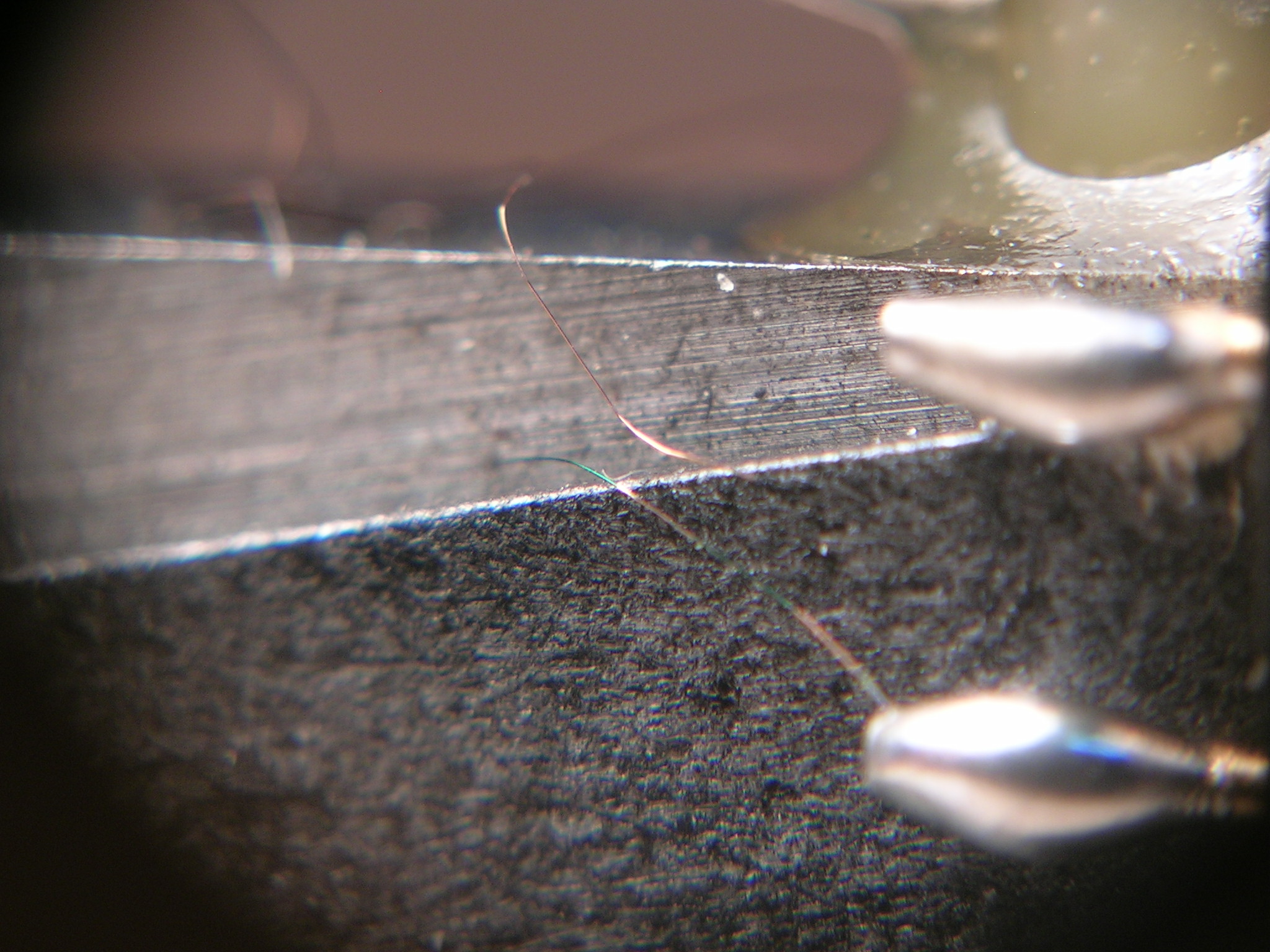

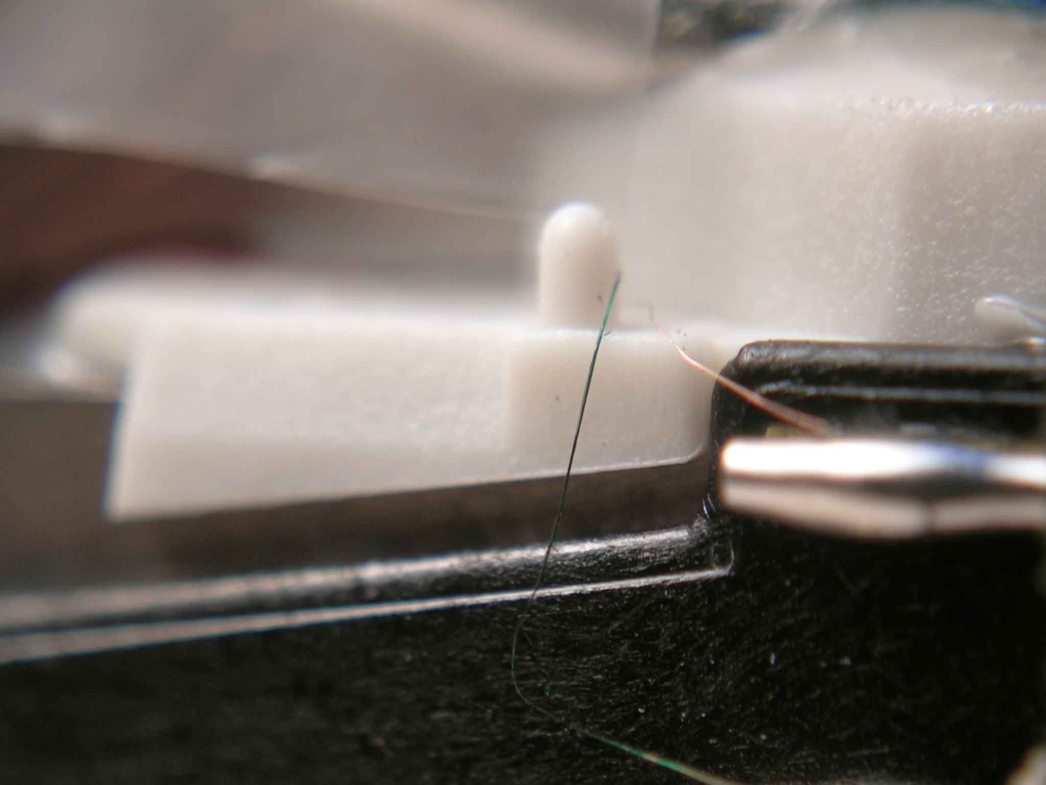

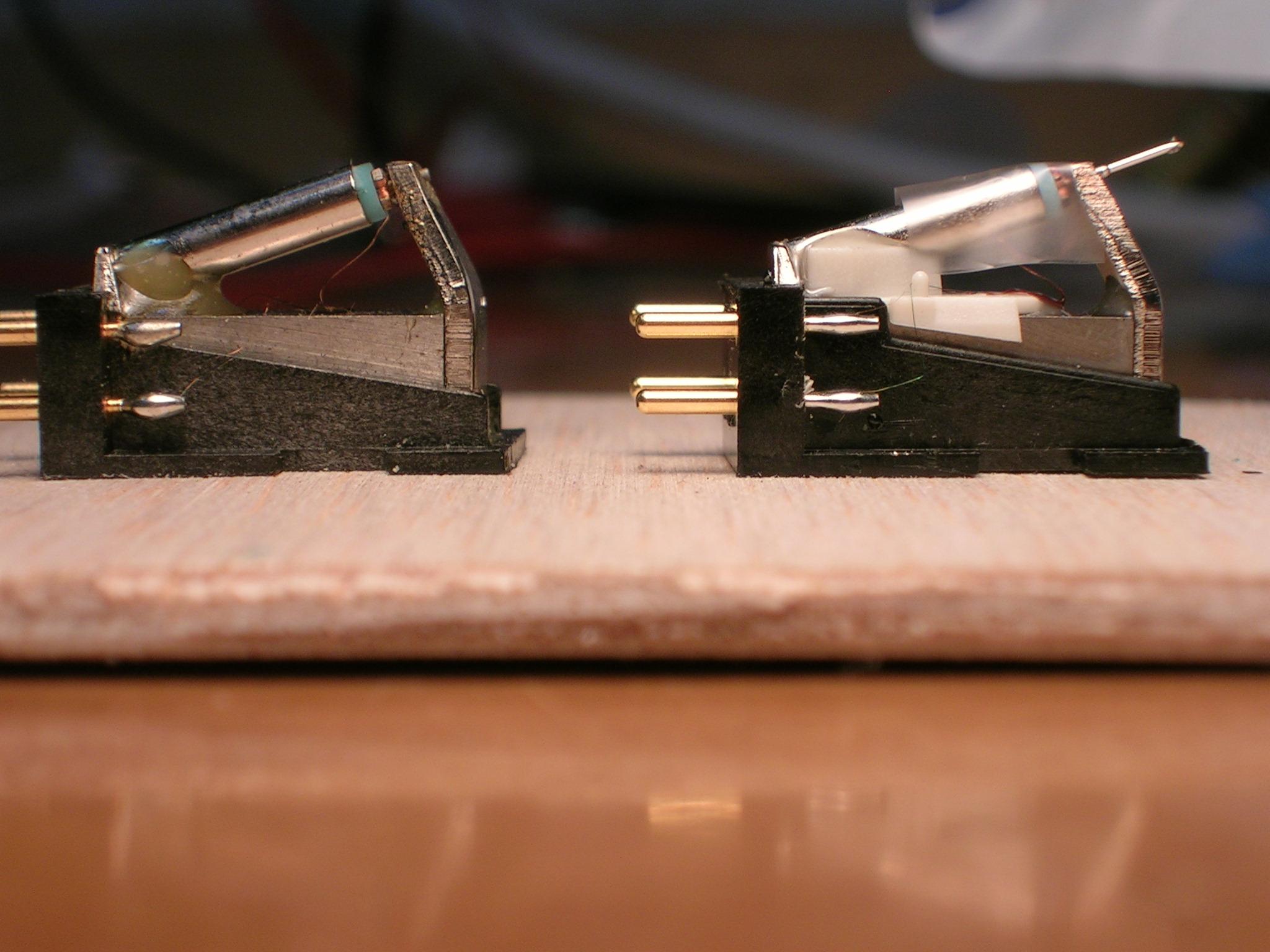

Joined 2002
Thanks Jonathan for the feedback.
Extremely thin wires may cause after sales reliability issues.
e.g. the older DL-103 becoming silent on one or both channels due to wire break where it was touching the magnet edges. Later they installed a plastic dressing over the magnet and smoothed the plastic edges to protect the wires , I can’t say if they increased the thickness of the wire too.
There is a big difference in the feel btn annealed and not annealed copper .
I have no experience with high purity OFCs, thanks for sharing your experience.
Also good to know the Lyras use robust wire, wise choise.
George

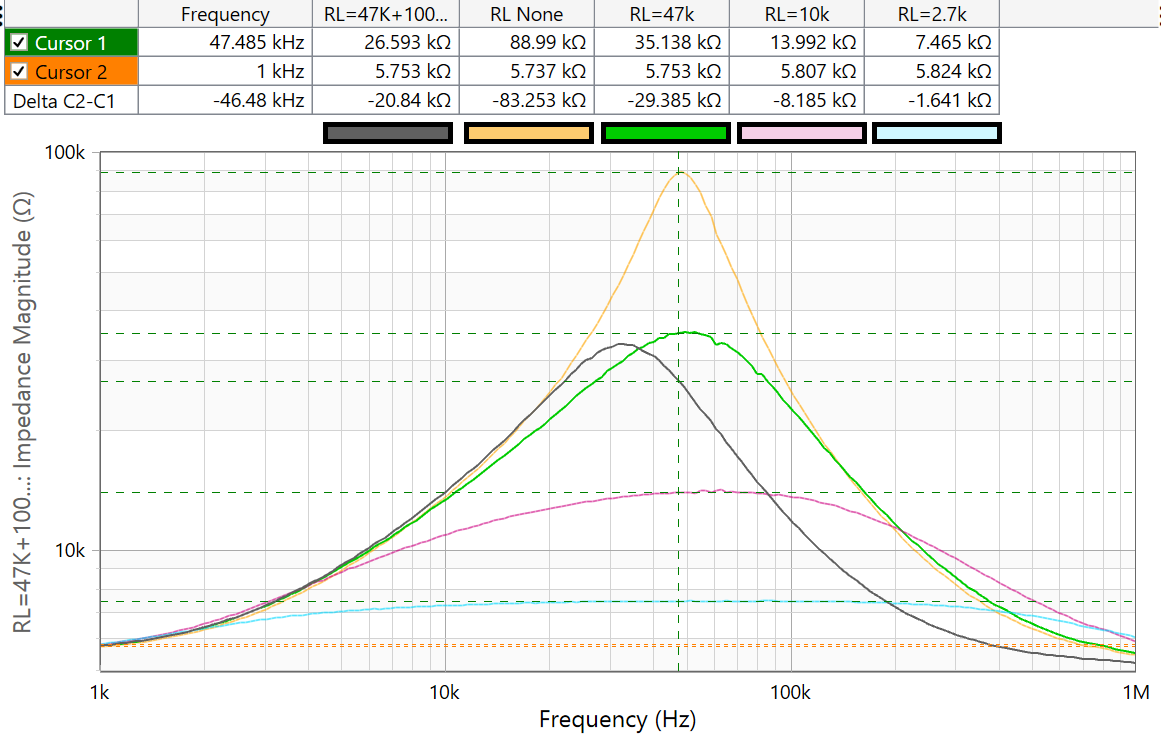

Thank you jackini. Very helpful post.
What is the test setup?
George

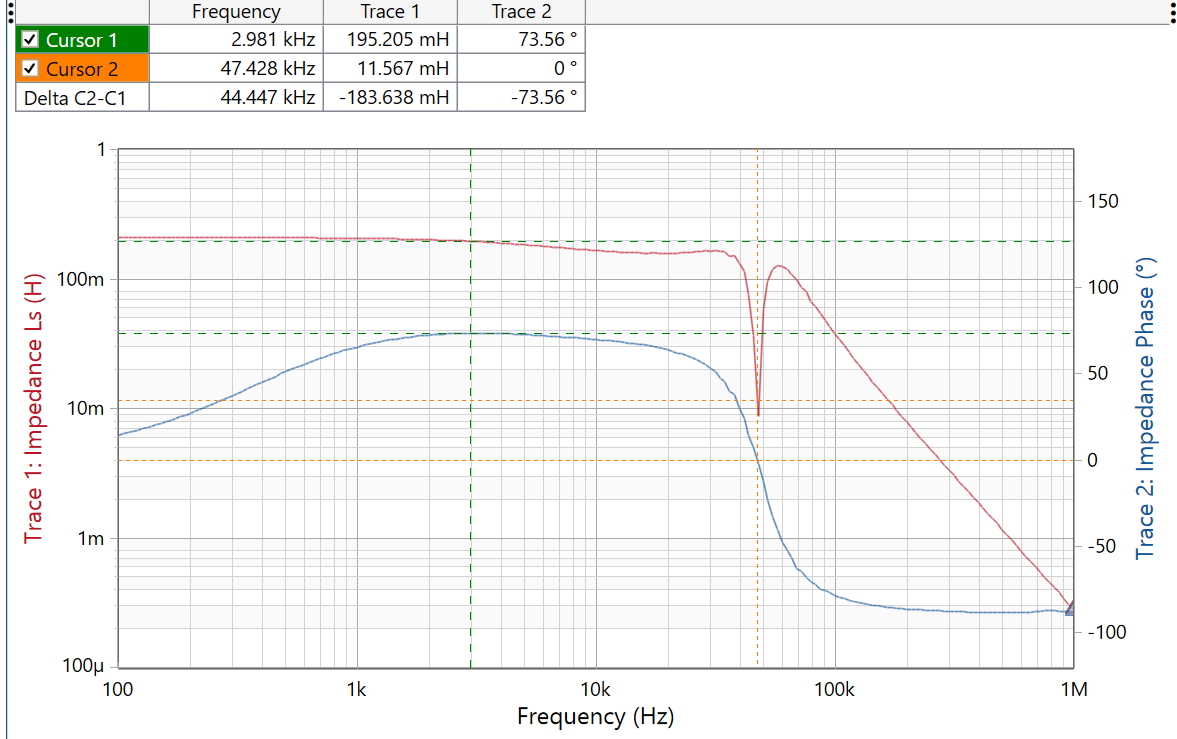

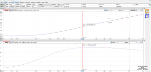

A Bode-100 Vector Network Analyzer with the source set at -10dBm, feeding a 5K caddock resistor. The caddock's are very good up to 10MHz or so.
You can see the pure inductance + shunted inductance effect and the resonance at 50kHz which gives an idea of "capacitance".
Something about this plot looks wrong the notch is too steep for that phase plot. The notch looks more like a vector subtraction than a resonance, can you slow down the sweep?
Also sorry to be thick but is there a picture of the test jig and exactly what is being measured?

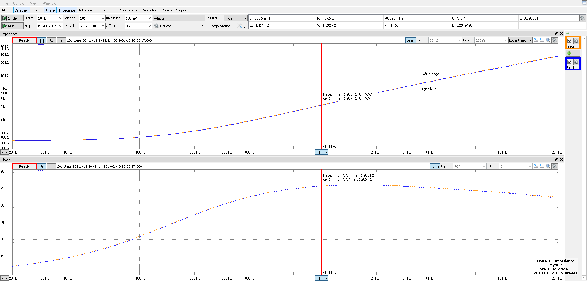

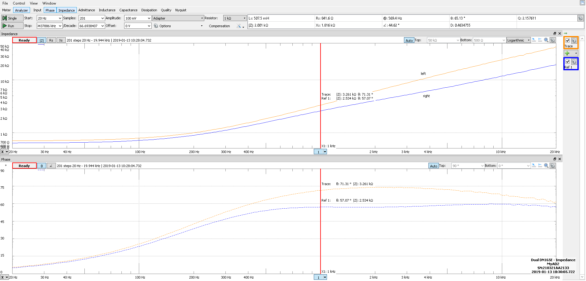

the value for the Shure´s inductance seem way too low, compared to the Datasheet.
Here´s my measurement of my old Linn K18 (AT95 Body, ATN145LC needle).
and my even oplder and probabley defect Dual DN165E (a Ortofon OM5e??)
The inductance values are here quite similar to the Datasheets .... the Linn/AT beeing a rather low-ohmic low-inductive device and the Ortofon considerably higher in values.
jauu
Calvin
ps. measured 20Hz to 20kHz, @100mV signal into 1kOhm.
