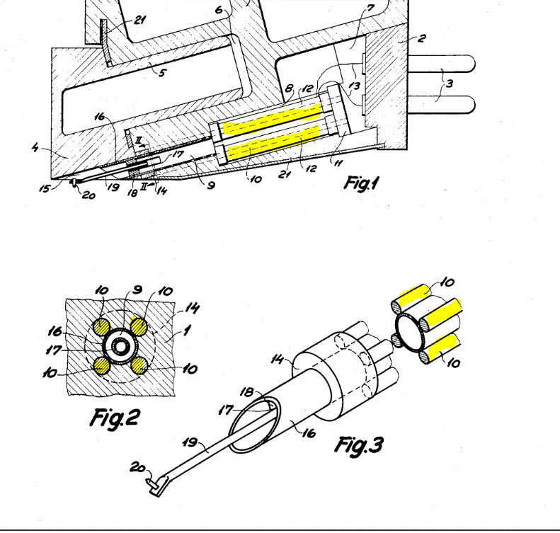

I looked at the brochure https://www.ortofon.com/media/15182/ortofon-series-500-mm-cartridges-brochure-page-1.jpeg
and then at their MI/MM patents
MAGNETIC STEREOPHONIC PHONOGRAPH PICKUP
Replaceable stylus for stereophonic phonograph pickup - Fonofilm, Industri A/s
I am not sure what they refer to in the brochure by the “pole pin”
Do they mean in the patents the moving element 17 (fig. 1, 2), which in one implementation is a soft tubular armature (MI fig.4) , in another implementation is a tubular magnet (MM fig.5)?
Or
Do they mean the fixed annular permanent magnet element (14)?

Bill, again (if you know). Where in the patents drawings is the “pole piece” mentioned in the brochure’s fig 1, 2.
George
Marked in yellow.

Thanks Bill. In the patent, these four legs (item 10) are described as solid cylinders and not as hollow tubes (permalloy)

They were solid cylinders in the VM series (which was the design the patent was written for) and OM series. The 500 series were where the split pin was introduced and since then they have made examples of both solid and split just to confuse everyone!

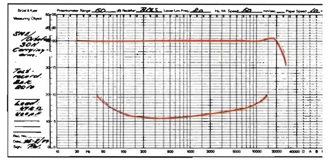

Doesn't help that the FR plot for the SME30H (solid pin) does not show the droop that they have in the 500 series brochure. BUT they are using a very healthy 400pF load and SME did put extra C in the arm base for ortofons.
