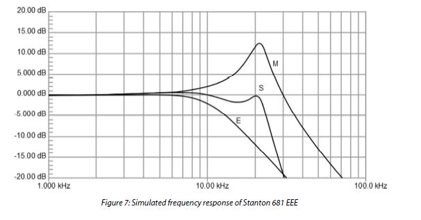

It doesn't, but it is oft repeated that there is a mechanical resonance to prop up the HF of the cartridge. See attached from a Linear Audio article courtesy of Jan and S Van Raalte. I don't buy it as the HF peak is explained by too much C. Just nothing to explain the presence region dip fully.
Non-reciprocal mechanical effects would certainly explain a difference between electrical and LP derived measurements and the fact that stylus up/down makes no difference.

The mid dip happens to broadly coincide with the quadrature frequency of cantilever as a transmission line. I wrote some models a time back that showed a characteristic dip in mechanical impedance, see if I can find them.
Basically, cantilevers aren't very rigid.

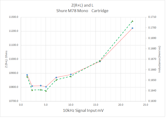

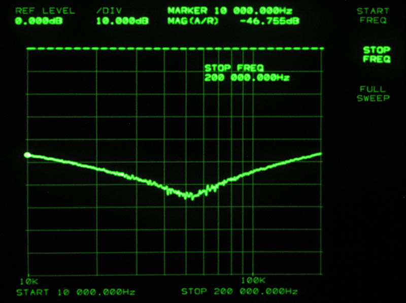

I saw some of the stuff George had posted on impedance vs signal levels. Since the Bode-100 isn't as good as the HP3577A in resolving low level signals I decided to move the test setup over to the latter and examine Z with signal from 1mV (-47dBm) to -20dBm at 10kHz. This is a first cut. I am going to have to build a jig to shield the cartridge for more precise measurement: (Jan, aren't you sorry you sold your HP3577?)

A few questions:
-First attachment, what is the division marks on the vertical axis and what does it represent (voltage level or impedance)?
-Second attachment, what is the frequency of the test signal?

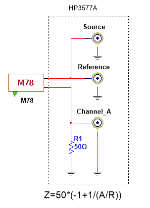

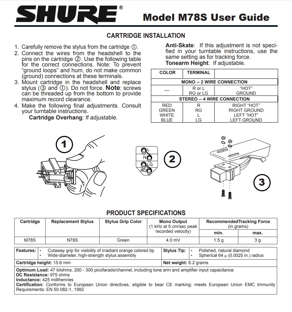

-Can you present a schematic of the test setup you are using?
The vertical axis is the dB ratio of Reference to Channel "A", it can also be linear magnitude.
10kHz

I'm not sure what is to be learned from measuring the cartridge inductance in parallel with a resistor that can't be determined with a simulation. The loss pathways between the mechanical energy in and electrical energy out are huge. Loading won't alter the mechanical motion. It will alter the electrical behavior. If you draw any current the magnetic nonlinearities will get mixed in. Maybe the additional distortions are pleasant?
Jackinnj's setup could allow for quantifying the distortion contribution.
Thanks. So it is freq response rel to Reference (and it’s 10dB/div).
Ouch. It seems that I am blind (in addition to being deaf)
