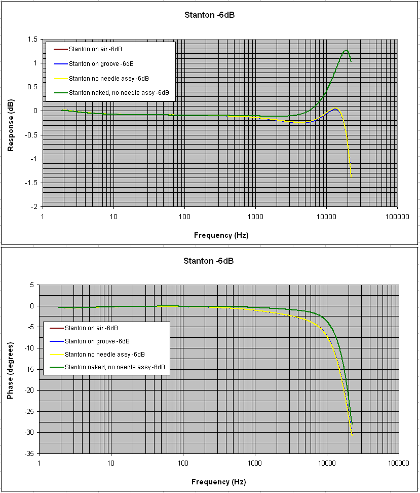

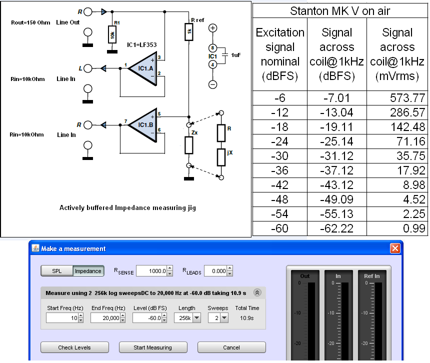

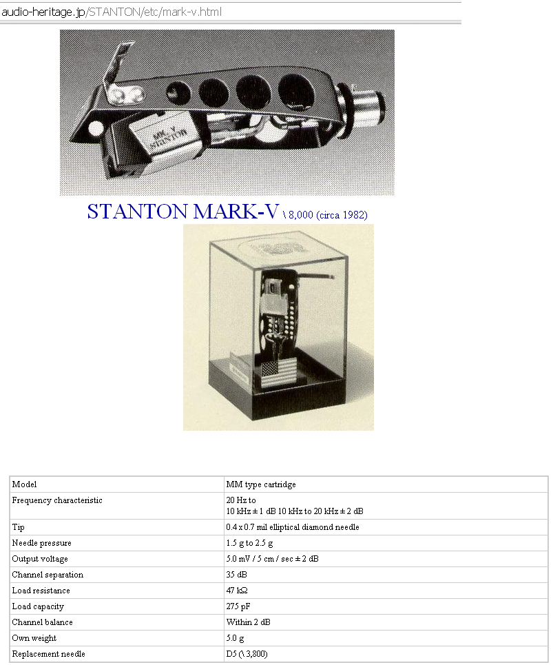

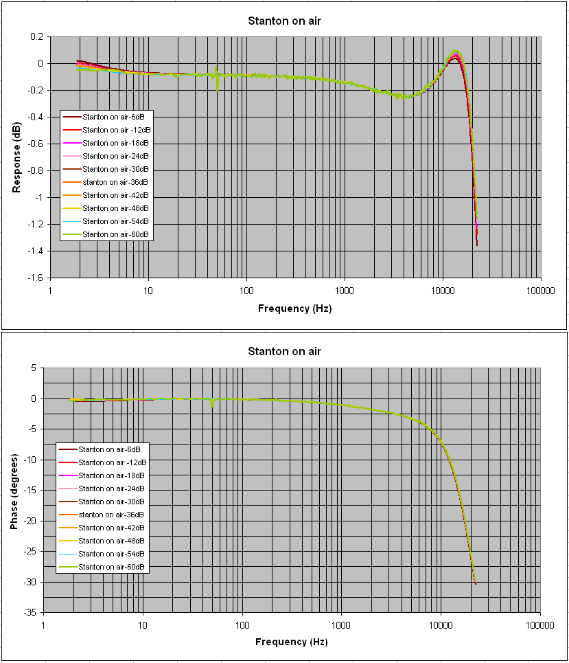

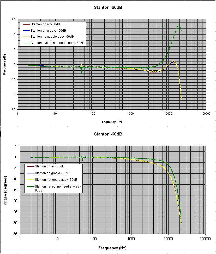

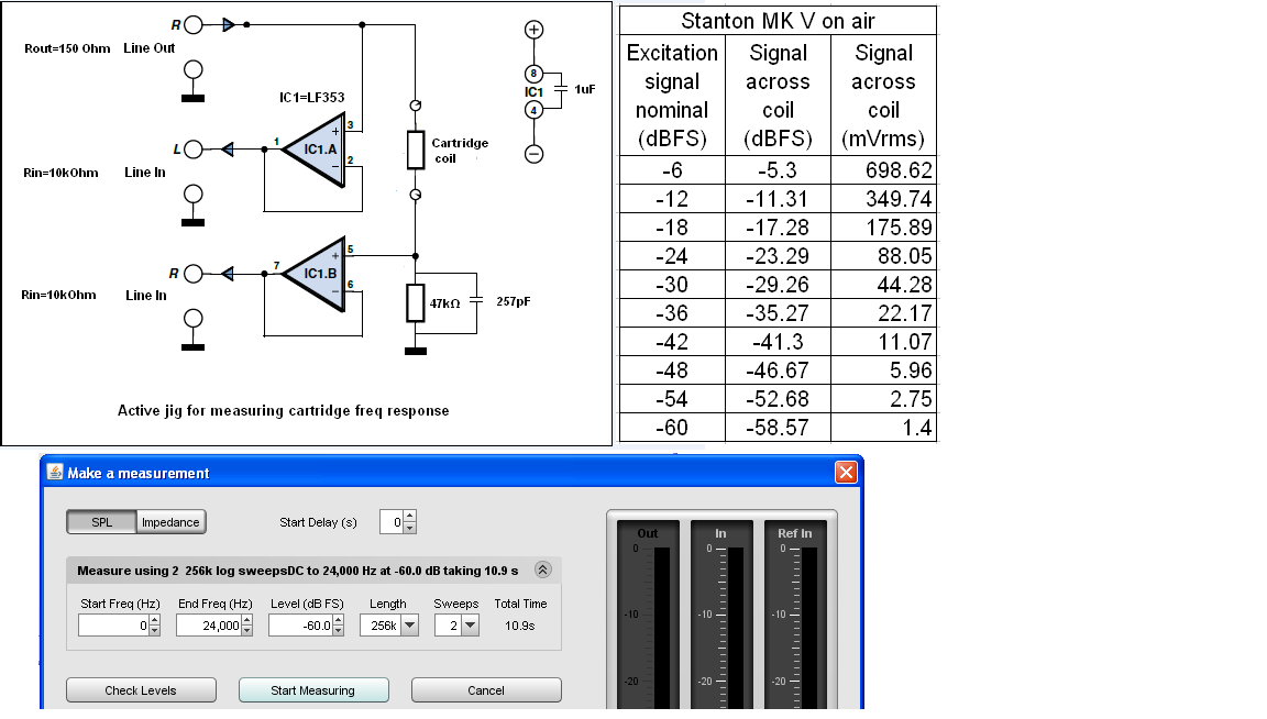

Back to the subject of the thread.
Measurements done with REW sw.
One set of measurements with the cartridge as shown on schematic.
Another set of measurements with a short in place of the cartridge coil.
Both measurement sets exported as txt files and imported into MS Excel. No smoothing applied.
At the diagrams you see the result of [cartridge set] – [short set].
This subtraction removes any jig’s freq response and phase influence from the result.
George

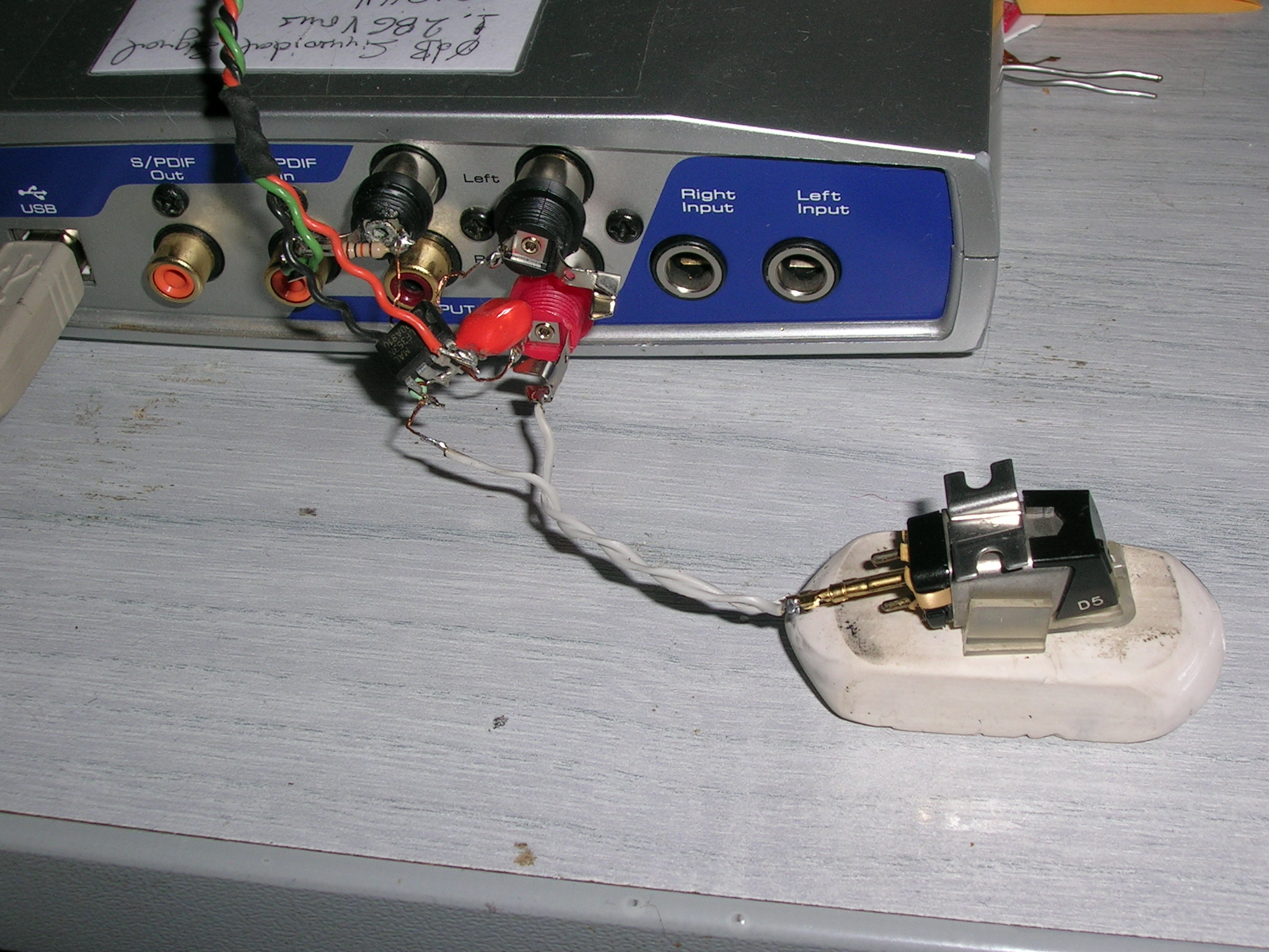

George
George,
Great set of measurements.
What are your conclusions and how should this information be used in relation to dynamic cartridge behaviour.
Hans

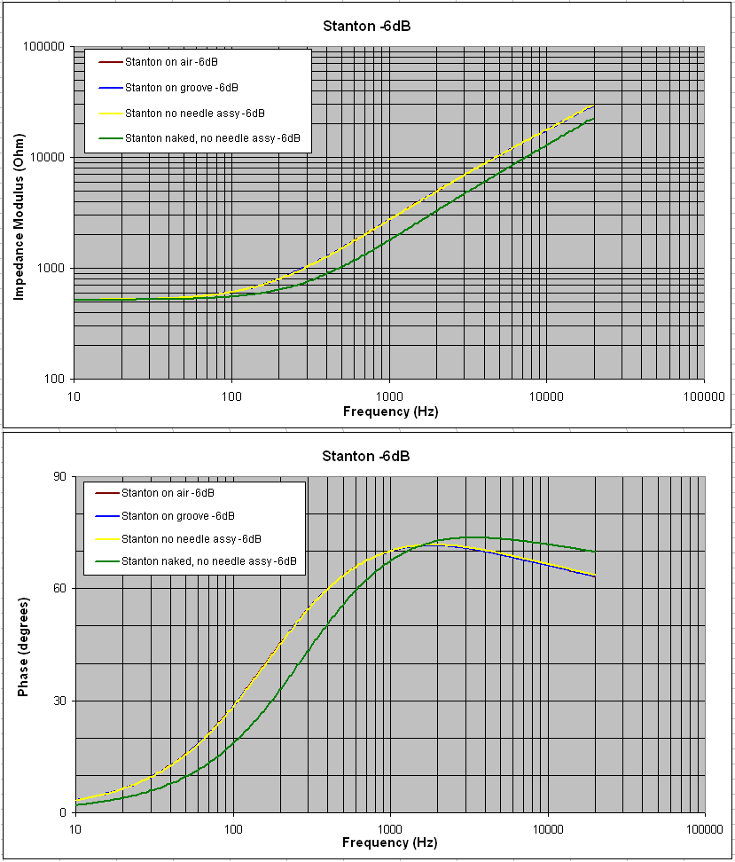

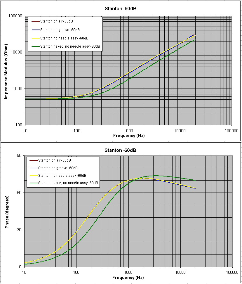

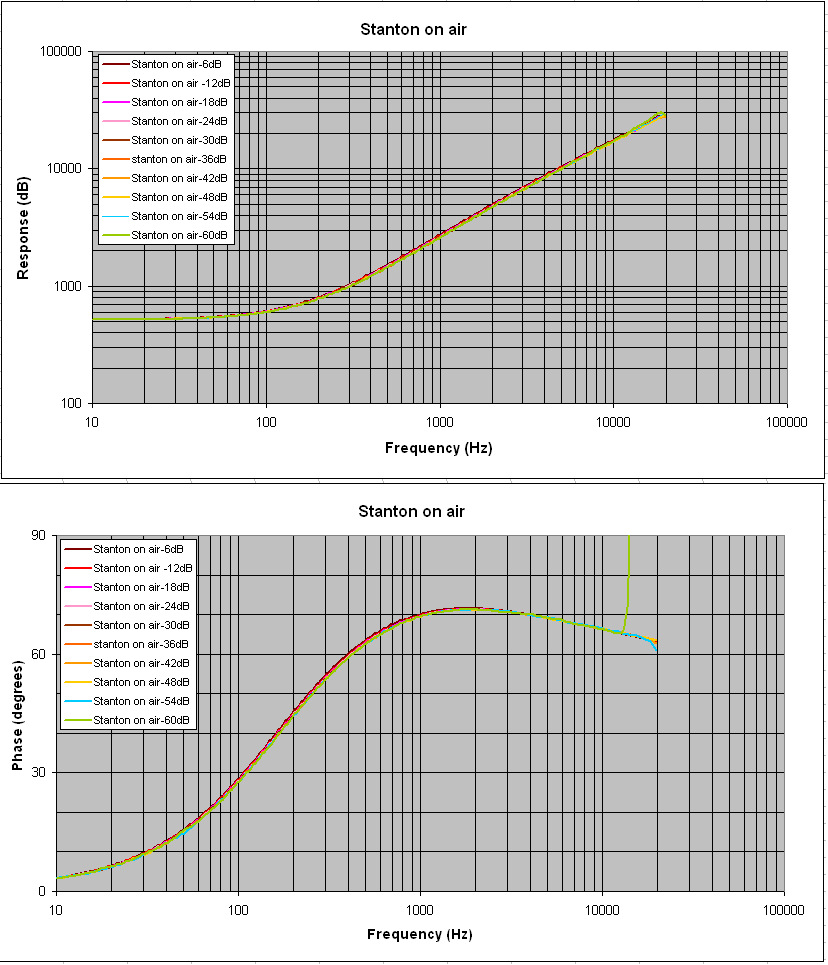

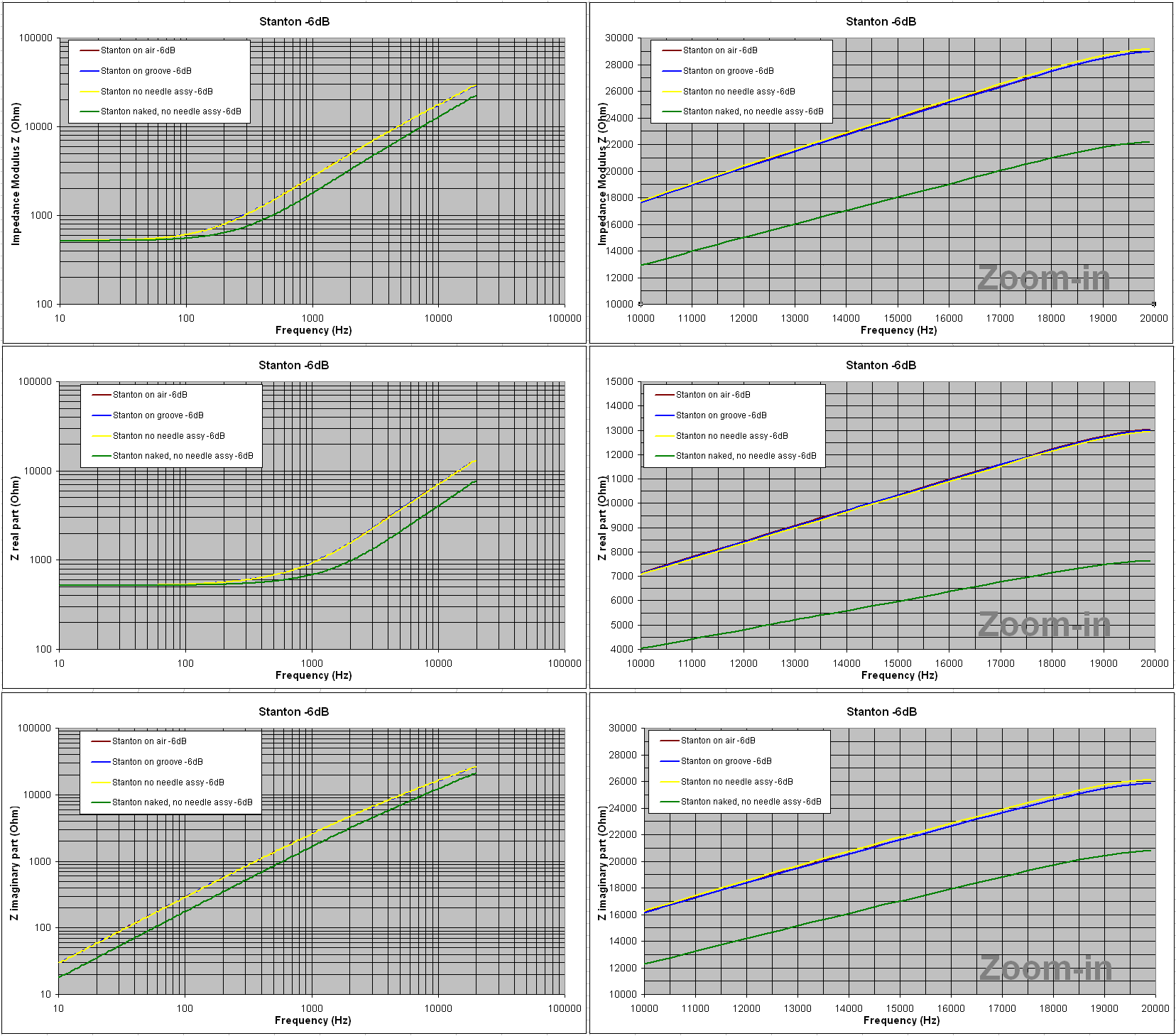

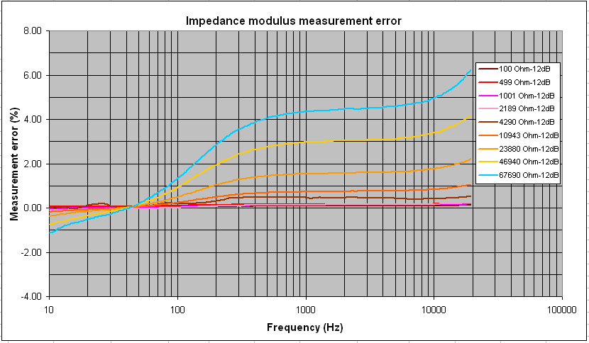

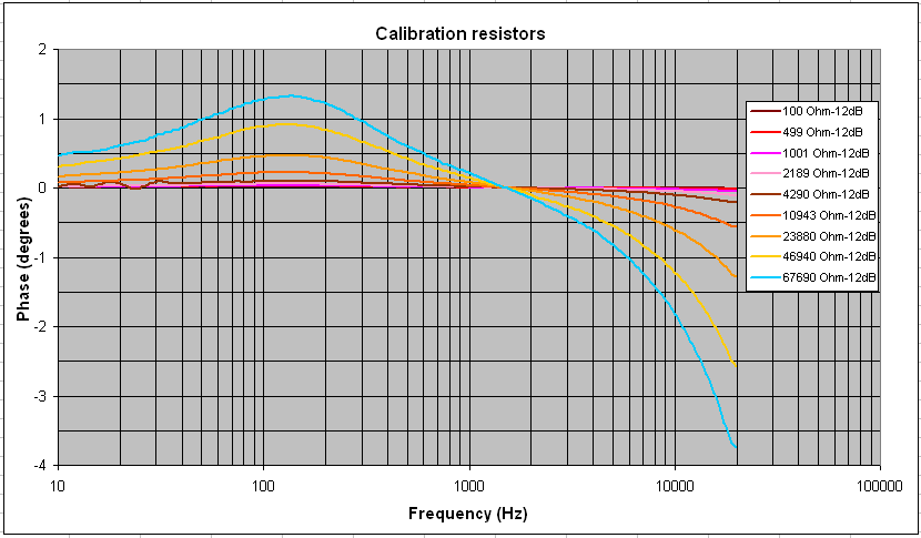

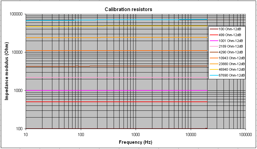

Next, Stanton MK V Impedance measurement.
Again, measurements done with REW sw. Measurement sets exported as txt files and imported into MS Excel. 1/6 oct smoothing applied.
First three attachments is result of measurement jig’s characterization with calibration resistors. Not very bad for using a single reference resistor across so wide an impedance range.
George

George,
Thank you Hans
The excitation signal was from –14dB to +41dB ref 5mV, enough to cover the dynamics of a musical crescendo from p to fff
Within this signal range these measurements don’t show any change in behavior. Maybe there might be something at an even lower excitation level due to the core permeability nonlinearity at very low flux levels (initial permeability).
A secondary observation is that the moving parts of the motor don’t affect the measurements almost at all, another indication of very weak reciprocity.
Yet, the metal shielding of this cartridge affect the performance above 1kHz quite a lot.
George

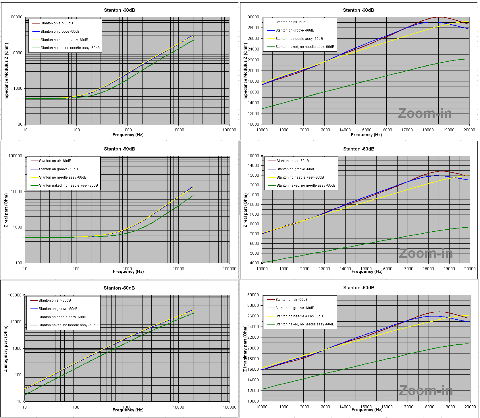

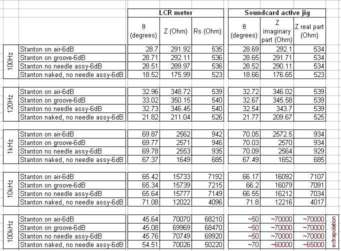

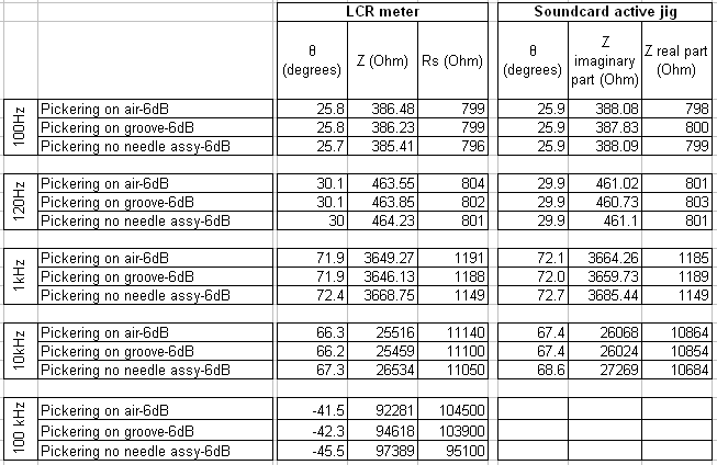

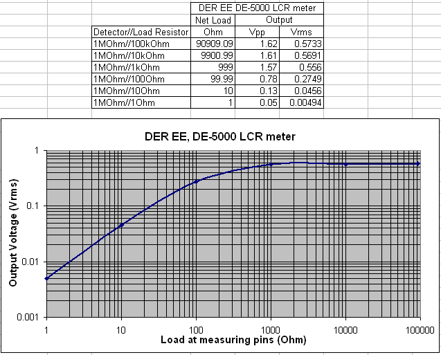

Continuation of post #189
I extracted the real and imaginary parts of the Z modulus.
It is good that there is close match between the measurements obtained from the LCR meter and those from the soundcard+active jig
Note: The 100kHz data for the soundcard is nonvalid. It is only an estimation through visually extending the curves from 20kHz to 100kHz)
George

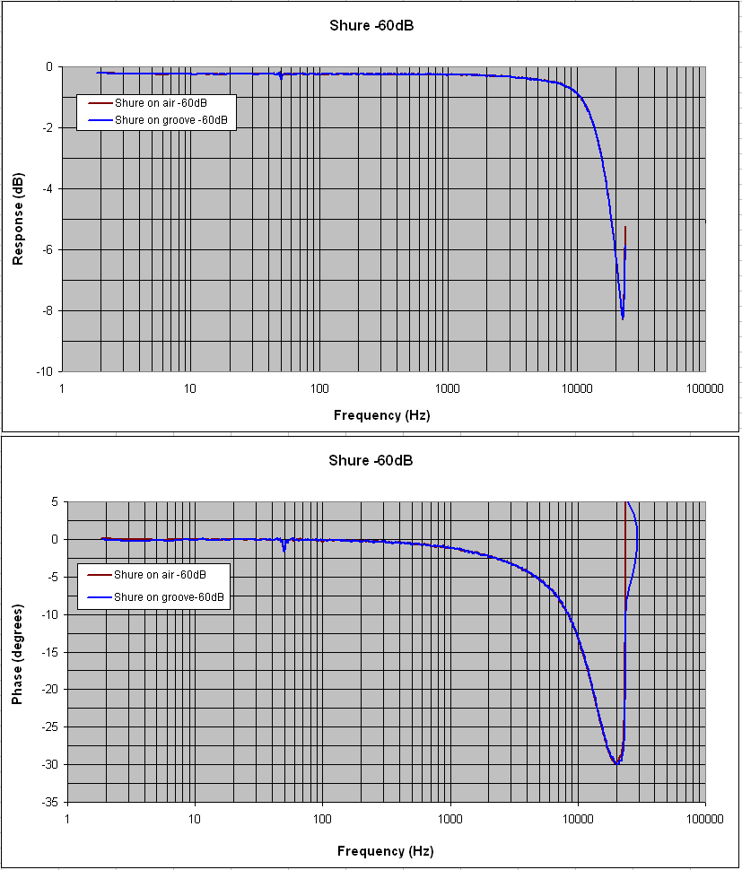

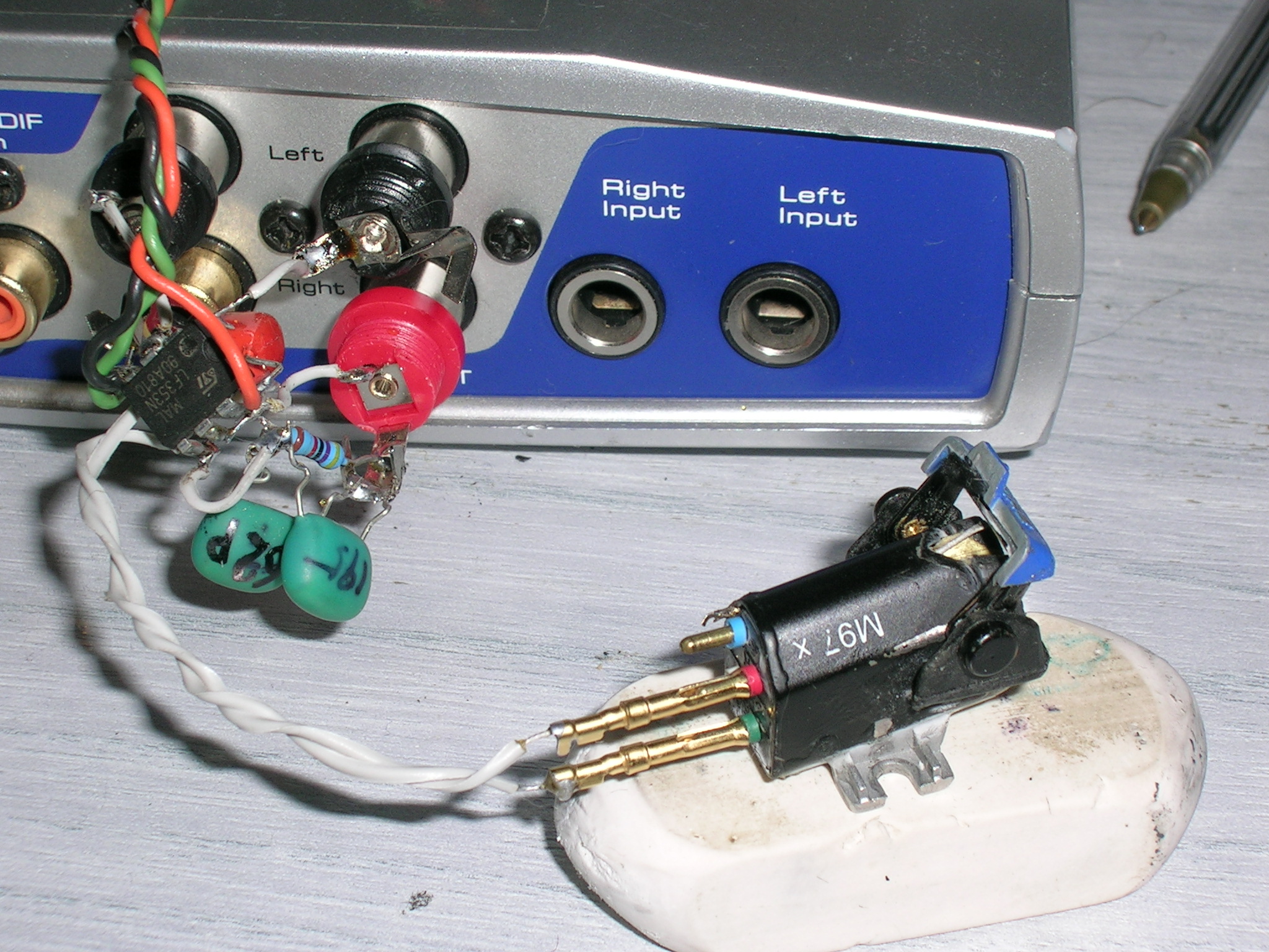

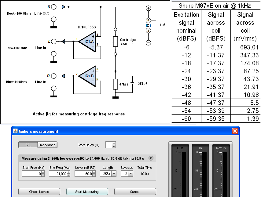

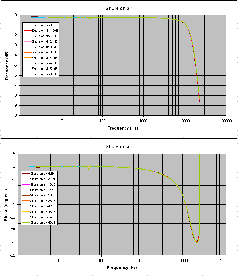

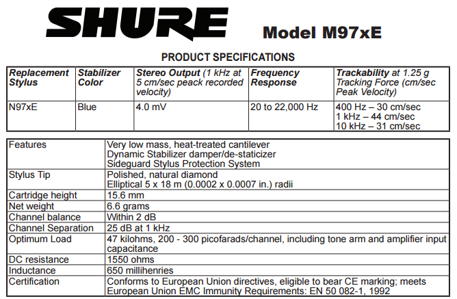

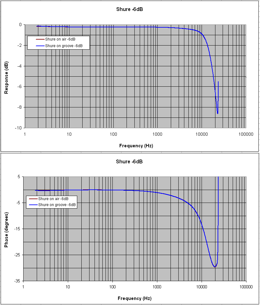

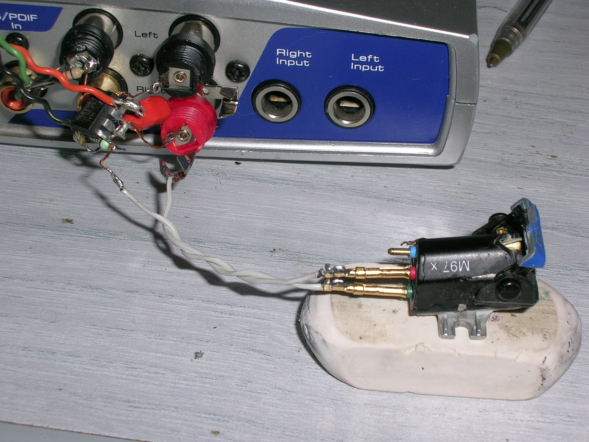

Shure M97xE response
George

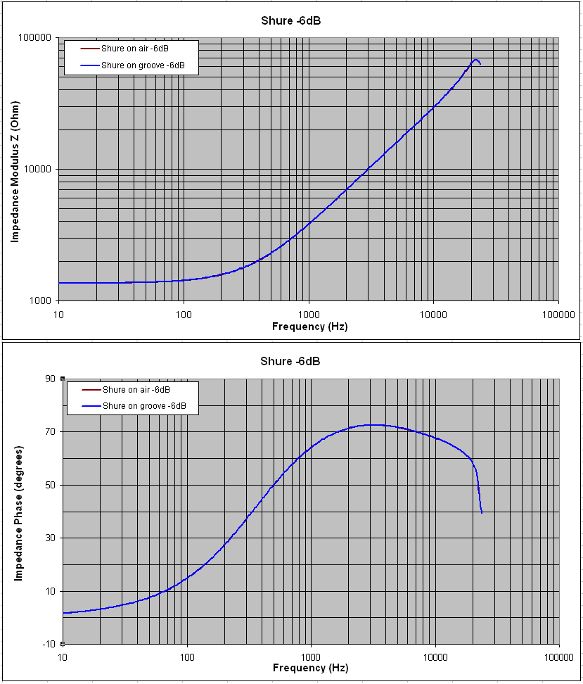

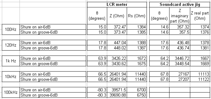

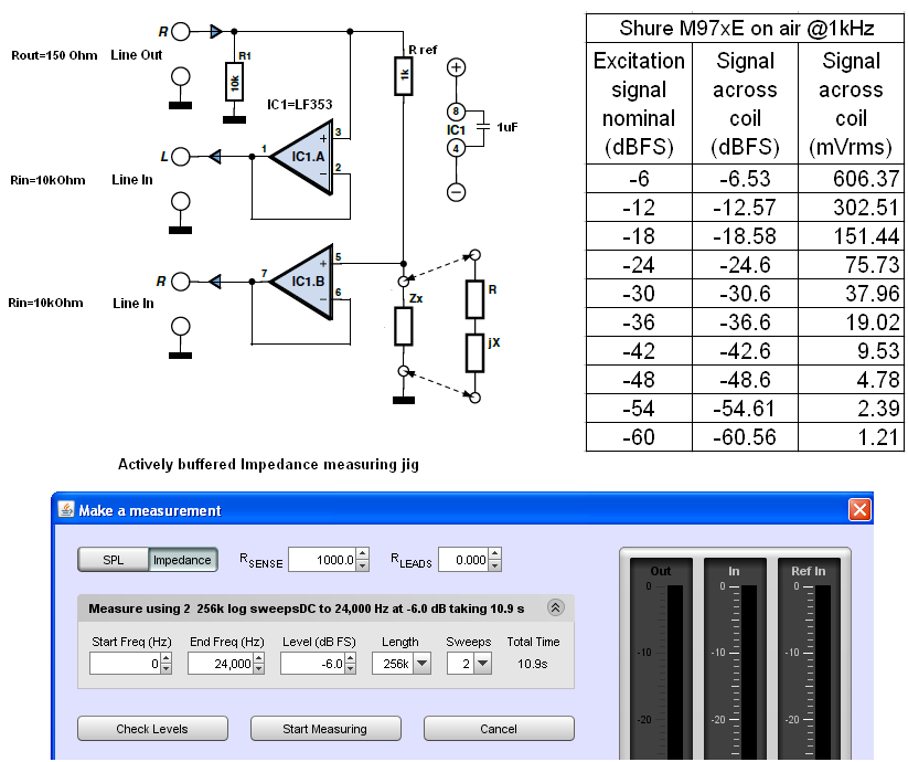

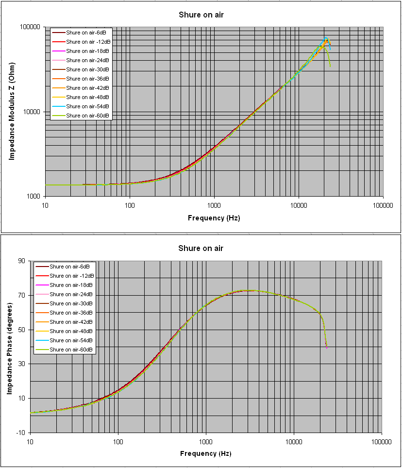

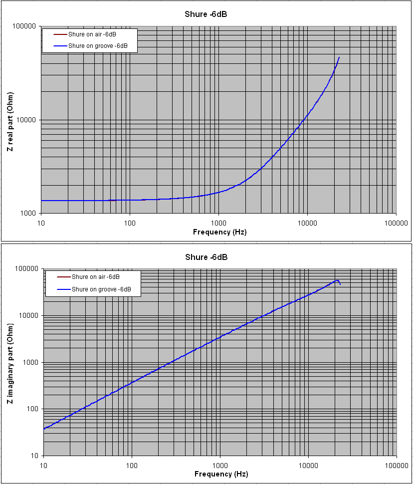

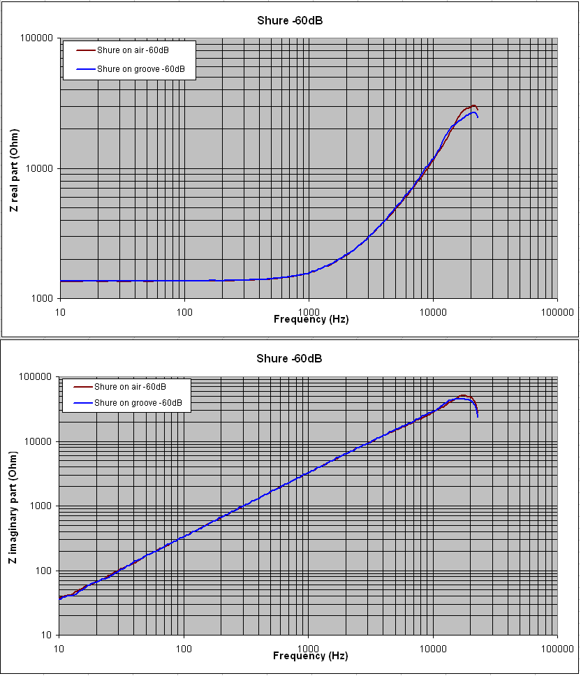

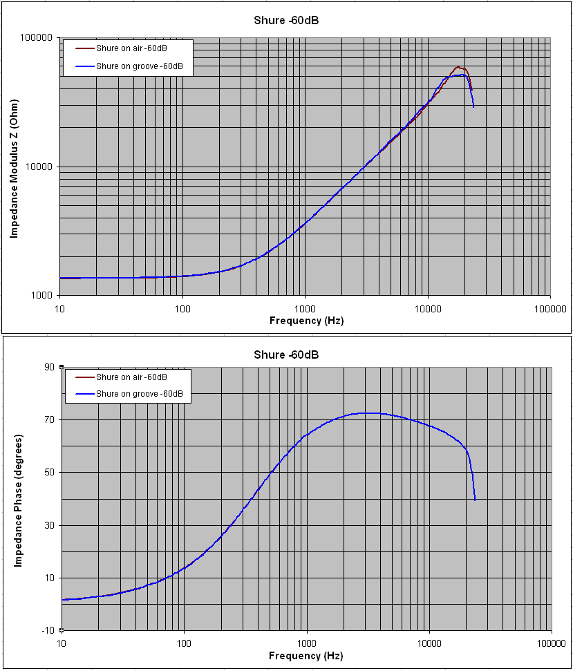

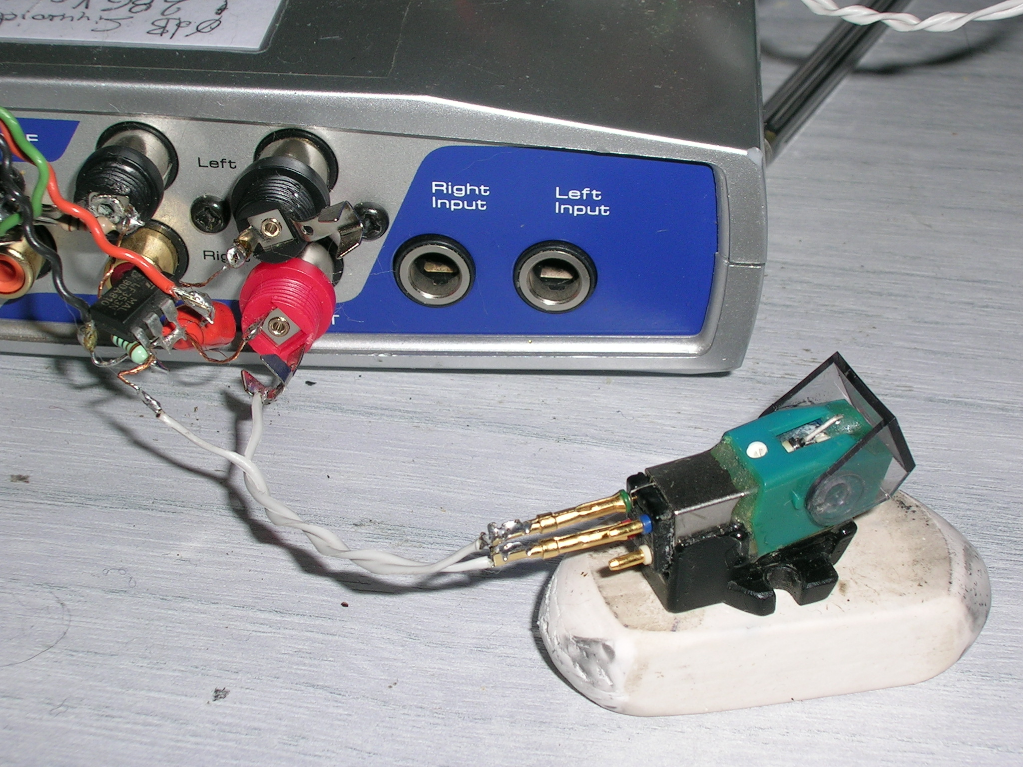

Shure M97xE impedance
George

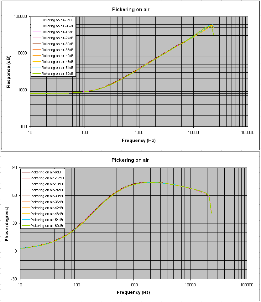

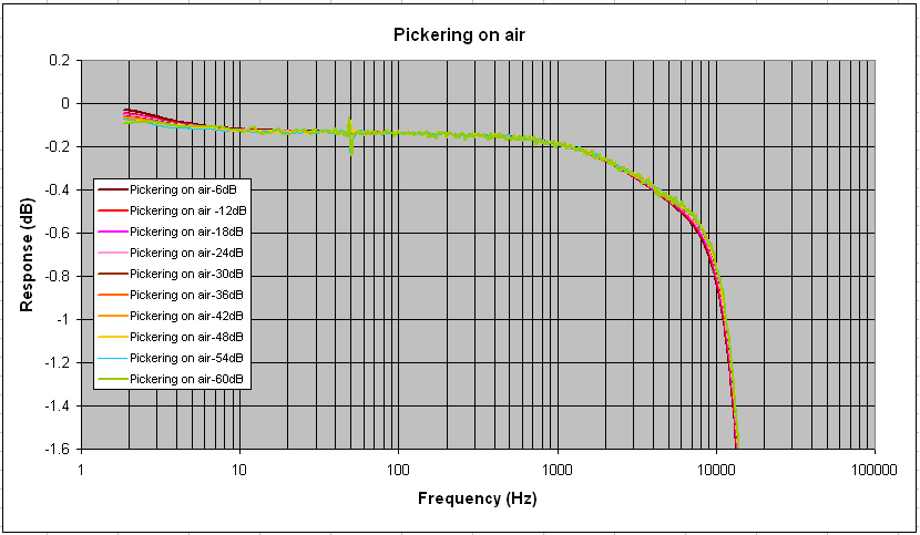

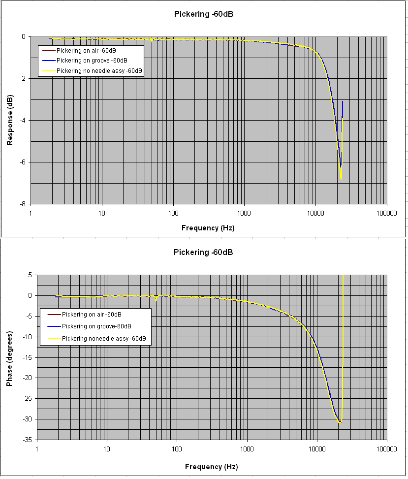

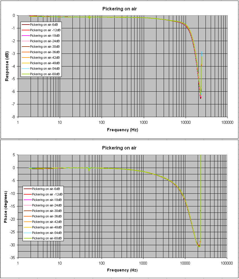

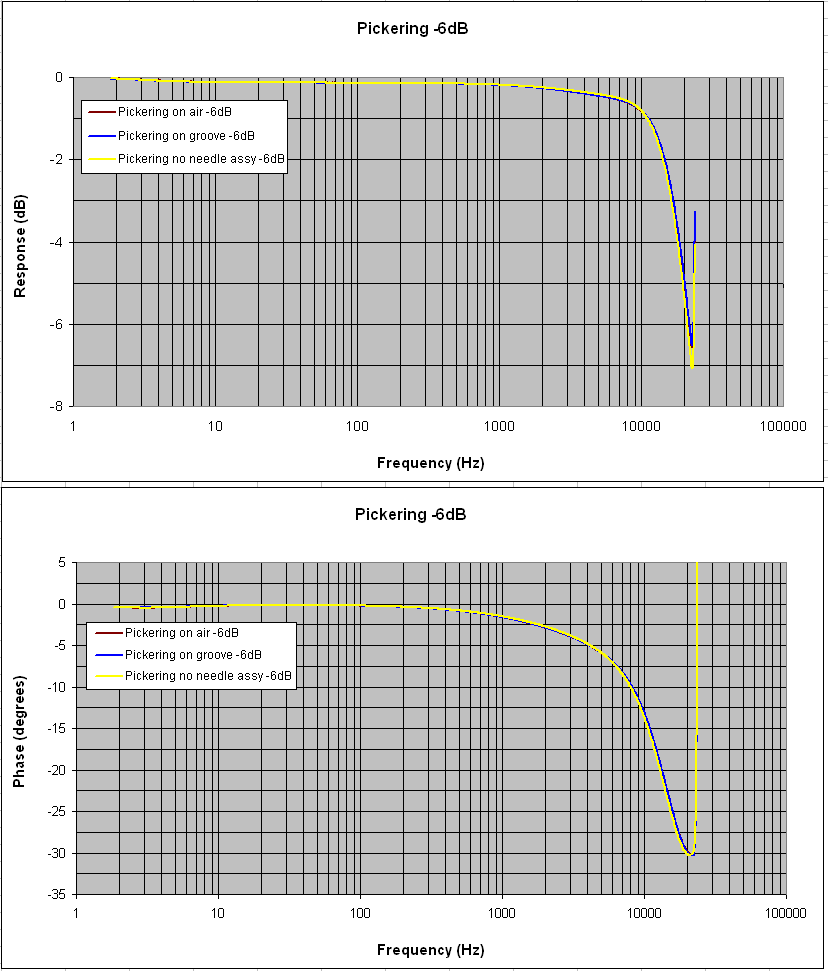

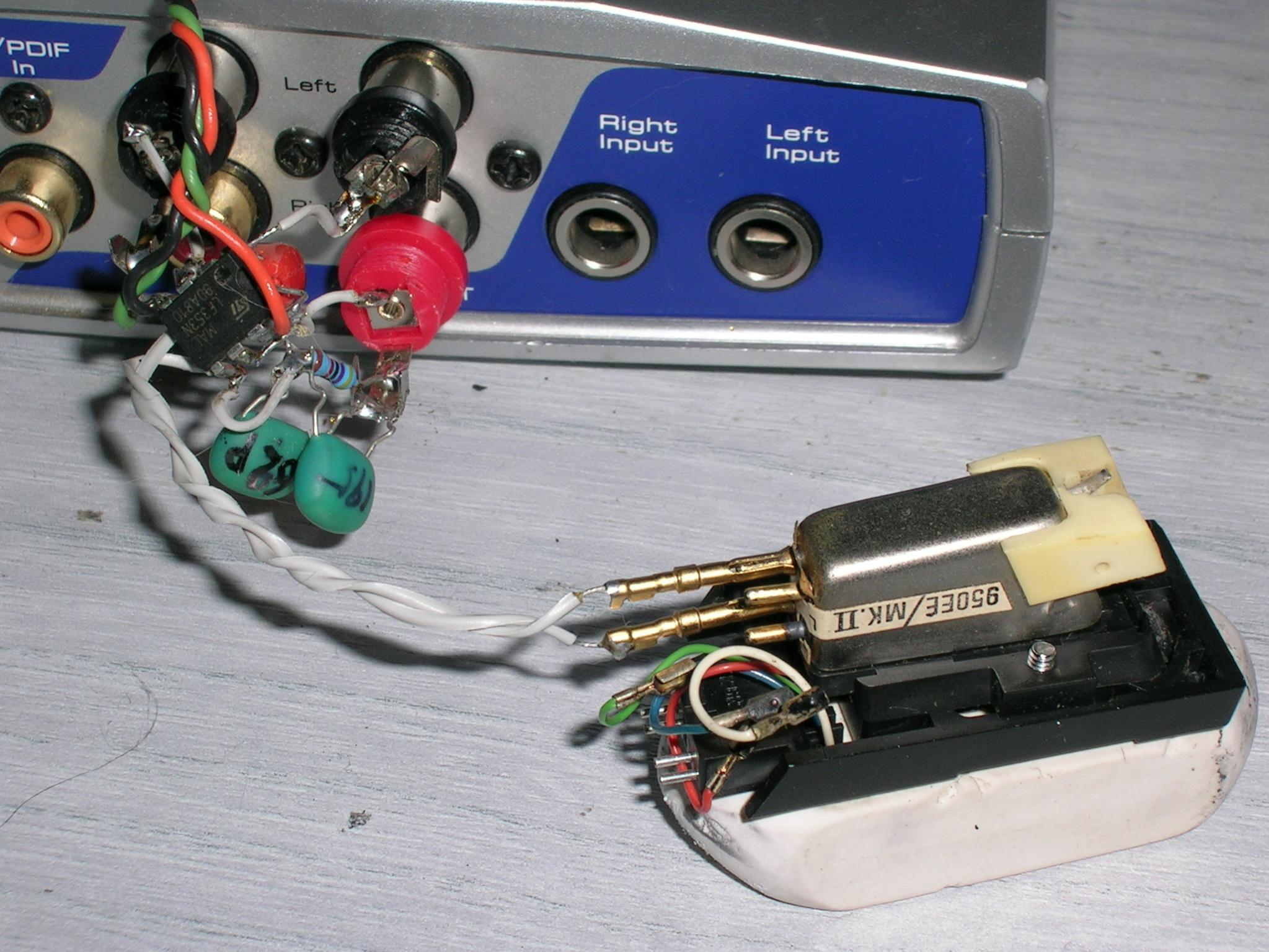

Pickering 950EE MK II response
George

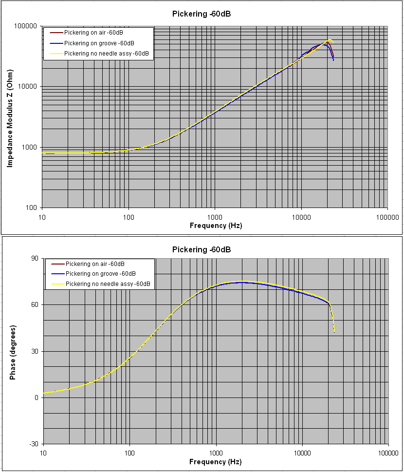

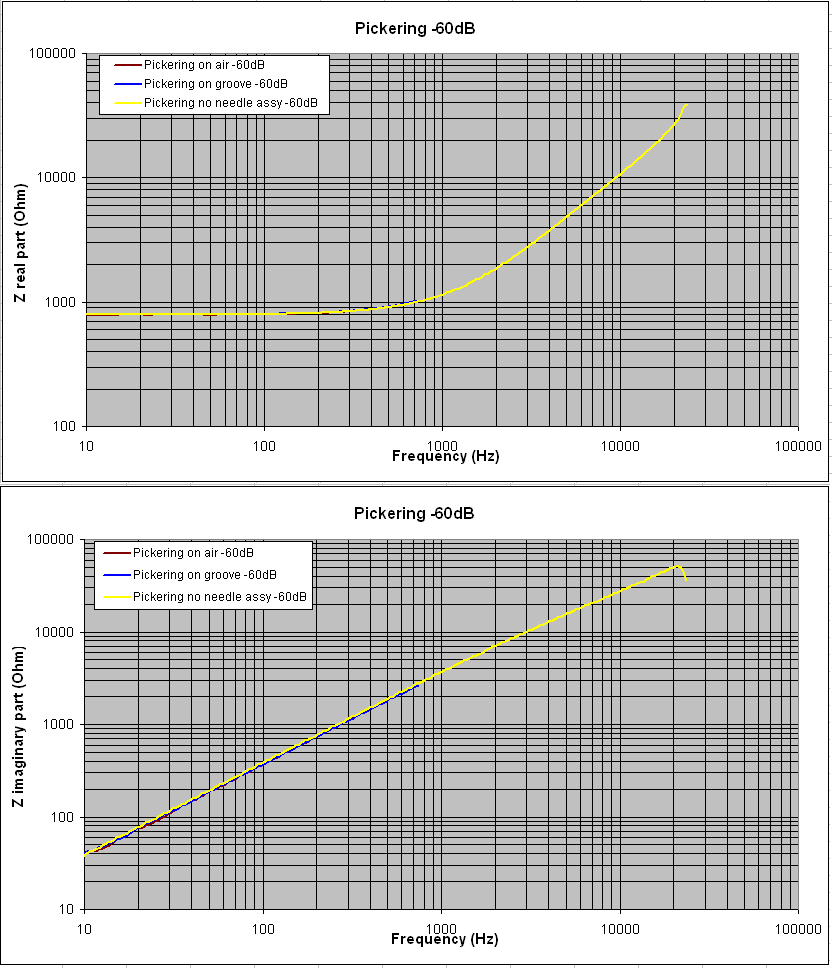

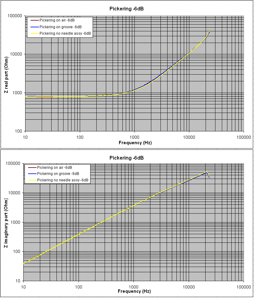

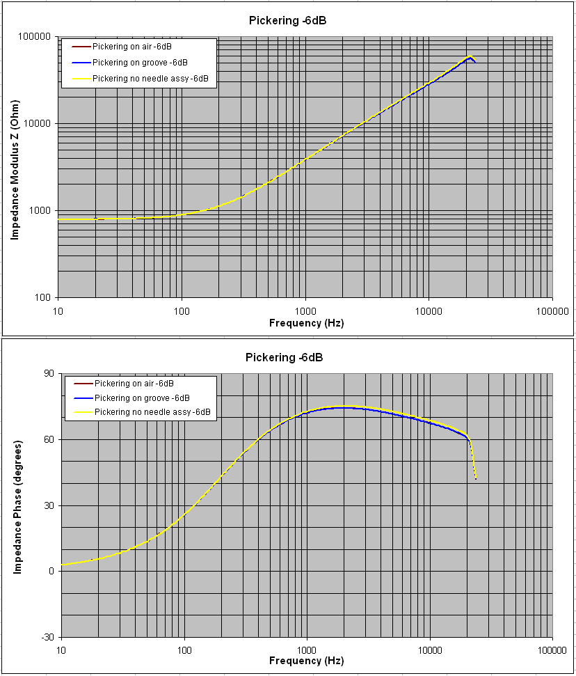

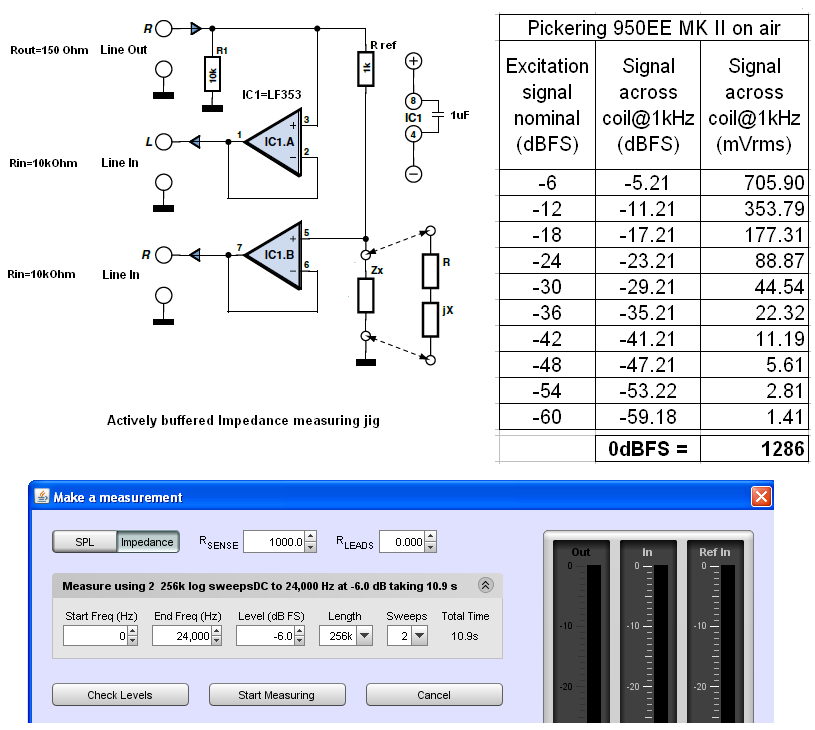

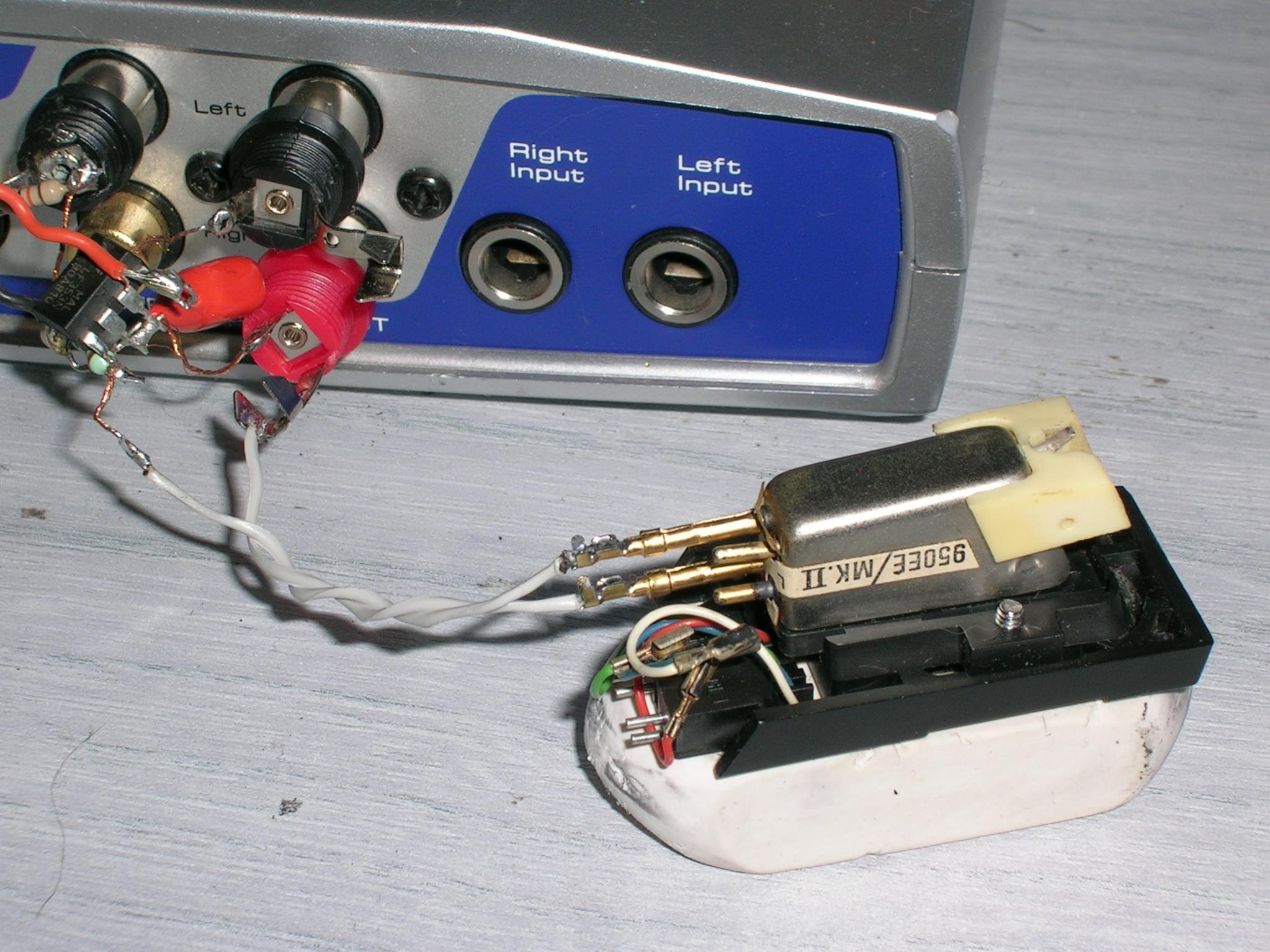

Pickering 950EE MK II impedance
George

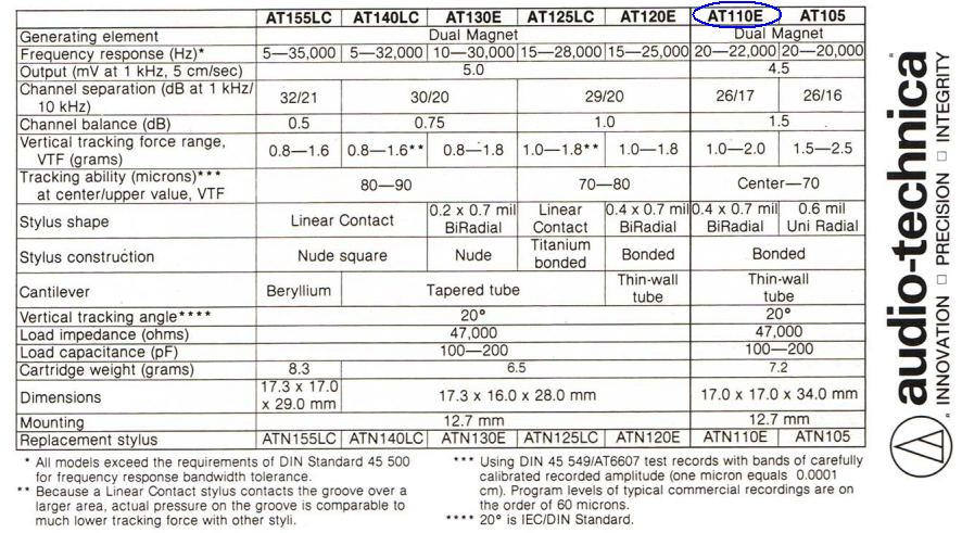

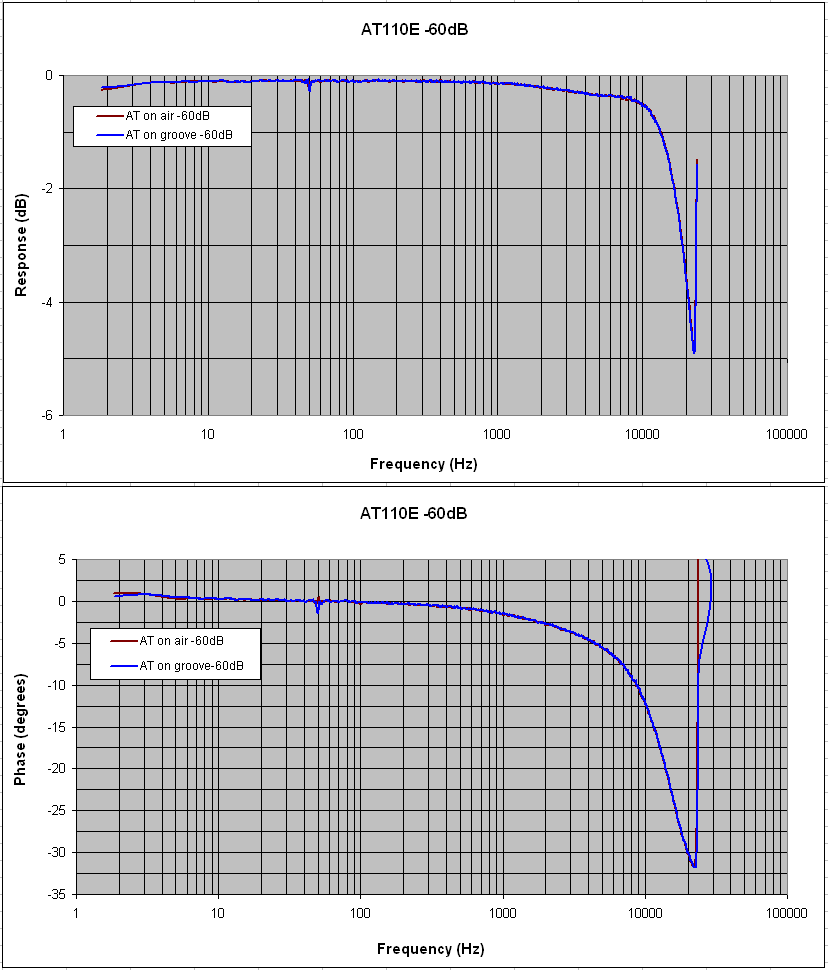

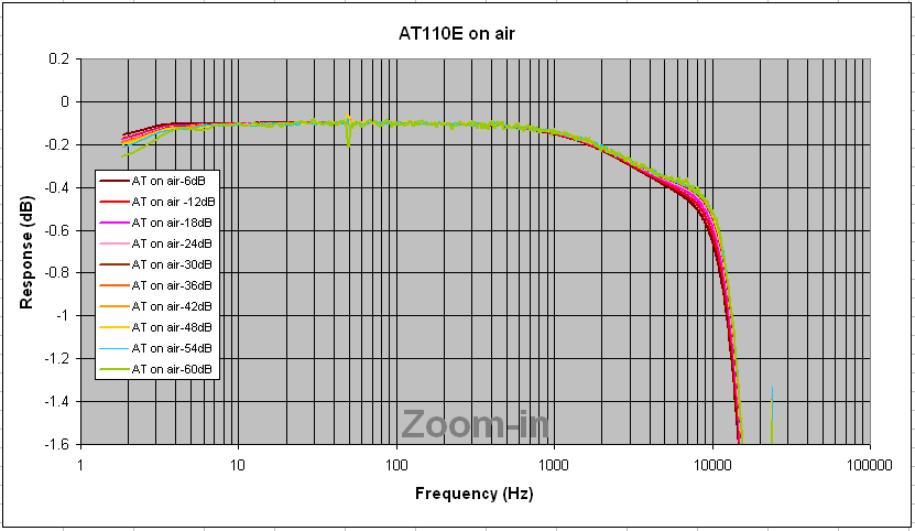

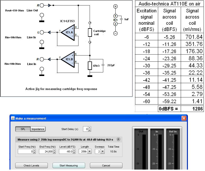

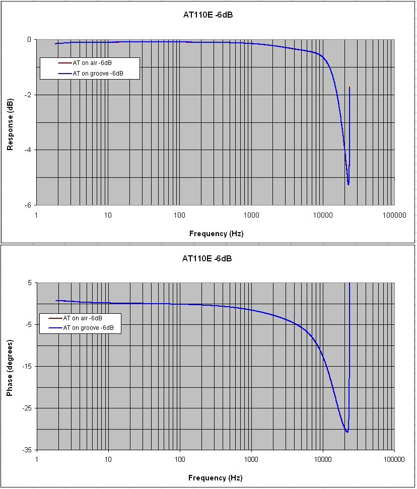

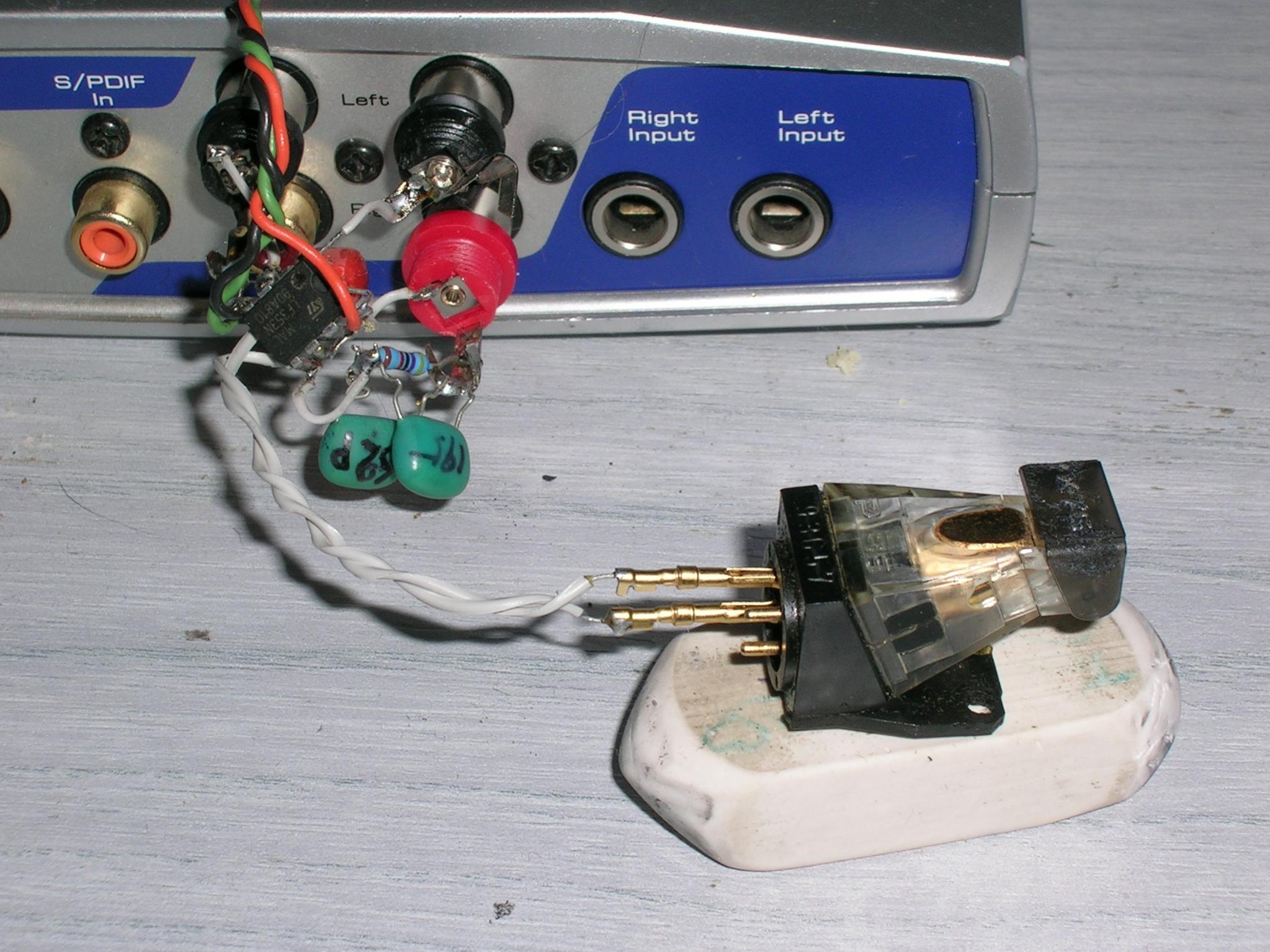

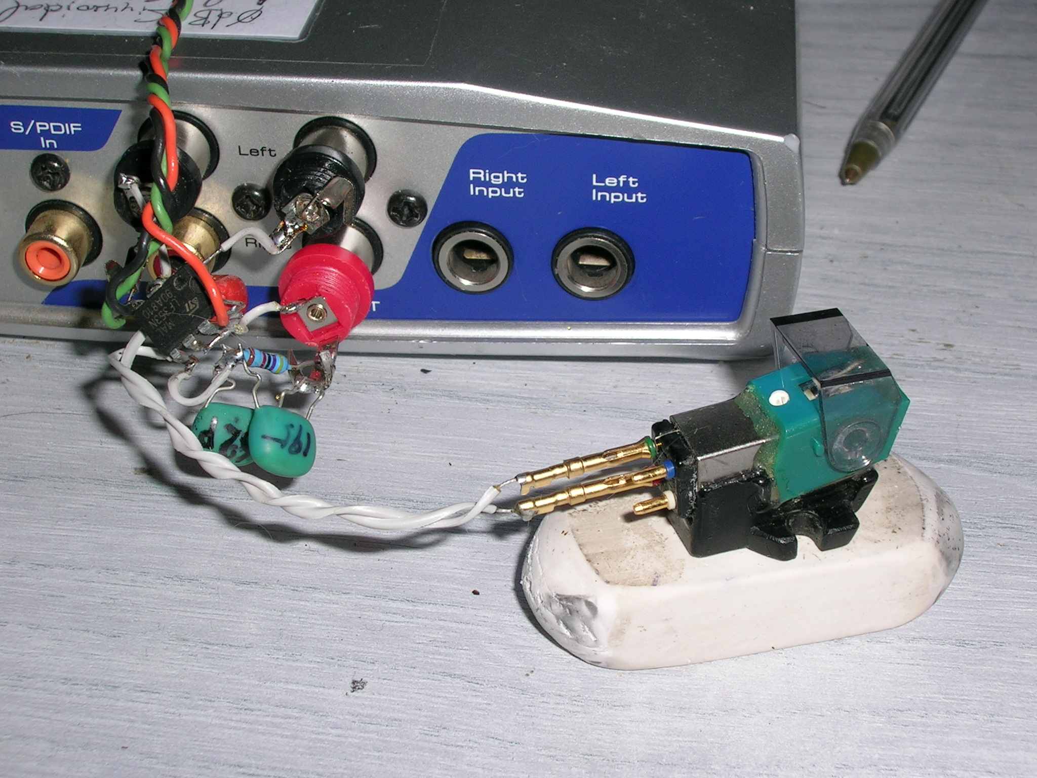

Audio-technica AT110E response
George

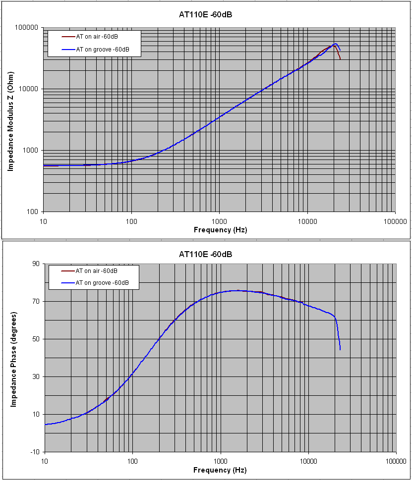

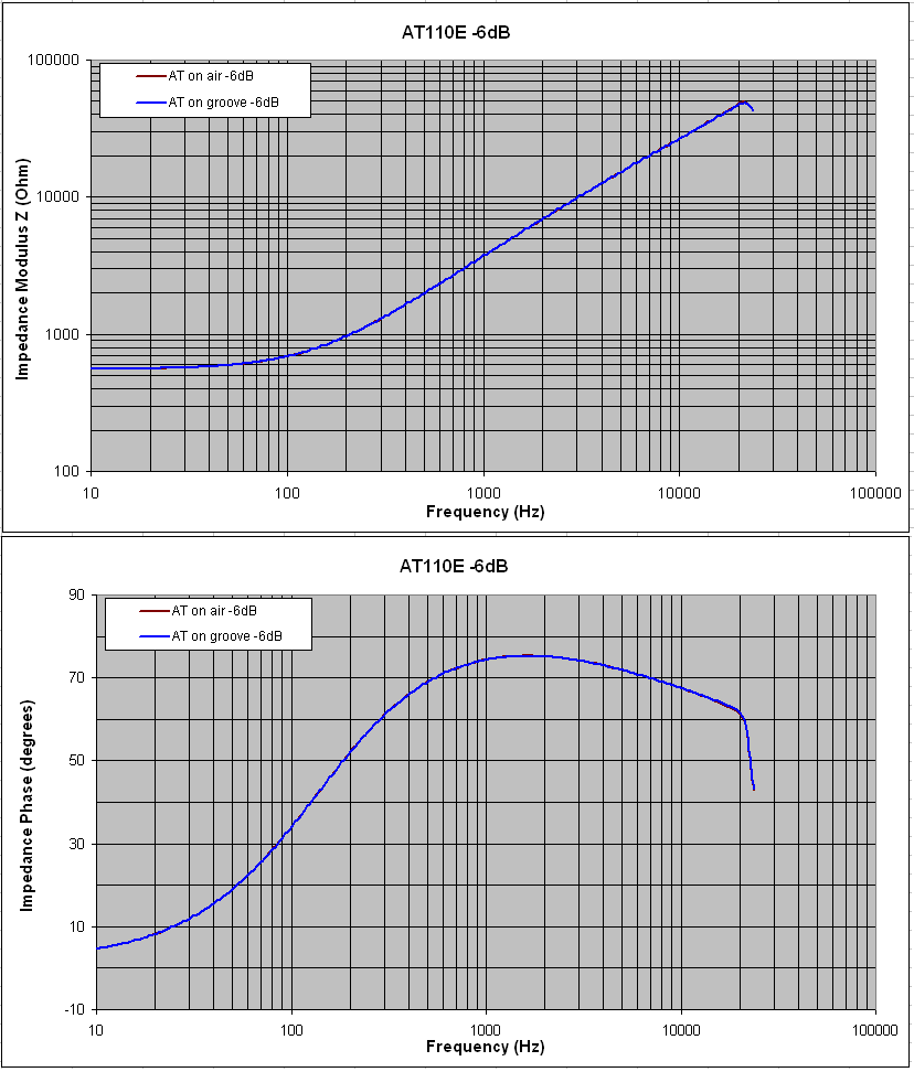

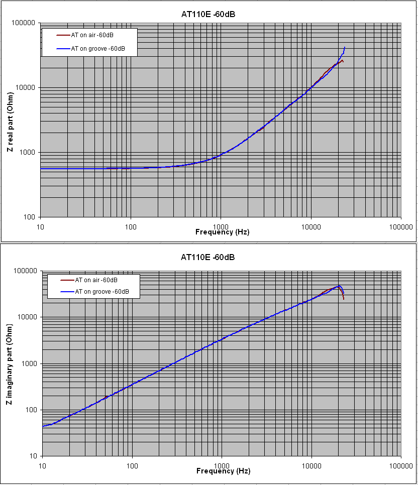

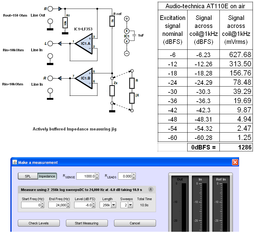

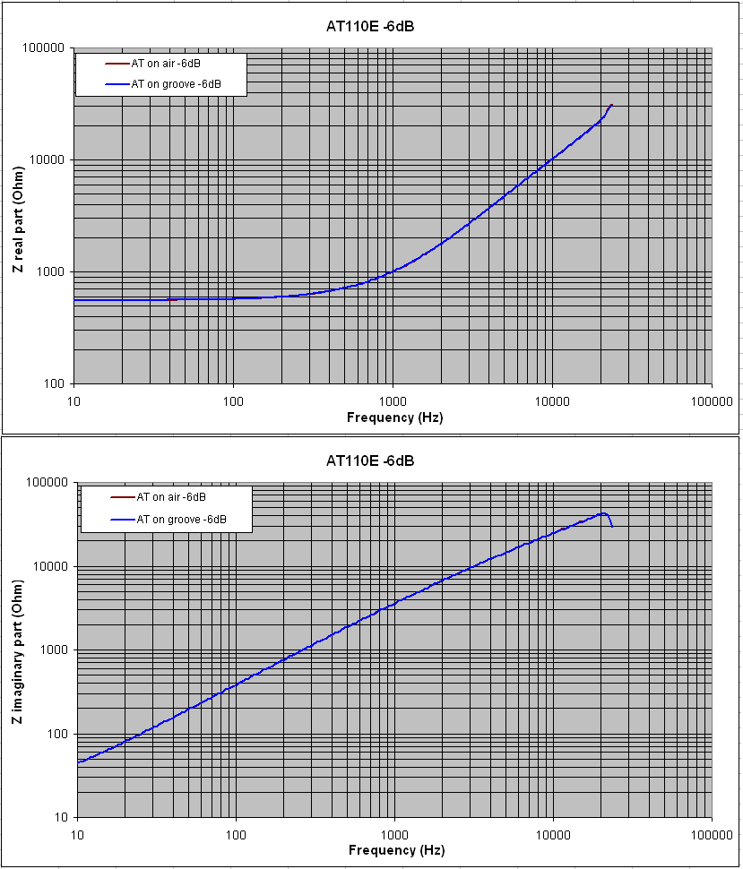

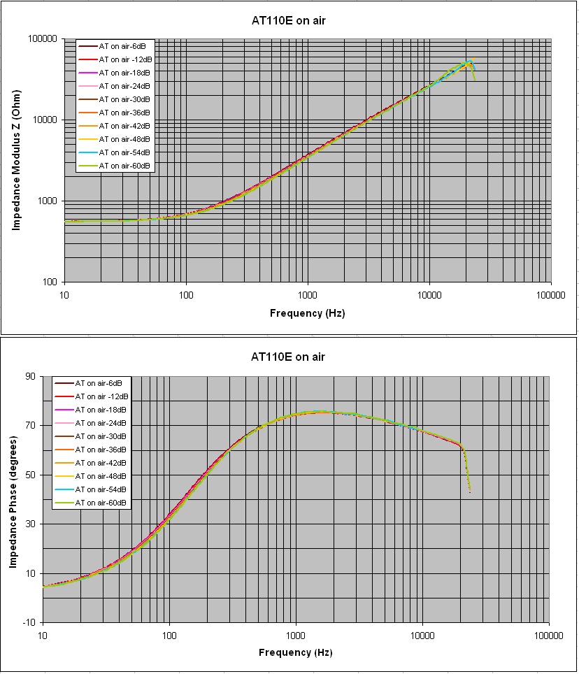

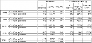

Audio-technica AT110E impedance
George

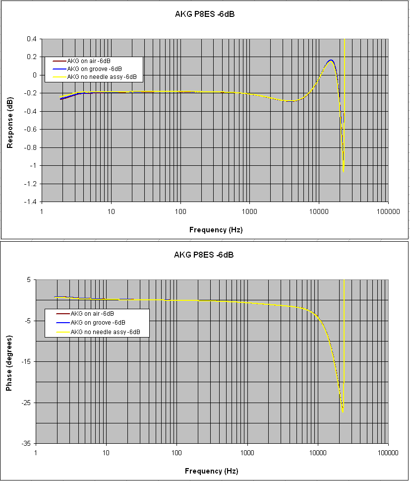

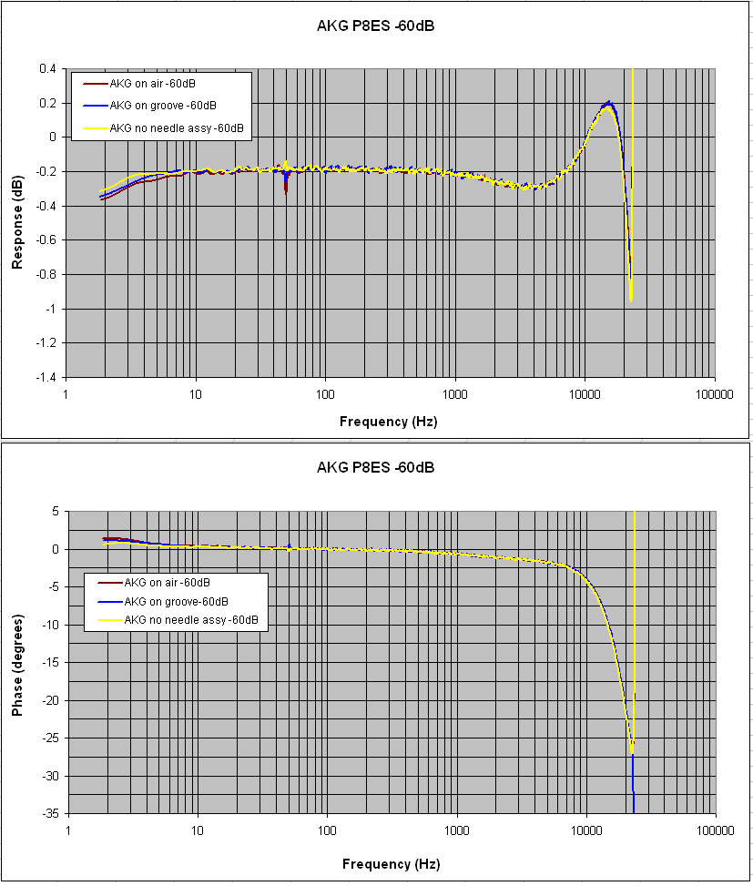

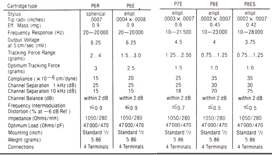

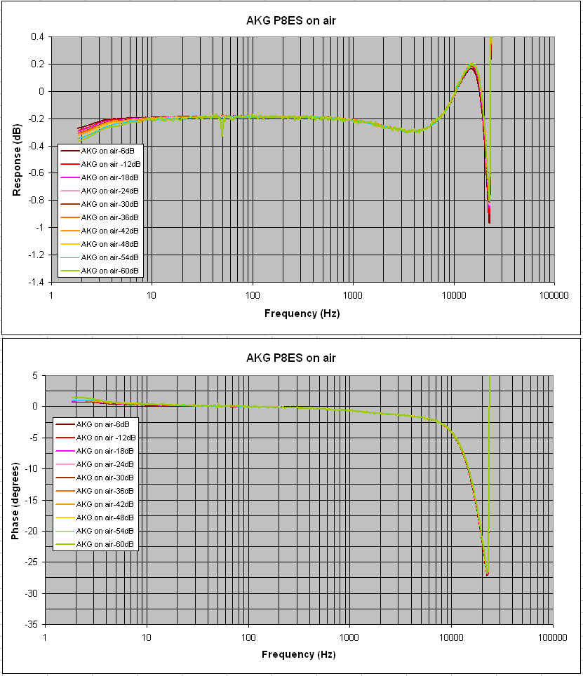

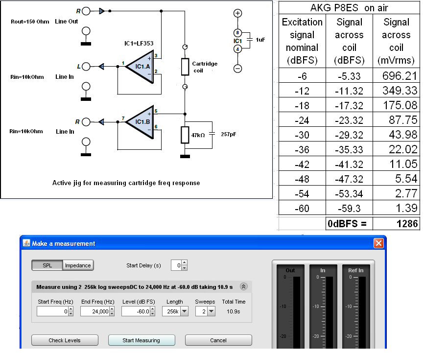

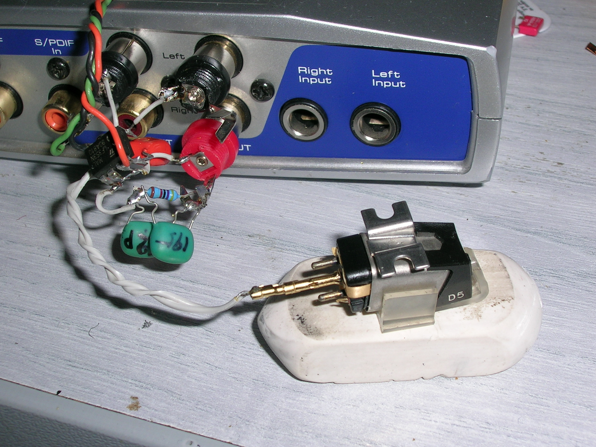

AKG P8ES response
George
