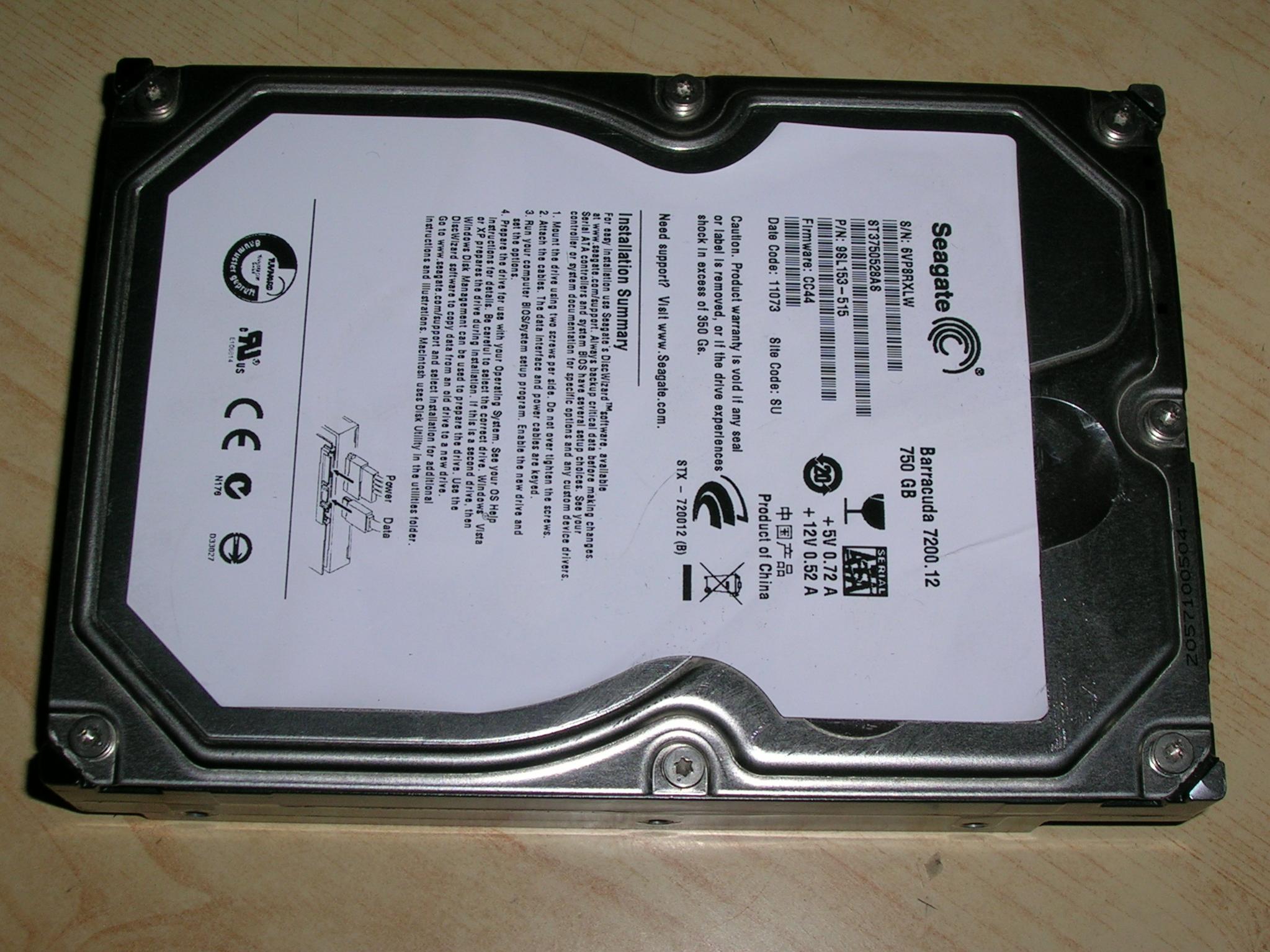

Wow, total empathy and words don't cover it. But don't do anything hasty, plan for a recovery. If it's windows and an external drive, chances are its corruption of one copy of the NTFS file system headers. But there is a backup copy automatically stored, so recovery might be possible. Stay cool and take good advice, don't rush.I lost access to the impedance measurements of the previous 5 days, together with anything I had saved the last 10-11 years on a 750GB HD.
I am totally pissed off

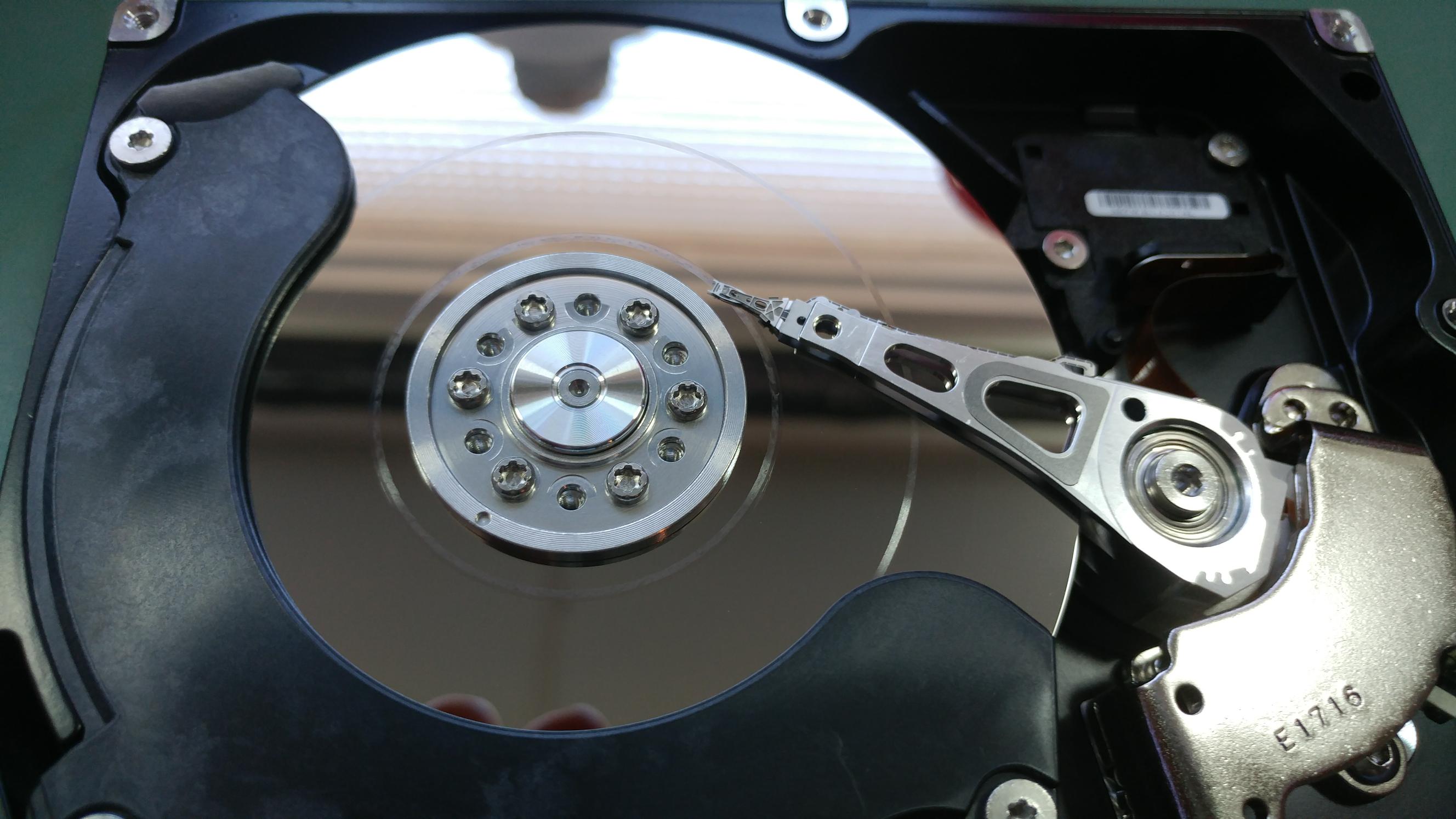

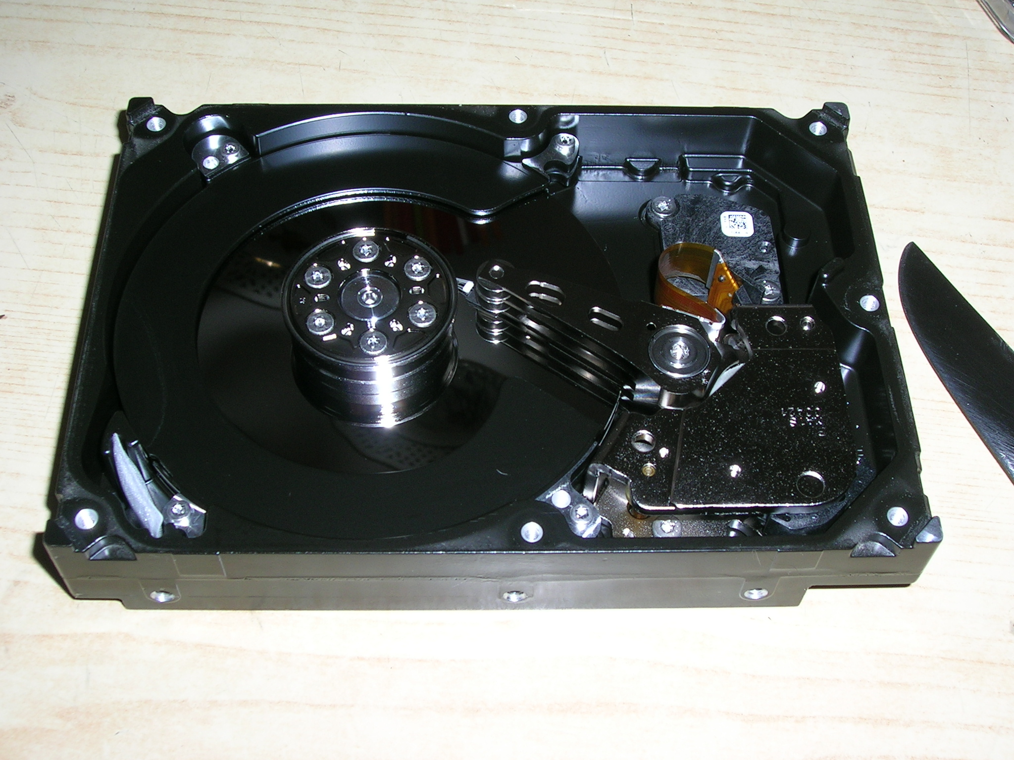

I was close to sending it out. Then decided I would look inside. I found this and gave up. Sometimes acceptance is a relief. Easier that finding another matching drive and attempting to swap parts.
On mine, the visible side is scratch-free.Then decided I would look inside. I found this and gave up. Sometimes acceptance is a relief.
Yes. And I don't hear it clicking when it spins. If it's the electronics there is some hope.

There are specialised companies very capable in recovering of what is still there.On mine, the visible side is scratch-free.
George
Don't try to do it yourself, you do not even have a dust free room to start with.
The smallest dust particle can already lead to a fatal crash.
Hans
Just a thought....once you've had at it, it may no longer be a candidate for pro recovery. Amateur efforts easily cause more damage. You don't have a clean-room, now do you?
300Eu doesn't sound like a lot, given the pain it could relieve. When it comes to the cost of an error like not running backups, that sounds pretty cheap. I've made far more costly errors than that. A cup of coffee down the laptop keyboard, for example.
If you are careful and open in a dust free environment its not that bad (I used to work in a disk manufacturing company). Don't leave it open, don't sneeze, but no clicks is a good sign. Get a similar drive from eBay and swap logic cards. You can even find logic cards. They are cheap enough to give a try. You do want to copy the important stuff immediately if its working.
