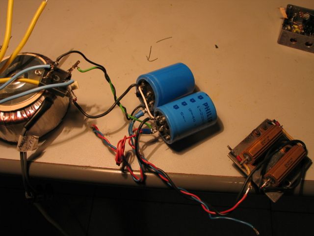

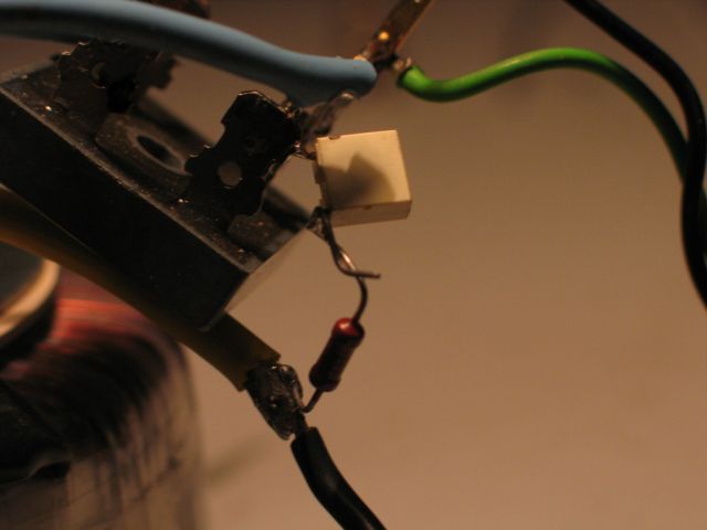

Here are some preliminary pics about my best efforts to illustrate what we have been talking about:
First, the test setup:
Classic style power supply, high current rectifier bridge, 2*24 VAC, 2* 20000 uF reservoir caps.
Made in a hurry, [ugly, pardon me].
I am sniffing at the power AC, with respect to ground [transformer central tap].

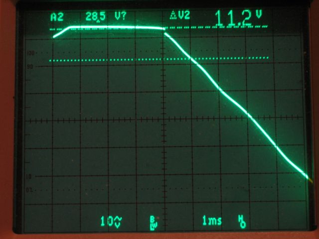

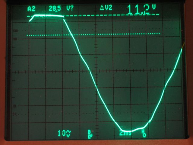

This how the AC signal looks like. It is assymmetric, because I only load the positive power rail. the load was visible before, it is 20 ohm Dale power resistor.
On top you see the sinus "de-capped". At the end of the plateau, there is the glitch. Note the value of it, I've put the markers on it!
The same again, more close:
Note, that the width of this plateau is the duration of the recharge current pulse. The lenght of it depends on the signal current flowing into the load: with higher output this plateau is increasing, with lower output signal it is narrower, it stops at around 2-3 msec. Now, you have that spike rigorously attached to the end of it, with it's relative phase [and amplitude] modulated by the output signal!
